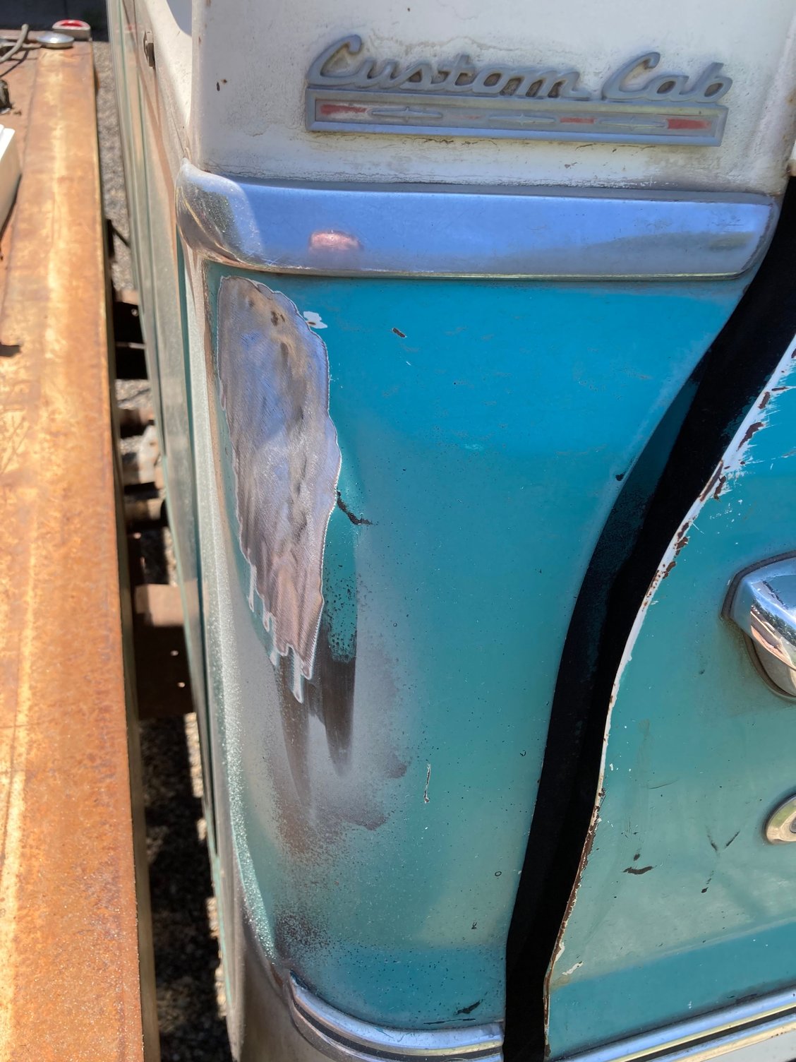

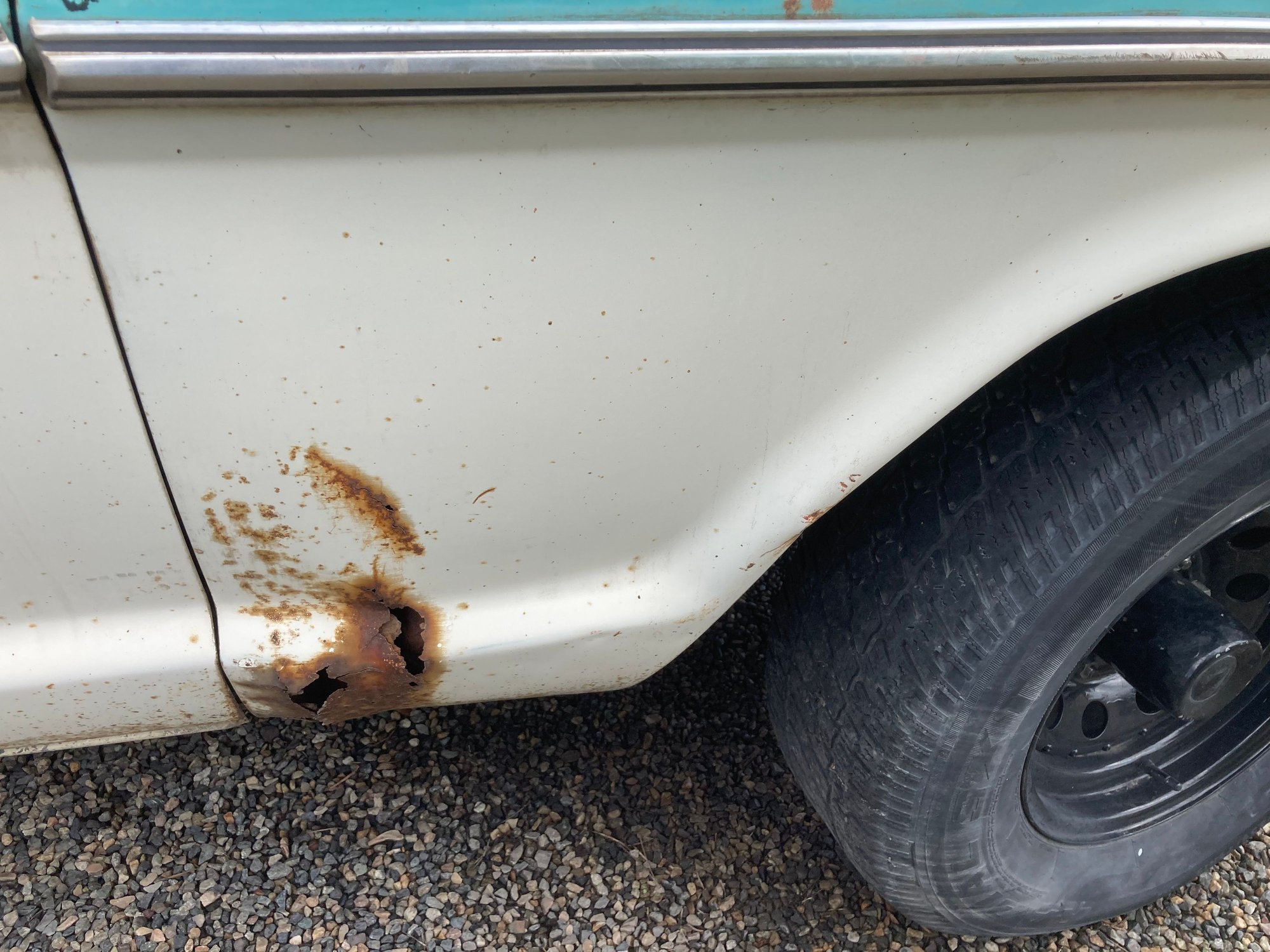

Starting a new build, I bought a 1967 F100 flatbed ($600) that the previous owner said he built a flatbed for and swapped in a chevy "heavy duty" rear end. He said the front suspension is worn out but the 302 and automatic trany are still "good". I have a 1972 F250 chassis with all stock running gear so the plan for now is to put the 67 cab and flatbed onto the F250 chassis. I started by hunting the rust spots these trucks are known for and fixing what I could as I wait for my parts orders to arrive from NPD, LMC, & DC. Here are a few pics...

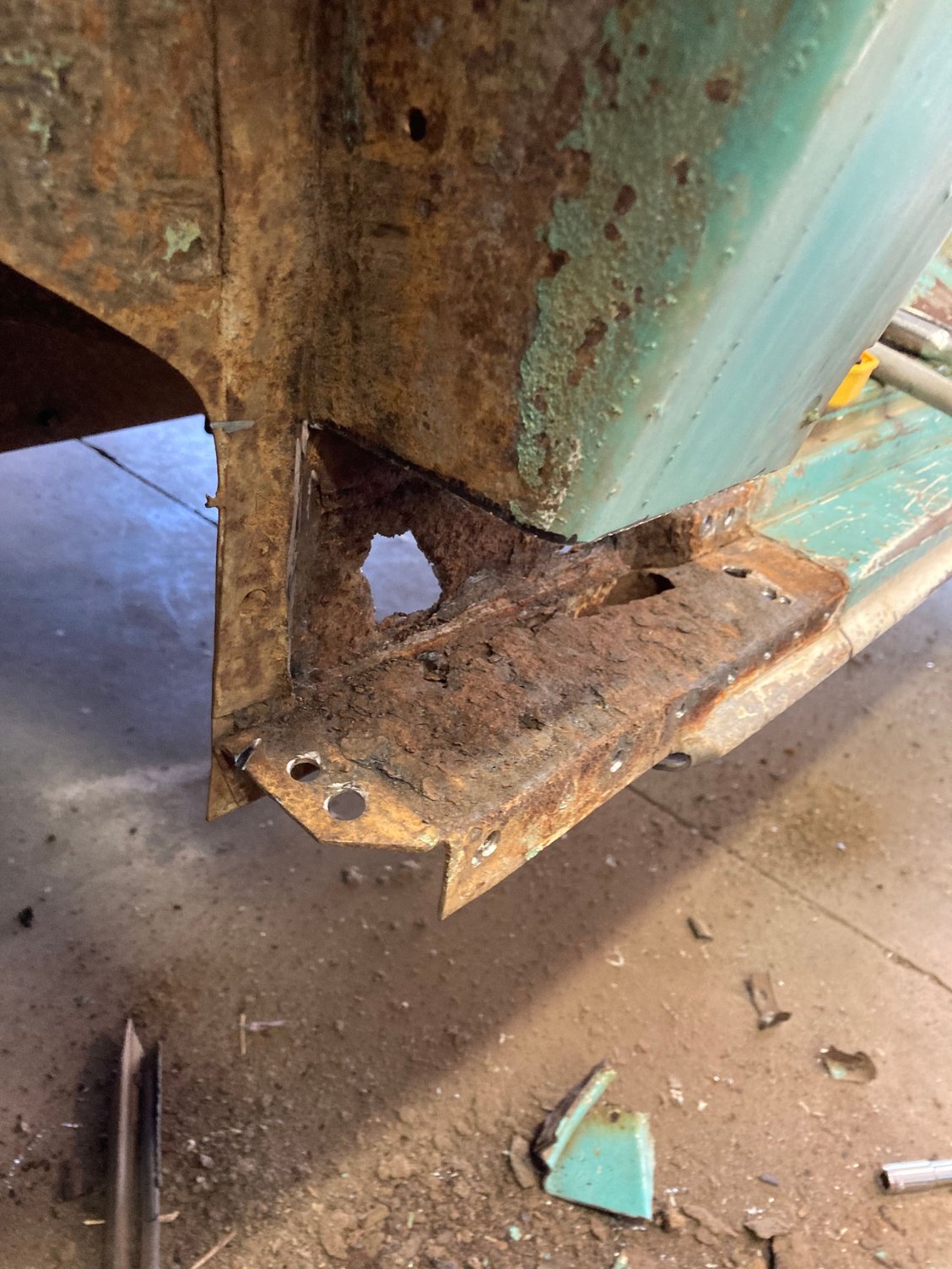

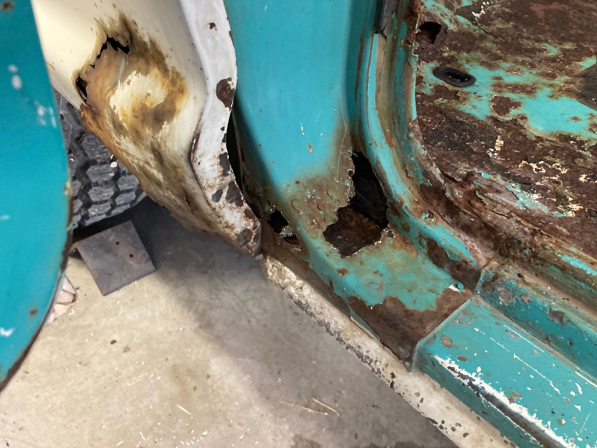

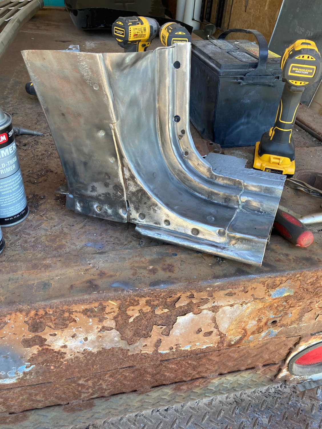

I have patch panels for the fenders and floor panels but I was surprised to find really bad rot in the driver side cab corner. I don't have a picture of before so you'll have to take my word that it only looked like surface rust but turned into a complete corner replacement.

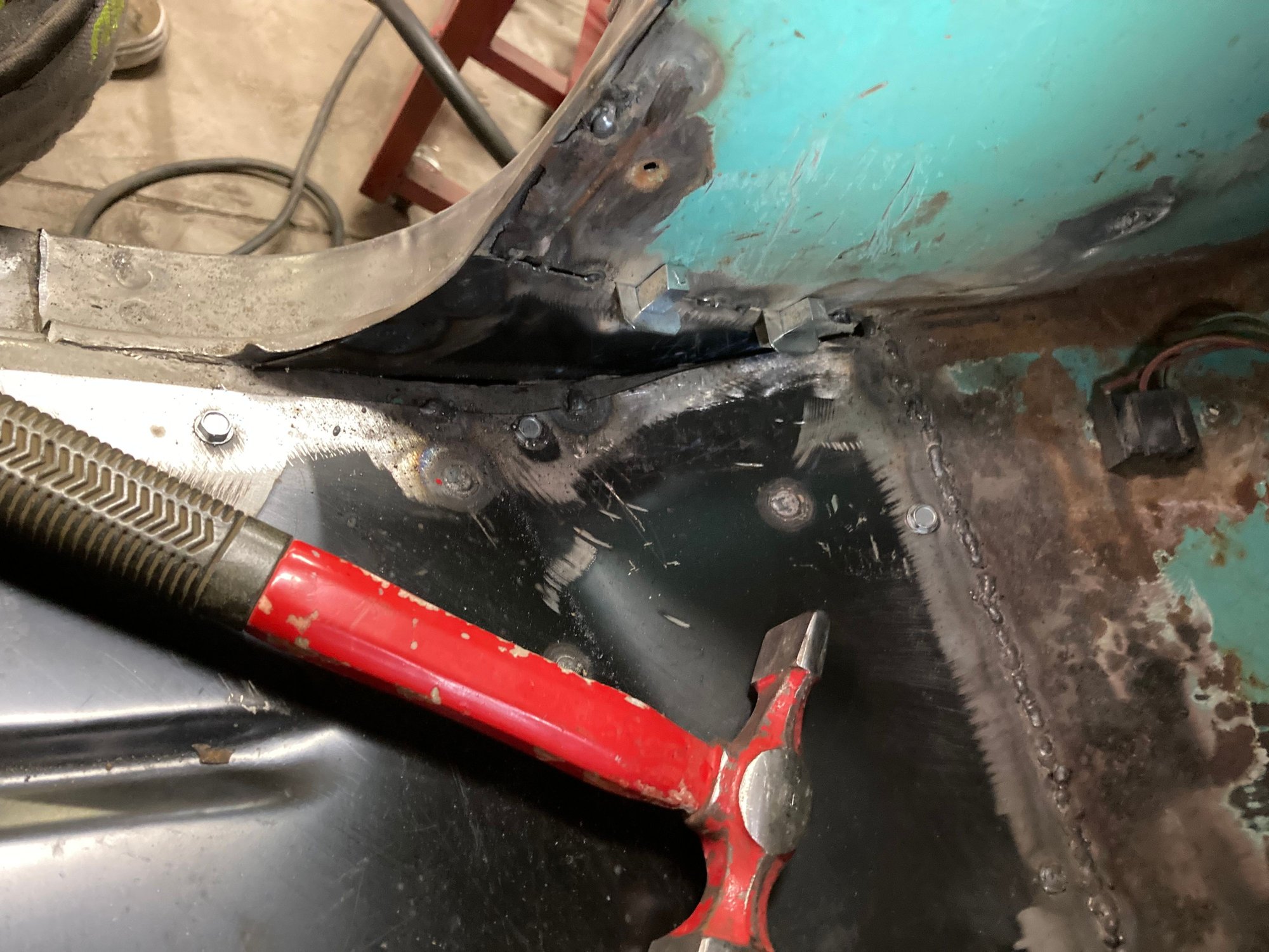

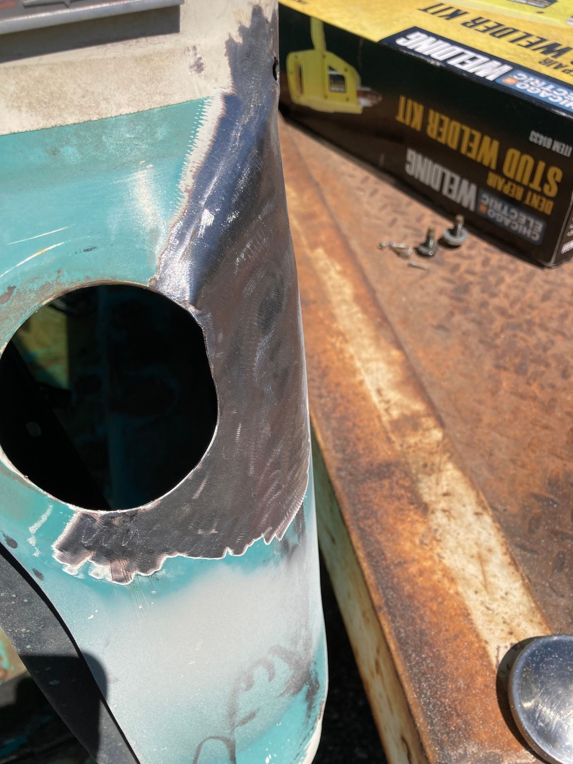

There were a couple dents on the back of the cab corners so I used my pin welder to pull those out.

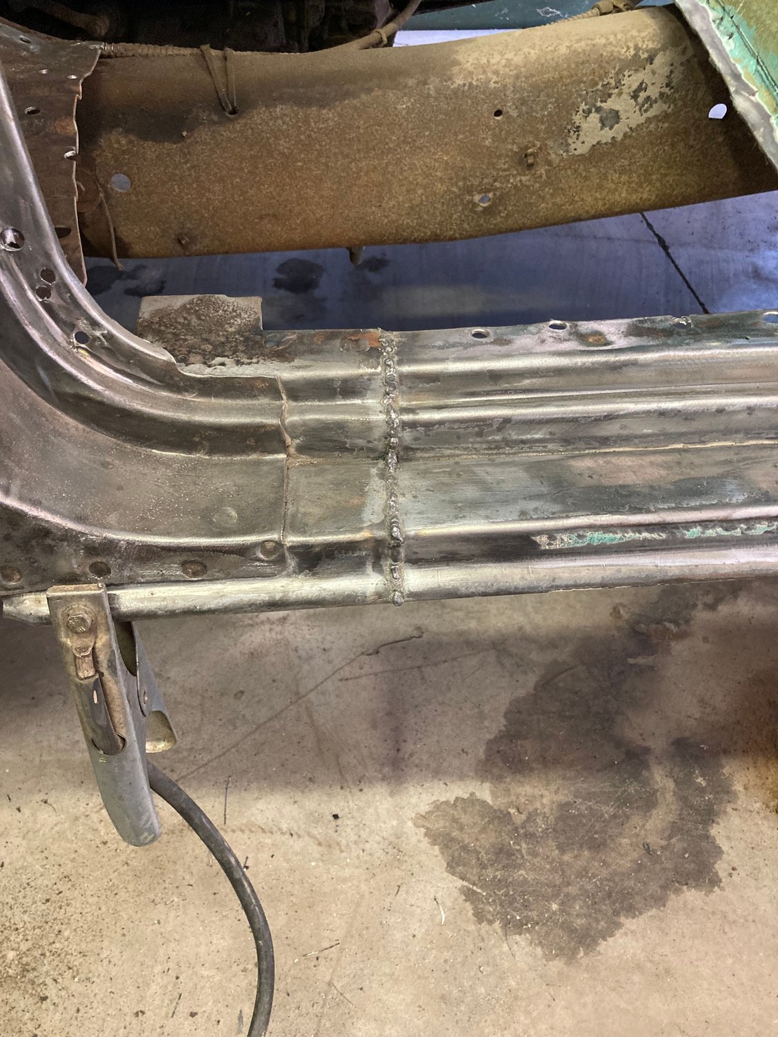

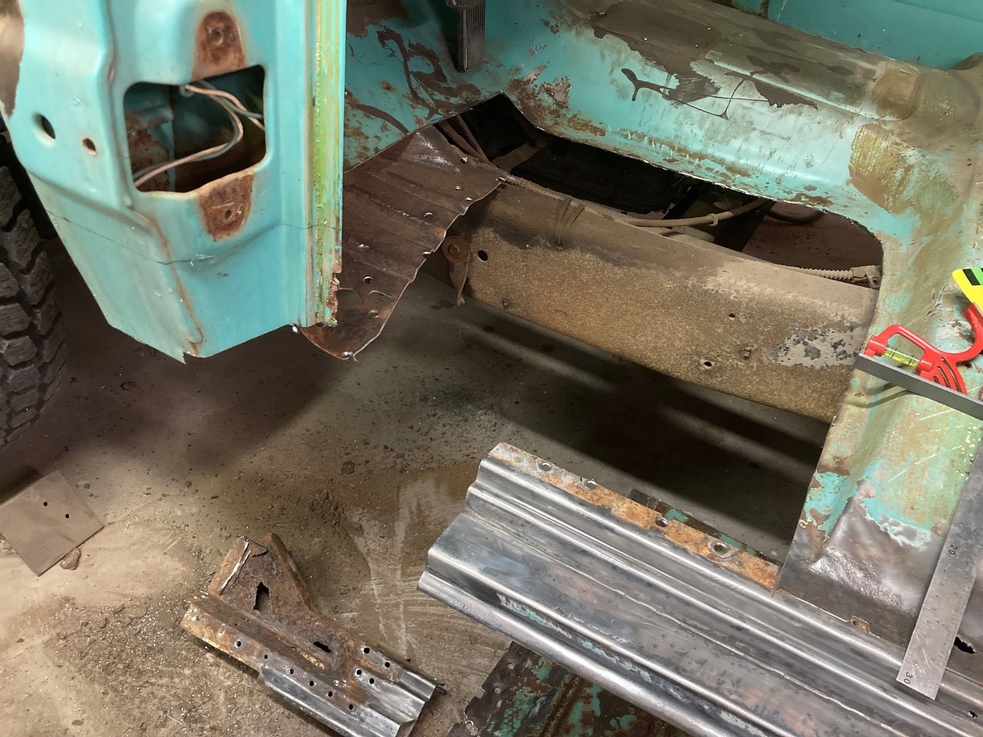

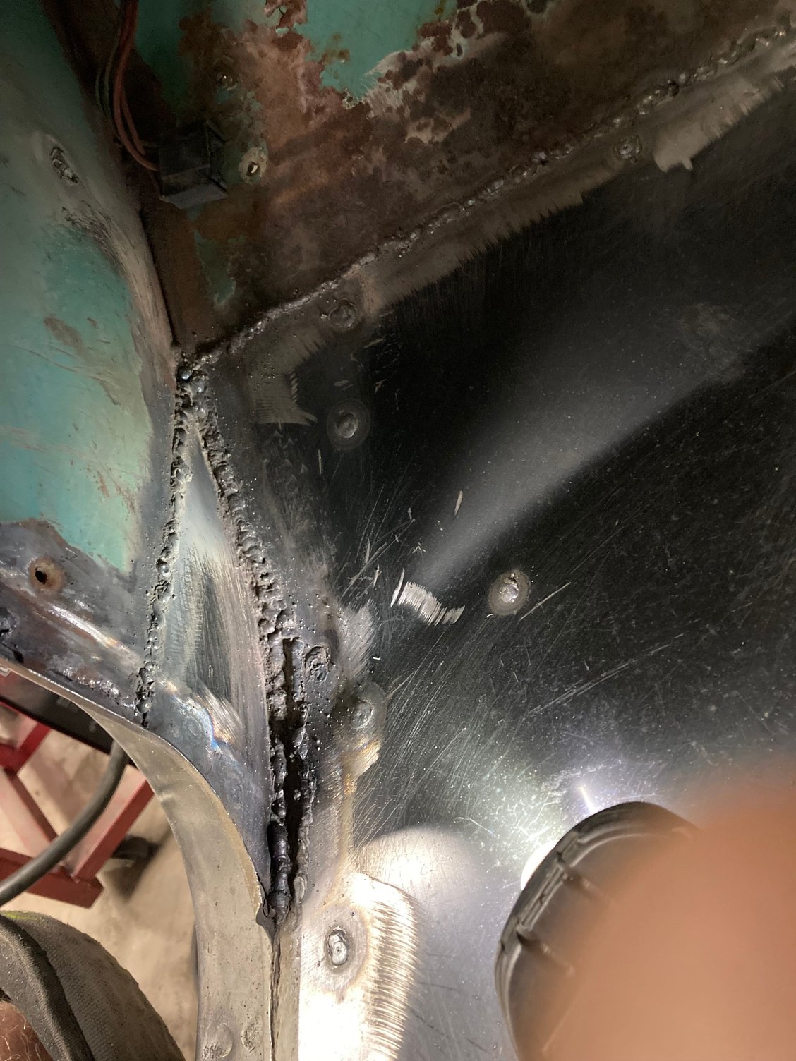

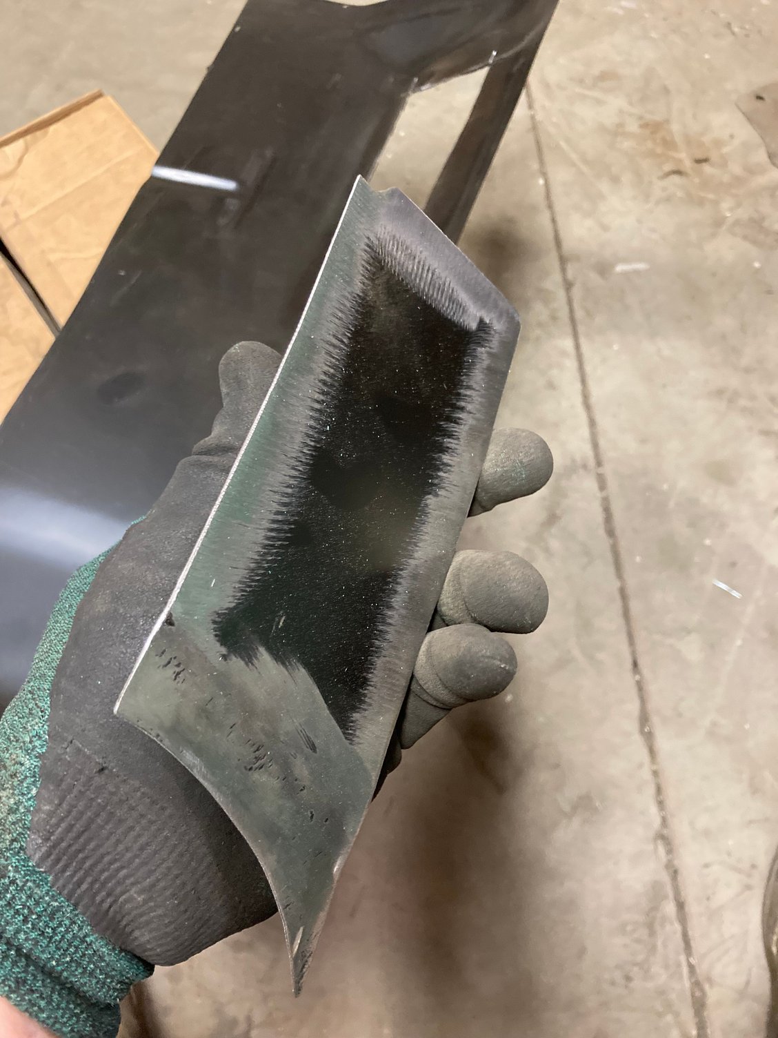

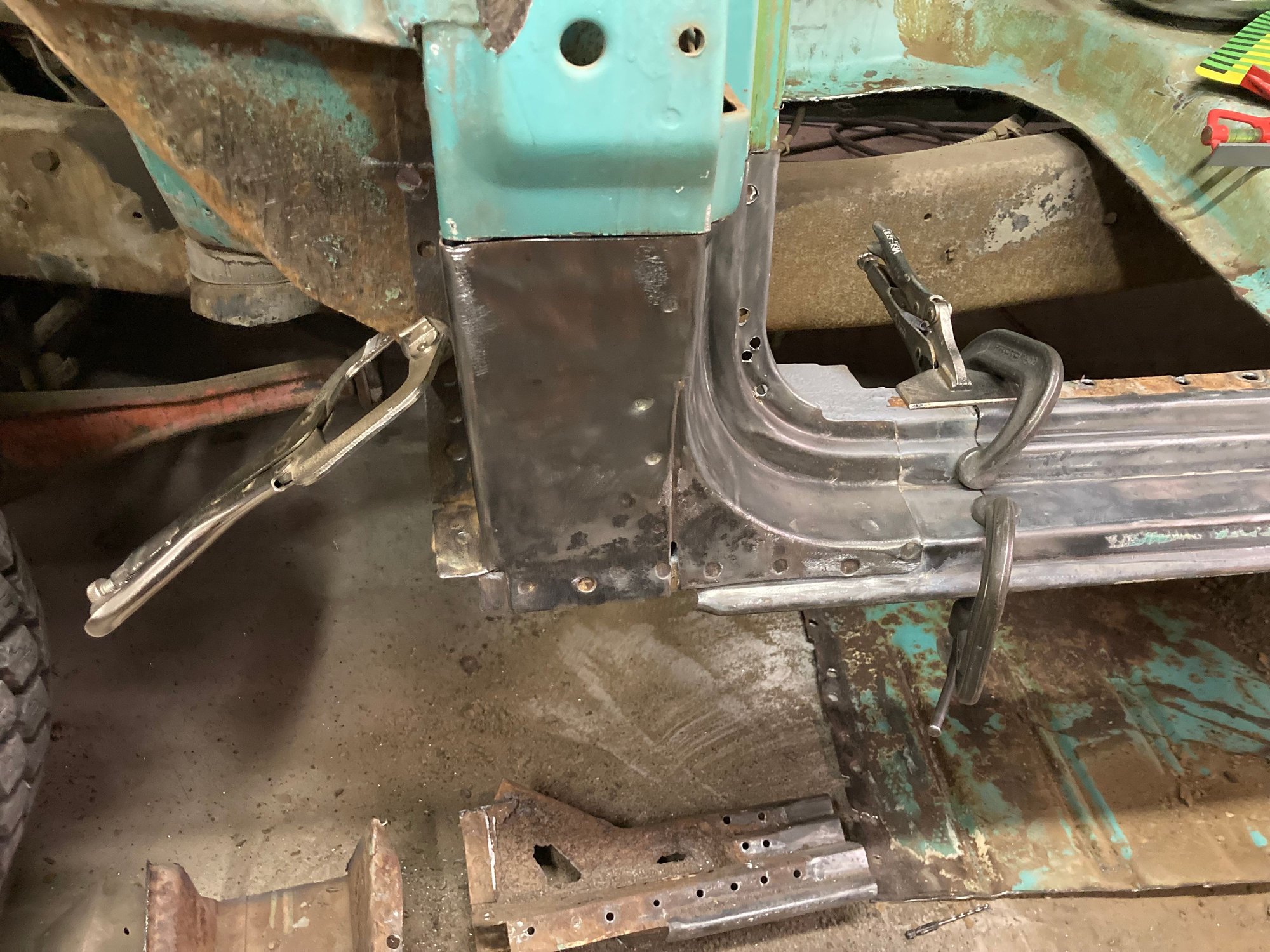

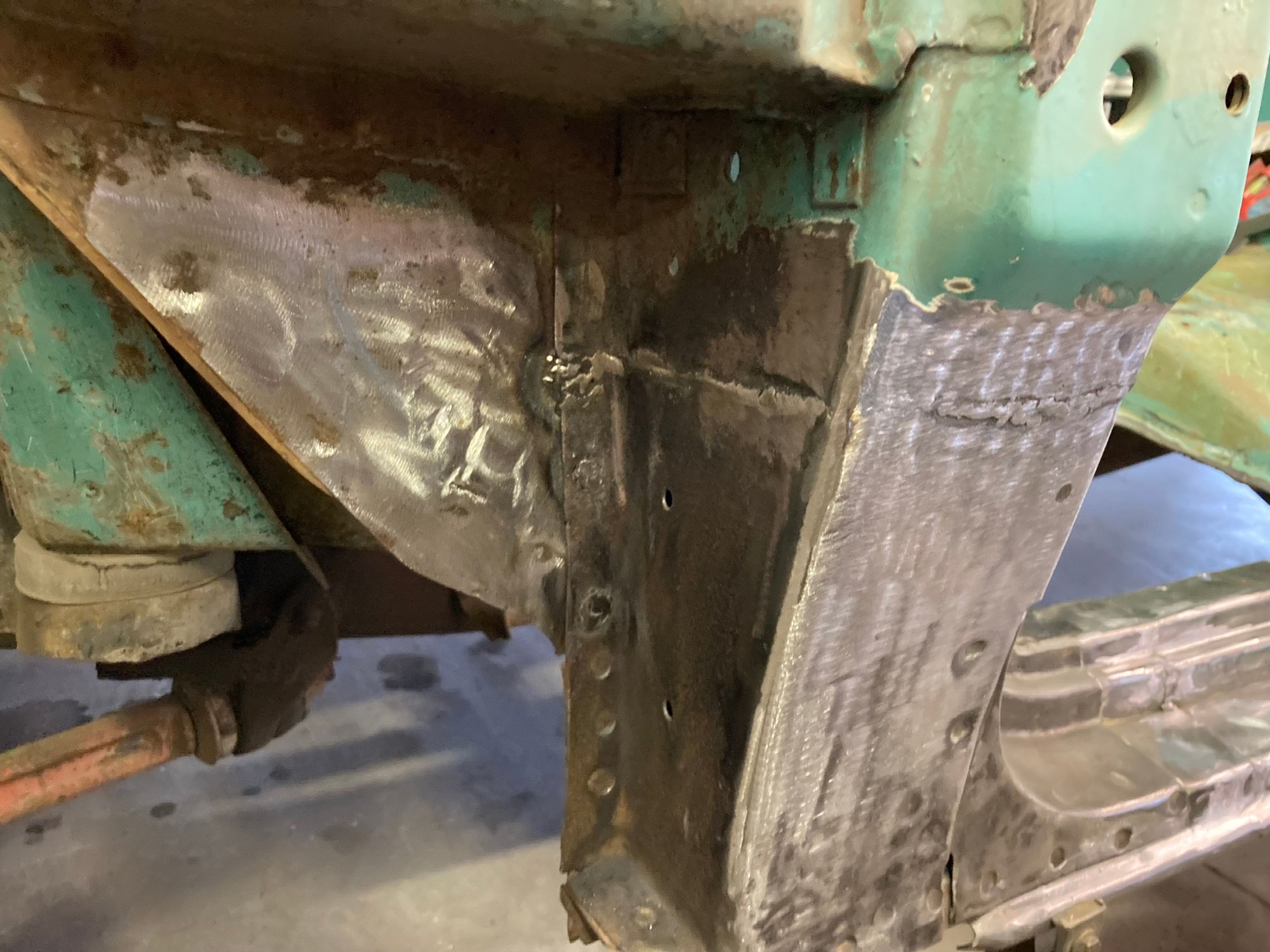

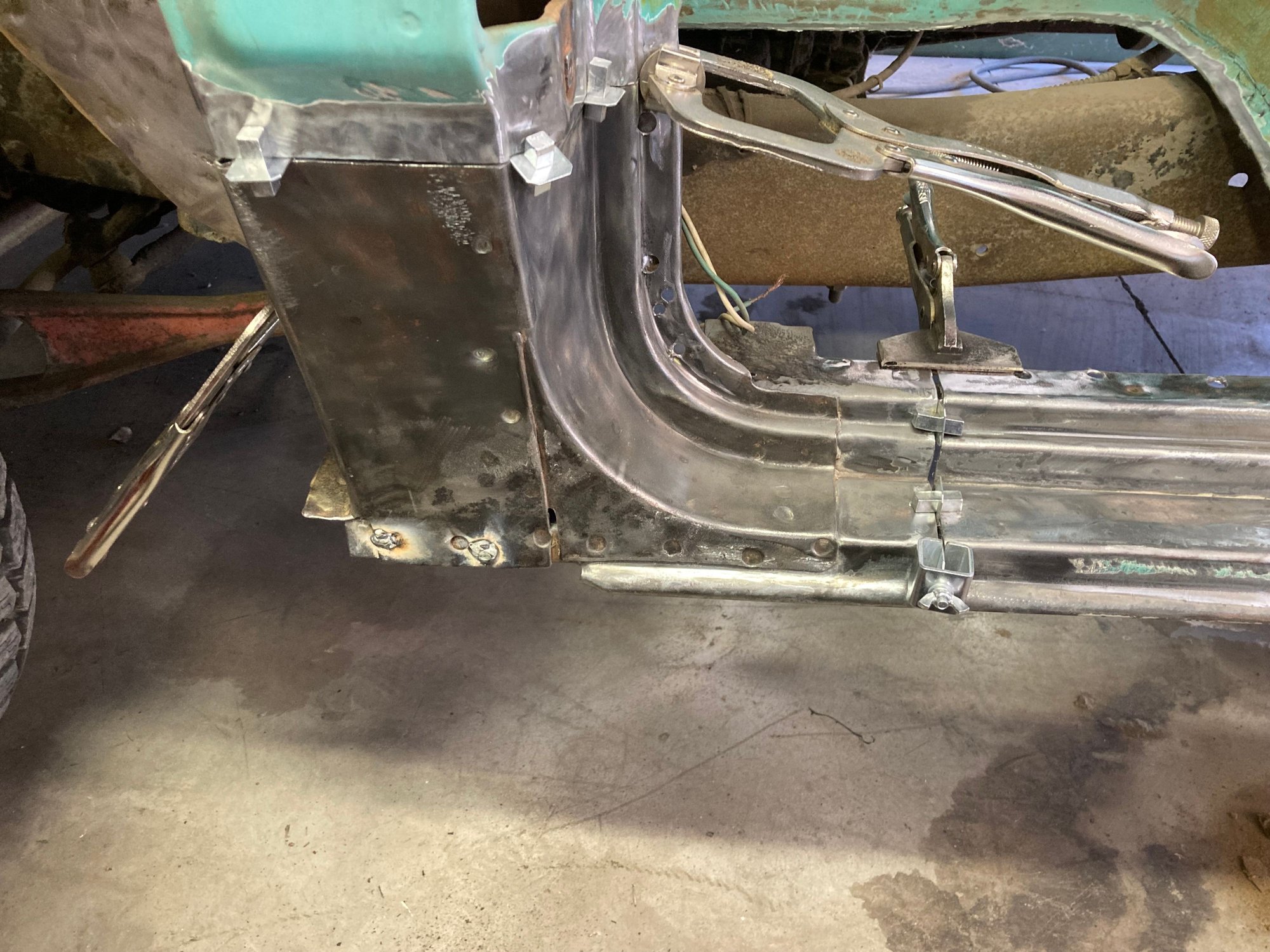

I found a good cab corner on my parts cab, cut it off and cleaned it up. Started fitting it to the 67 after cutting away the floor and rotted corner.

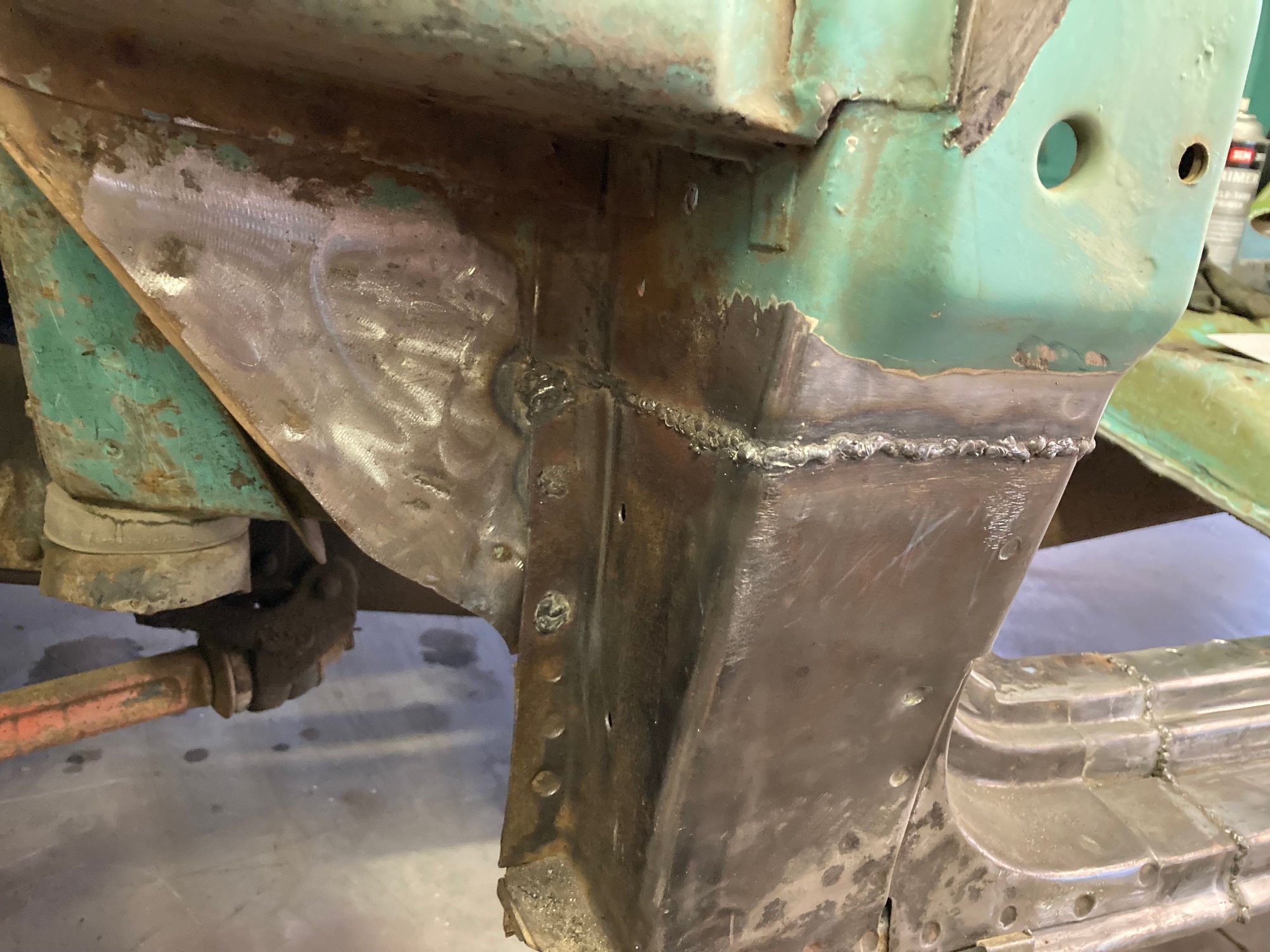

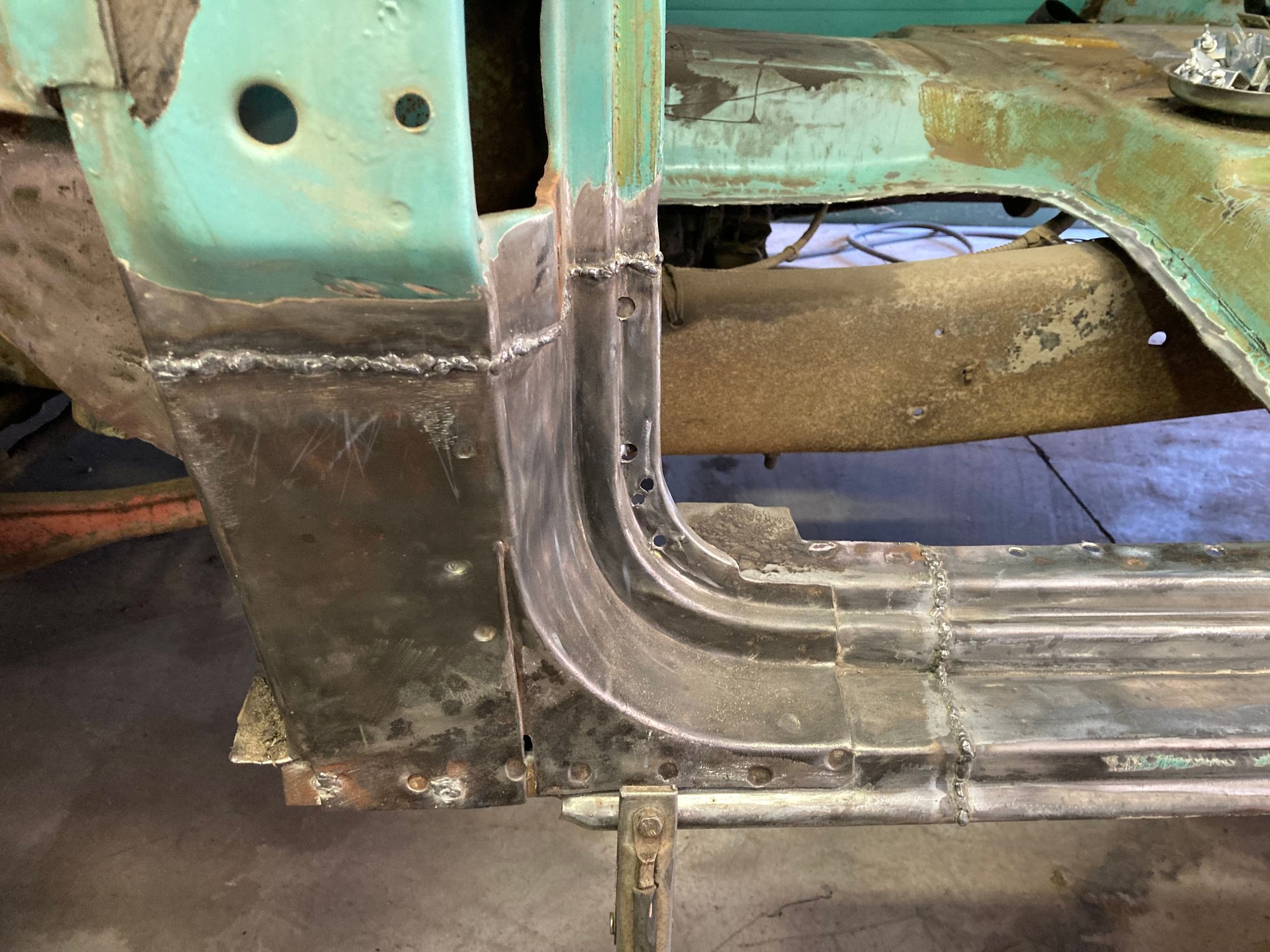

After a bunch of trimming I got it fitting where I wanted and welded it up.
Did a little grinding to smooth it out and started to prep the floor.

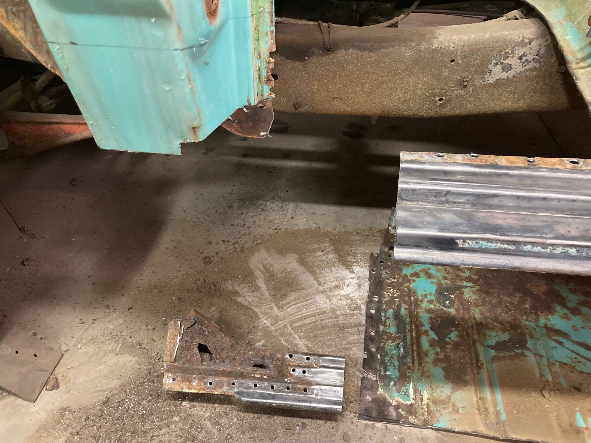

I will have to build a patch panel for the rusted out kick plate and then trim the replacement floor pan to fit.
So that's what I've done so far. I hope to be able to work on it a little each night and have something to show off by the end of the summer but only time will tell if I can make that happen.

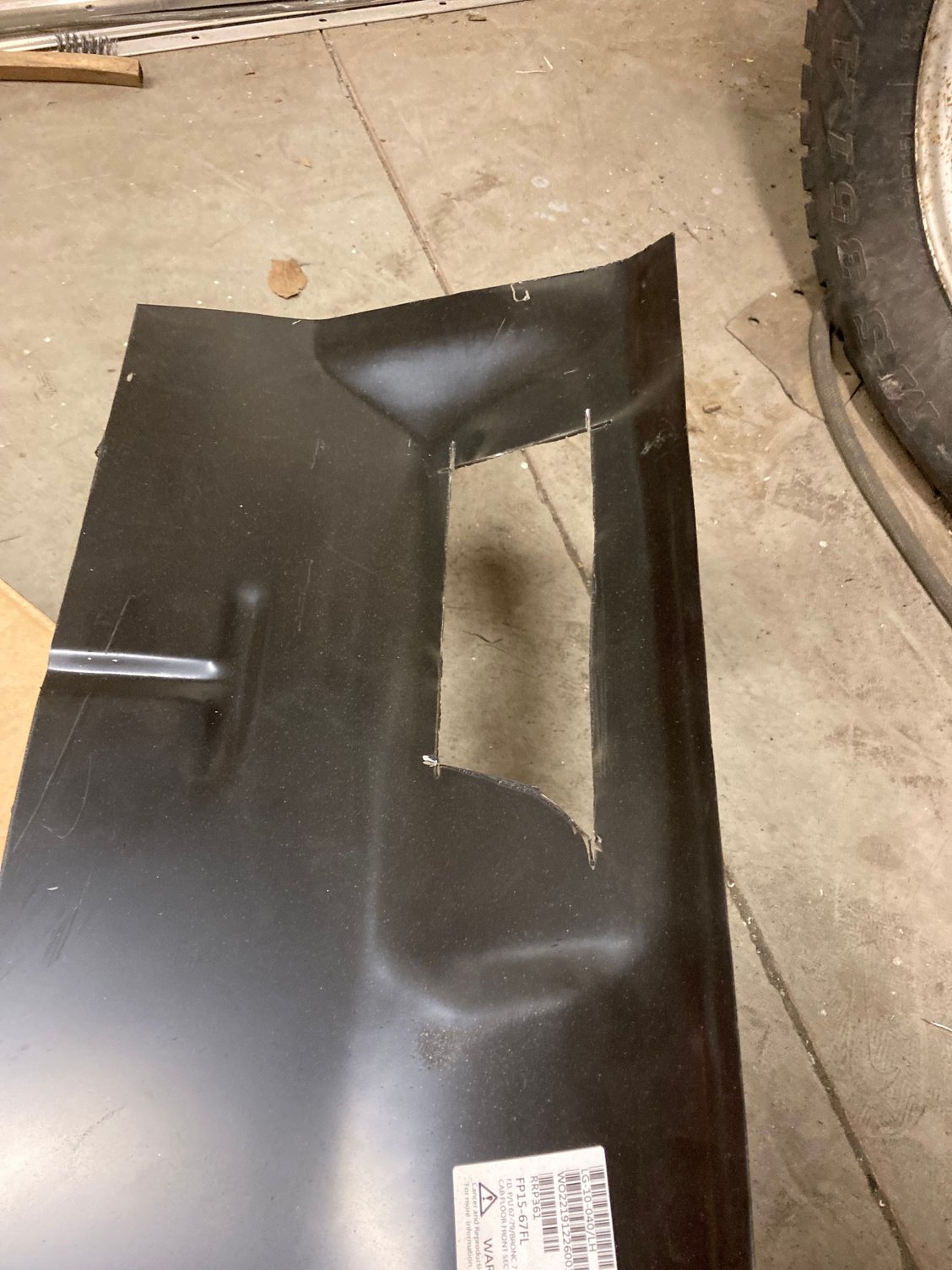

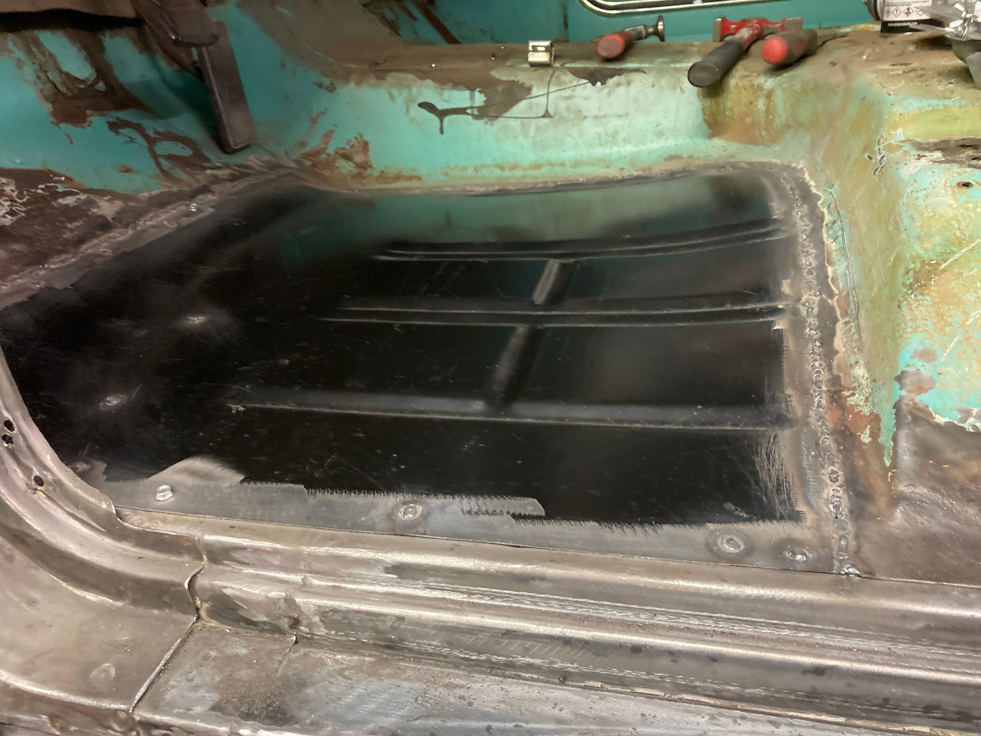

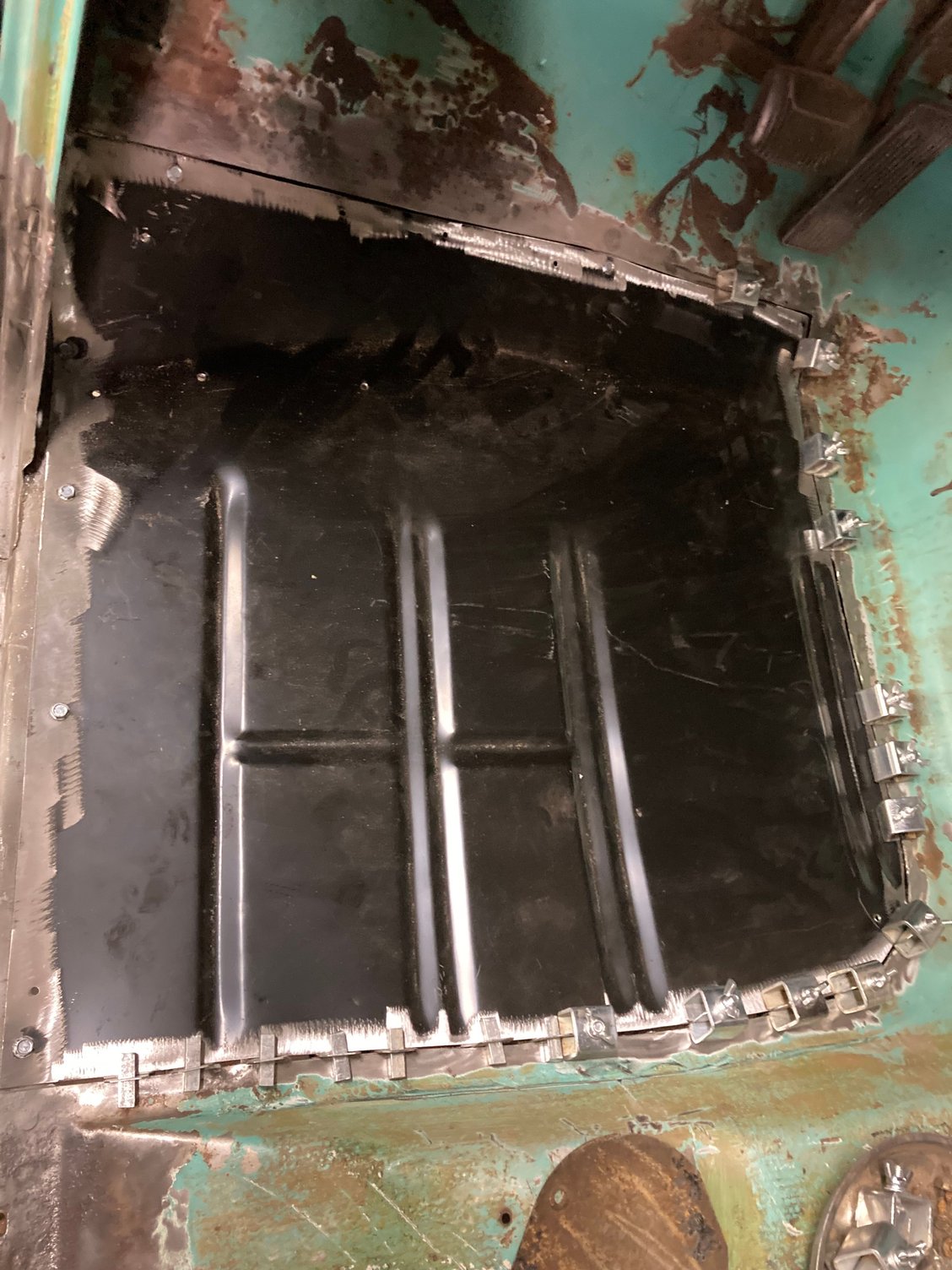

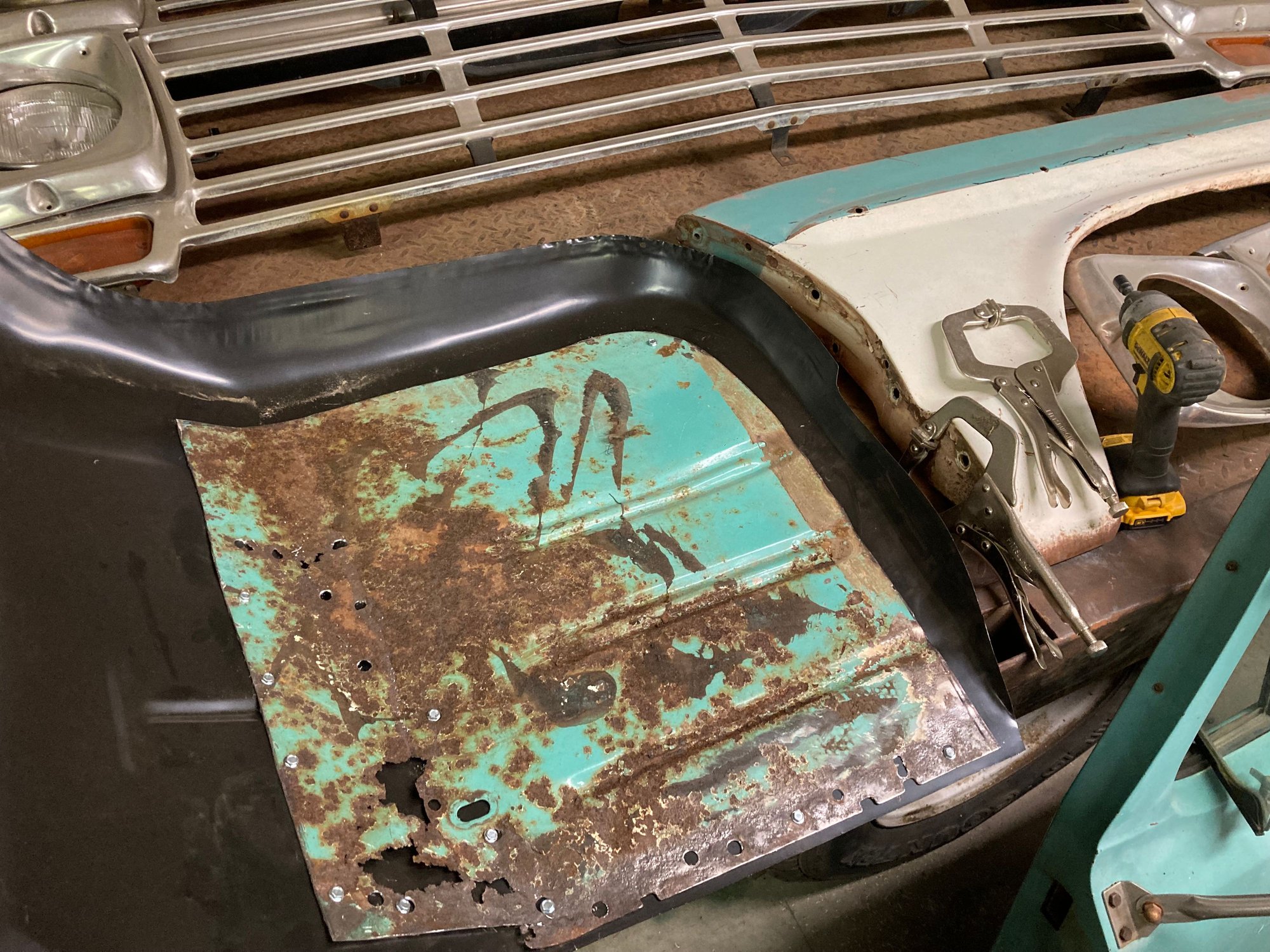

Didn't get as much done tonight as I'd like to but the drivers floor is in and one piece again. I used my cut out section as a templet and screwed it to the patch panel. Then cut along the edge to create an almost perfect copy. Still took a bunch of trimming to fit right
got it lined up after a couple tries and then welded it in.
Still need to grind the welds and do some more welding on the underside but that can wait until I unbolt the cab and lay it back for easier access. Now onto the kick panel patch and then passenger floor...

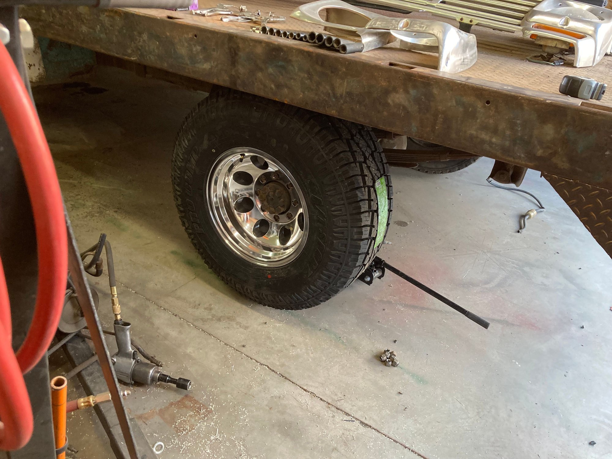

Some shiny things showed up today!
So of course I had to try on the new shoes...
With 2 projects in the shop it can be a bit cramped so I'm really liking this huge extra work bench

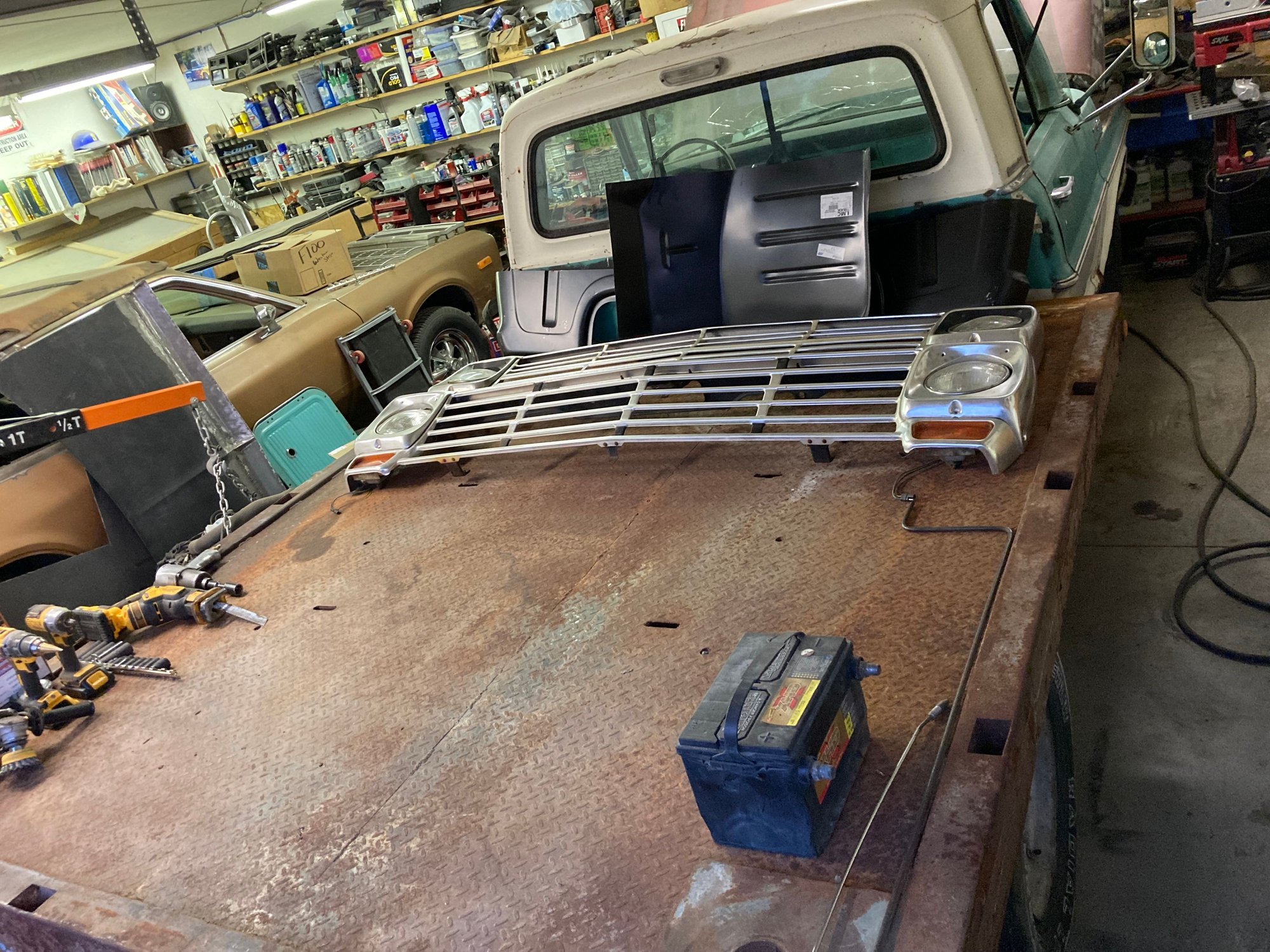

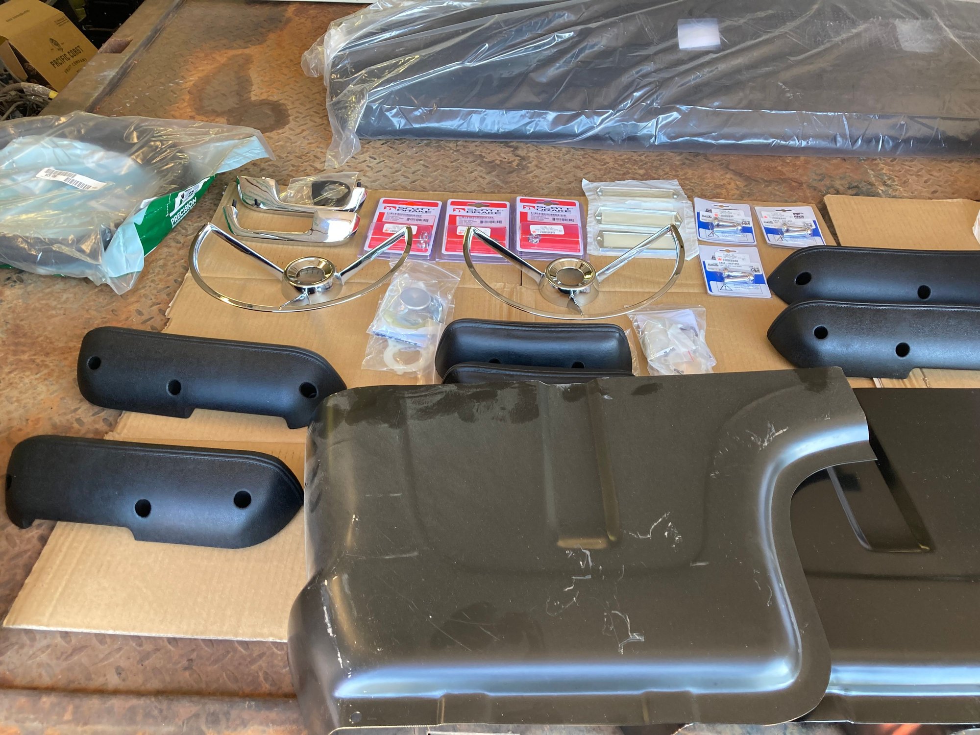

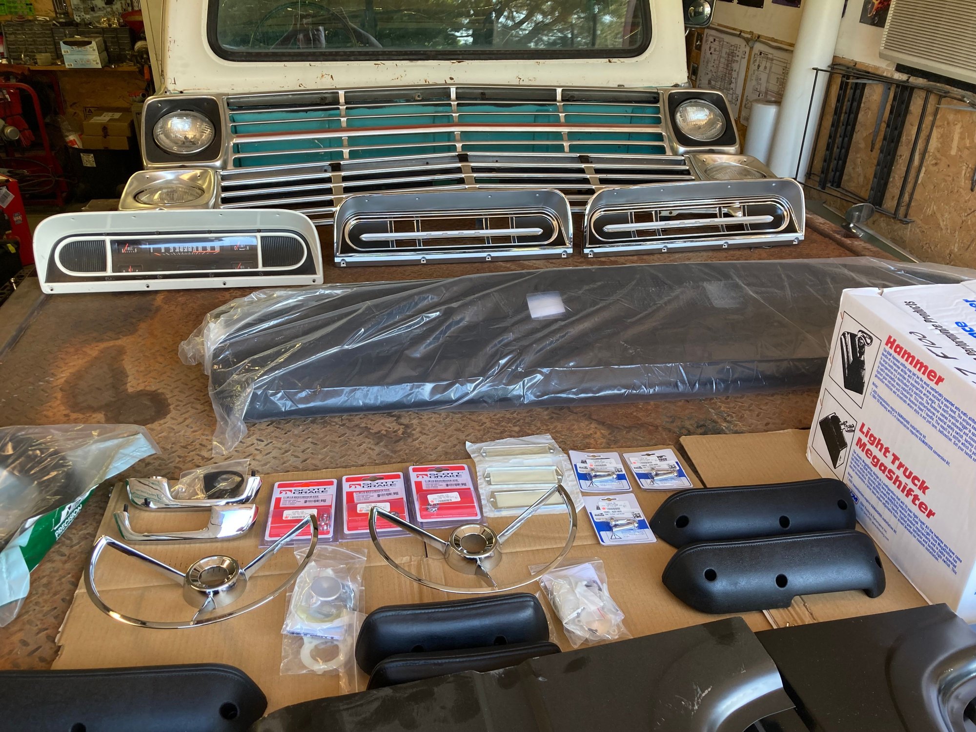

Christmas in July! well at least it's felt that way with a number of my parts orders showing up over the last few days...
I have 2 trucks that I'm focusing on but 5 trucks over all (oh and 2 parts trucks) so figured now was the time to stock pile some parts and get motivated to get them done! Still waiting on a few more orders from LMC and DC. Anyway not much else to report at the moment but I am heading back to the shop so we'll see what I can get done.

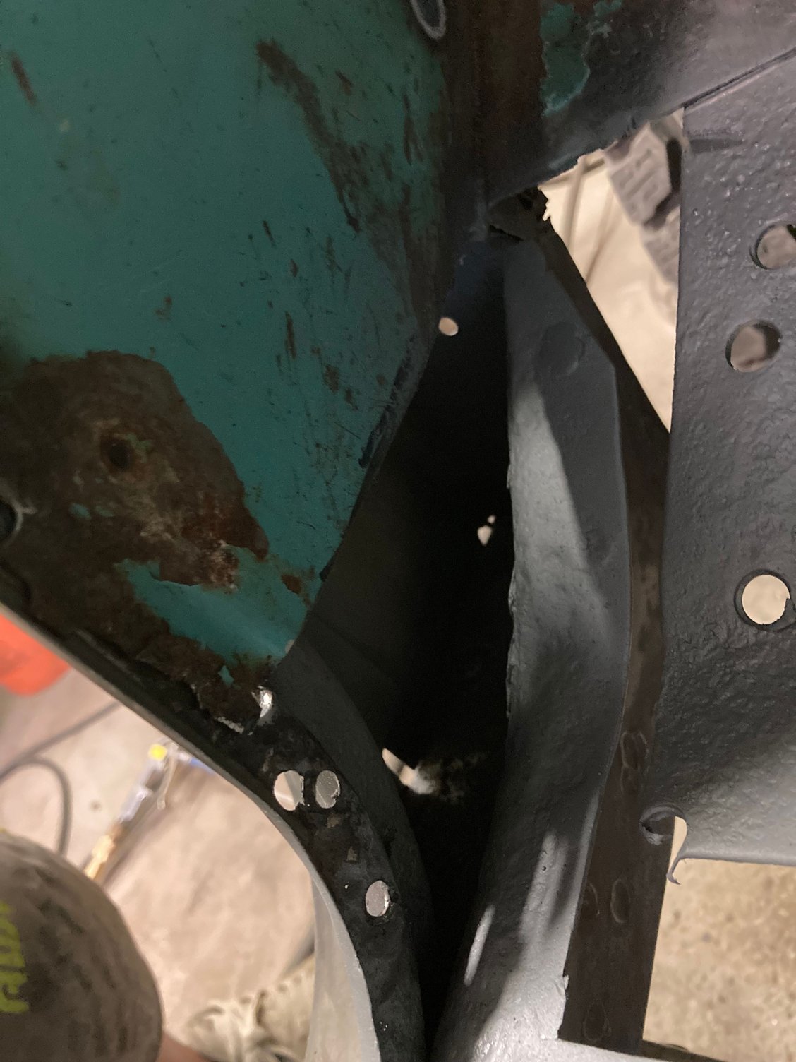

What coating are you using on the cab support to protect them from further rust? _ Tony.
Old Jul 17, 2021 | 01:11 AM
FoPar1972's Avatar
FoPar1972
Joined: Jul 2011
Posts: 683
Likes: 204
From: Pasco WA
JEFFFAFA
Don't ya just love unpacking goodies?
Yes very much so... gives me the good ol kick in the butt I need to get one of these trucks finished.
LACzar

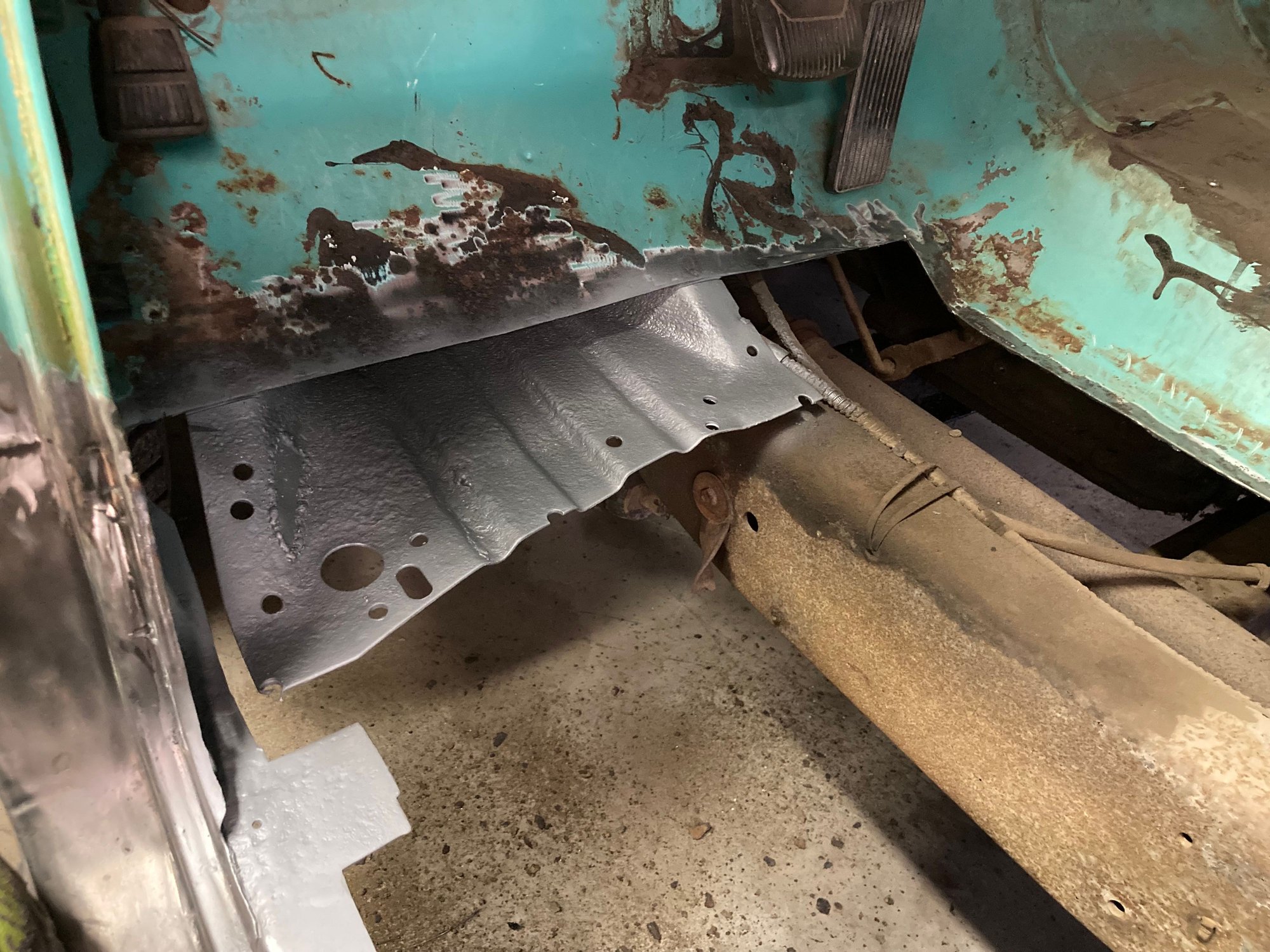

Any spot that has bare metal sealed up or near impossible to get to after welding them together I coat with Weld-Thru Primer first then weld. The cab corners can still be accessed kinda so I will coat them with POR-15 the best I can through the hinge hole.

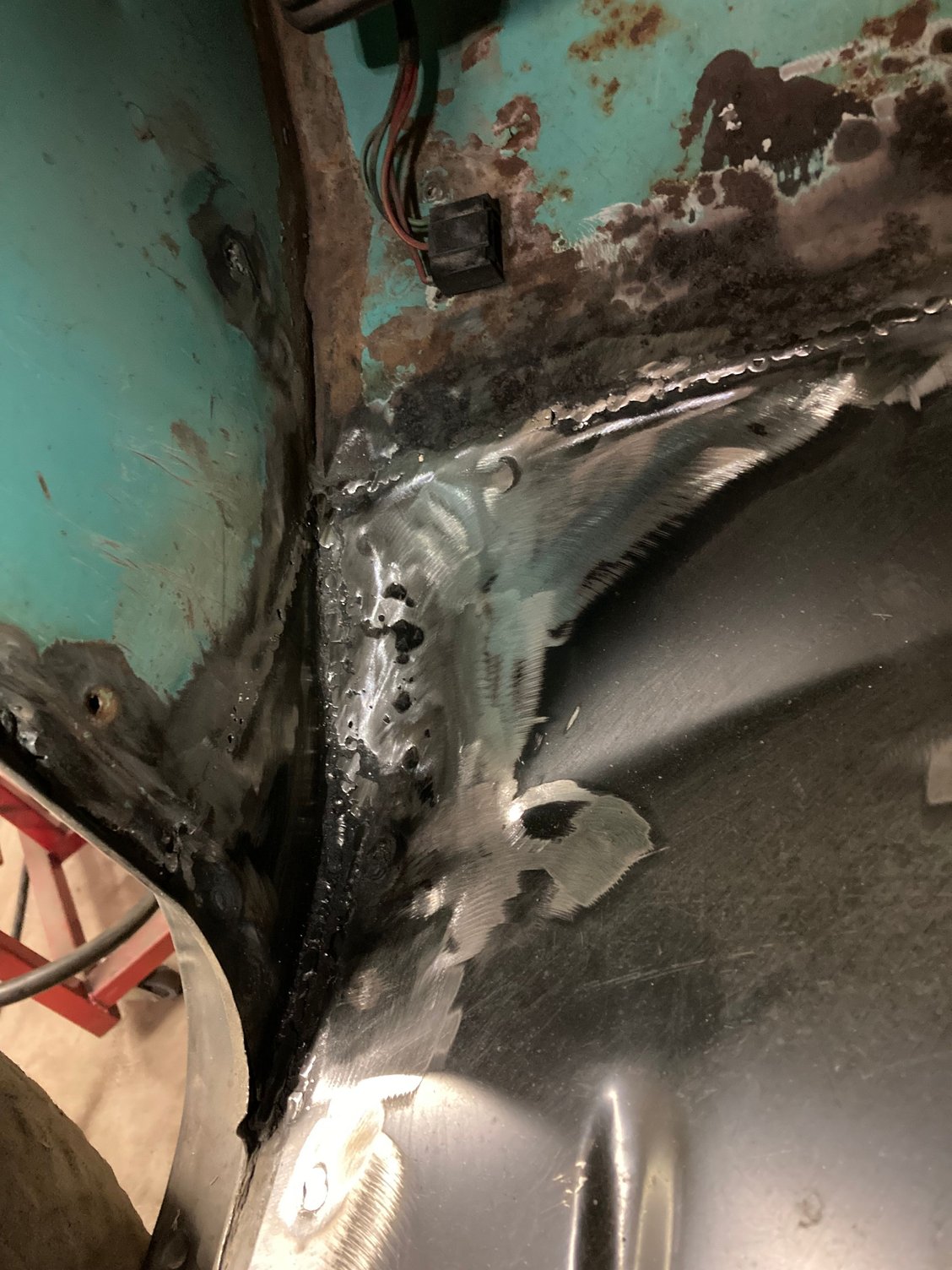

I made up the kick panel patch out of the left over floor pan metal. Lots of trimming later and I got it to fit.
The panel has a sight little curve or curb for the weather stripping to sit against so I pounded that into it an it fit much better. Welded it up but that is not a fun spot to have to weld in. Very cramped and I almost removed the steering wheel after hitting my head/welding helmet so many times.
Nothing to pretty and I have some pin holes to fix but the rust is gone so moving on!
