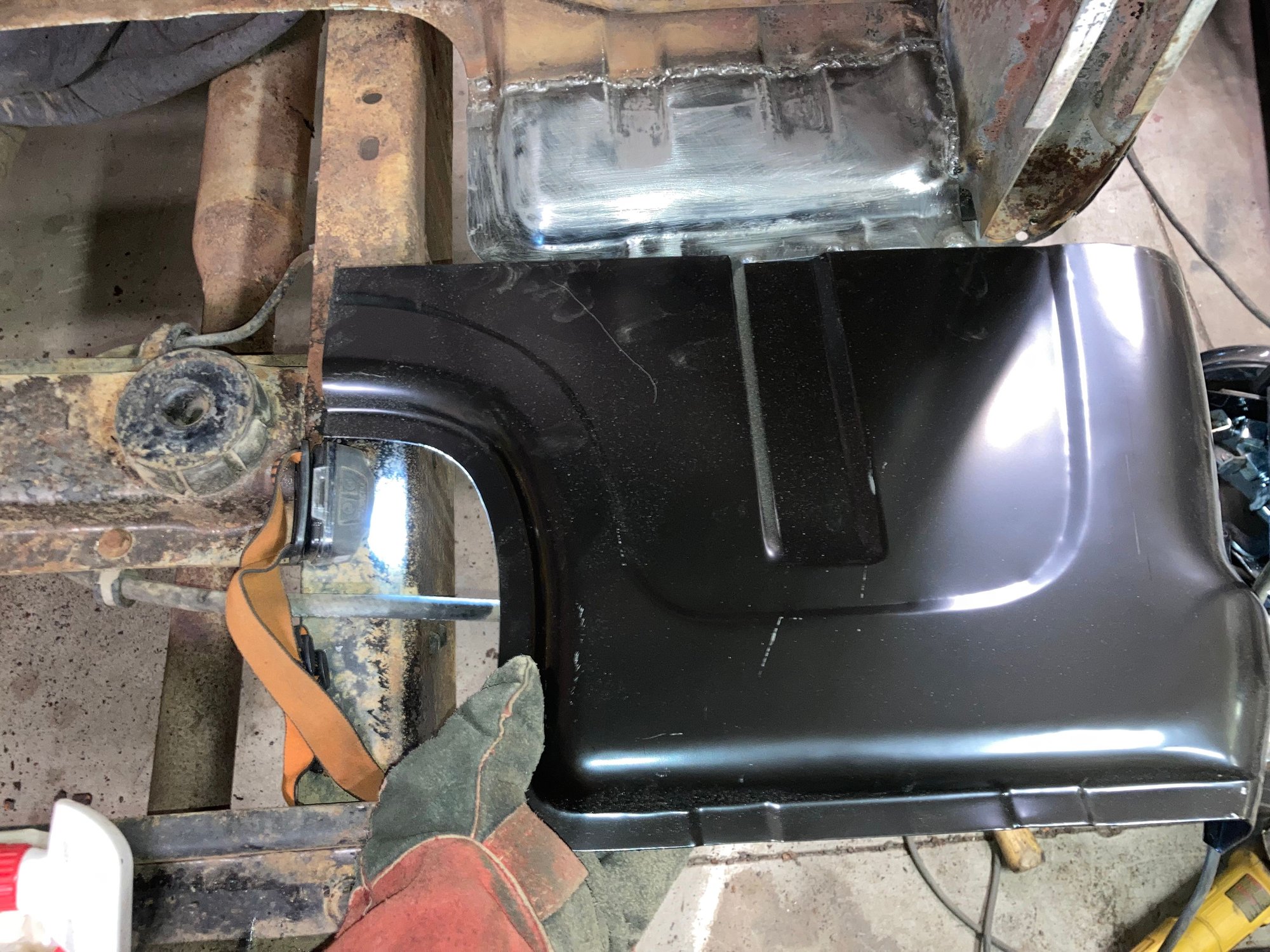

Really nice work on the cab corners. What are you going to do about that inside portion?
Thanks! current plan is to use another outside patch panel and see if I can flip it to the opposite side and trim / hammer to fit.

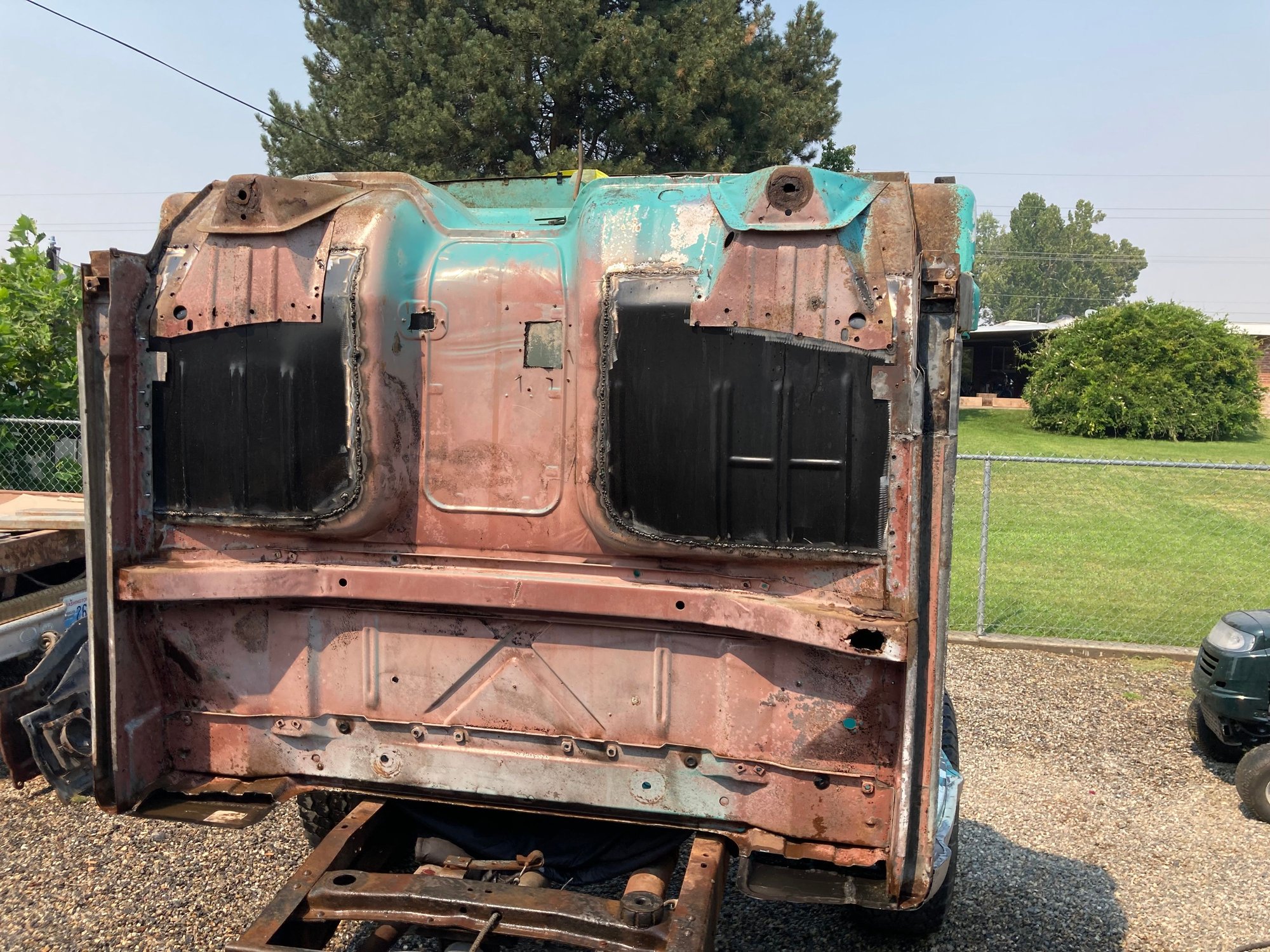

Ran out and pressure washed it on my lunch break (one of the benefits of working from home)
Before
And after...

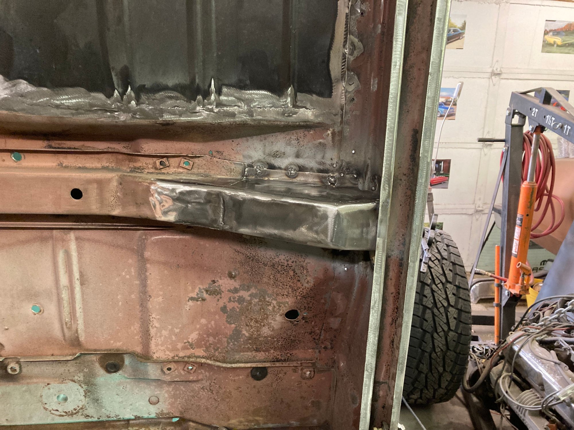

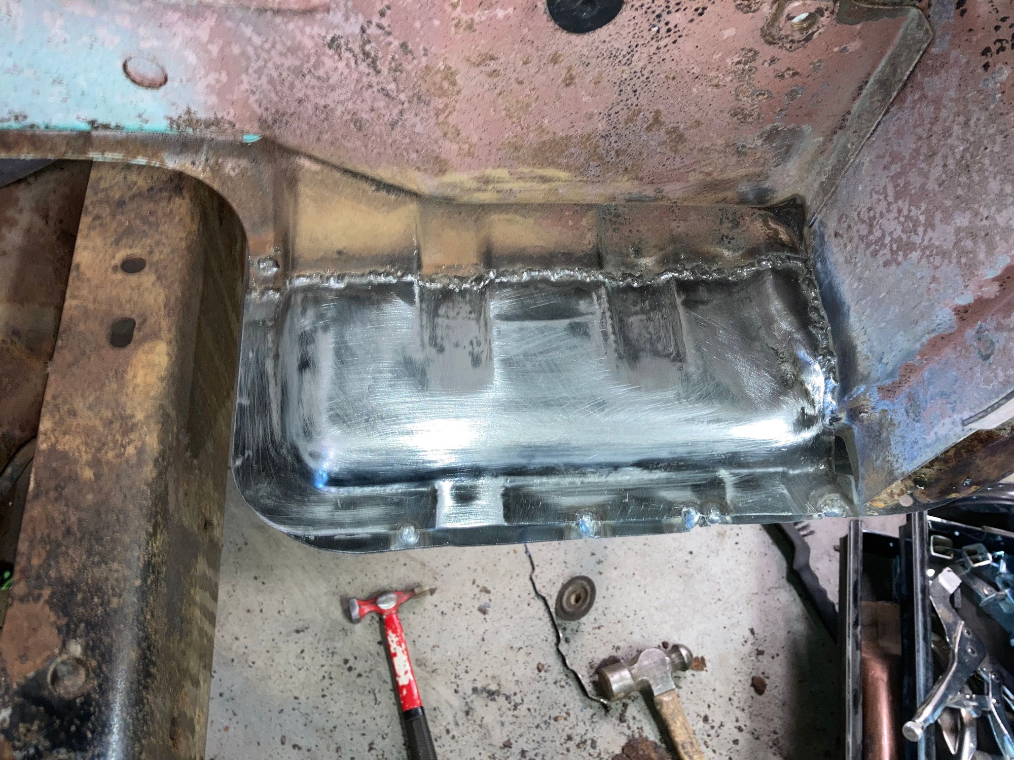

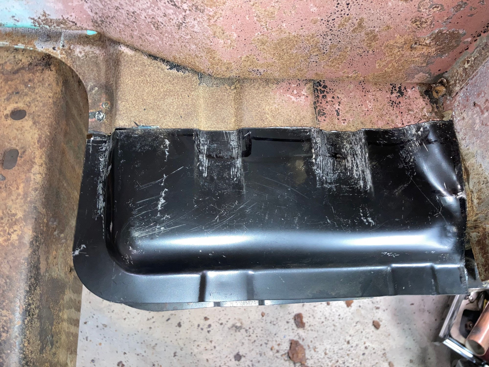

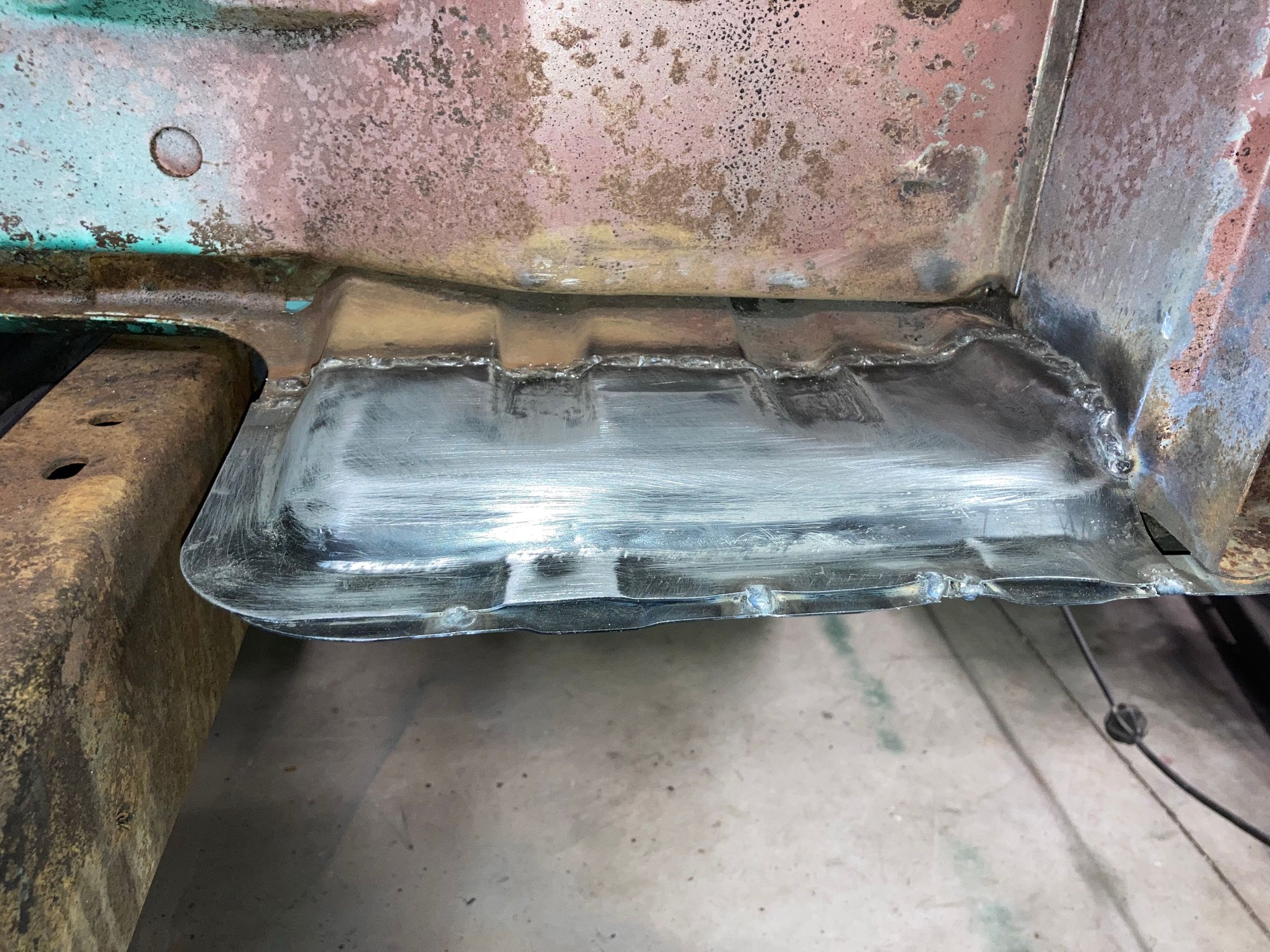

Started on the bottom of the cab this evening. I grabbed the section I cut out of a rear passenger corner patch panel and flipped it to the inside drivers side and started forming it to fit.
As you can see none of the body lines match up.
kept pounding away on it knocking in the body lines slowly working each one.
getting closer each time I bring it back to the cab.
finally happy enough with it to weld it in.
Not too bad considering I started with this...

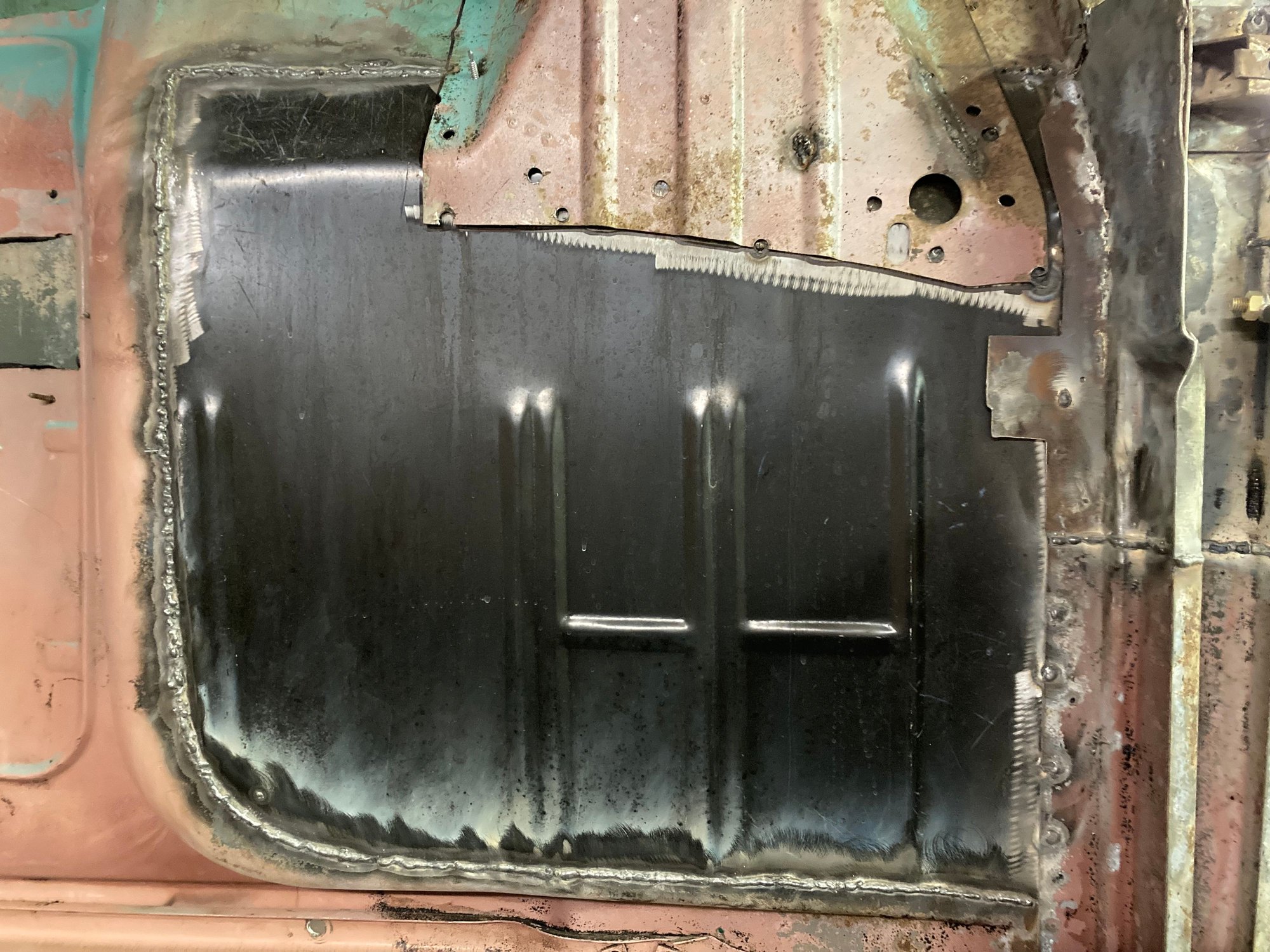

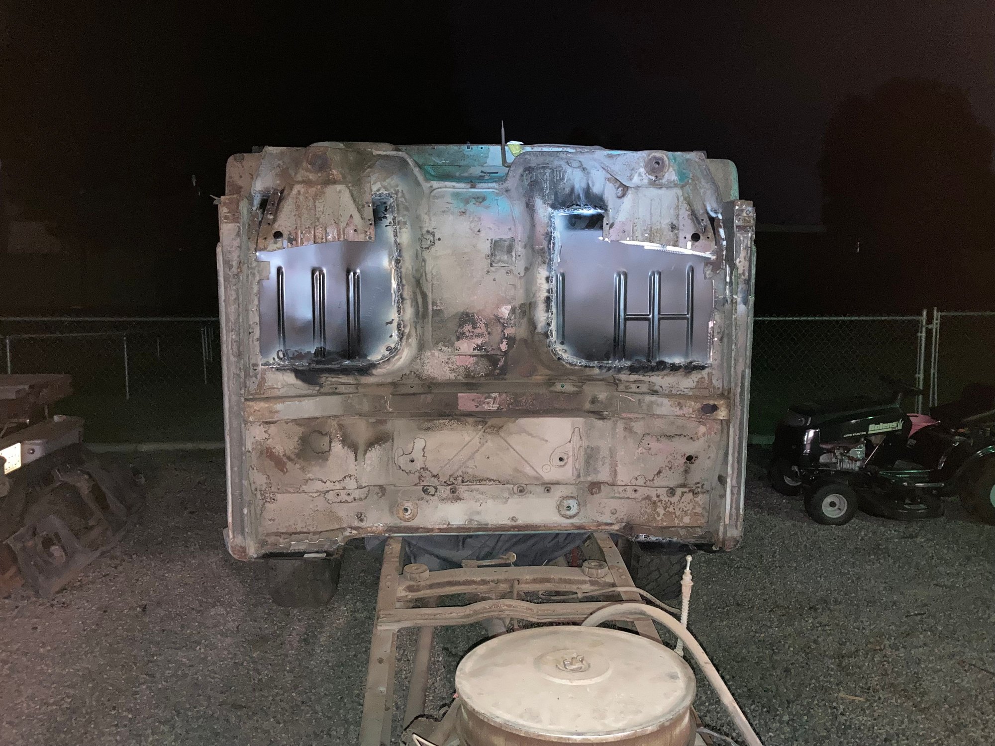

I also continued welding in the floor patches from the bottom... well until I ran out of welding wire. Have to make a trip to the store tomorrow for more.

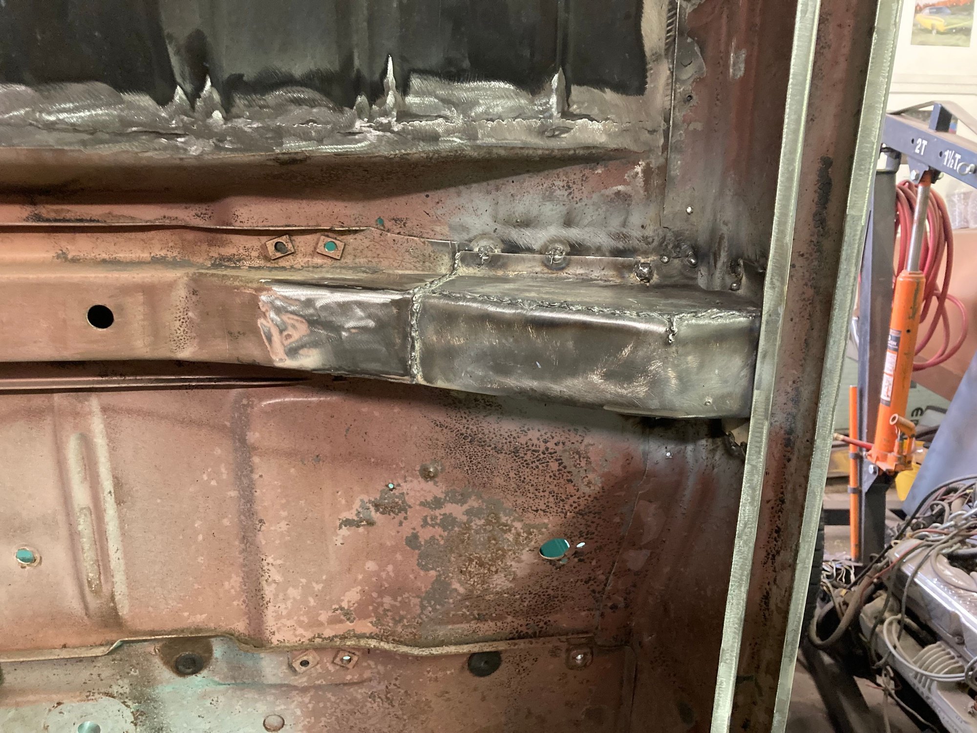

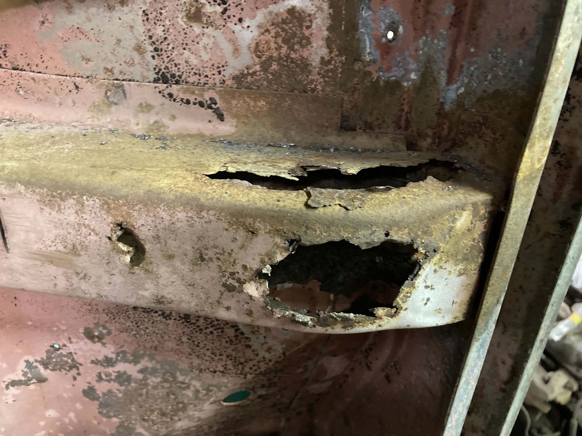

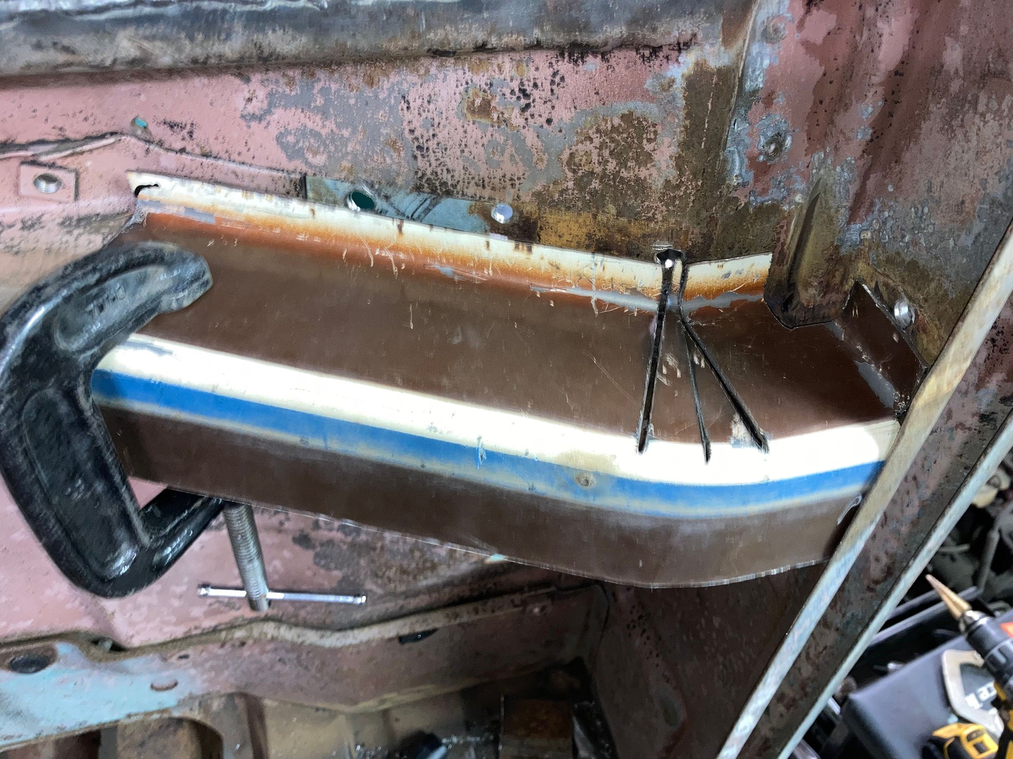

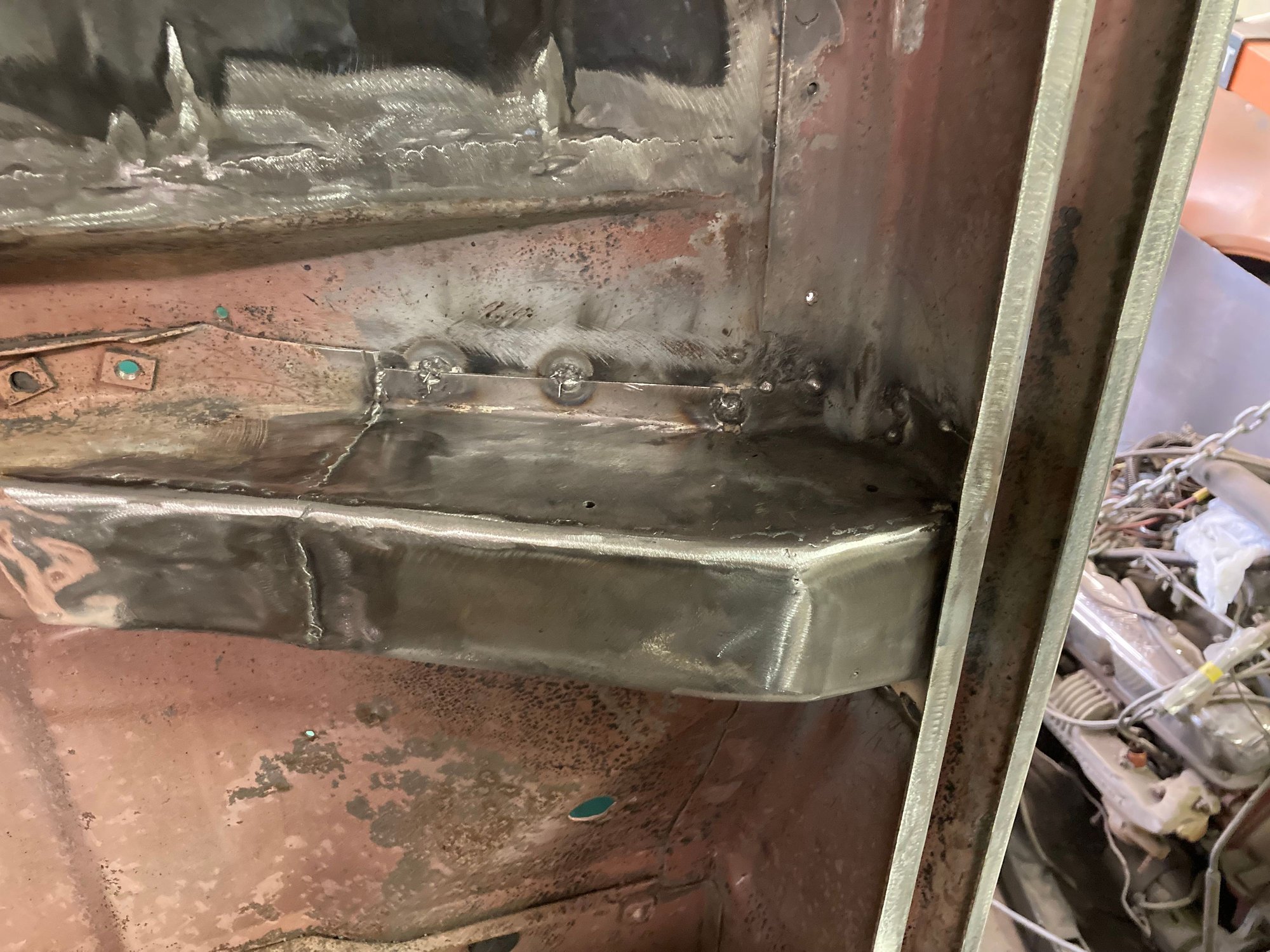

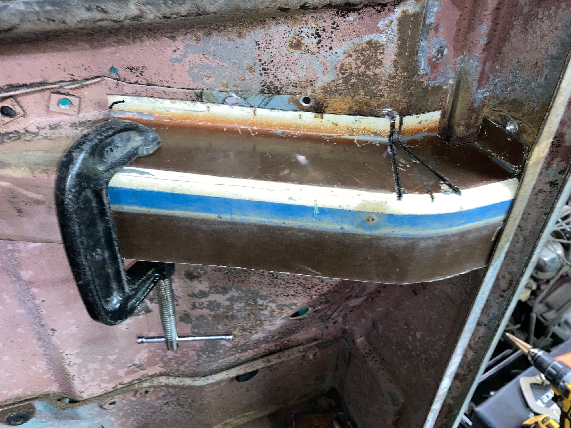

I was going to order the cab support that goes across under the cab but DC was sold out and I also wasn't happy spending another $100 to $200 depending on buying the patches or buying a whole replacement panel and then still having to drill cut and weld it in. I figured have enough scrap metal laying around that I could probably come up with something. So here is my rough start to a patch panel...

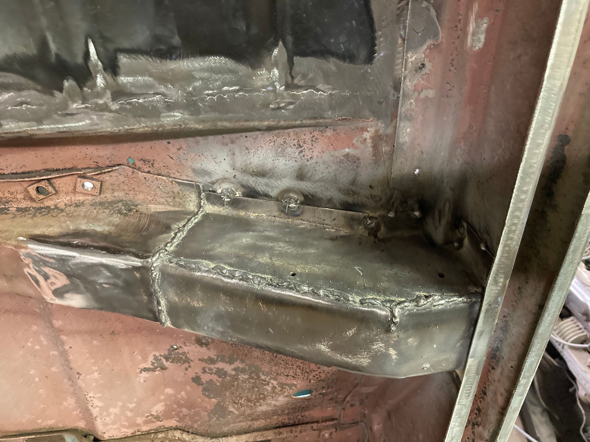

Did a bunch of grinding today on all the floor welds and other areas so nothing too exciting, I was able to finish up the crossmember on the drivers side so that's nice to have done now.
Floor pan all cleaned up and starting to look like part of the truck...
Crossmember welded in
ground it smooth
Not too bad for a scrap chunk of sheet metal from a tailgate... (Ford tailgate as well )
