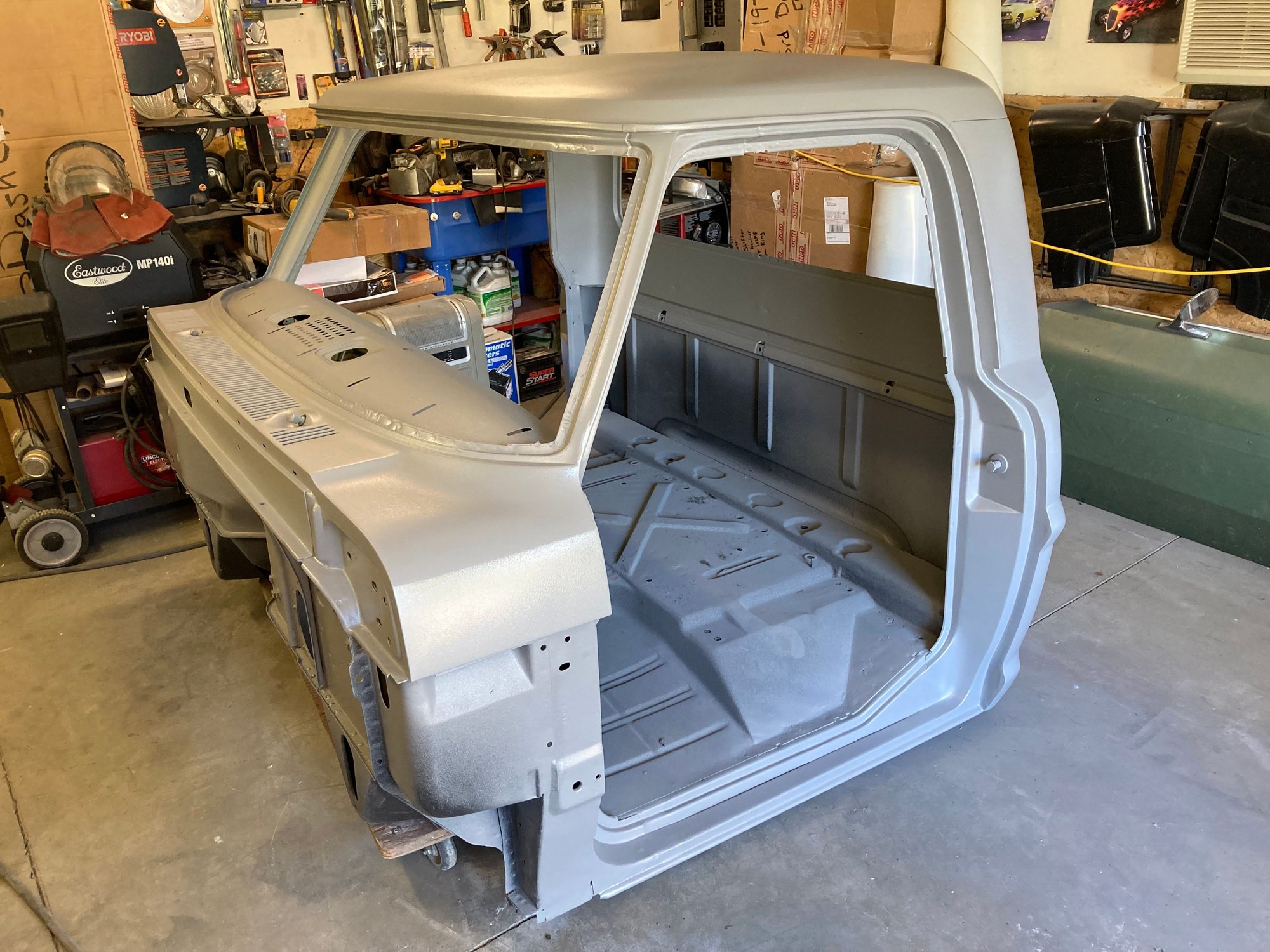

Yesterday was my wife's birthday so no work on the project. (a perfectly cleaned house and took her out for dinner was my day... )
Today I made the trip to the paint supply store and picked up a few supplies including a gallon of epoxy primer. Came home and started sanding out the inside of the cab. I was very surprised by all the paint runs in the original paint that I never noticed until sanding inside the cab. Funny how much the factory was able to get away with. Anyway I was able to sand out the entire cab this afternoon and wipe it down with wax and grease remover. I'll hit it again tomorrow with another wipe down and then a tack cloth before spraying my first coats of epoxy primer.

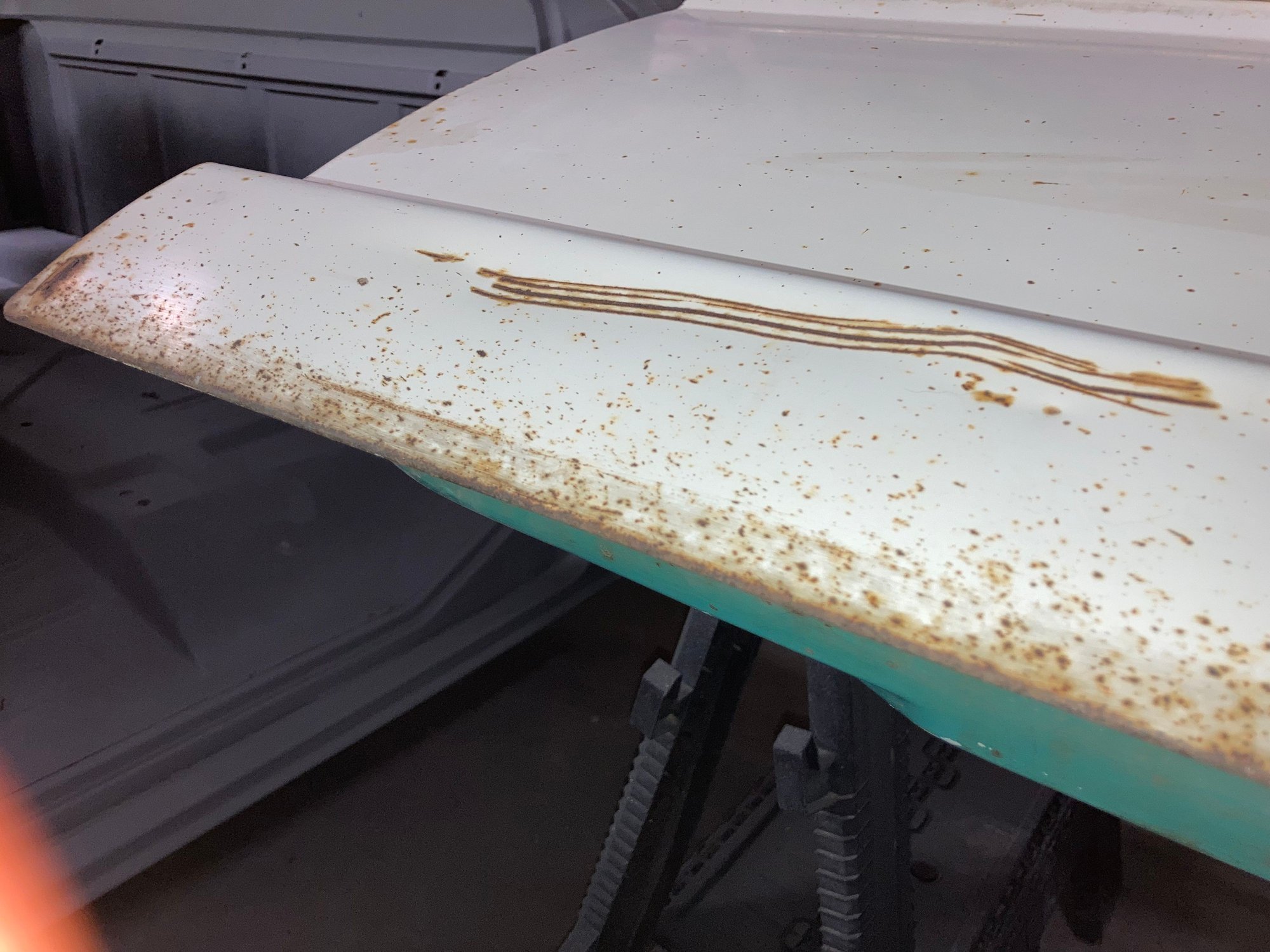

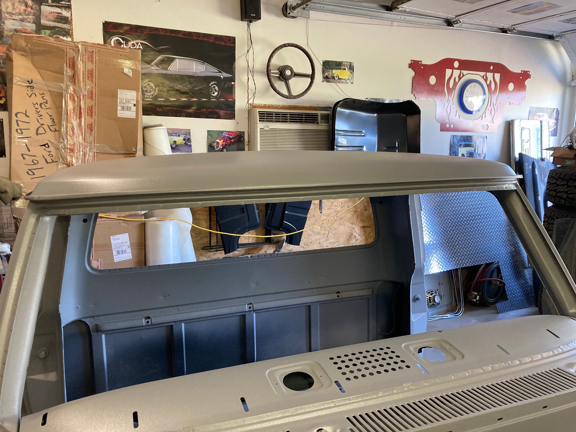

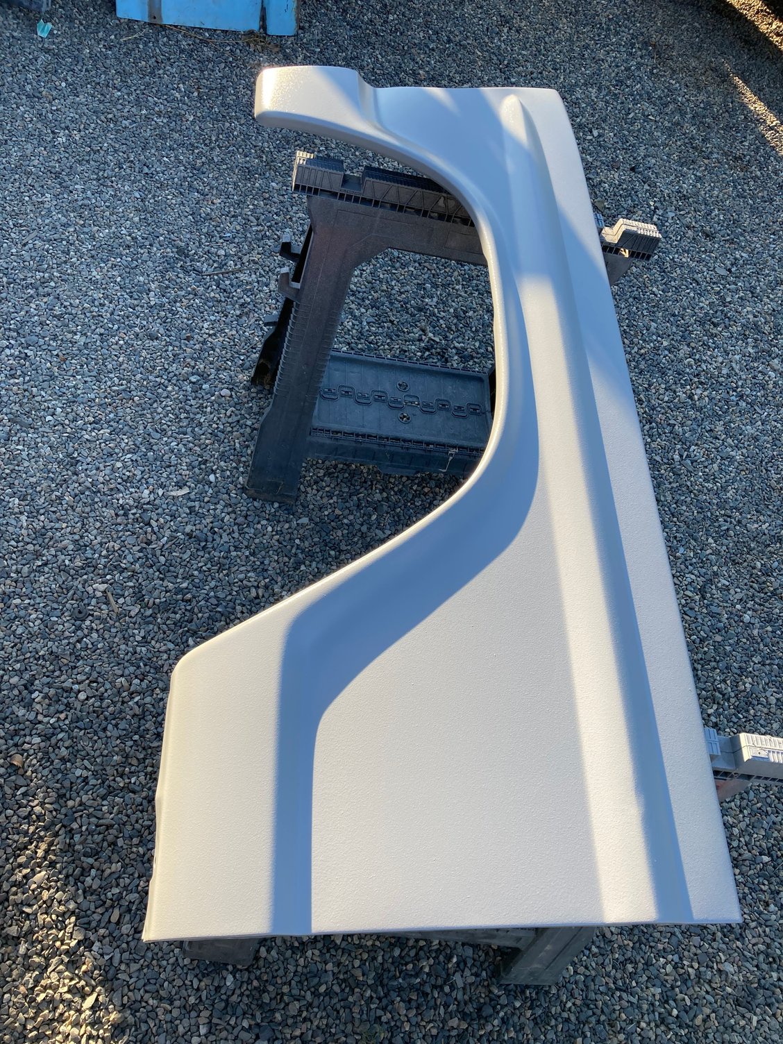

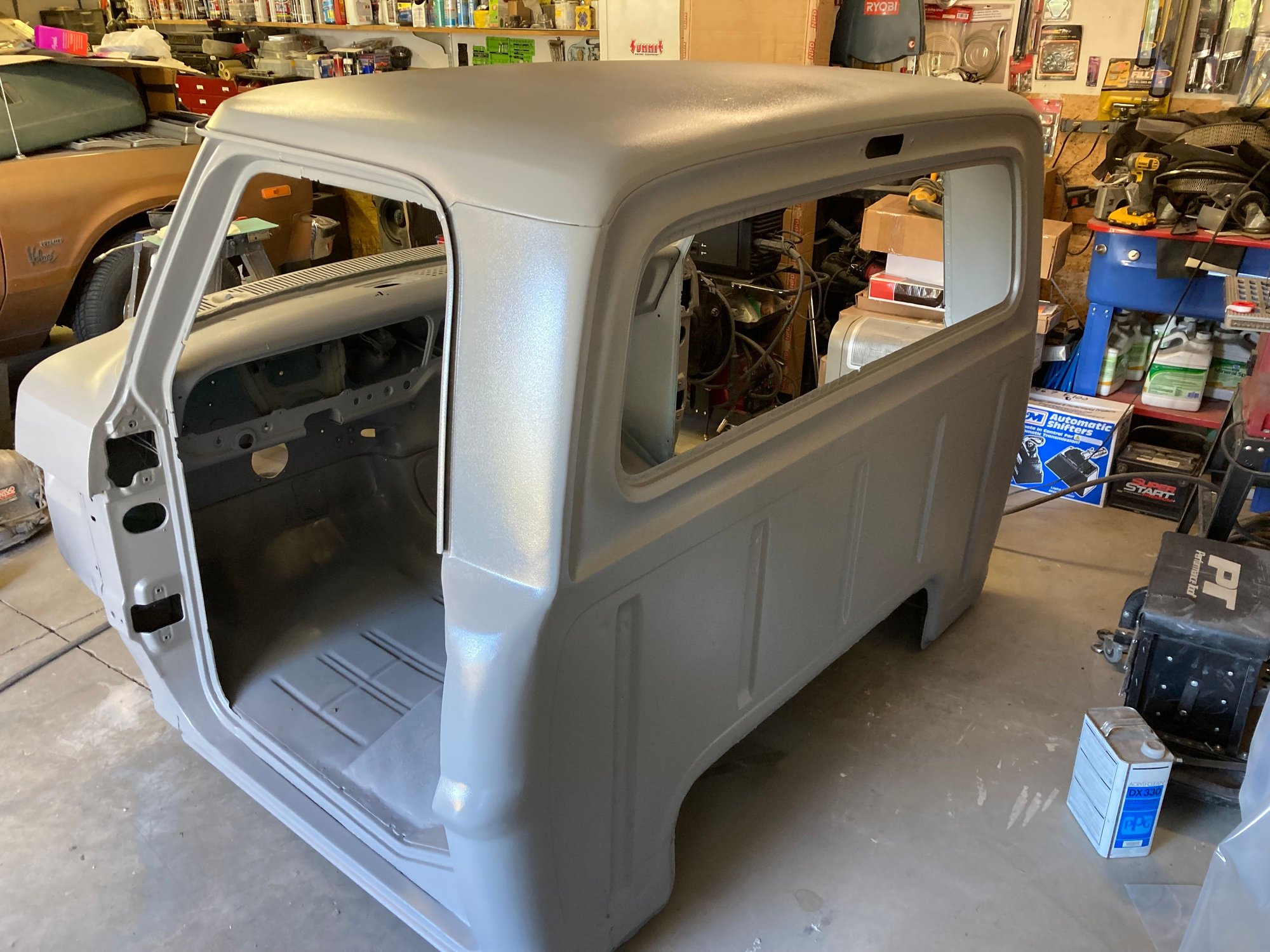

Cleaned the cab again with wax & grease remover then wiped it down with a tack cloth. Sprayed 3 coats of epoxy primer inside and out...
Set up both fenders and one inner fender outside and sprayed them as well.
With a solid coat on everything I can see some spots that will need more attention but I feel a lot better with a number of the parts sealed up and protected.

That's awesome!! Nice work.

That truck is going to look better than new when you’re done. Very nice!

It really changes with the application of primer. Being all one even color shows off your prep, nice job!

Thanks! yeah I'm so glad to have it in this stage, there are a few spots that don't show up in the pictures but over all I'm happy with the prep.

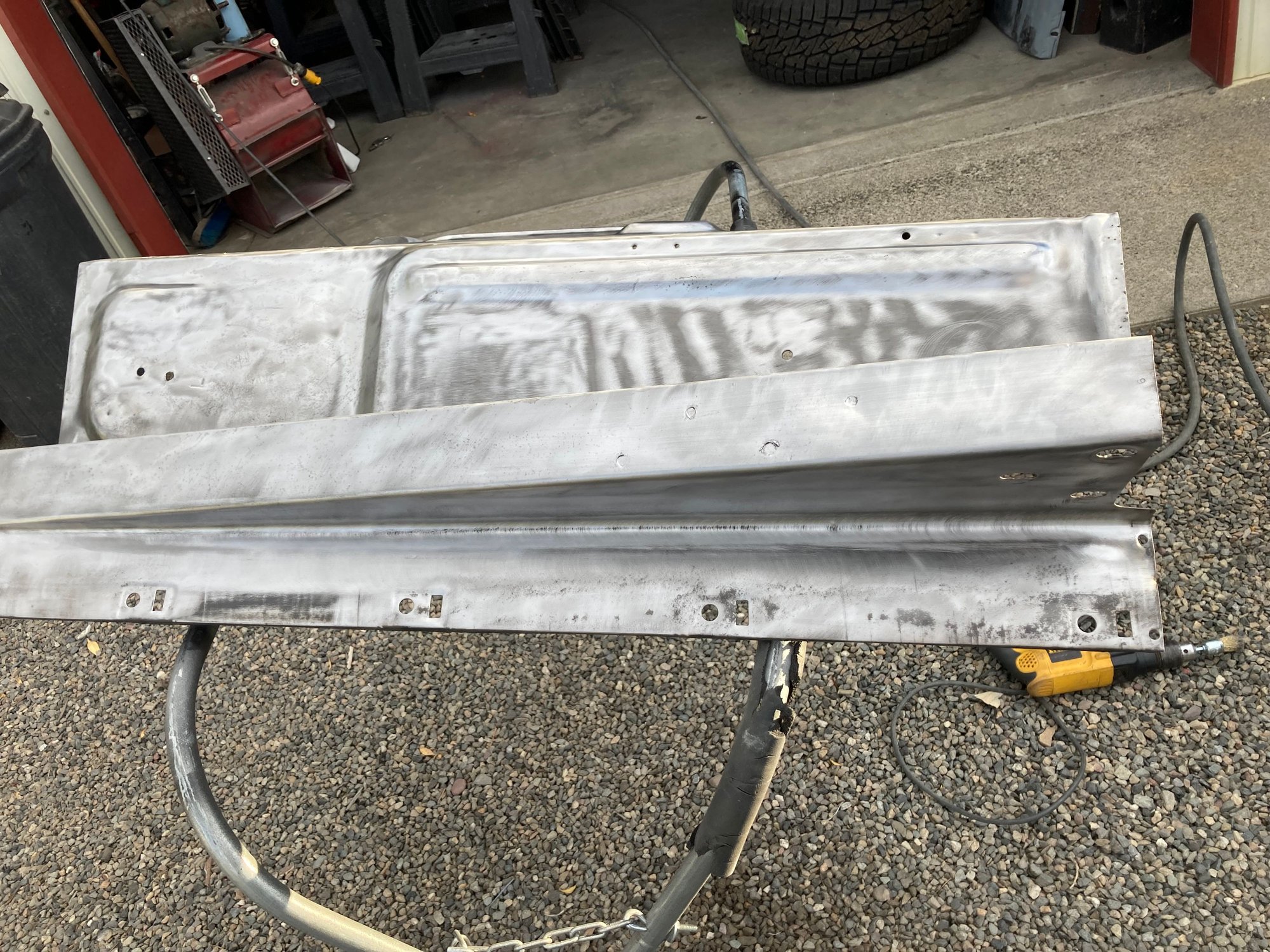

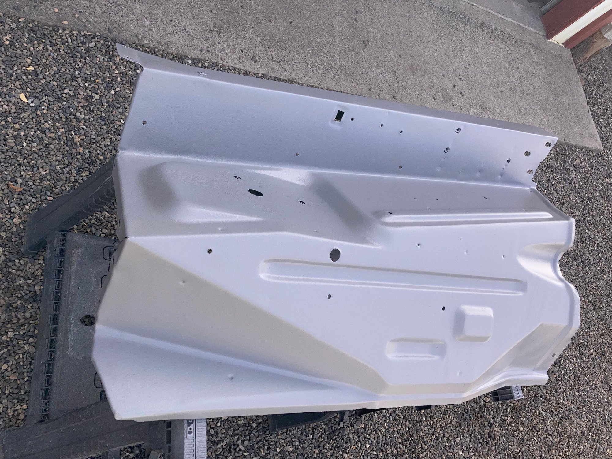

I was hoping to scuff the other inner fender and spray it but the old paint wouldn't feather out, it just kept flaking when I tried to sand it. So I stripped it down to bare metal...

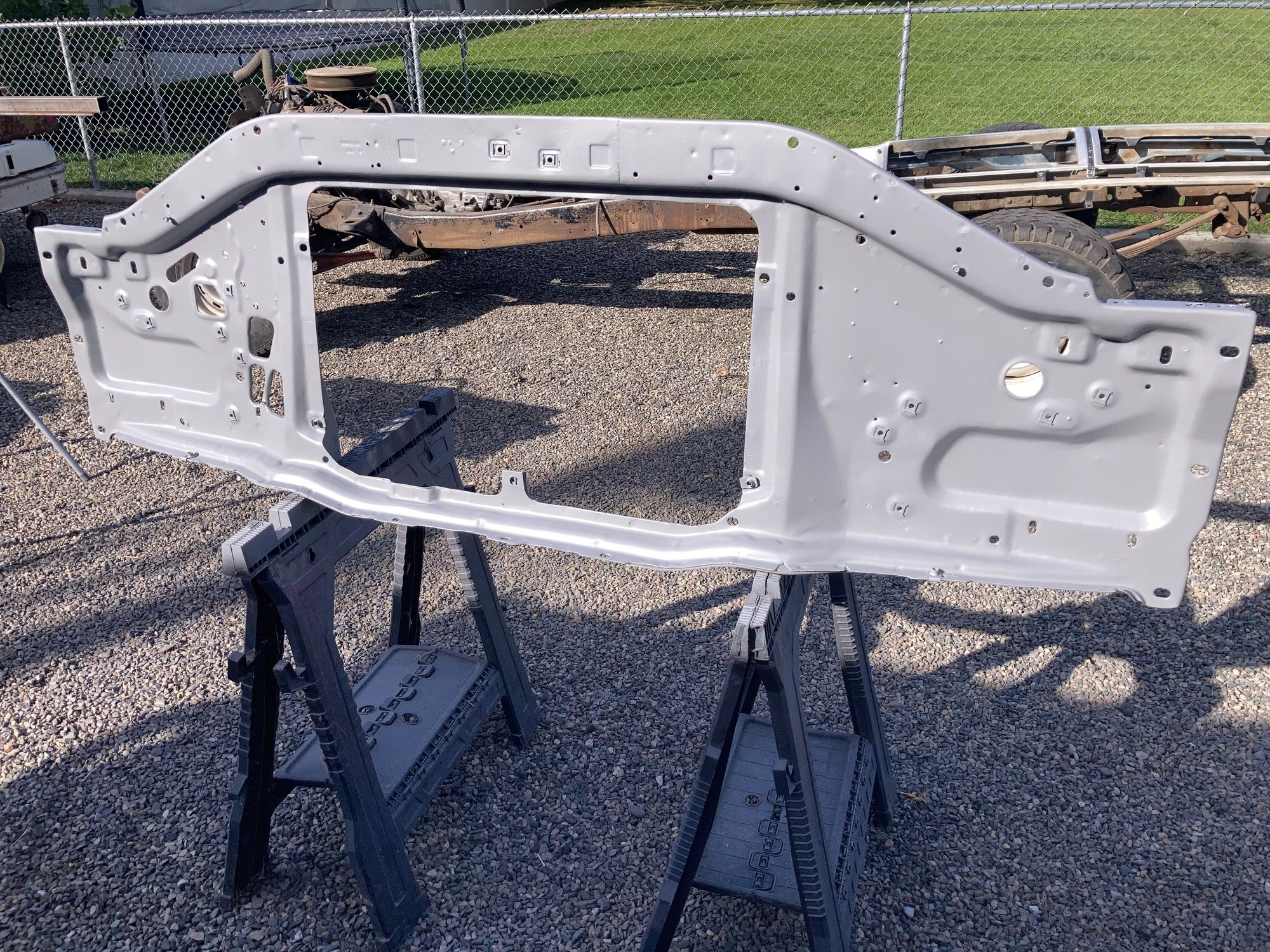

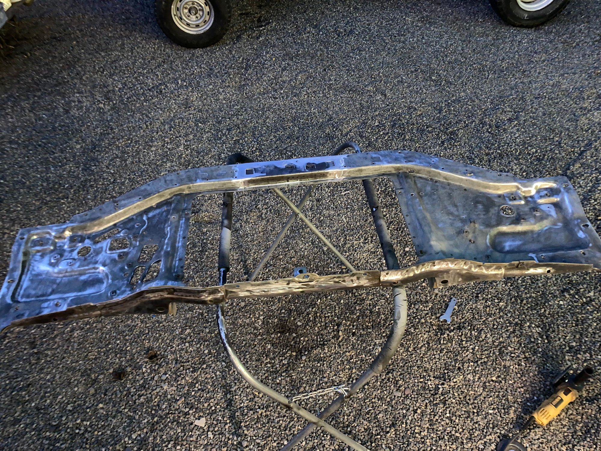

Happy to see that it's extremely solid and rust free. Also continued working on the radiator core support. Ground down the welds and also stripped the paint front and back

Wow, those inner fenders look amazing! I also have to say the core support came out really good.

yeah I'm happy with them and even happier they are now all now in epoxy primer...
core support still needs some body work around the welded in section but I'll get that done eventually.

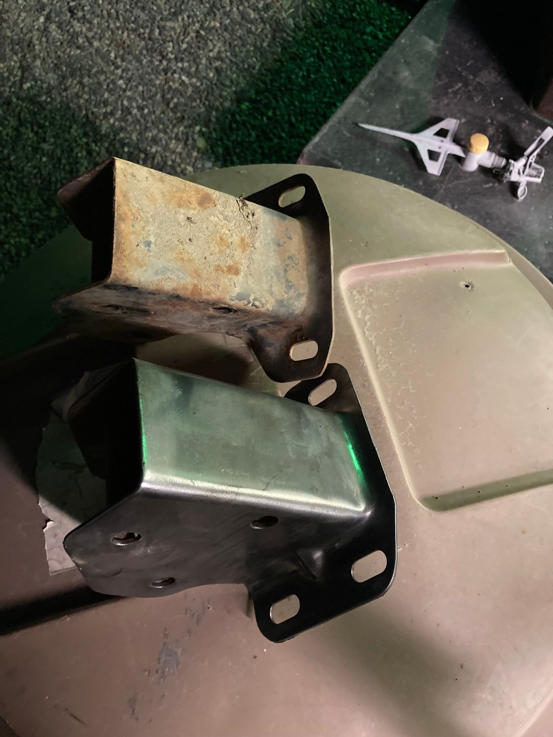

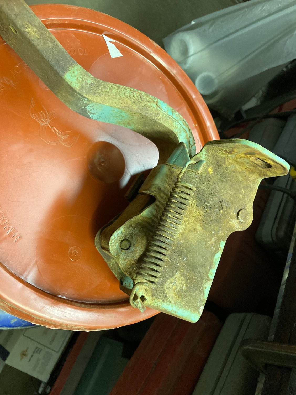

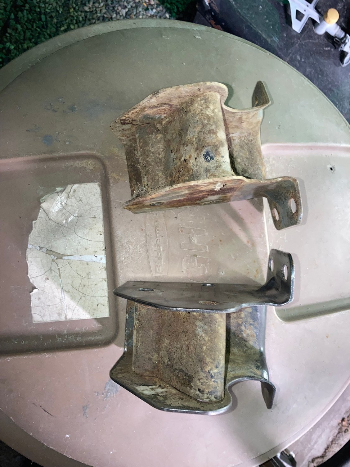

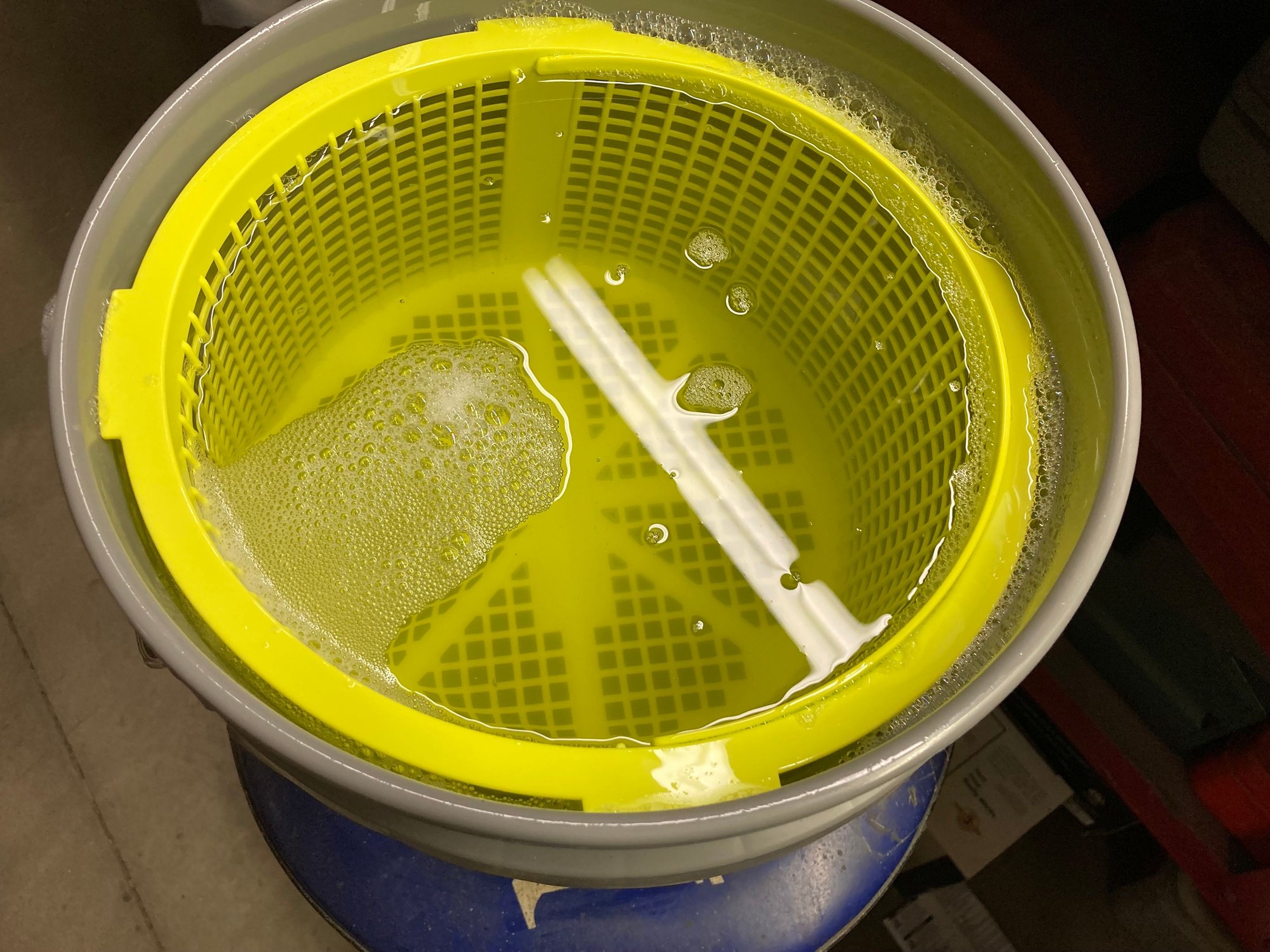

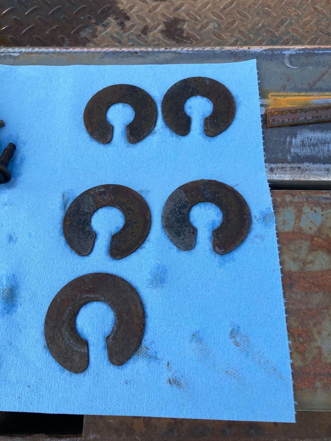

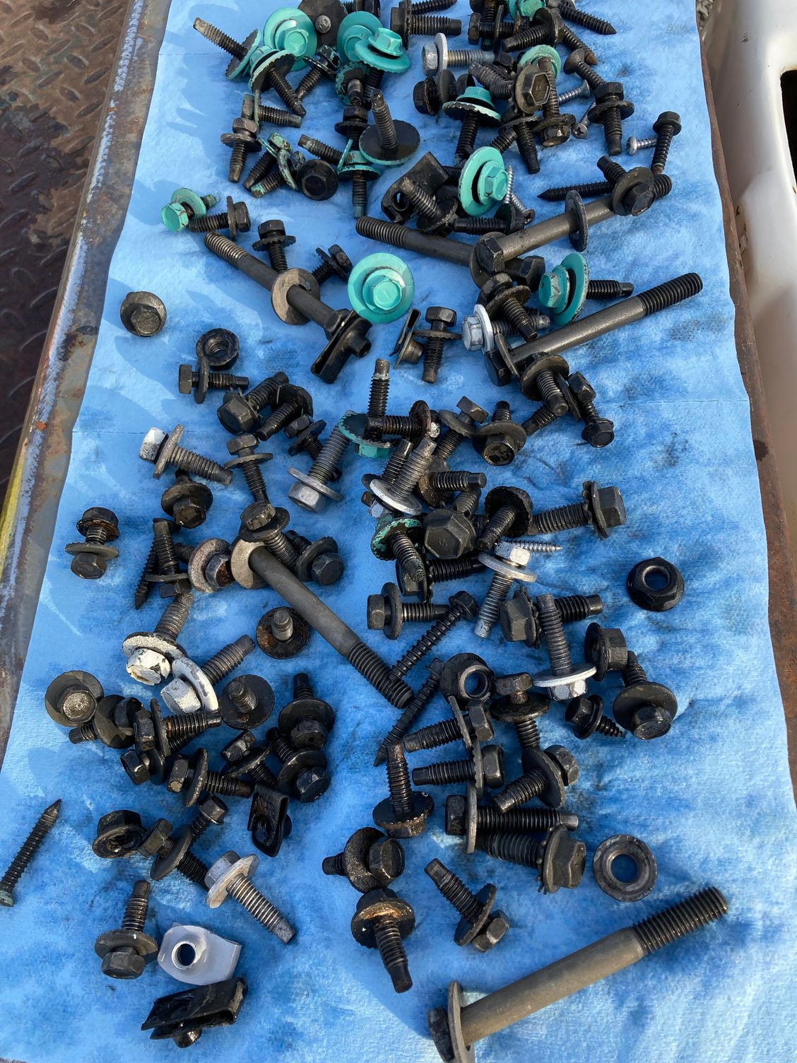

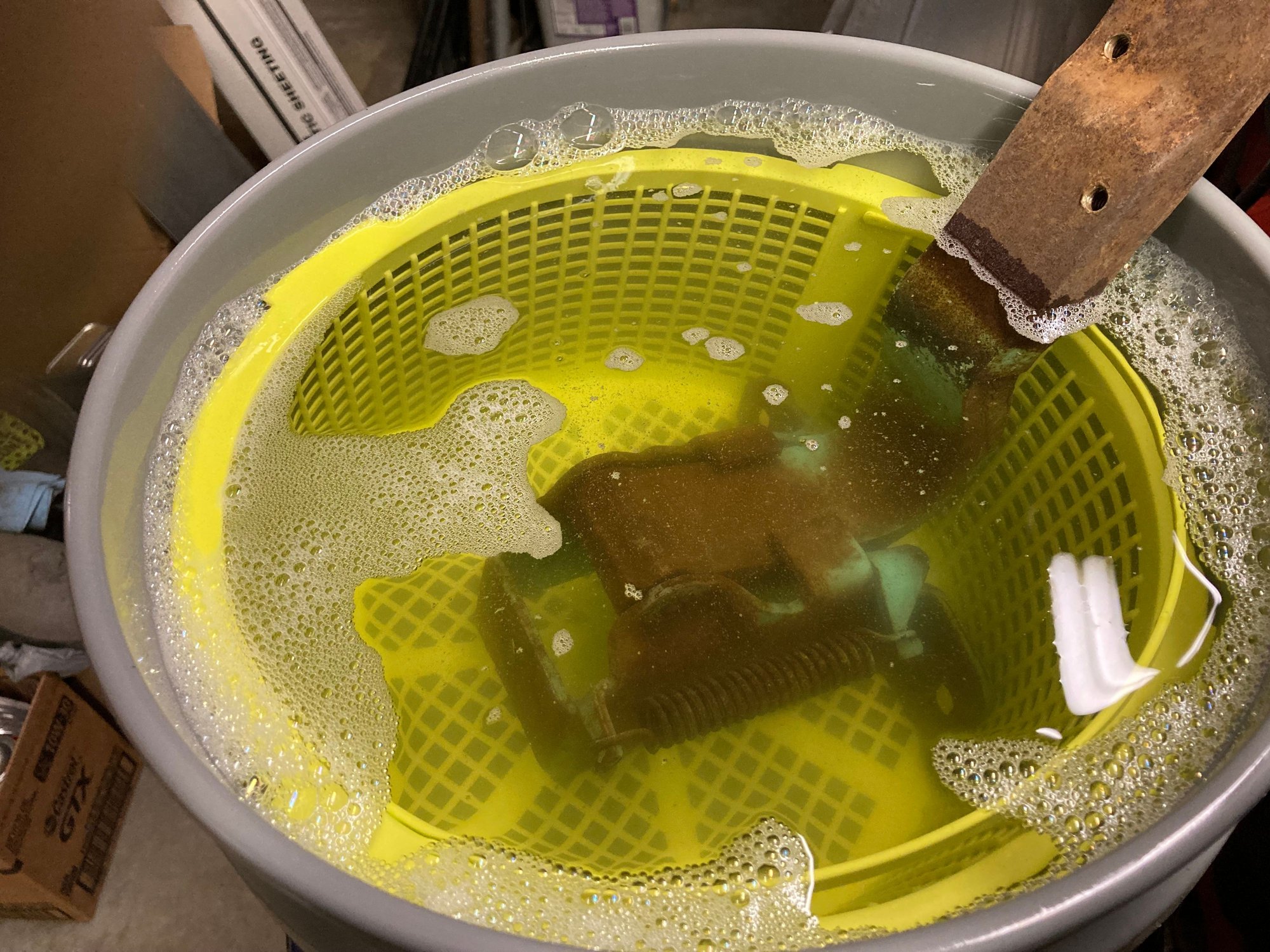

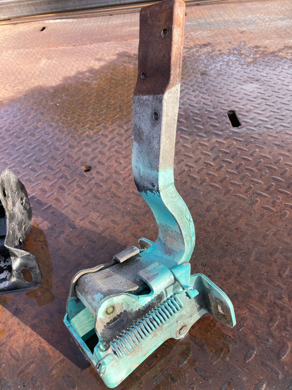

I've heard good things about this rust product so I ordered a 3.5 gallon bucket of Evapo-Rust. It showed up yesterday so I figured I'd try some parts in it over night. I put everything in about 7pm last night and pulled them back out at 8am this morning and I have to say I'm impressed.
This morning
I love this shot because there is a clear line where it was sticking out of the bucket and how much different it is.
These spacer washers are about the only thing that didn't change so I dropped them back in and will check them this afternoon.

When I consider how many of those pesky wire wheel bits I've had to pull outta the front of my body that method is looking increasingly tantalizing Wish they made one big enough to throw a truck in.
This is exactly the reason plus all the hours and the aching back from hunching over the bench grinder... I was able to do all those parts in my sleep... literally
