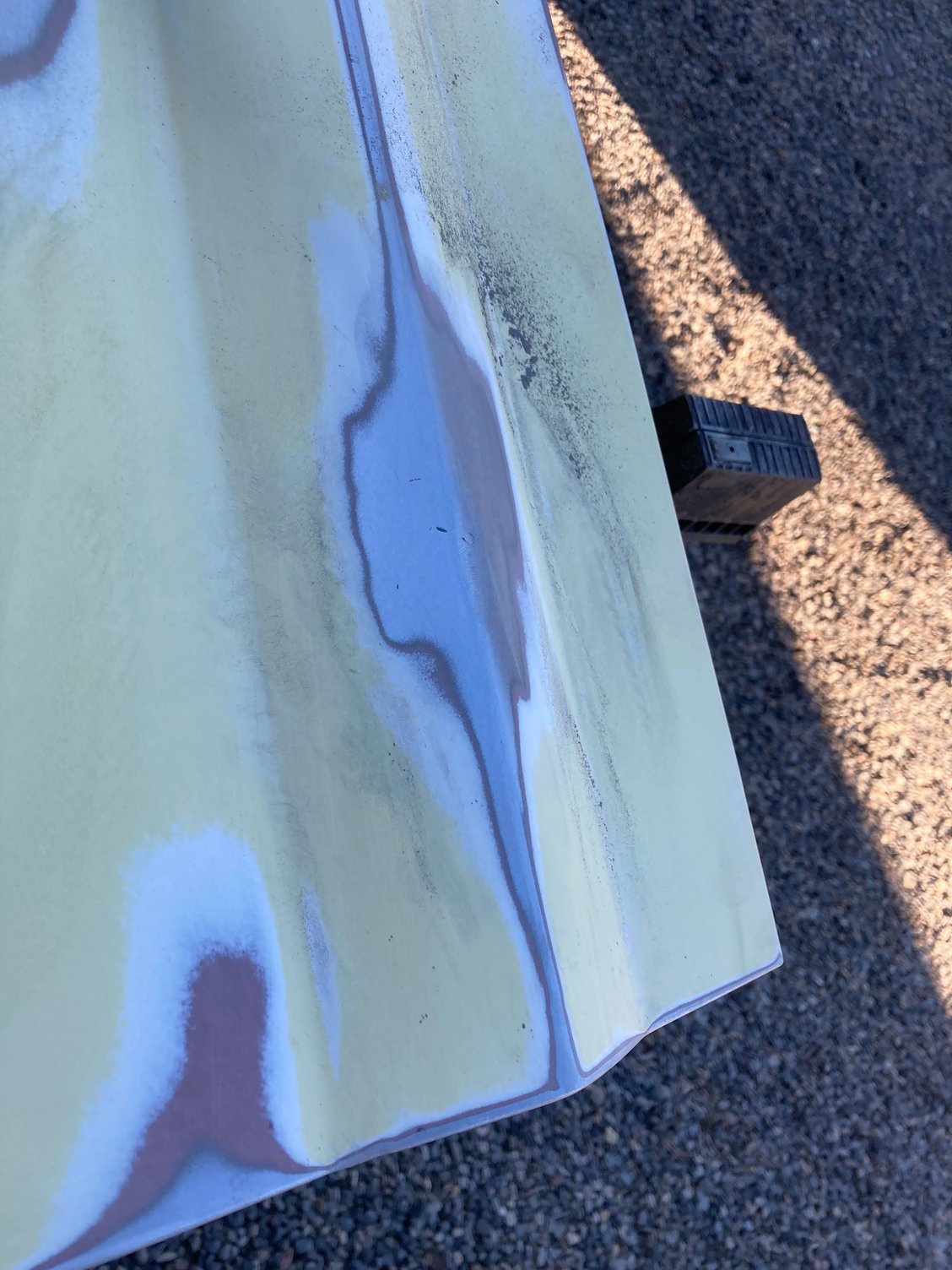

Hit it again tonight and was able to nock down all the high spots with 36 grit and followed that up with 80 grit. Sprayed 2 heavy coats of high build primer and then bailed as that stuff is nasty. I'll give it an hour to dry and to also air out the shop. Then I'll get after it with 220 grit.

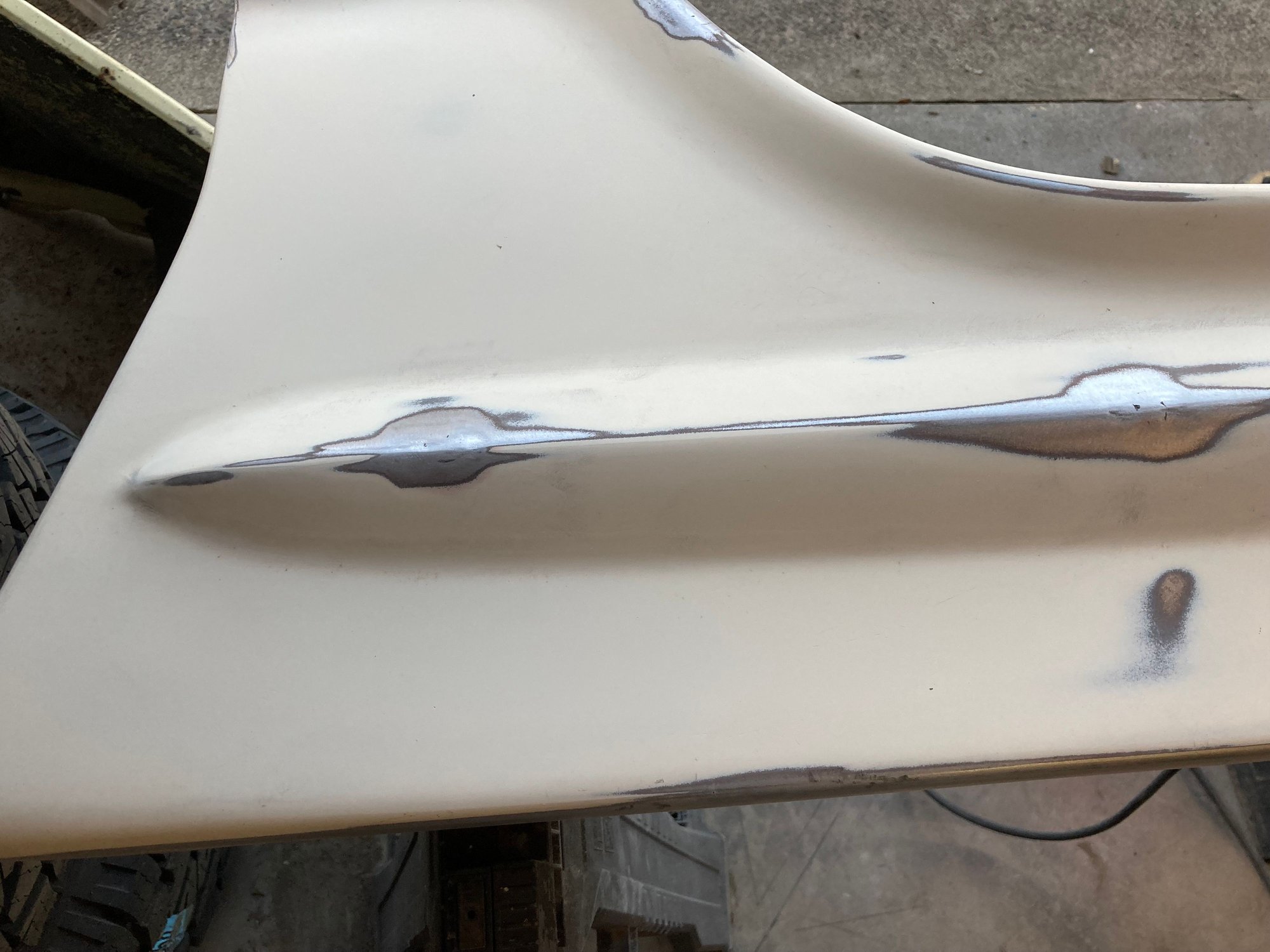

Had a number of things this past week that needed my attention so I only was able to work in short burst each day. Mostly block sanding filler off the cab and reapplying more and then sanding it back down. Starting to burn out on blocking out the cab so I switched it up a bit this weekend and pulled out my good fenders and inner fenders and started working on them. I was going to repair the rusty fenders that came with the truck but in the interest of saving time I'll leave those for another project and use my good ones for this project.
Started by sanding out scratches and small dings in the paint on the passenger fender and also prepping the trim holes to be welded up. Only found one small dent on the wheel well lip
Welded up the trim holes and ground them smooth.
hammered out the small dent on the fender lip and feathered out the sanded paint a bit more.

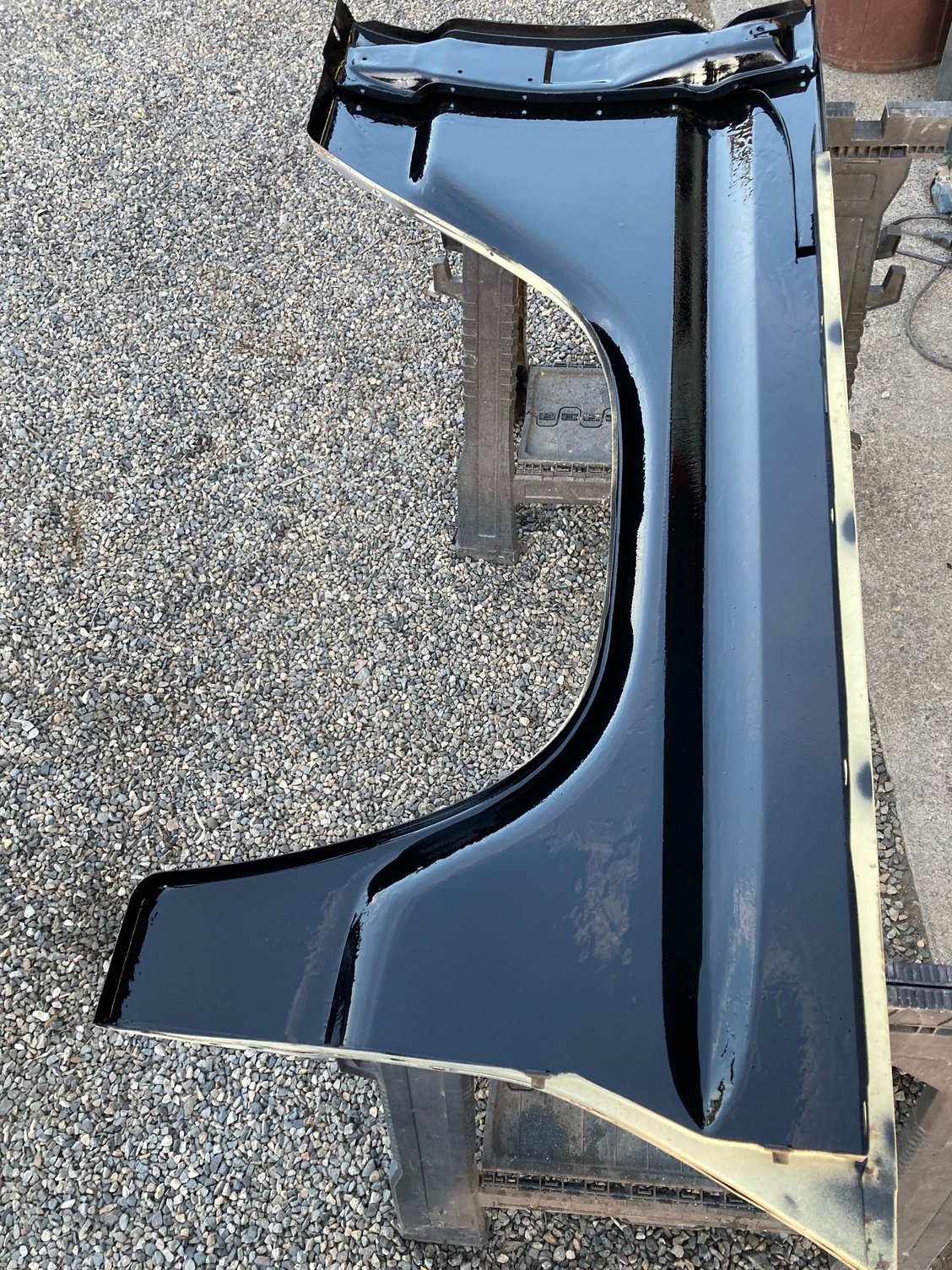

stripped all the old undercoating off the back of the fender
Then hit it with 3 coats of bed liner coating.

flipped the fender over and stripped the backside and then hit it with 3 coats of bed liner as well.

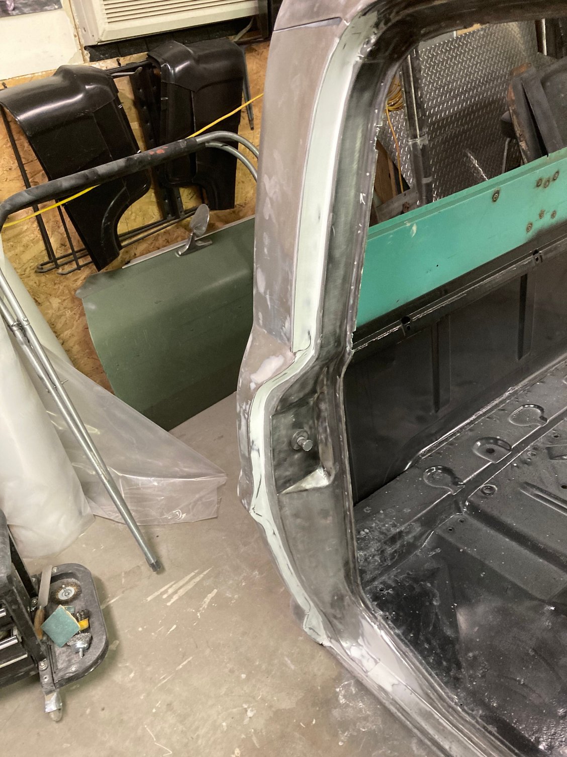

I went back to sanding on the cab and I'm happy to say that it's finally ready to coat it with epoxy primer. I've sanded and worked over the roof for as long as I can and it finally feels level and smooth when I run my palm over it. I'll continue with a guide coat and more sanding after the epoxy primer goes on to see if it truly is smooth.

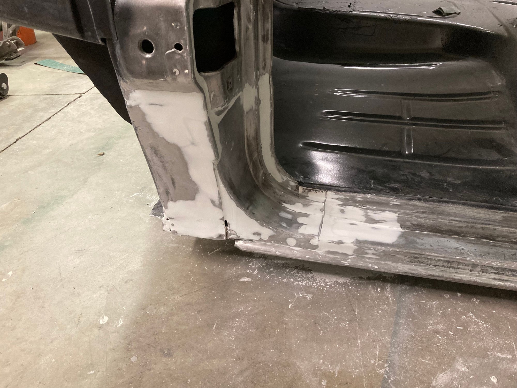

I also worked on smoothing out the cab corner repair and blending it into the door frame.
Before...
After...
Smoothed out both door jams...
