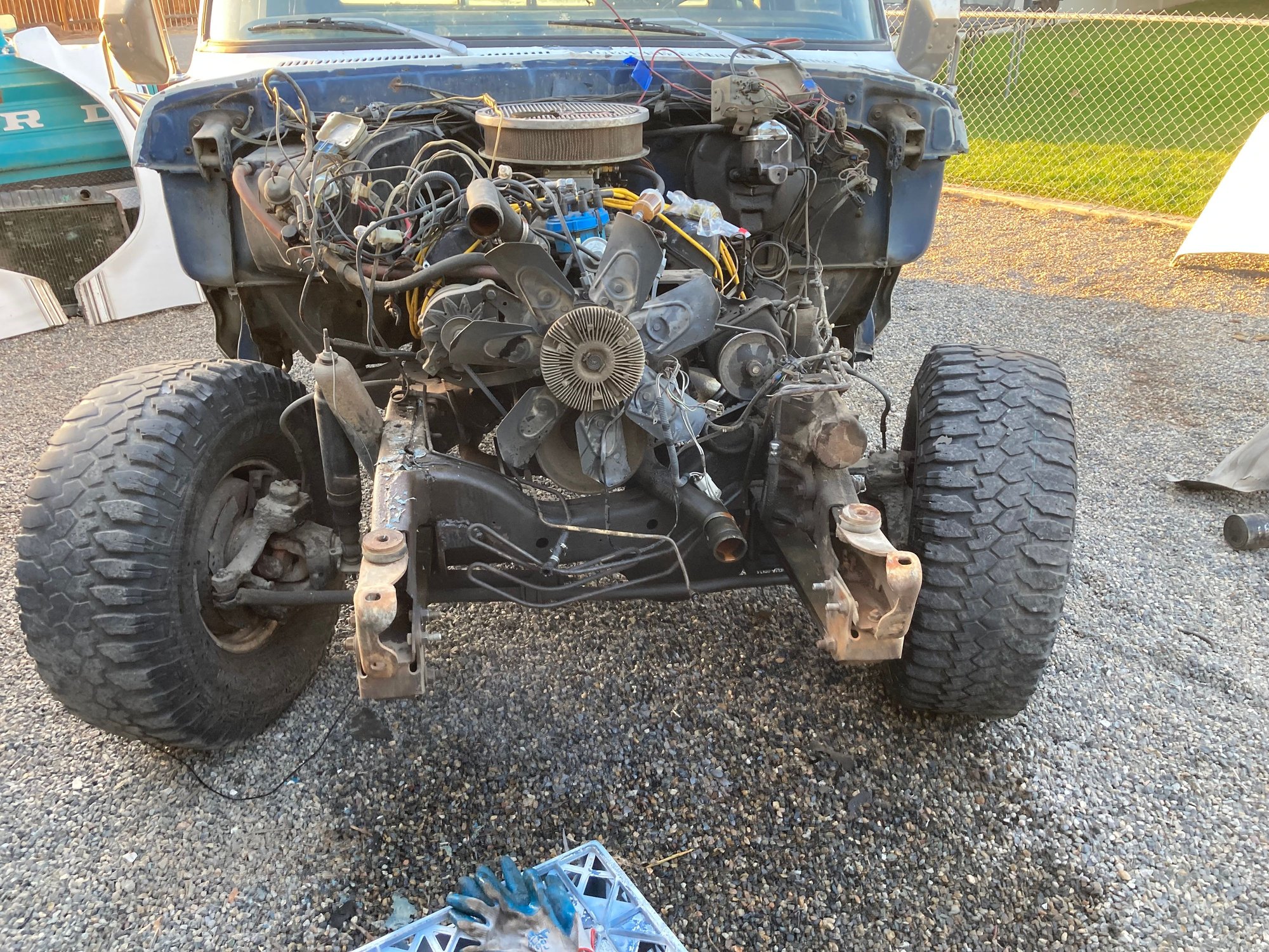

Time to pay some bills... Ford buddy brought over this truck for some new gaskets and an engine compartment clean up and detail (new paint, hoses, untangling a wiring rats nest, ect) Also needs all the exterior trim removed as it's heading to the paint shop after I'm done with it. So this will bring in some extra $$$ for the projects.

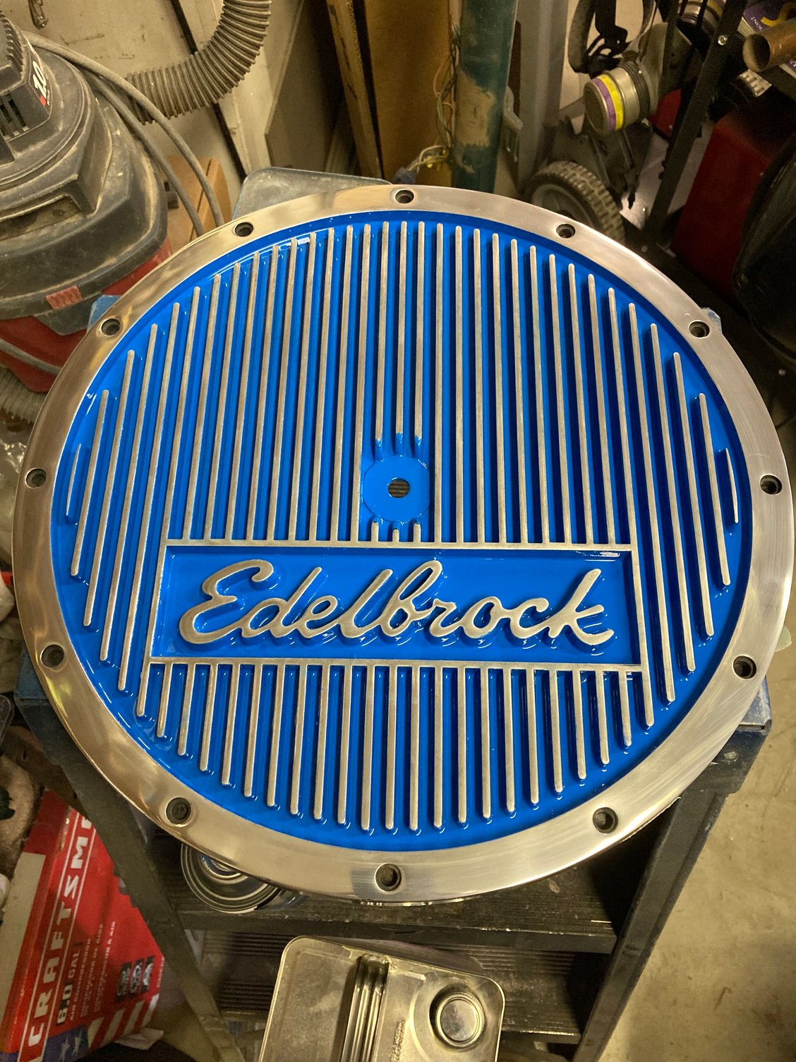

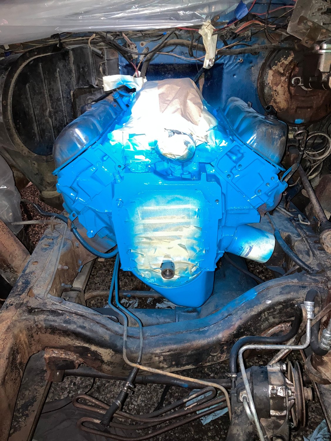

Quick update... Still working on the 78 ford, there have been a number of delays with incorrect parts showing up and a week of cleaning and degreasing whenever the rain will let me. New timing chain, oil pan gasket, oil change and new filter, new water pump, new valve covers and gaskets are also on the list. The owner wanted everything but the engine painted black. He's planning a lift for the truck as well so all the suspension was just blacked out for now...
The owner wanted to keep the Edelbrock air cleaner so I polished it and painted it to match the engine.

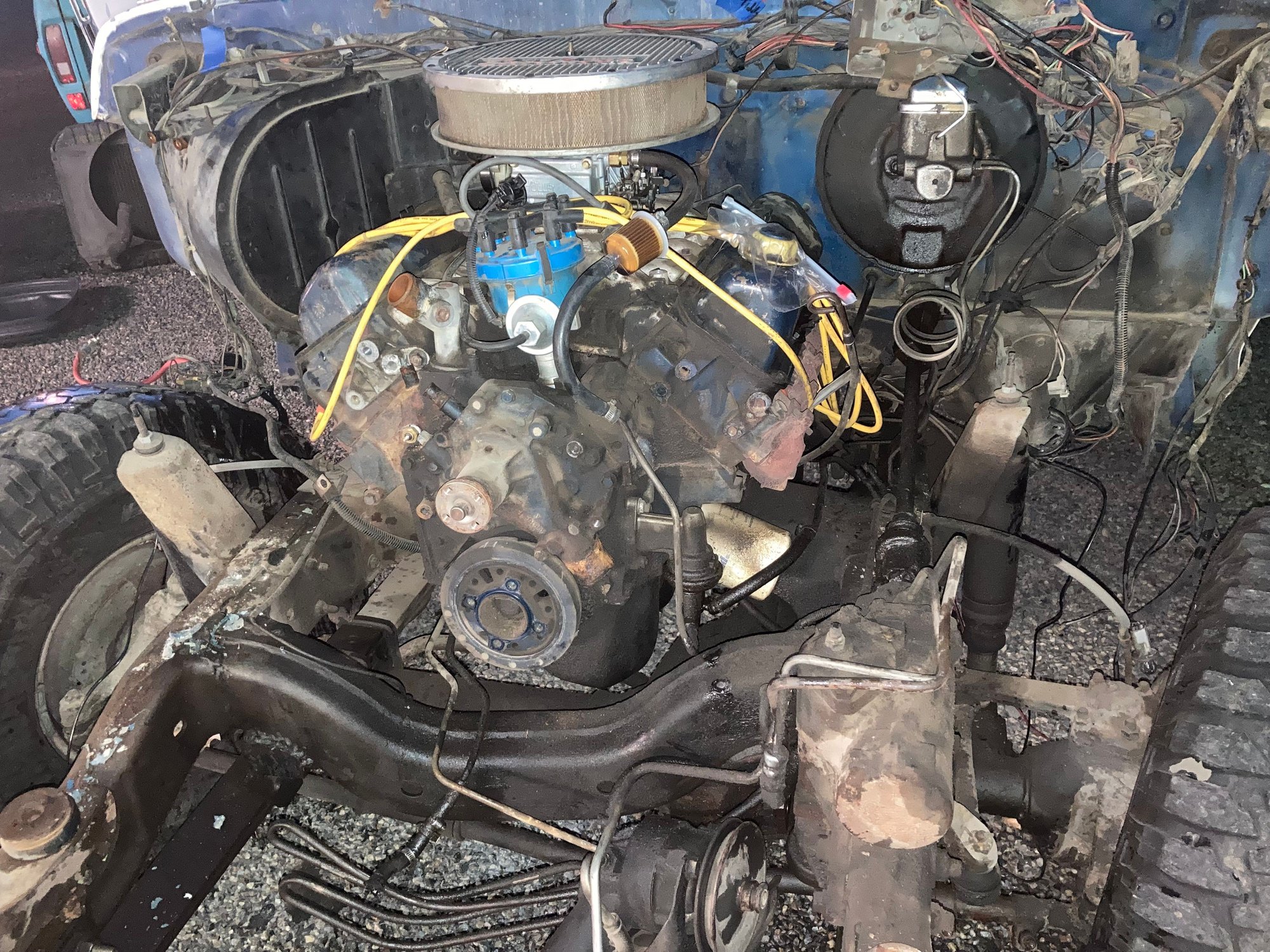

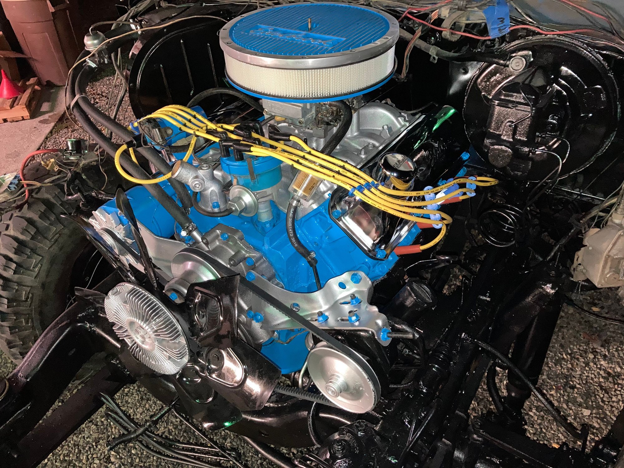

Owner of the 78 dropped off the correct parts yesterday so I was able to start working on the engine bay again. Swapped in the new timing chain, dropped the oil pan and put in a new gasket then buttoned up the timing chain cover and put on the new water pump. With all the other parts cleaned up and painted the rest of the engine came together nicely. I still need to sort out the wiring and clean it up so it's not an eye sore.
Before...

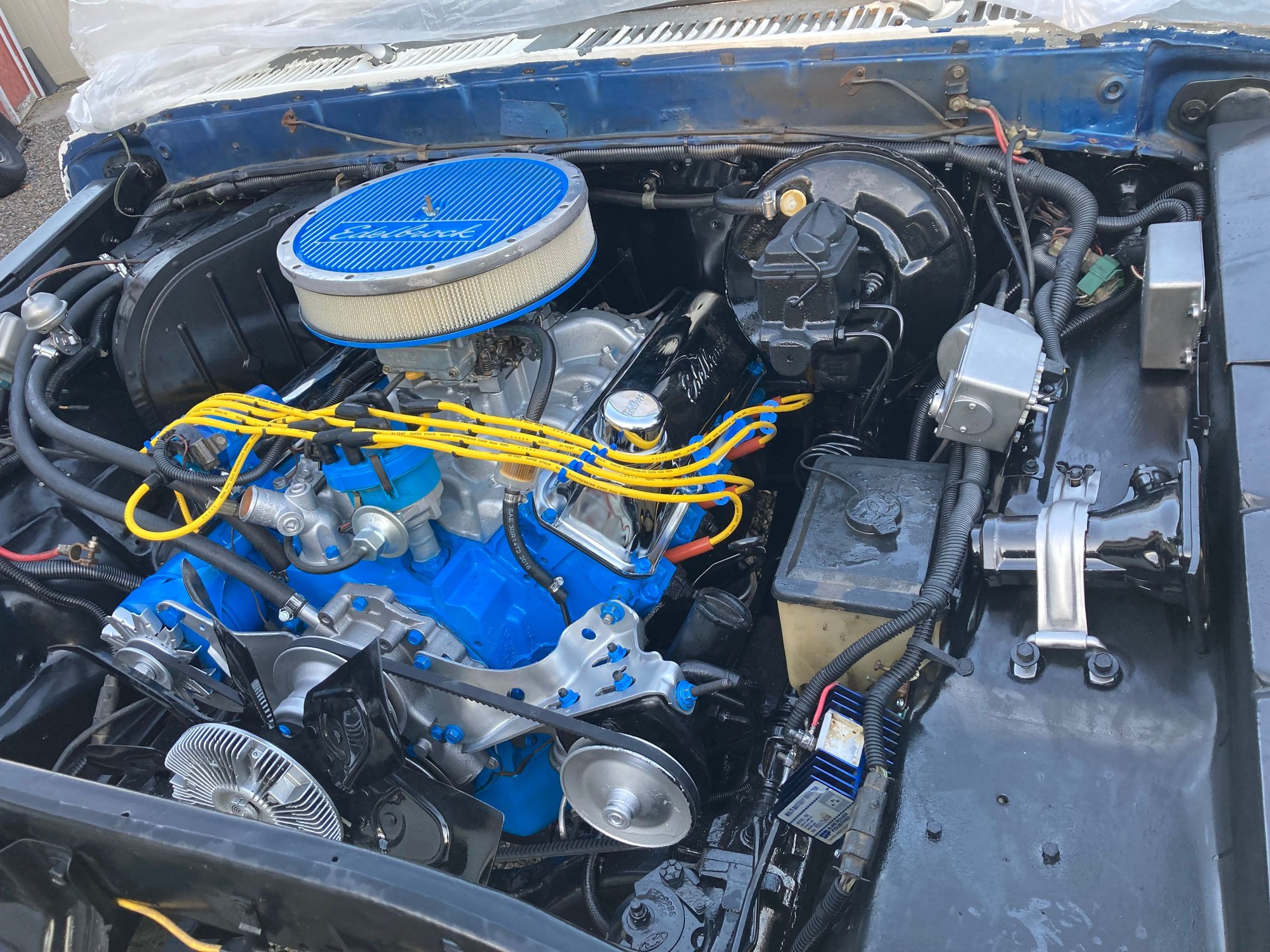

Sorted out and cleaned up the wiring and started to reassemble the front end. Shouldn't be too much longer and I'll have it wrapped up and I can get back to the flatbed project.
Before...
After...
