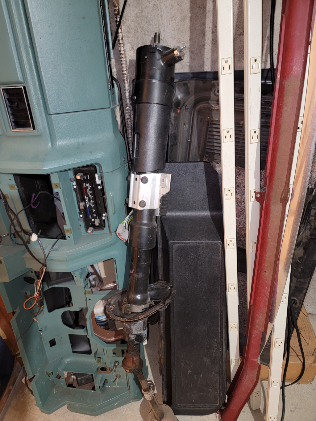

As an aside, I have a replacement column (my tilt-wheel stuff is broken) in my basement that I got from a JY ~10 years ago, but that's a project I never planned on....
