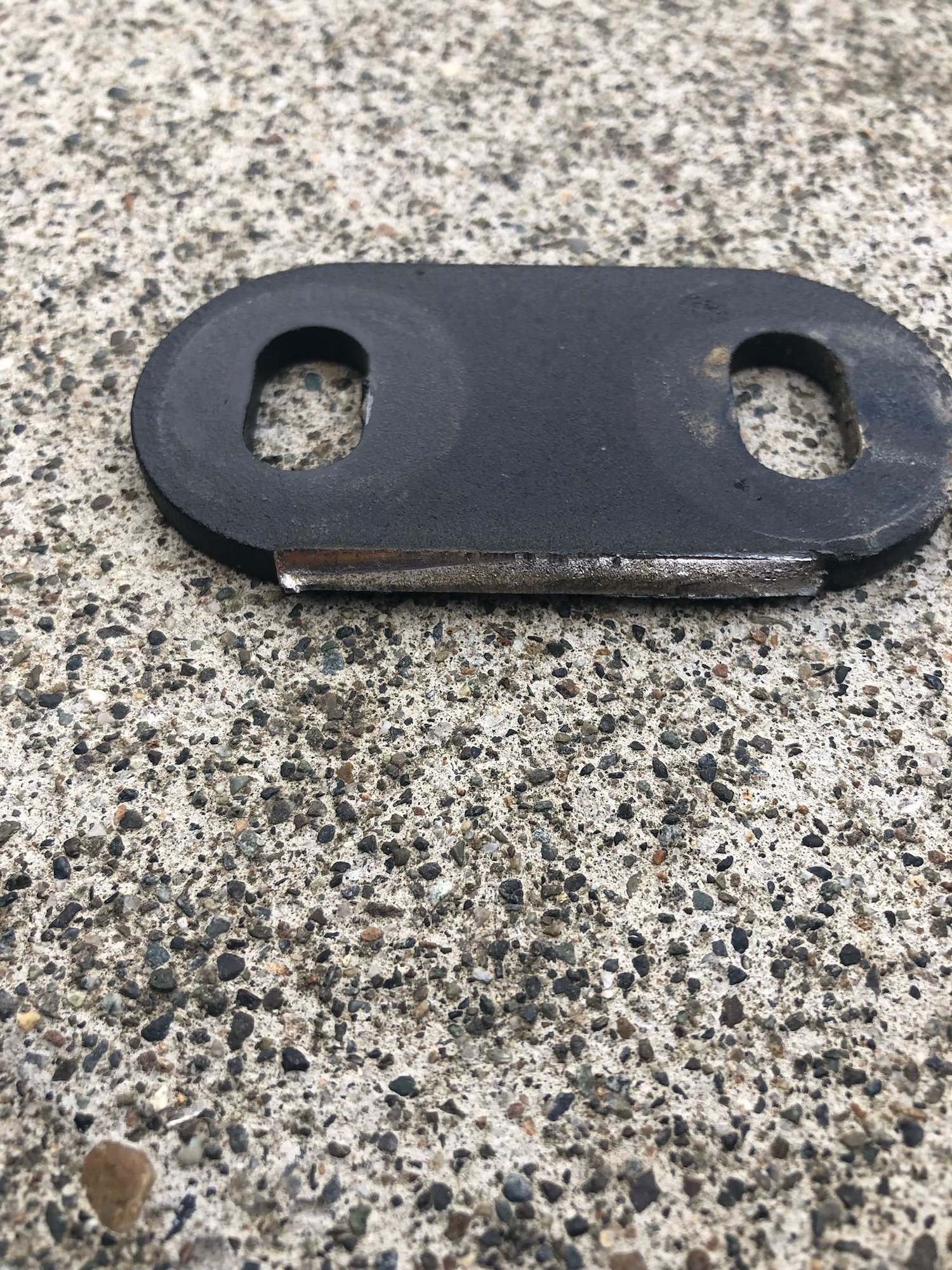

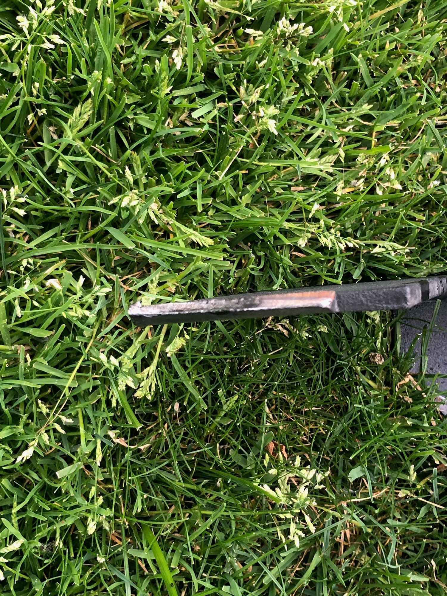

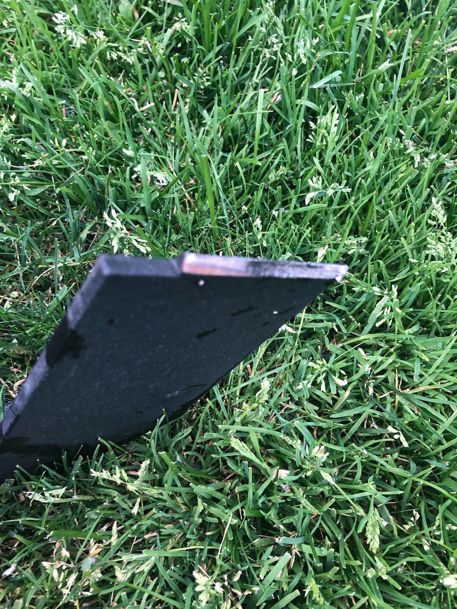

Updating an old post. On Friday 8/25/2023, I noticed my NFAB light bar looked like this:
I had just stopped at a UPS Store on my way somewhere else. Fortunately I noticed it before getting back on the road. I was able to "remove" it by just lifting and lowering the whole bar about 3 times (think bending a paperclip until it breaks.). It would have fallen off on the road very soon after driving, and I would have run over it, possibly causing thousands in damage. Or worse, it takes out another vehicle and causes a huge crash. Definitely massive good luck on the timing of the stop, and noticing it was FUBAR.
This time, both mounting tabs broke, and in the same fashion as before. Rust is visible near the top edge, so it started to fail some time ago.
The VisionX lights are simply far too heavy for this bar. It is only good for lightweight, small lights.
I'm not even bothering to contact NFAB this time. I'm just done with this bar, it is clearly not up to the task I'm asking it to do.

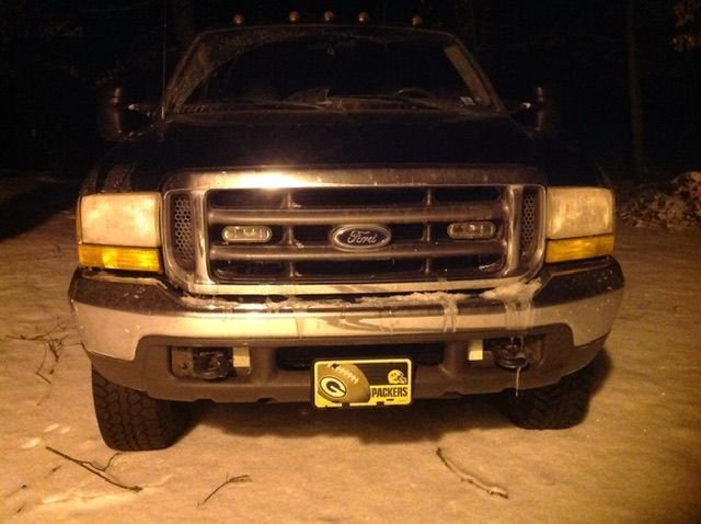

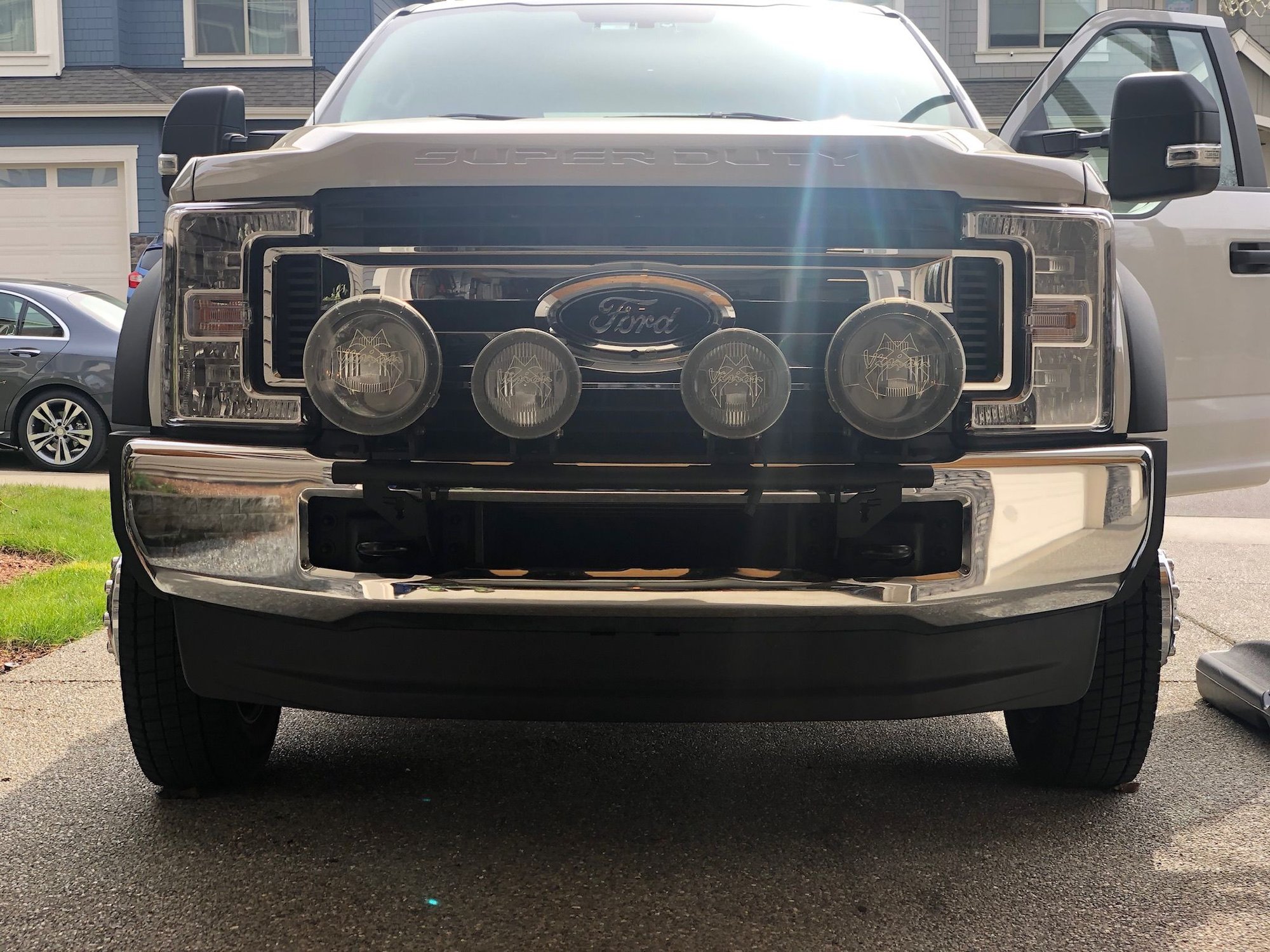

These Hella worked well in this style grill. Had to add your own led bulb if you don’t want the halogen.

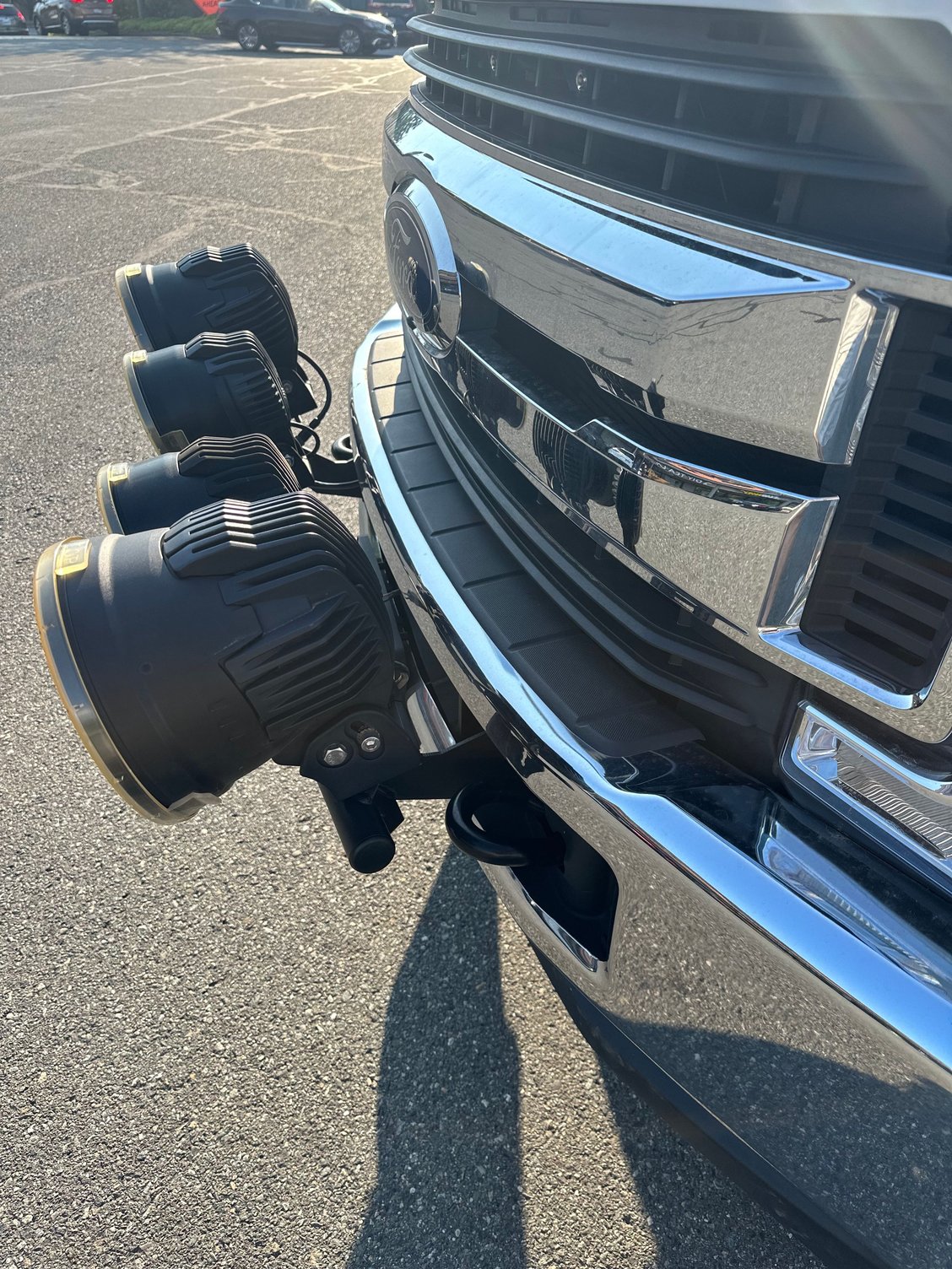

Reviving an old thread...
I used to have these lights installed on my lifted Jeep gladiator but since that vehicle is now gone, I thought I would move them over to my 2021 F350 Super Duty.
First I installed a Factory Aftermarket light bar, a very well designed and made product suitable for mounting light bars snd individual lights like these.
