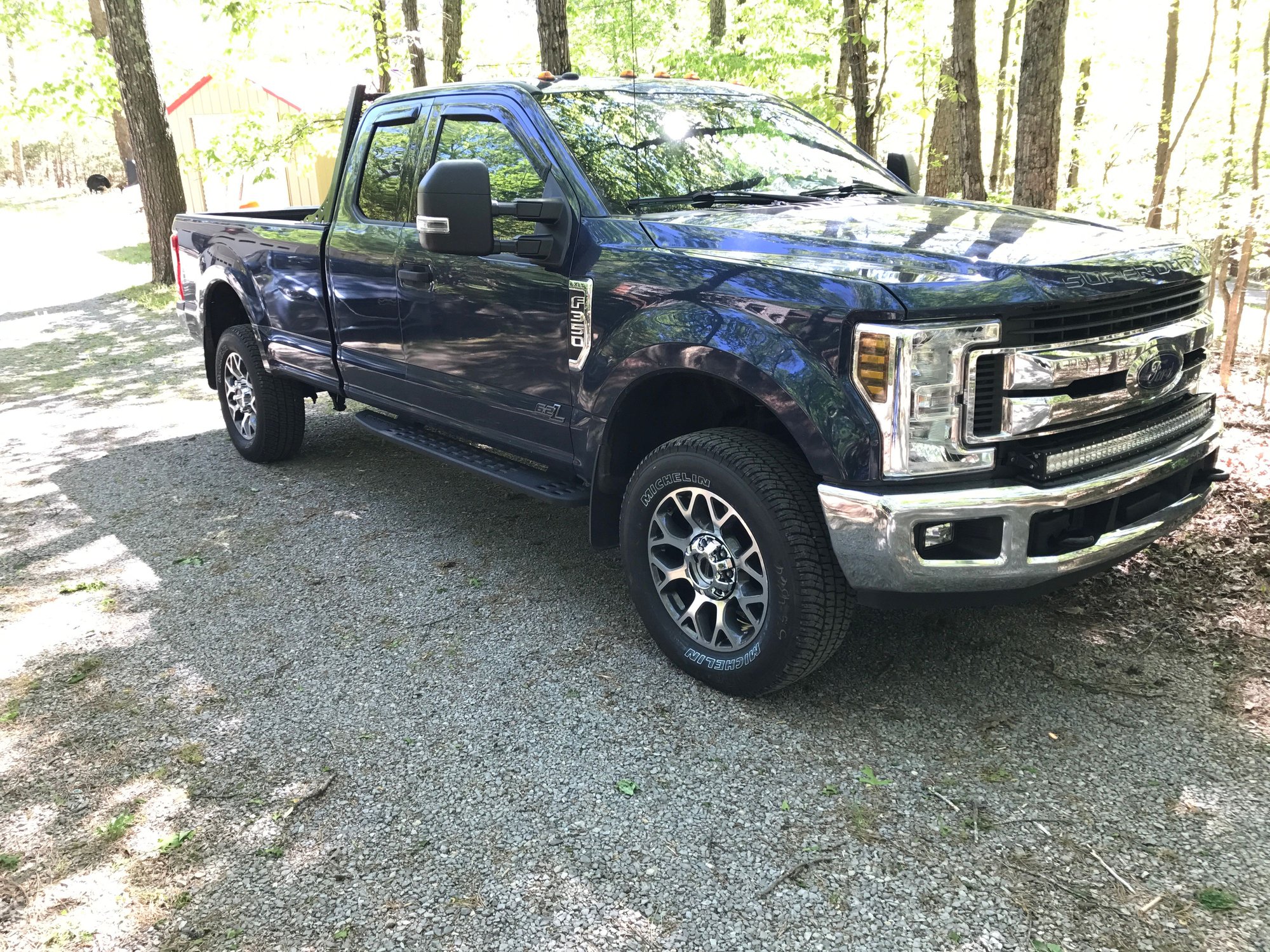

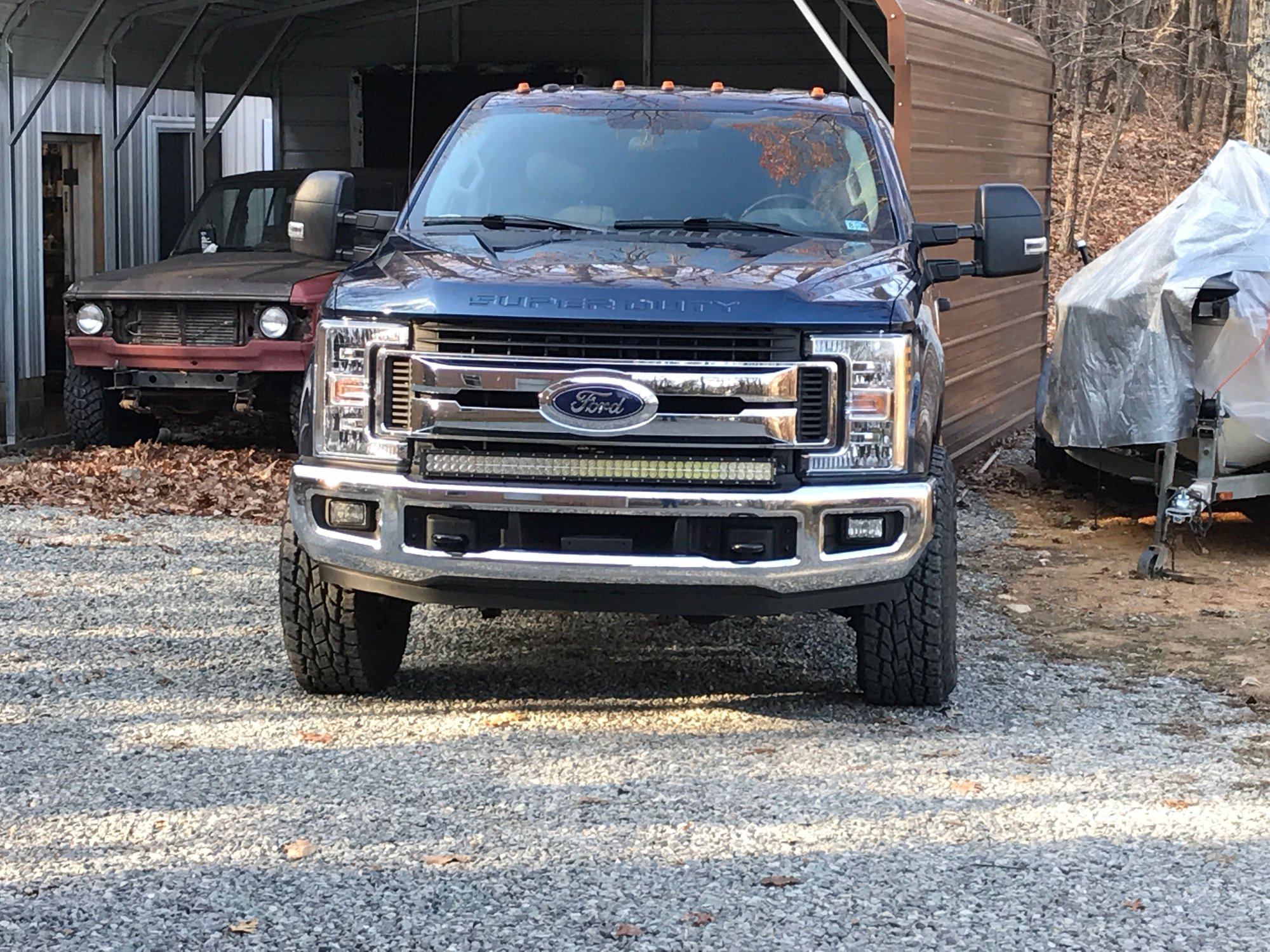

Here's mine. It's an NFab light bar that I painted white to match the truck. I have 4 - Rigid Hyperspots mounted and all can be cycled using the high beam switch. I also have a remote switch that I can turn off so just the regular high beams operate and don't cycle the cubes. I like the hyperspots because they're meant for distance. If you're hooking them up to your high beams, I would not use anything that's a flood or diffused pattern, you want to put the light out, away from the nose of the truck. Your eyes focus where your lights are.

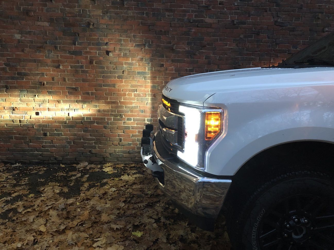

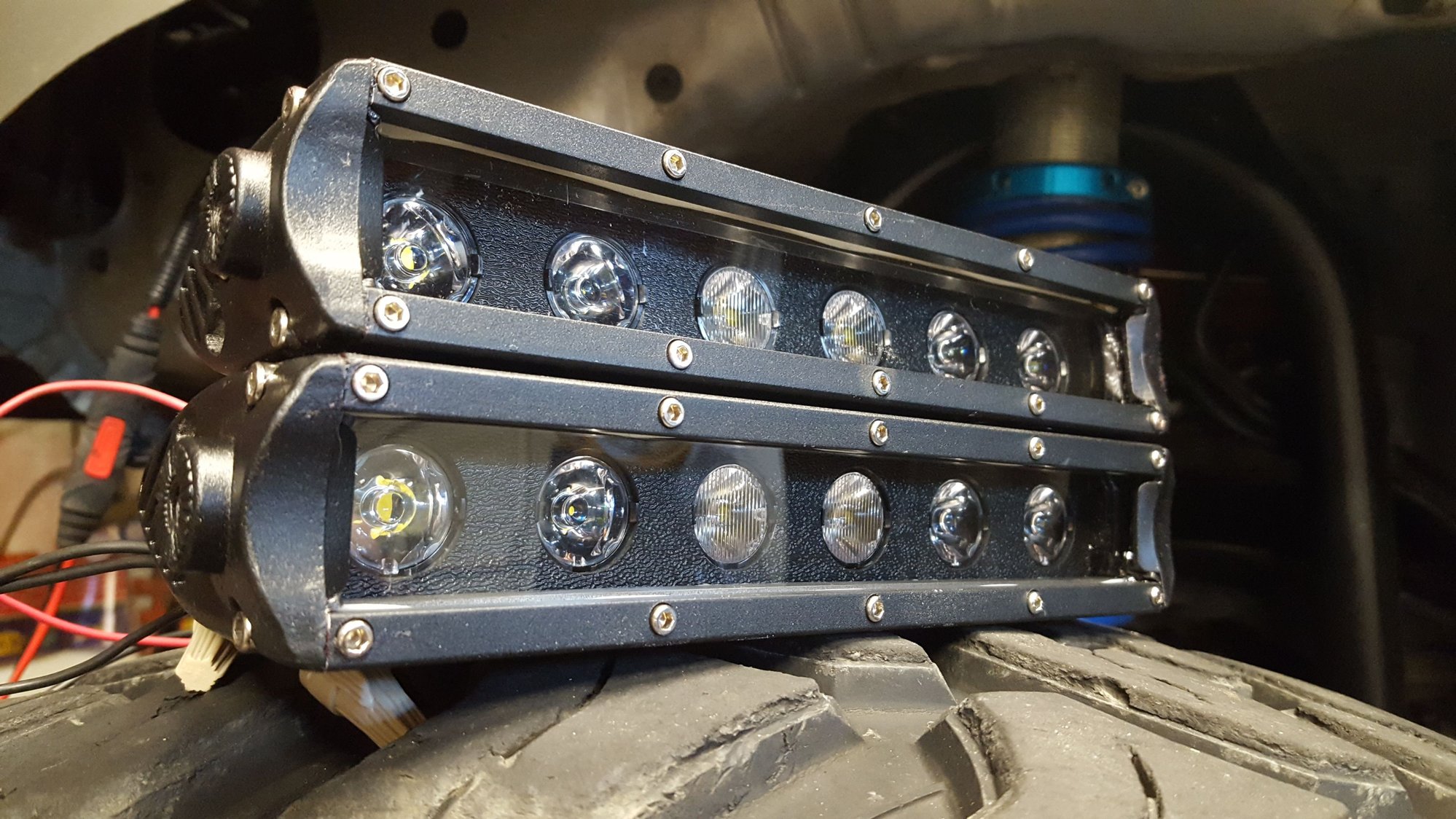

I built a set of these for my crawler and will be building another set to go on my xlt. Theyll fit on either side of the ford emblem.
Been there and done that with the cheaper lightbars. IMO they're severely underpowered, severely overinflated with their ratings, and the optics are horrible. Unless you spend top dollar for the baja design stuff, it's just there for looks. Just one of these lightbars draws as much amperage as a 50" cheapie, and has better optics.
Just one of these pulls about 5 amps. Here's just one lit up.

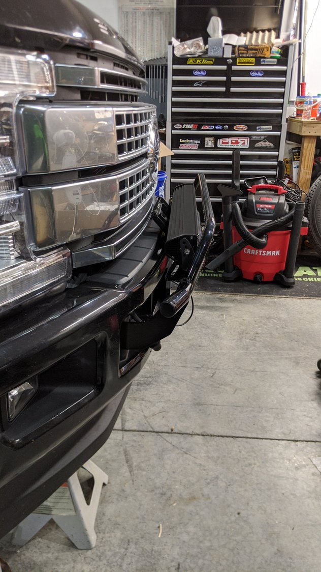

Here's what I've done so far (shown with stock front Valance since replaced by the 2WD version)...
Mine was part number F174LB-TX. One of the great things about having a low trim level truck is I don't have to consider messing with the tech stuff. My truck doesn't have ACC so I just bolted it on and wired up the lights. There's an alternate part number for trucks with AC but I have no idea what the difference is (F174LB-AC-TX). Price seems the same and the install instructions don't seem any different either.

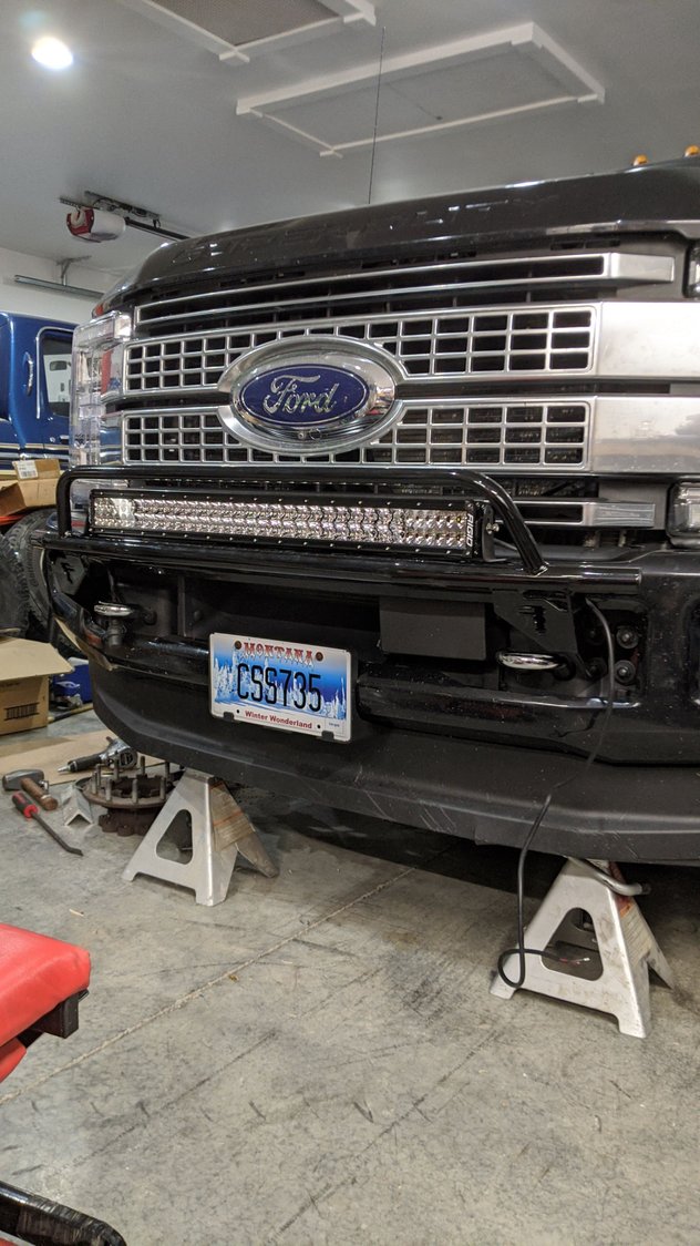

I used an N-Fab bar mount as well. AC specific part number. It was about the only bolt-on solution I found that would work with the adaptive cruise. I read about the rusting problem, and despite a multi-year warranty on the finish I wanted to be proactive and filed a few sharp edges and rattle canned over them. Would not recommend doing that. Even though I scuffed the areas I was painting the black Rustoleum paint beaded up on the powdercoat like water on a windshield and did not flow out smooth. Made kind of a mess. I was able to make it tolerable after 4-5 coats to get the beads to grow together. It probably won't rust now, but if I was doing it again I'd run it as delivered until it rusted. Then get out my grinder and Dremel tool and do a proper de-burring job and have one of the local shops strip it and re powder coat it.
The one I chose with the top protection bar is pretty visible in the front camera, but doesn't totally impede it. It does put black bar out in front of the truck in the overhead 360 view.
