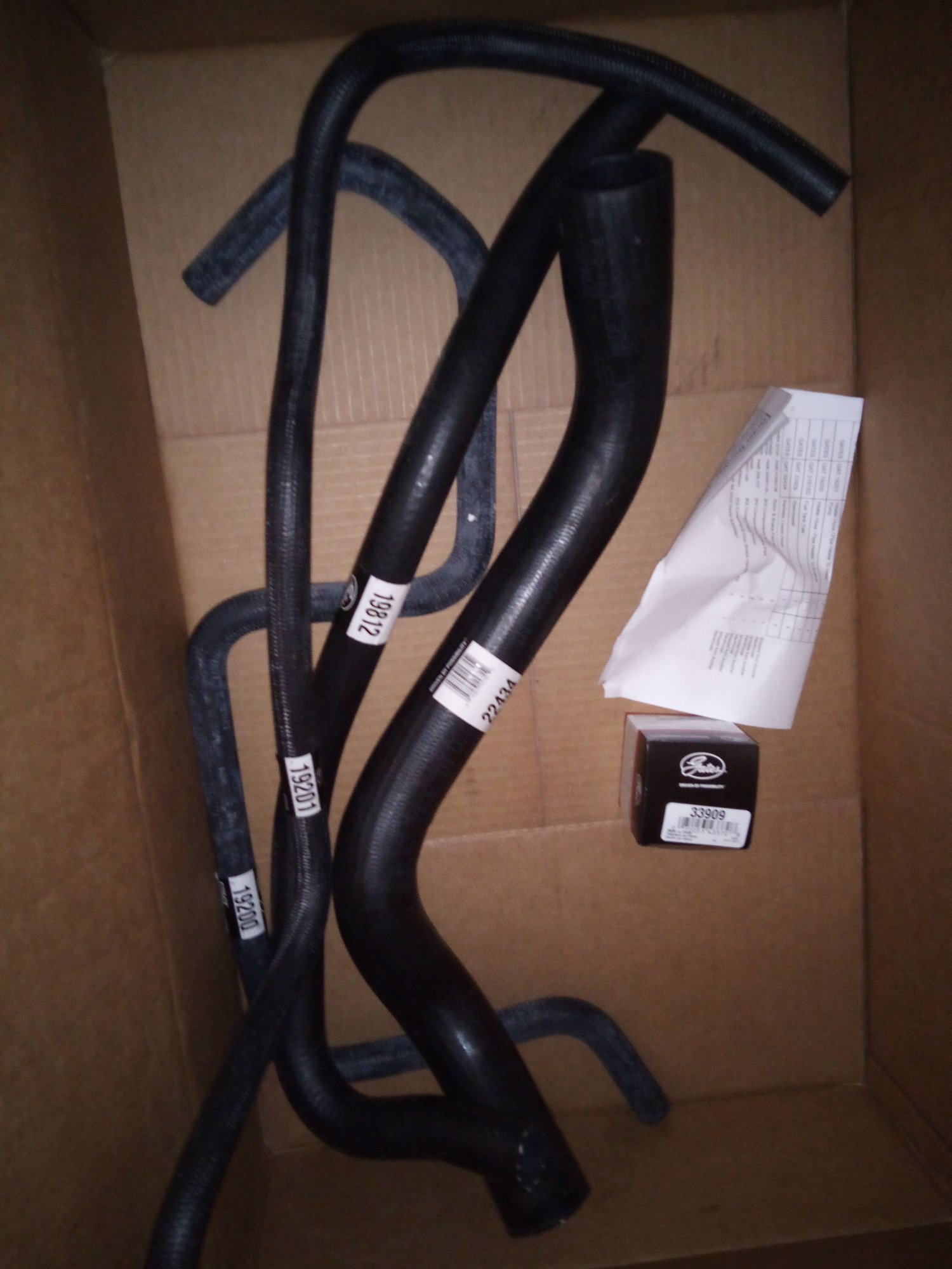

So we all know to pull injectors the 3 intersecting fluids have to be drained; oil, coolant, and to a much lesser extent fuel. Since my truck still has the original coolant hoses (that all still pass the look, feel, squeeze tests) I'm replacing them all just due to their 22 years of age. And the original thermostat. And while I'm at it I'll swap to ELC, yay no more test strips! After price comparison between local and online, all new Gates hoses can be had for 1/3 the cost of local sources thru RockAuto
Ahh the smell of new rubber
