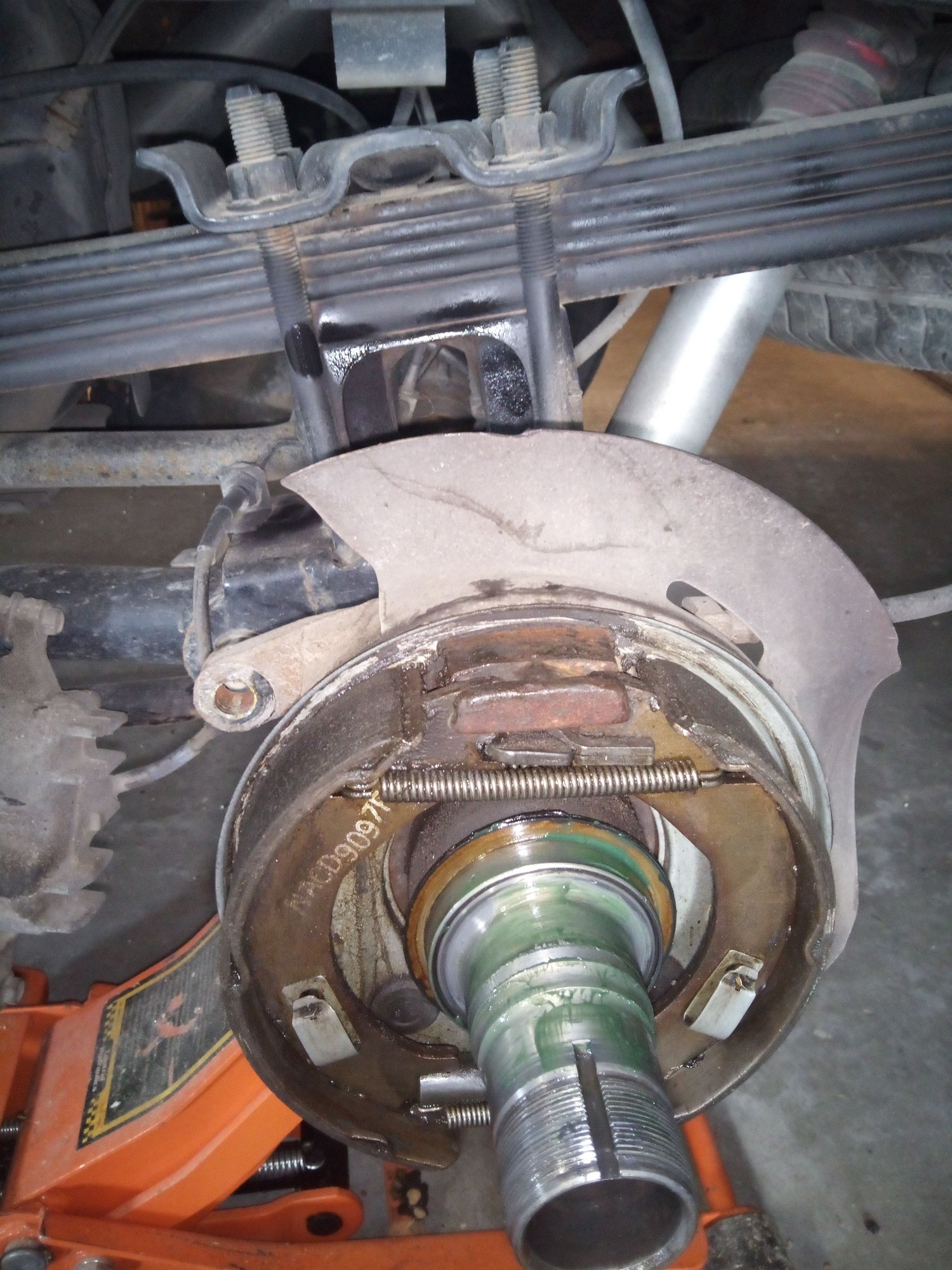

Well yesterday sucked. Started on the "simple" brake job, rear rotors and pads. That quickly expanded to include five 1hr round trips to parts stores.
So the first steps were obvious in rotor replacement. Remove the tire
Stupid wheel weights have damaged the clear coat
So next I removed the brake caliper, and hung it from the frame with an old school rubber bungee strap so it wouldn't hang from the Russel stainless braided lines.
Grr. Truck was filthy, but the darn surface rust was distracting throughout the entire job

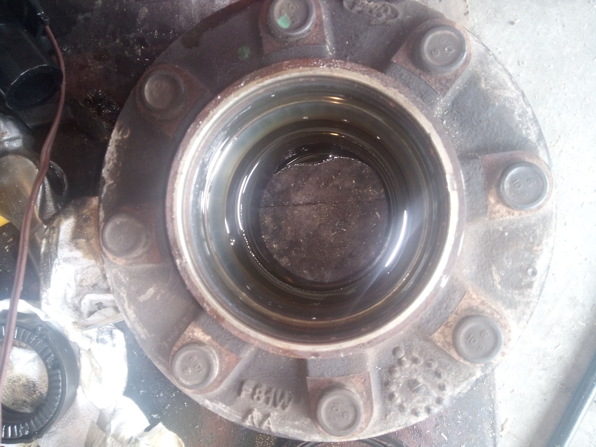

Removed the rotor and sat it down, but why are my gloves damp?
No... Failed hub seal
So, off to the parts store for the axle spindle nut tool and hub seals, pics of the tool & part number provided by @Sous
Tool with part number W83008
Axle seals BRS-116
So, off to the parts stores. Yeah, first one had the tool, but not the seals. Second one had 8 seals, but no tool.
The next steps were pretty straight forward after a quick read thru on threads here. Needed a puller to pop the hub's seal lose after removing the nut and outer bearing, then gave it all a couple blasts of brake cleaner. Then the fun began.
The back of hub, races checked, ready for the rear bearing
Bearing back in place, still looks excellent, a fresh splash of stinky gear oil
Oil slinger in place, ready for the seal
Next up I poured another splash of fresh gear lube between the front and rear bearing races then lifted the hub in place, added the front bearing, then the nut, and that's when the day sucked. The threads wouldn't grab, and no matter how hard I pushed I couldn't get the hub to seat on the spindle enough to start the nut. So I pulled the hub off, applied a layer of great lube to the spindle and got out the punch and gave the inner bearing some light taps. Still wouldn't seat. So a few more light taps. Nope. So, called in the calvary. Dad. Dad was a high level mechanic at our paper mill before he retired, and part of our Skunk Works team. He had 40 years of wrench turning under his belt working on multi million dollar machinery from manufacturers all over the world, he's replaced thousands of bearings and seals and designed and upgraded a crap ton of stuff. I needed a second set of eyes, and experienced hands. So he brought a heat gun & bearing heater with him.
Nope. We tried everything he could suggest for the next 2 hours. I double checked part numbers on the seal for my 99.5 F350 vs Sous' 2000 F250, which of course were the same seal. It just wouldn't go on far enough to grab threads, and the spindle was smooth with no ridges for the bearings to be hanging up on. And nothing showed to be hanging up on the revealing layer of grease we wiped on the spindle.
Then the simple thing. I laid the old seal over the newer, and boom. The old seal was 1/16” larger inner diameter than the new. But why?
Grr. After looking the spindle over yet again, but with this new info we finally saw this. A sleeve. What the heck. Did the PO have a damaged spindle and decide to sleeve it then use a different sized seal over 17 years ago? After an inspection of the seal for any sign of a part number and coming up blank we grabbed measurements with my calipers then we traveled yet again to the parts store with the old seal. They suggested and we compared seals for 2wd, 4x4, 4wd (apparently there is a difference?) and even duallys for every 7.3 in their database. They actually asked if it was a junkyard axle out of a Chevy at one point.
Dude, lug spacing is different, and the axle tags say no. Trust me it's a Ford Sterling 10.5
So finally we put in the seal OD and id and came up with a MotorCraft seal that looked right and should work on the sleeve and hub. Of course there wasn't one in town, but their DC could have one in the morning. Ok. So back to the house to clean up a little n chat before I had to start picking kids up from school and sports. Then off to throw a fuel pump in the Corvette.
I'll never learn. I should have cut my losses for the day and just done house work. So the fuel pump on the Corvette is insanely easy to change standing at the fuel filler. I've done it before. Just remove ten 10mm bolts on the fuel cap assembly, and out comes the entire sending unit and the new goes back in. 5-10 minutes tops. Uhg. So as I lifted the sending unit out I heard light splashes into the fuel tank. I didn't see any debris around the unit that could fall in when I started. Once I lifted it up a couple inches I could see the carnage. OMG. I already hate ethanol, and whoever had the bright idea of mixing it into gasoline, but now I wish them a slow death being burned alive by an ethanol fire. The entire sending unit, where it wasn't painted like the above side was, was a mass of corroded huge flakey brown crap. I had added stabilizer before it went into storage, but this was insane. The copper wires to the pump and level indicator were even green and corroded clear thru. Then I had to go fishing to find the pump. And the filter sock. And pulled out 8 nitrile glove handfulls of corroded gunk. The fuel was lacquered black, and the bottom 3 inches in the tank was a thicker go like syrup. My best friend was about 200ft away admiring his new to him the day before showroom condition 66 Impala SS. He stopped and came over and 20 ft away said man that lacquer is making my eyes water clear over there. I finished scooping out bits and wires while I could still breathe and called it a day. Then ordered a stainless steel fuel assembly that will get here Tuesday...
Sorry, I was too high to think about taking pictures before we left. We walked around his acreage for a while to clear my head and have him show me the progress on his guard shack/package delivery setup he's having put in at the front gate.
Once back home I couldn't get the seal out of my head. Was it a sleeved repair job? A bad axle from the factory that Bubba put a sleeve and oddball seal on to make his quota Friday afternoon while dreaming of his sports team and beer?
So into the depths of the net I searched once the females were all asleep. After many pages of results I found a very very old post on a different forum mentioning a 2 piece seal on a 96 OBS coming apart on disassembly and throwing the guy off, but it was so old of a thread there were no pics. After some more searching I found more mentions of a 2 piece seal separating, but no pictures of these 2 piece seals. So I looked up a 2 piece seal. Basically it's a seal, that has a sleeve inside. It's own thin sleeve is to prevent wear to the surface of whatever it's sealing. That seal's sleeve wears instead of the axle spindle. Hmm, good idea. But they were more prone to leaking since there were 2 sealing surfaces going on, so Ford phased them out to the 1 piece seal we know. After looking over pics of seals during my inability to sleep thru the night, and some morning confirmation from@SkySkiJason and another set of eyes from Sous my morning goal became to gently try and remove the sleeve to see if my seal had separated upon disassembly.
Success! Now my spindle looked like all the other pictures and videos I'd seen where everyone simply pushed on the new hub seal and tightens down the nut.
Shoot. That would saved half a day and untold frustration and lost sleep. Off to the parts store again! So after picking up the same 2nd seal I had returned yesterday I was back in the garage joined by dad. Oh and the heat gun made removal of the passenger side seal's sleeve that also separated on disassembly easy peasy. Plus the knowledge of that even happening made it quite simple... Dad said many times he'd never seen a seal like that, but he wished they'd used them instead of having to remachine and sleeve worn journals for years
We put it all back together, torqued the bearing nut to 60ft# then backed it off 7 clicks for the used bearing (5 clicks for new) all in about 10 minutes. Slid the axle back in and applied blue loctite and torqued the bolts to 80ft# Then finally put on the new rotors to replace the slightly grooved originals
So purdy.
Yes I know the debate of drilled vs not. I was hoping it was just a stock photo on the website since there was no mention of drilled in the description but there was mention of slotted. Granted drilled and slotted on my Corvette have never been an issue and let me tell you those suckers get hot during an auto cross event. But it's also not towing 6.5 tons behind it while full of my family going cross country...
Here's the pads with ceramic lube on the brackets and ready for the capliers. The lube also goes on the sliver pad liners where they contact the caliper and pistons, but no pics of that. Also lubed the slide pins.
So there you have it. 1 bad, frustrating day, and a day of relief, but fresh brakes I won't need to worry about for quite a while.
