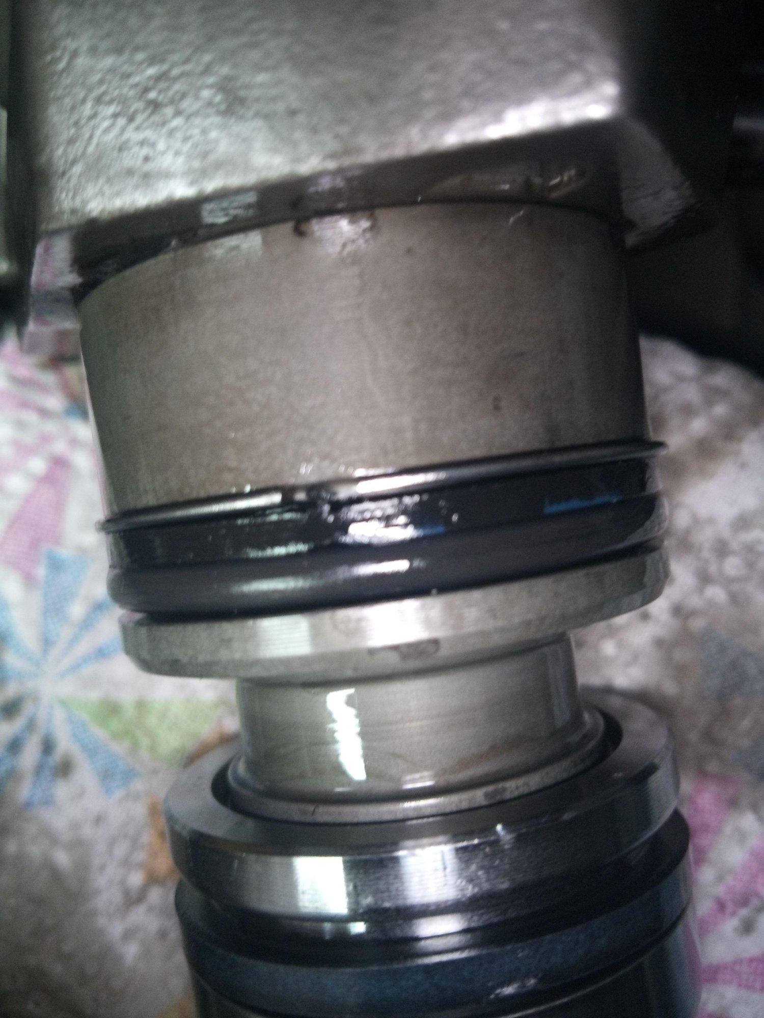

Alright updates as they come this morning.Got kids to school.
Checked torque on my lower injector bolts. Started at 120" # and worked my way up in 5inch steps up to where I hot torqued them years ago. DS were all still torqued to where I had them
Pulled the rearmost injector to allow all the fluids to drain into that cylinder since motor slopes to rear of truck.
Initial inspection to my untrained eyes shows a pretty piece of hardware. Only one concerning spot on oring, but probably to be expected after 22 years Here's pics
Suck cess ful removal
Nozzle and copper washer
Only one concerning spot on all of the external orings where the metal ring pitches together on the square one, but the sealing one under it looks great
On to the passenger side VC removal and torque checks then rear most removal. Then I'll remove the remaining DS

Alright, passenger bolts were also still torqued down to what I had hot torqued them to.
Removed the passenger rear injector and let it drain into cylinder. Then went and removed the driver's side injectors. Then the passenger side.
One thing you'll need if you remove yours some day is a 5mm Allen wrench to remove the oil deflectors before you pry them up. And ideally not the bent at a 90⁰ one piece cheapies. Took some effort to break free. No way I'd want to try it with a 1" long wrench handle
All out!
Nozzles all look the same
So clean and pretty, no scorch marks anywhere on any of them
The only area of concern that wasn't at 100% visibly on the external orings. Where the metal ring pinches the flat oring
Nozzle and crush washer. No gooey oil/coolant sludgey mix like some removed injector pics
So the good news is they are all out. The bad news is... They are all out...
Well since I was at work last night and been up 21 hrs I need to try n grab a nap b4 school is out. So I'll worry about the boxing up and shipping part tomorrow after some sleep and family time. Catch y'all later
