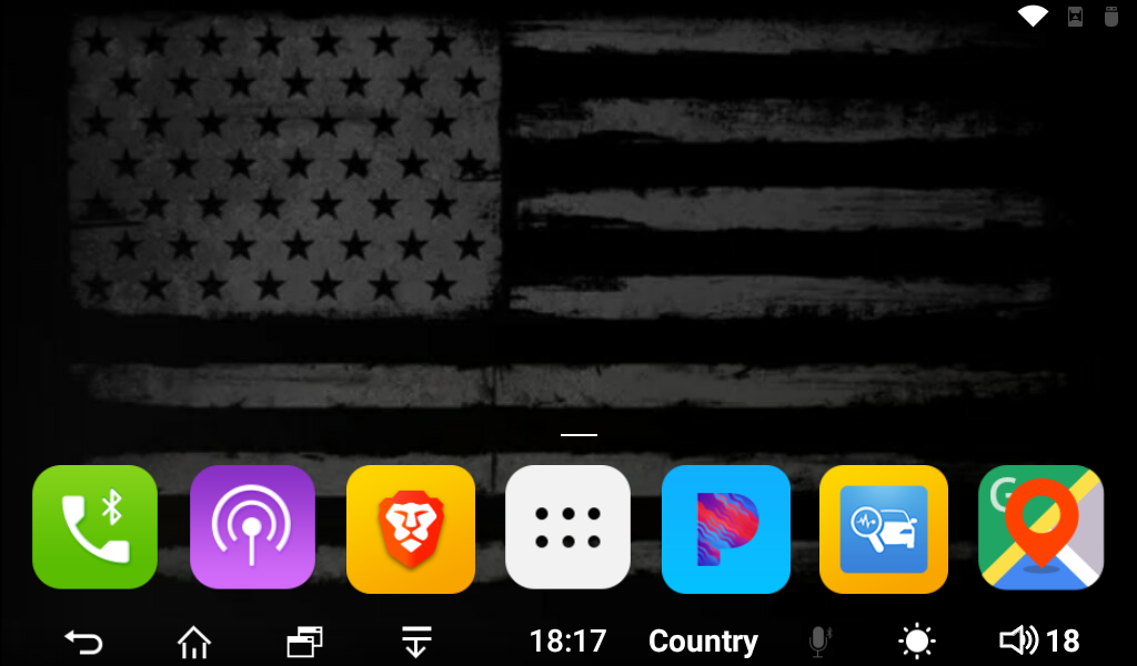

Below is a screenshot of the display of the head unit as it sits in the dash. FSL is the second from the right and will be online within 2 seconds of pushing the app button.

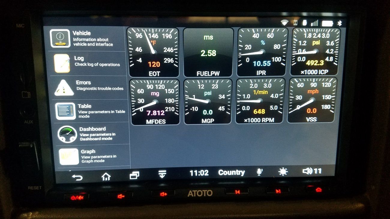

Below is a picture I took recently showing the FSL gauges I had initially loaded.

It is an Android OS head unit, similar to a tablet, but in the form of an in dash stereo. All of the information you may need is in that thread somewhere that I linked. There is no screen cast feature on the unit I selected, but there are on other Android head units. I selected this one due to the dual BT receivers, but I didn't end up using both like I had originally thought.

Once in the truck, if I want to use FSL on the head unit, I push the app button (just like you would on a phone or tablet) and FORScan is up in a second. Once it is connected and the truck in the top left turns green, the gauges are up and you can go about your business.
