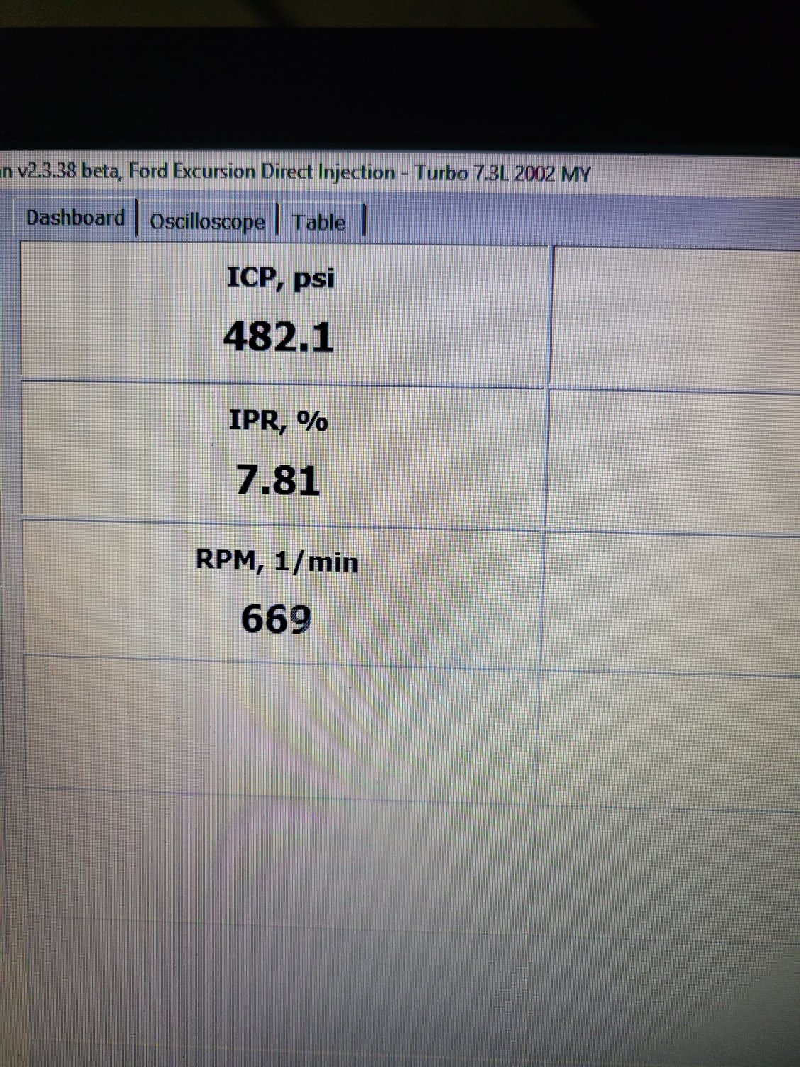

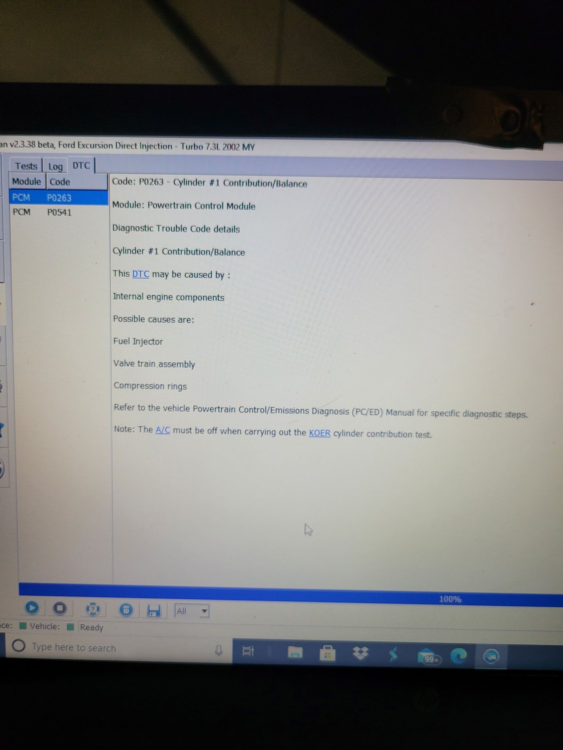

**Update**
Ok since the last time I was on here I tried the PCM reset and still was receiving the same P1316 code along with P1271, P1275, P1277 and P1274. So today I pulled the passenger VC and took solenoid and armature off #1, #5 and #7. One at a time. #1 had shims and removed then put back together. #5 had no shims, so swapped out armature and solenoid with an old injector I had in the garage. #7 had one shim and removed it. Put everything back together and ran test. I am concerned about one of the readings from the cylinder contribution test.(photo attached). Also ran ICP and IPR readings, not sure if within limits. (photo attached). P1316 came back but is only showing a P1274. So in the morning I'll pull the driverside VC and check #4 for shims.

PSI and % look good and CCT failure on #1 is pretty common. It's the end of the line for the fuel in that head so any hiccups show up there and #8.

I don't follow your reasons for removing shims and swapping solenoids. Did you measure them? But hey some codes went away so rock on.
Did you do the 50 cent mod? Did the injector harness look fully plugged in to the VC gasket?
ICP looks fine for idle. Need numbers while driving under load to know if the HPOP system can keep up.
Once all together monitor the PERDELS PID for all 8 and give us a screencap.

Contacted Bitterroot, they sell injector rebuild kits and also rebuild injectors. Told them what issues I was having and they said to pull shims.. I had gauged them after rebuild and all were within. 002 and .004.. But they stated sometimes injectors can be temperamental. Reason I swapped solenoids and armatures on #5 is because I couldn't think of anything else to do beside take a large hammer to it. LOL.
I'll take it for a spin tomorrow and check HPOP. Now how would I bring up that PERDELS PID thingy on FORScan?
As for my UVCH, there is no plug on the inside of harness. Only 9 pin attachment on outside. And it snaps together and locks..

I rarely see #1 fail CCT by itself. It’s ‘common’ to see #8 fail and many times #3 and #8 together. I think PERDEL over about 5% trigger CCT failure.
The P1274 needs to go away before P1316 can be addressed.
Those are aftermarket VC gaskets (Dorman?). It is possible that is the cause of P1274. You could swap VC gaskets and see if problem follows.
I’m sure Matthew at BDP gave you good advice.
Good luck, I think you’re getting closer!!
I’ve already forgotten why you installed shims - but, you’ve basically established your injectors need rebuilt. All of this f$&ckaround could end now if you go ahead and get some fresh injectors. I’m not sure if the high to low side open codes ‘hurt’ the IDM...
