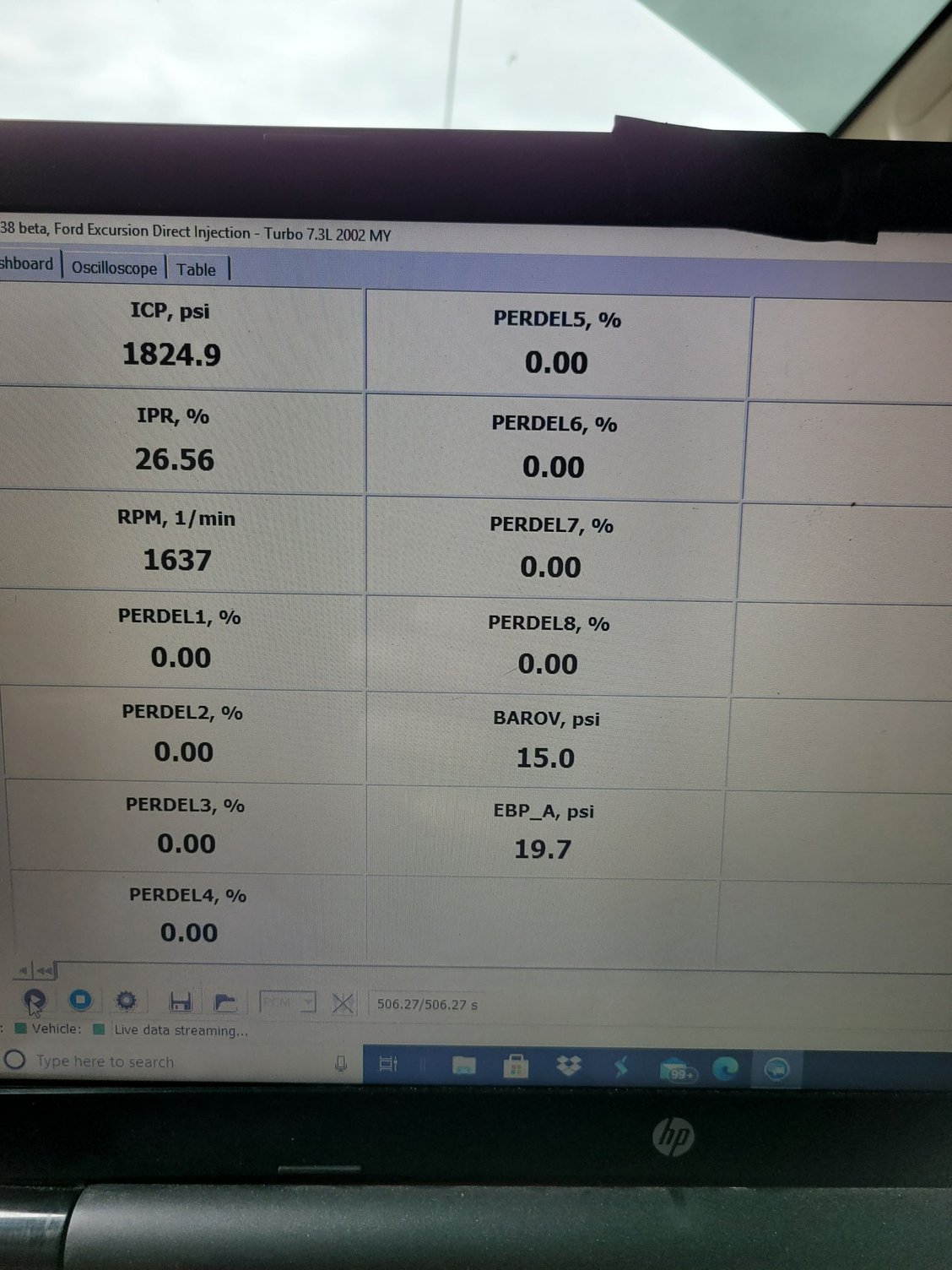

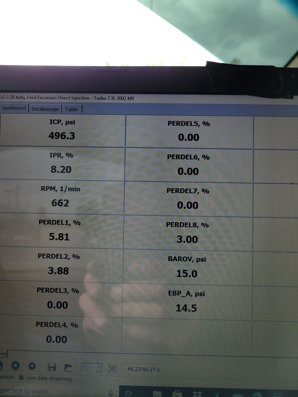

Ok, as I said earlier today I completely went through the known injectors that were giving me issues. Ran for a bit and ran the normal test. And just when I thought I beat the dreaded P1316, it came back and points to #4. Bitterroot suggested swapping #4 with #2 and see if it follows or stays on that cylinder.
I pulled up the PERDELS for the injectors and they stay at 0% unless I rev it and then #1, #2 and #8 come up. (Photo attached). Then drove at around 40 mph and watched levels. (Photo attached) and then at idle with warm engine. (Photo attached)

I could be wrong here but I thought perdels could only be measured at idle with a warm engine?
Old Mar 19, 2021 | 09:31 PM

Yep PERDELS can only be measured at idle with trans in drive and truck stationary. The test measures relative cylinder speeds and shows how they compare. Required test conditions for that are natural idle (no throttle input) and uniform load. Simply cannot be measured with changing RPMs or irregular load from driving.
HPOP numbers look fine for goosing the throttle a bit while not under load. Thinking that system is all good.
A great test of everything is swap injector 1 and 5, see if the bad PERDELS follows. If yes you confirmed a crappy injector.

Oh ok, truck was in park. And those numbers were after I touched the go go pedal. I use 10W-30 synthetic.

Thanks for the info, just changed #4 injector yesterday and did the test this morning attached is what I'm getting so far. I'm guessing that each PERDEL should be 0%. Not really sure though.

Yes. Close to zero% deviation is ideal.
Generally, you don’t feel a ‘miss’ until close to 10%.
It’s typical to see 1-4% on #8 and sometimes #1 and #5.

Ah ok, but I'm confused though. #4 is a new injector but has a reading of 5.13%. Shouldn't it be around 0% Truck feels like it may have a slight miss, but currently there are zero errors on buzz test. Nor is there a pending P1316 or any other codes coming up.
Either it’s not a very good injector or there may be something else going on with that cylinder.
