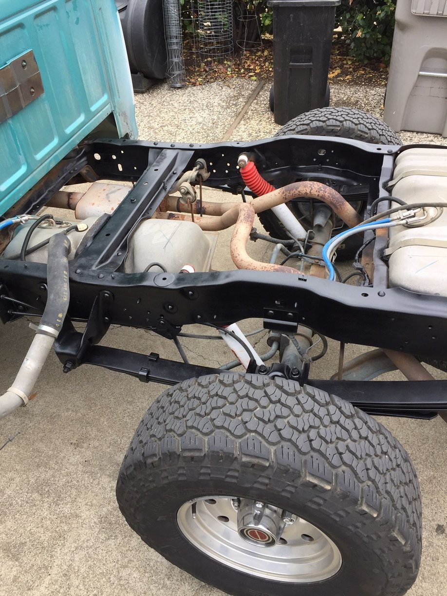

Originally Posted by Bignasty2
Okay guys, I went for it. I went with these guys because of the direct fit application and they were really the only player I could find that provided that.
LINK PREVIOUSLY PROVIDED HERE ( Company withheld information, issue not resolved)

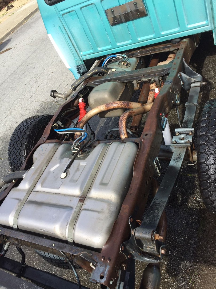

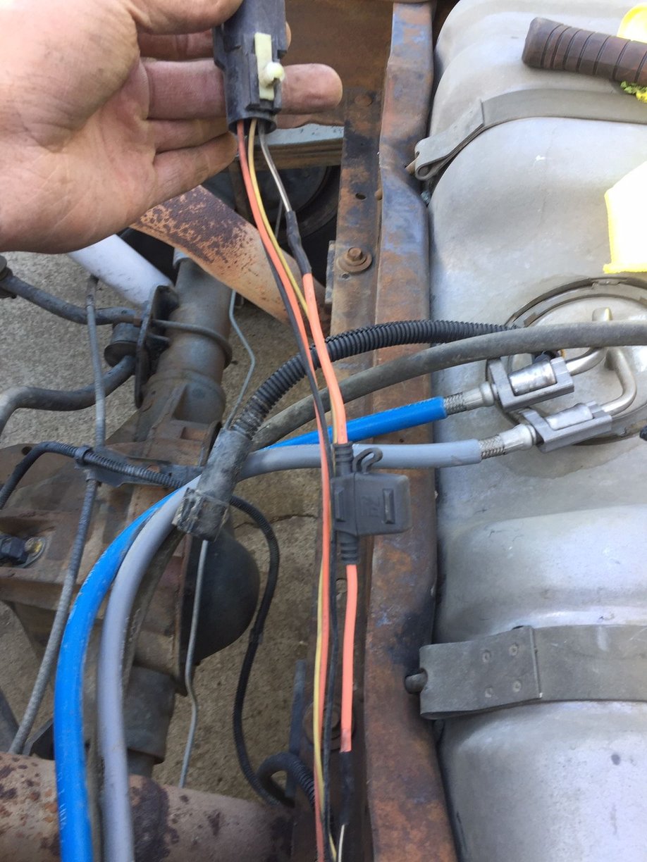

I read every line on this thread and thought I needed to up the wire size. I did some more digging and here's what I got; These pumps only pull 12.5 amps. The relay is 20. I bailed on the wire size increase. I wired in a 15 amp fuse at each tank. So far so good. They are MUCH quieter than I was expecting. I would put them right at stock (quieter if yours are dying). Check it out.

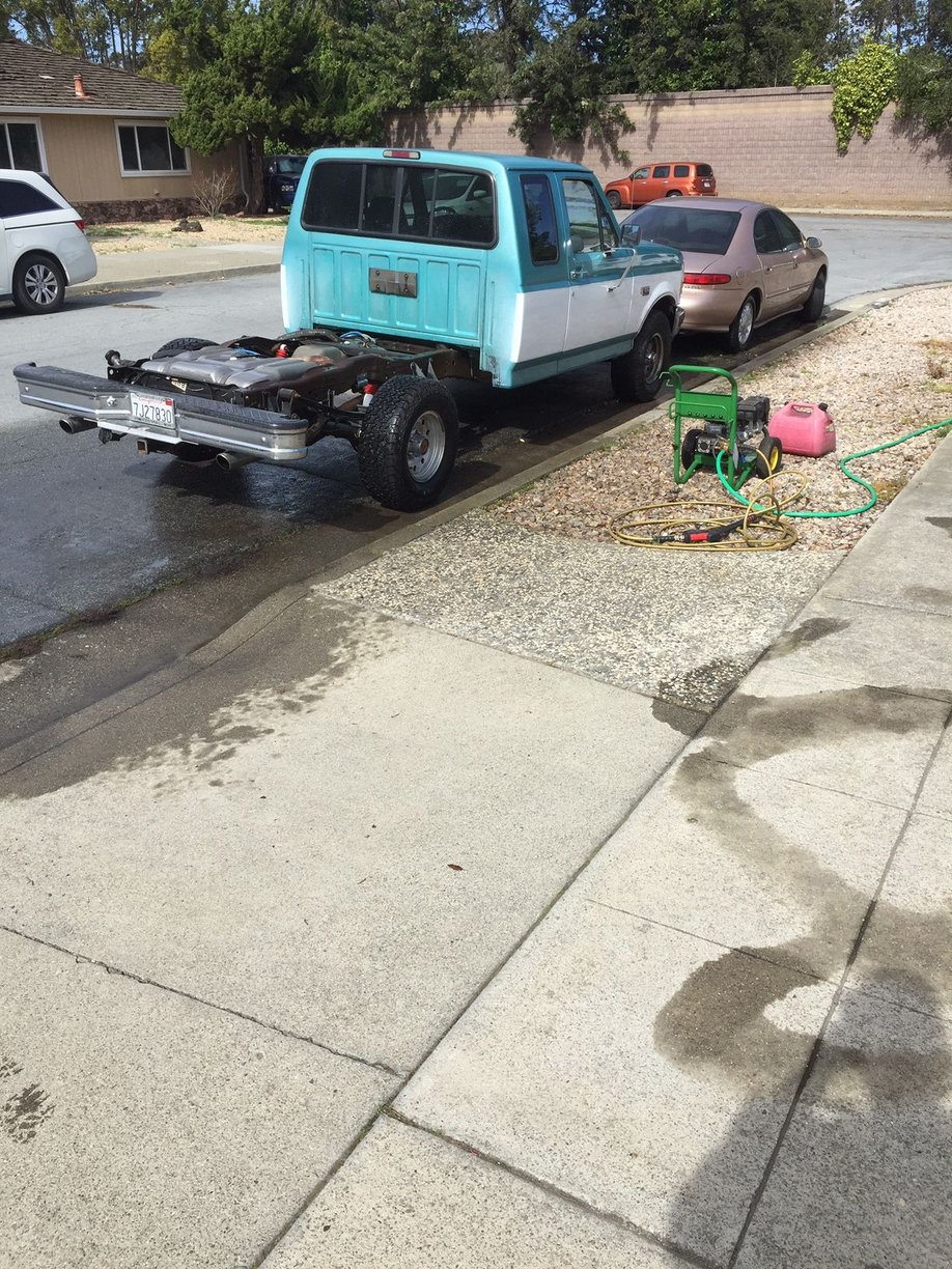

Neighbors starting to think I'm crazy
Cleaned up pretty good
Dogs aren't sure how they are supposed to ride on that.

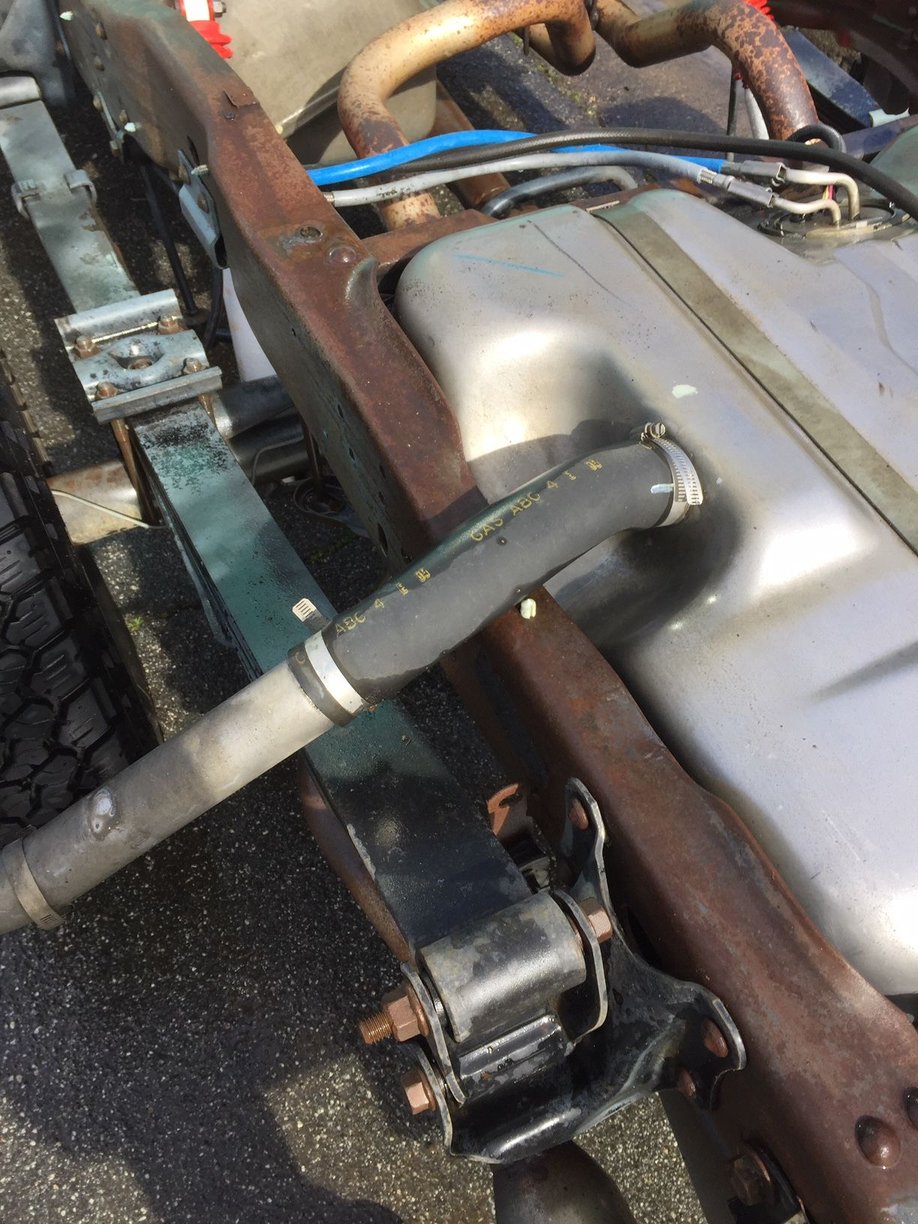

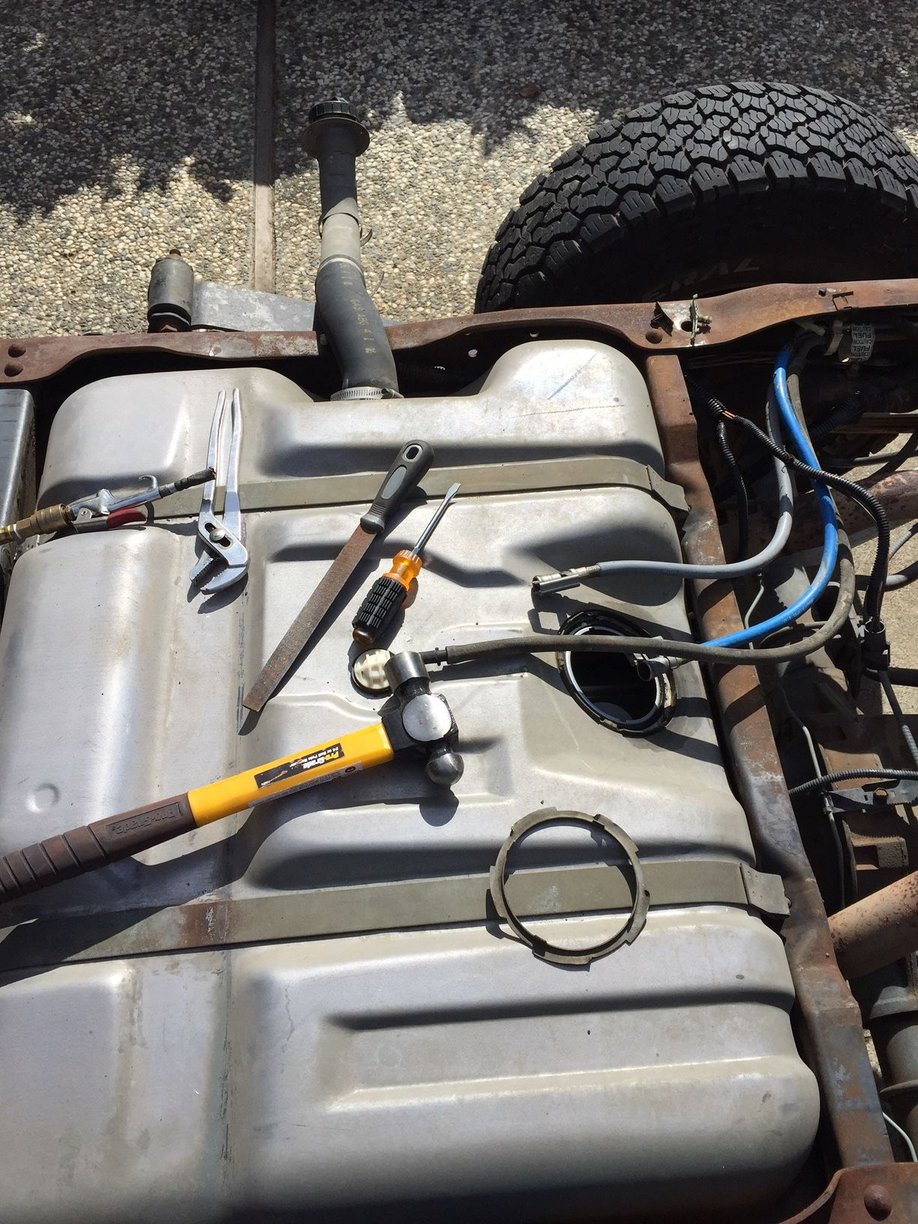

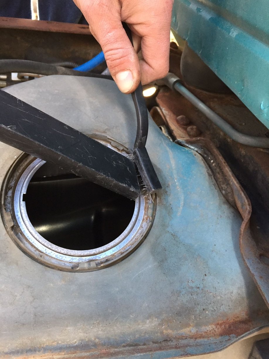

Carb spray, compressed air, and a vacuum BEFORE you pull that pump!
Pic out of order, but you get the idea.

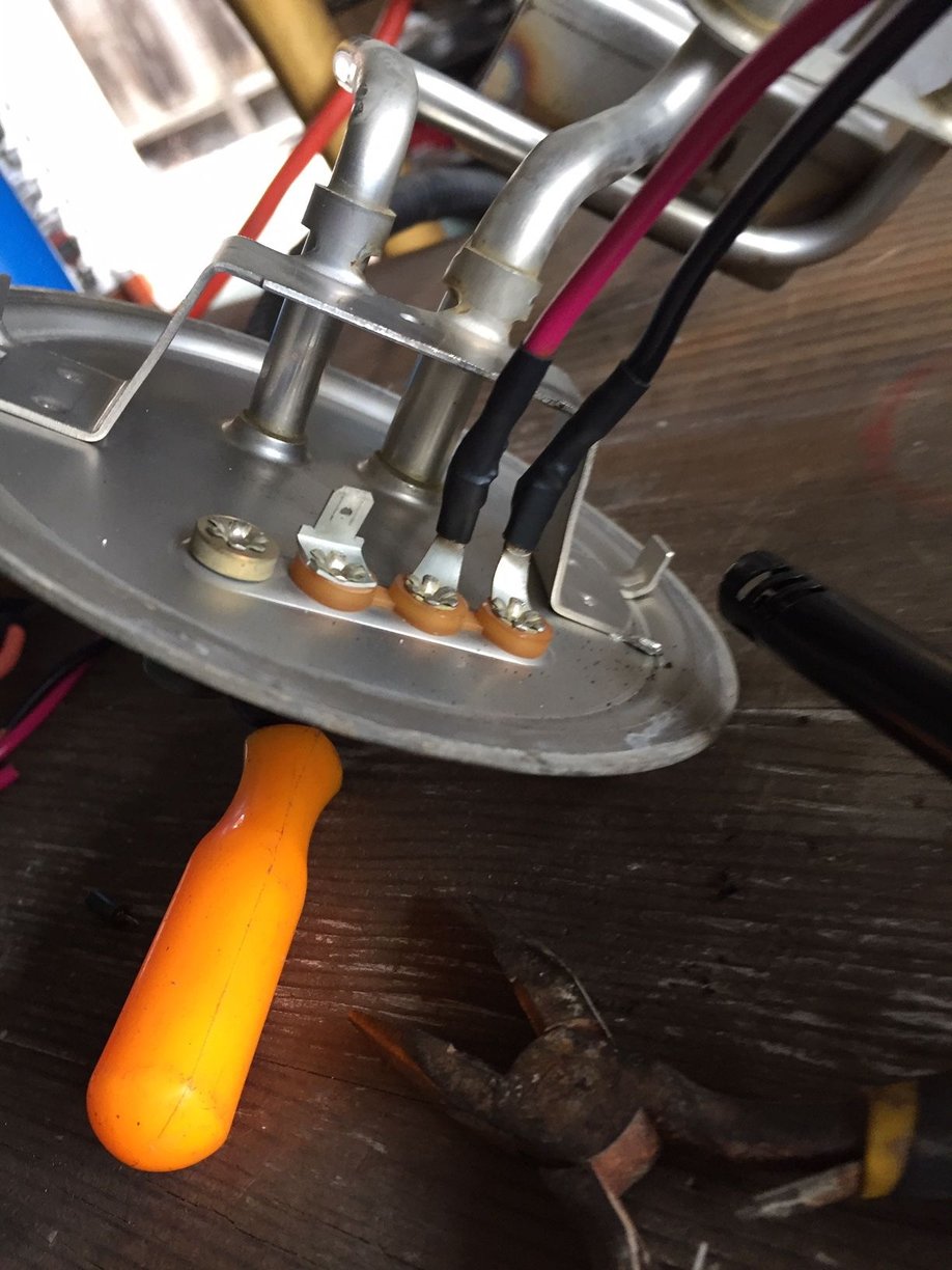

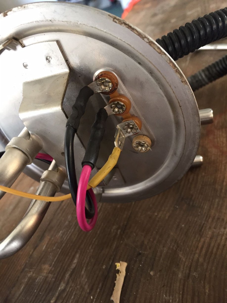

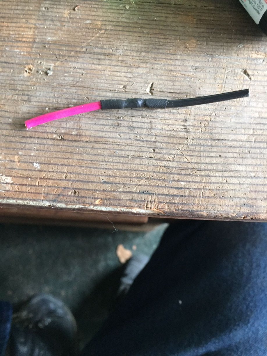

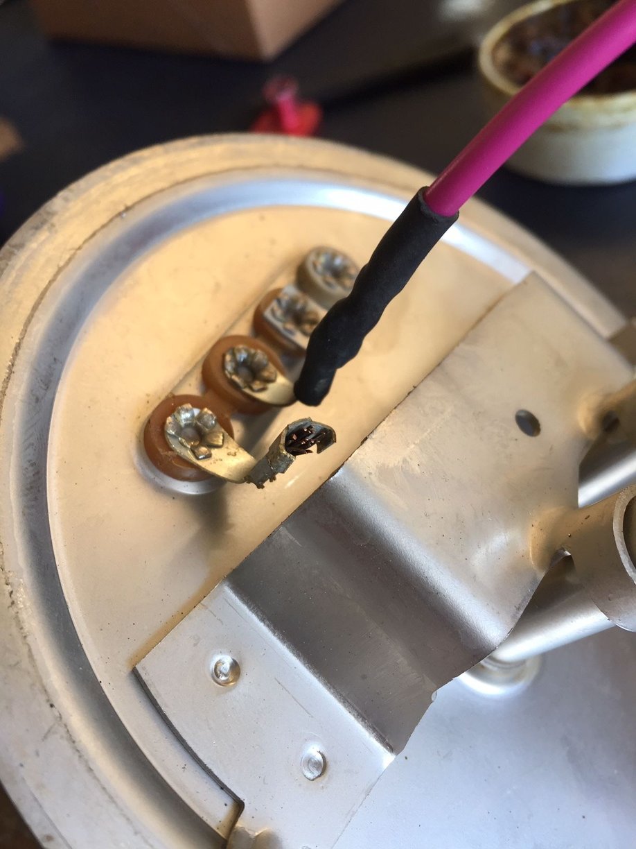

I torch soldered and heat shrunk both lines. Factory was only the hot.

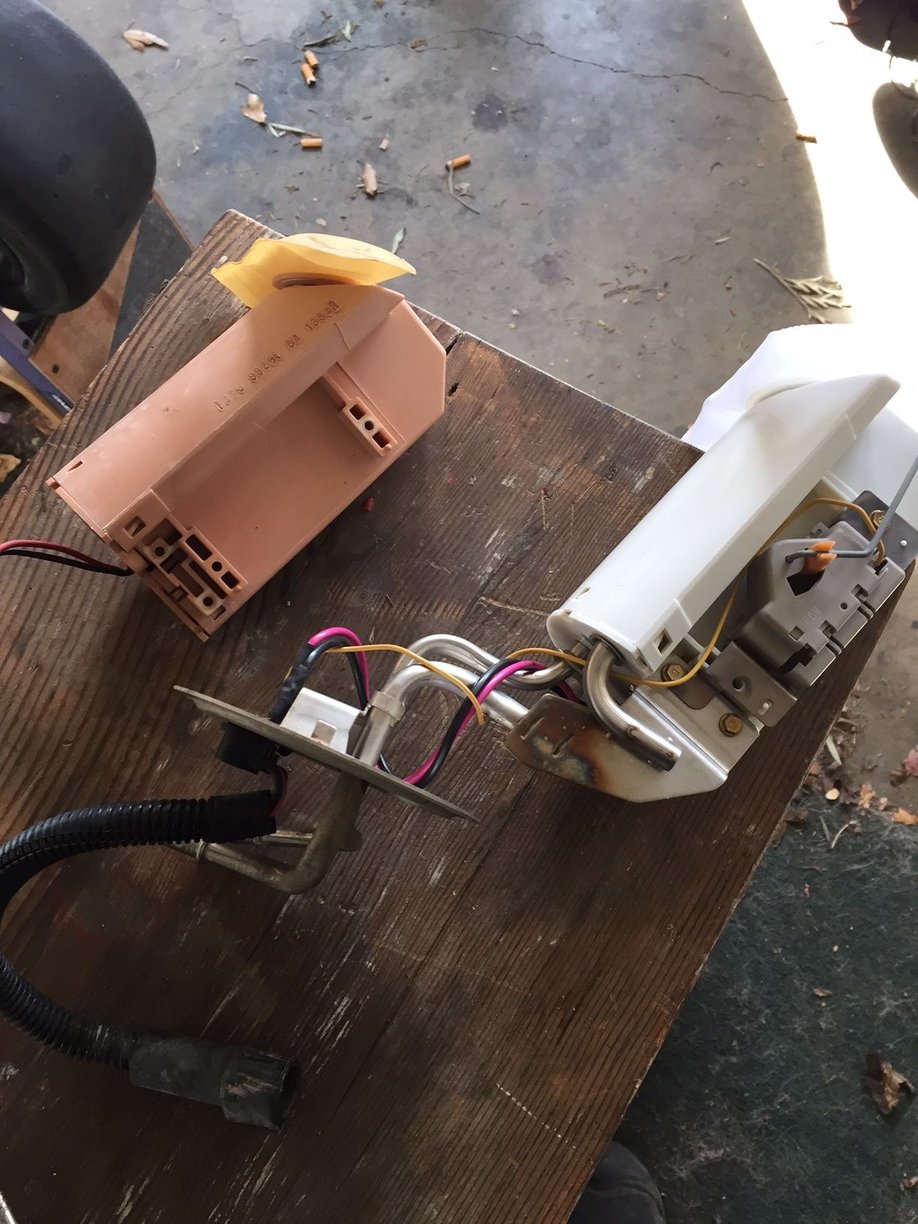

New unit was a great fit.
I figured these couldn't possibly hurt.
This will be my test piece. It's soaking in gasoline as you read this. The second I don't like how it looks in the jar, I will reassess.

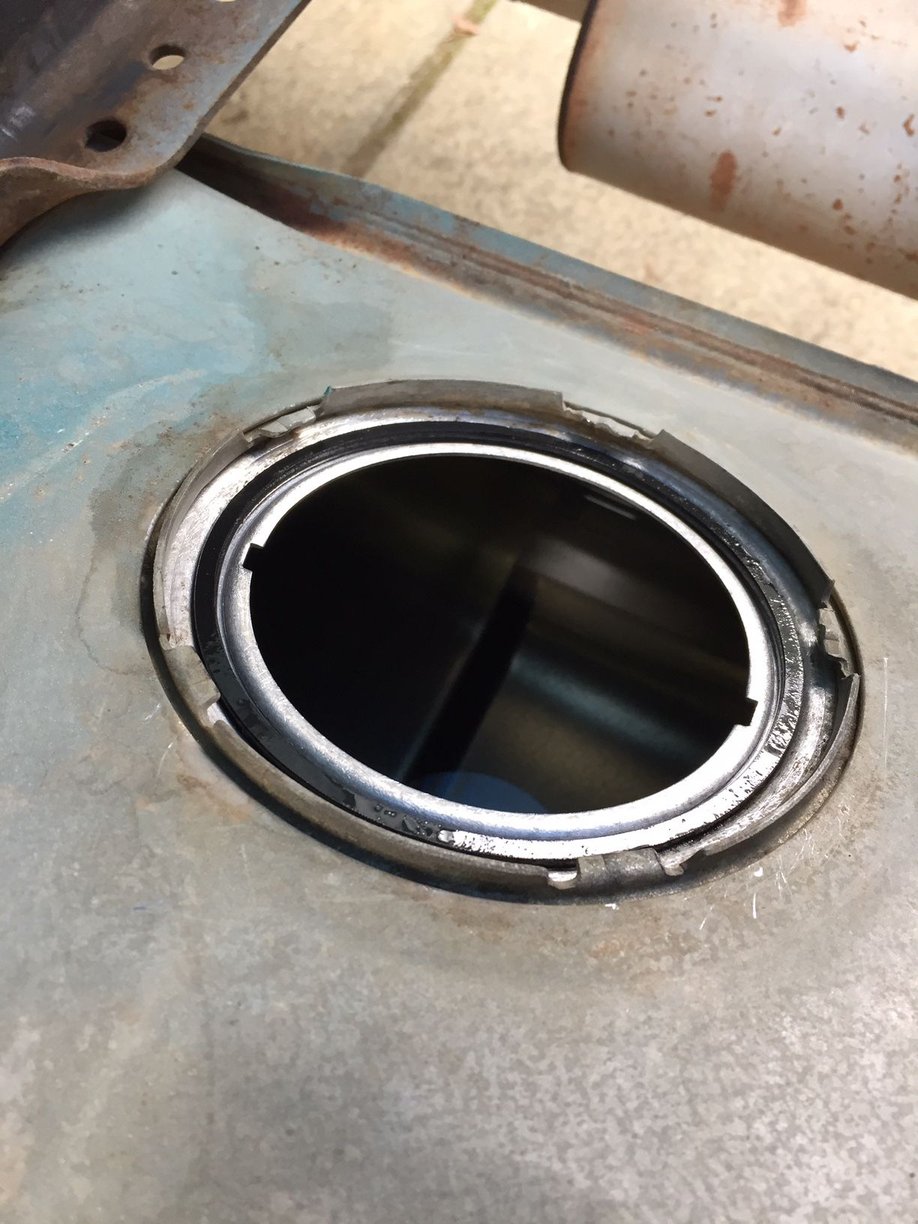

I intended on a new seal but the parts store only had one and wouldn't sell separate from the metal lock ring. Old seal was soft as could be so I saved $25 and cleaned up the old one. Use a little oil to promote seal and maybe swell a little.
The paint. always have to paint. Never on wires or liquid lines, that's just not tasteful.

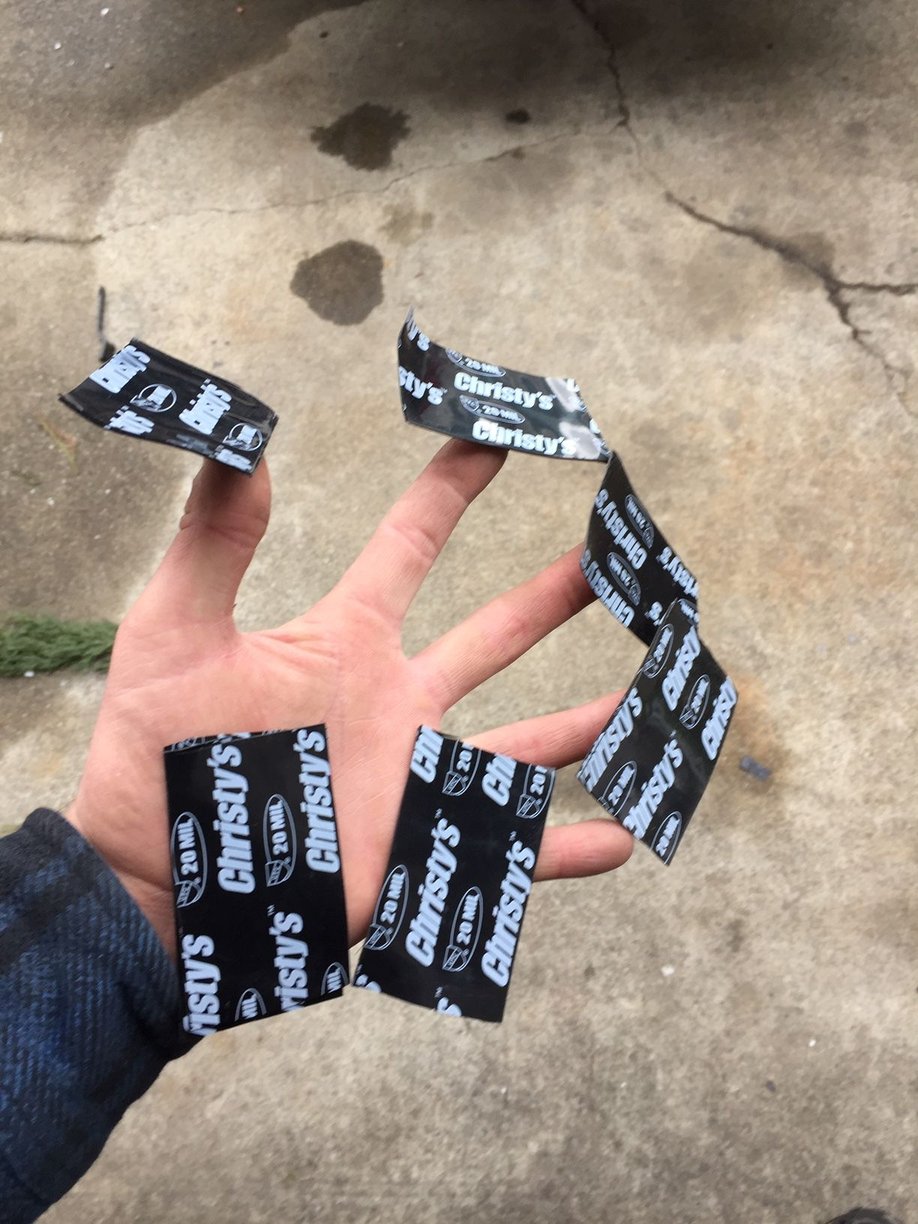

Two layers of 20 mil tape under each bed mount hole. I can't stand the the constant erosion of my precious bed supports and being constantly reminded by the friction noise.
I will update you guys if anything dies an early death or they don't pump as advertised. These were laying the foundation for this
Don't forget to test it all before the bed goes back on.
