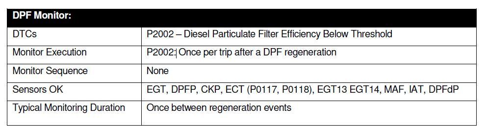

Here are a few of the P DTC's that start with "20"

But not always four digits just to be complicated, such as P208A.

Most of the P20* DTCs ending with two letters are reductant/SCR/exhaust aftertreatment related.
