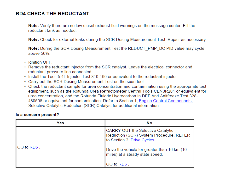

Originally Posted by senix
Interesting, don't recall but the code was just for the heater If I recall. Maybe the nozzle does not have a code itself but rather the pin-pointing testing would lead you in that direction?
P207F - Reductant Quality Performance
• Reductant quality
• Damaged SCR system components
• Damaged SCR catalyst
• Biased NOx11 sensor
• Biased NOx12 sensor
Pinpoint Test RD4 is the second step after checking for DEF contamination. I would guess the SCR Dosing Measurement test would indicate if the injector was malfunctioning.

The Bone's Avatar
The Bone
Joined: Feb 2015
Posts: 2,338
Likes: 255
From: Livermore Ca.
• Reductant quality
