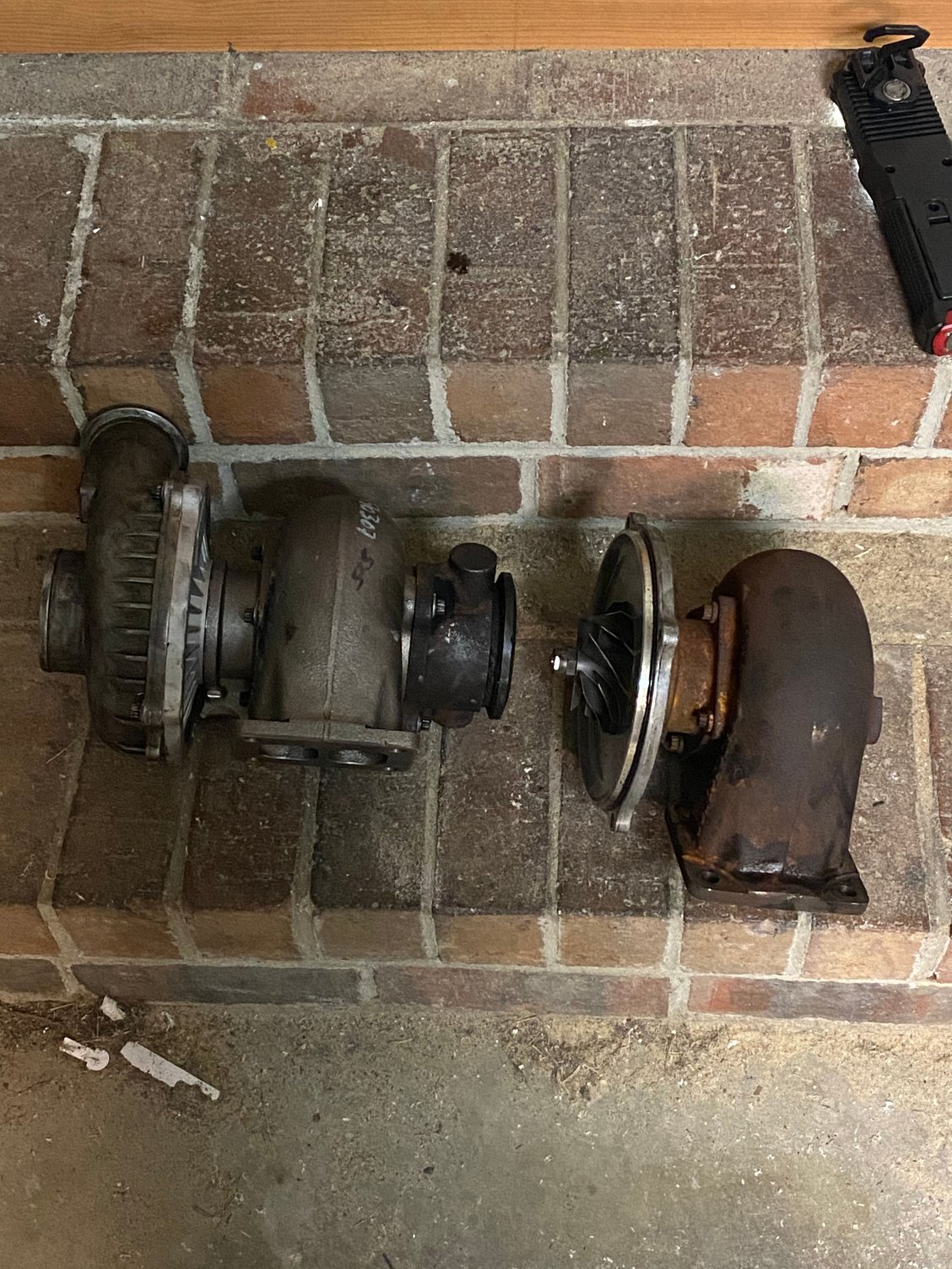

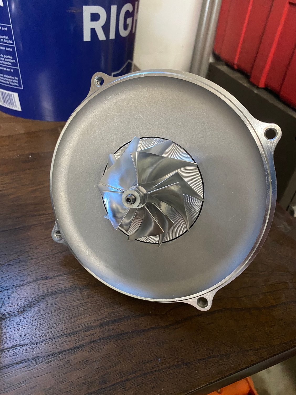

Pulled turbo and rebuilt it
Got my new cartridge in from Prosource Diesel. Included a 360* thrust washer and billet wheel!
Took about an hour to pull the old turbo and put the new one together (I’ve done it way too many times). Here it is all put together and ready to go on a pedestal and back in the truck. Hopefully this fixes my low boost issue.

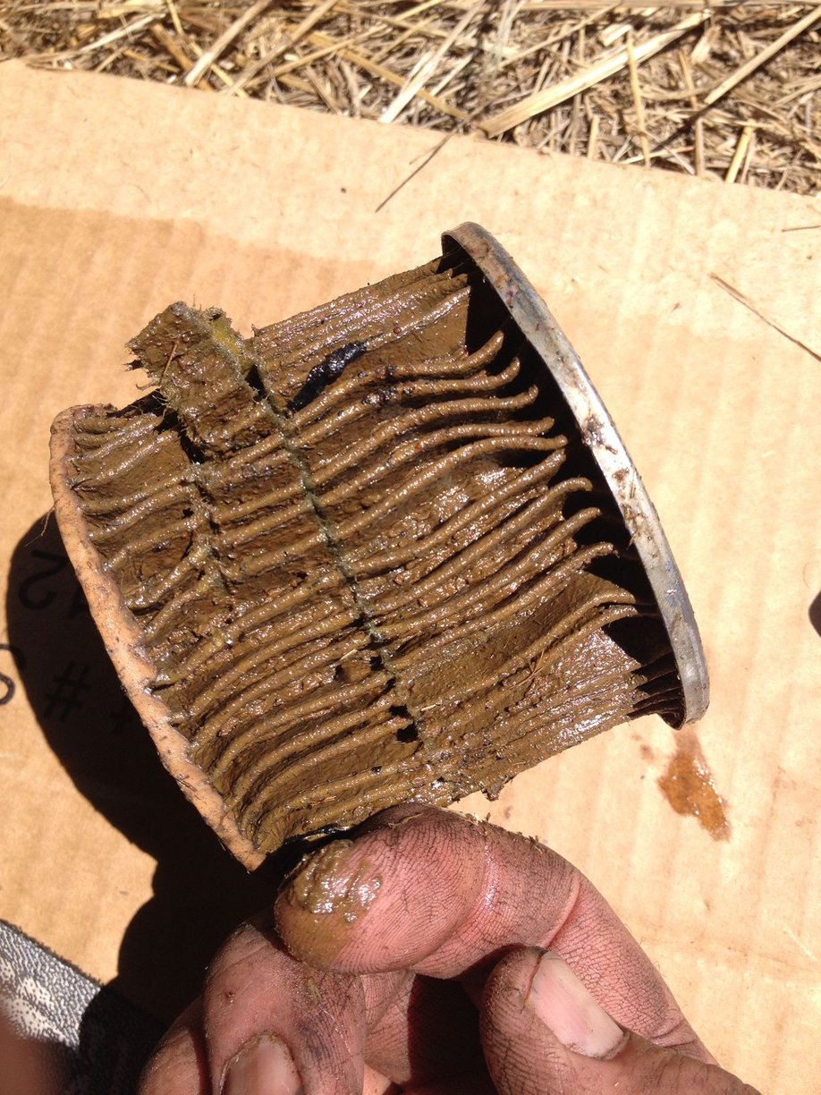

Filters are important!

I converted to e-fuel, so my filters are on the frame rail now.

That is actually a photo of Glenn's coolant filter. That is why he said they are important. That is how much silt he filtered out of his cooling system. @oldbird1965
Oh wow! My mistake! I appreciate @oldbird1965 showing me! Definitely moves the coolant filter up on the priority list. I’ll probably knock that out as soon as I finish this turbo and gauge install this weekend!
Mine looked the same! Gross.
