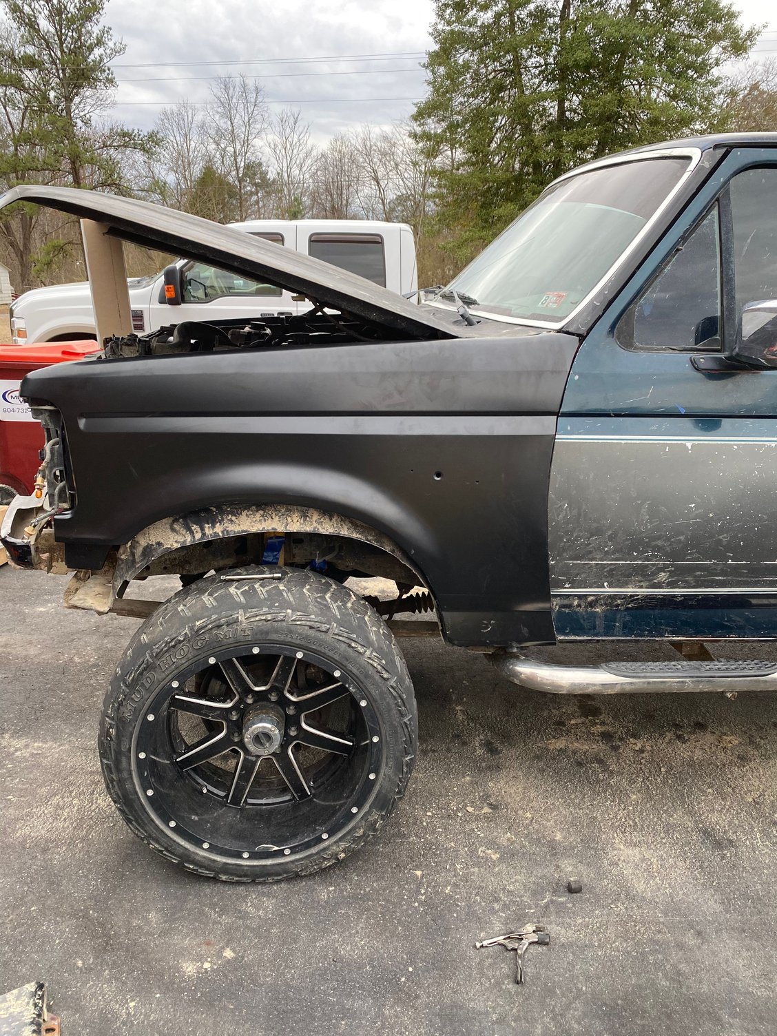

Got the driver’s side fender on. Trying to get the body lines straight. Realized how off my door was as well. Hoping fixing the pins in it will help!

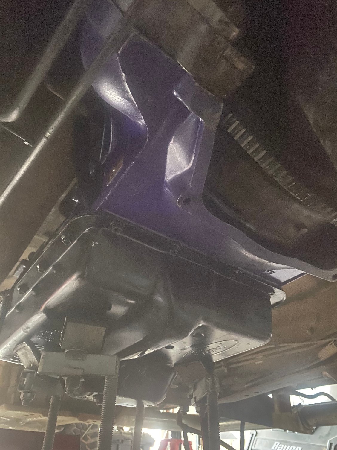

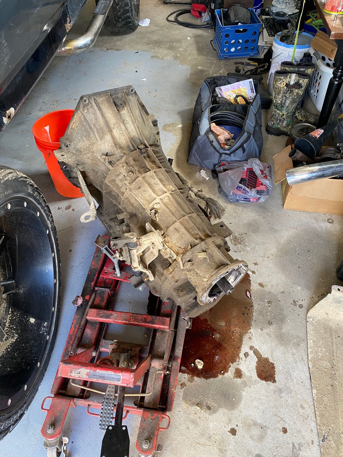

Transmission is almost done. Got an ATS transmission. Let’s see how it does. Transfer case was stuck and wouldn’t shift, but I got that fixed while it was out. Any tips on breaking it in and getting
it going would be greatly appreciated. Thanks y’all!
New transmission getting put in place.

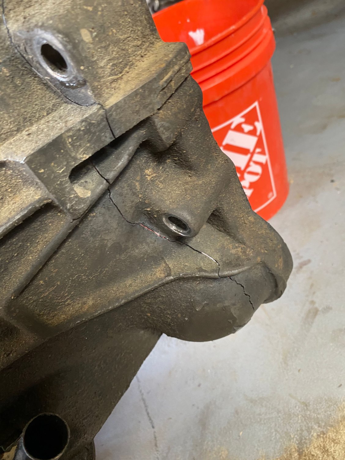

Bellhousing was clearly cracked. I had already peeled it off here, but the previous owner tried to epoxy the thing together.
Out with the old.

Transmission is complete. Will be starting it up and testing it out tomorrow.

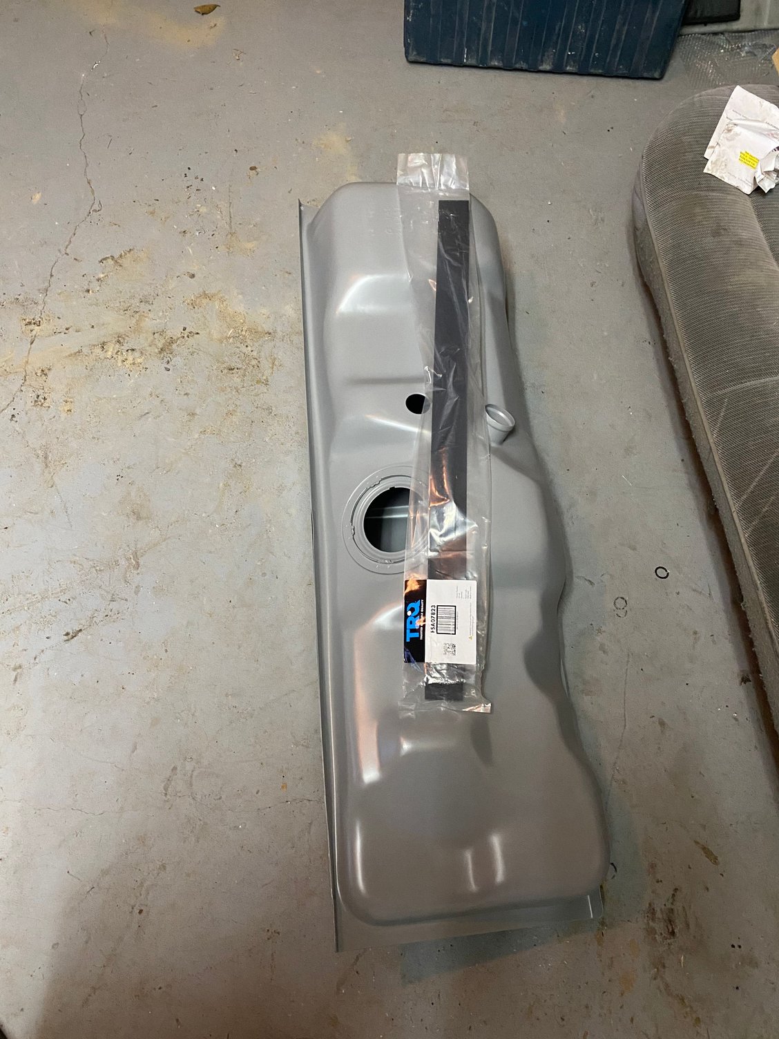

Front fuel tank
New front fuel tank is in. That and the
broken leaf spring hanger will be replaced soon.

Thats a shiny fuel tank. Mine looks like aids on the the outside, lord knows what the inside looks like.
The epoxy on the bellhousing is hilarious. I've epoxy on lots of things but never to hold a transmission together.
Hahah my current tank isn’t looking too hot either! And I’ve never in my life seen someone try to epoxy a bellhousing either, but I reckon they did what they had to. I bought it planning on replacing the transmission anyway, so no big deal.

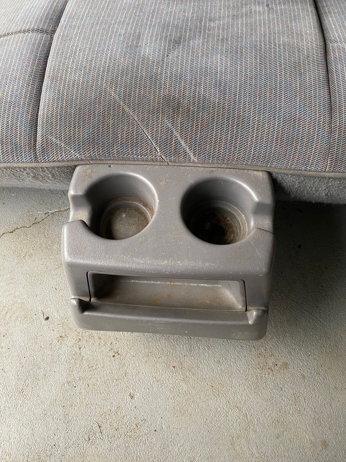

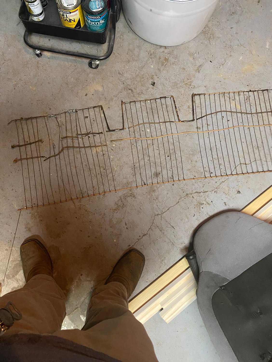

Seat repair and cup holder find
Finally got around to repairing my bench seat and finding a stock cup holder.

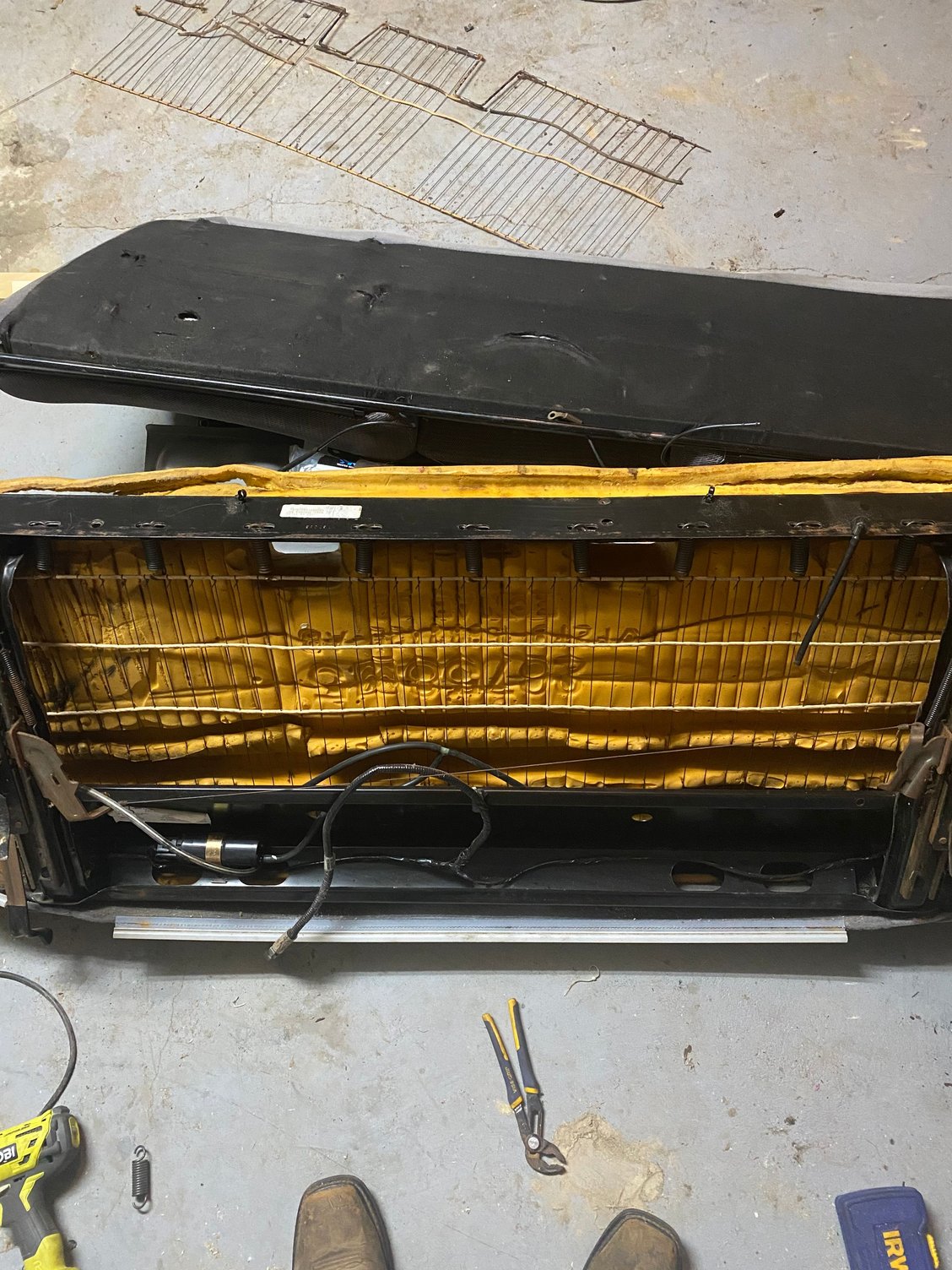

Here’s the stock lower support assembly. I tried wiring it up previously, but it didn’t do the trick.
Here’s the new one installed.

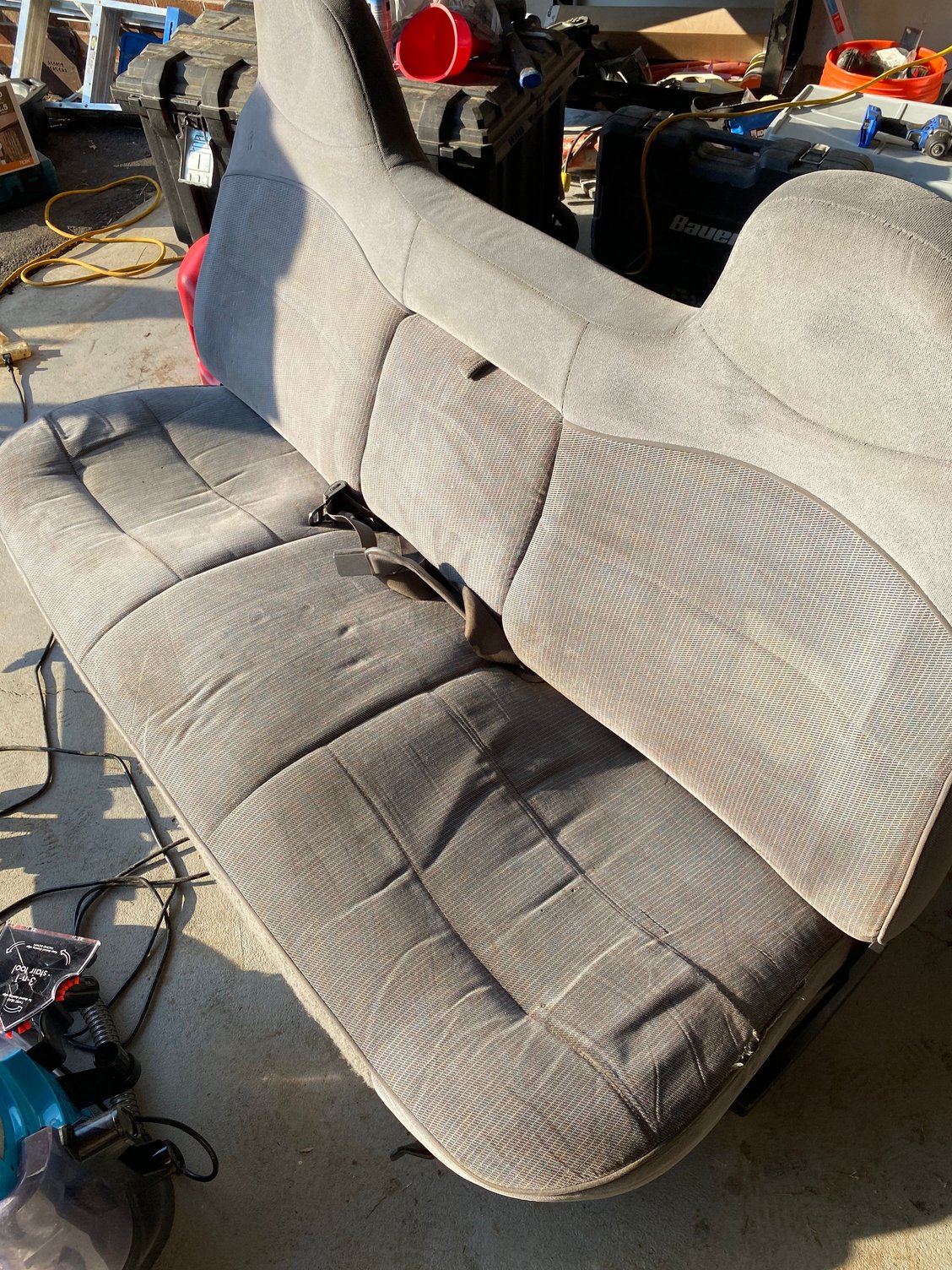

Here’s the seat all repaired. I had to stitch a huge tear in the back but didn’t get a picture.
I found some stock cup holders finally for less than the normal going price of $100 on e-bay. They need some cleaning, but they’ll be just fine.

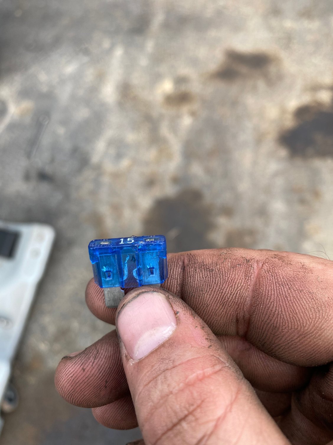

OBDII port wasn’t working when I tried plugging in my EDGE monitor. Easy fix. 15amp fuse in the #16 position in the cab was blown.
Old May 27, 2021 | 07:39 AM
  #59
BBslider001's Avatar
BBslider001
Joined: Mar 2012
Posts: 10,590
Likes: 382
From: Texas
Wonder why that fuse was blown? Hopefully doesn't do it again. Nice work!
I believe the previous owner had a bunch of LED lights plugged in and blew it. It’s not blowing anymore without the lights in luckily.
