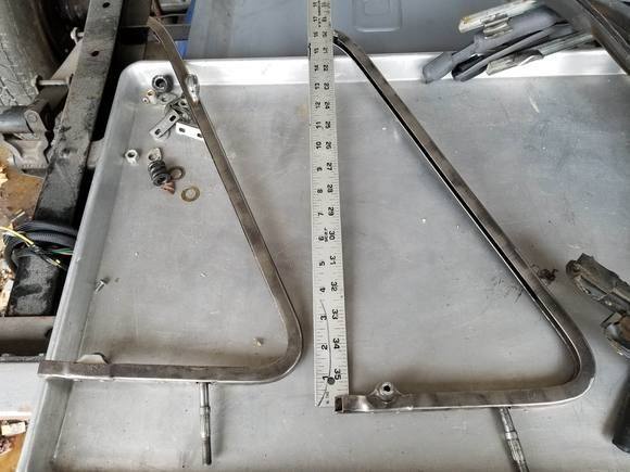

I am trying to get my vent windows outs on my doors. I have everything out of the door, window, lock and locking mech, window regulator, separator bar...but how do I get the vent window out? Looking at videos and threads, once all these other parts are out, does the vent window just slide out into the space that the door window once was? I am trying to reuse the frame, (the vent window itself is cracked) so I don't want to damage the frame if possible, but I just don't see how it comes out. Is the top hinge held in with rivets?
Any suggestions? or links to videos?

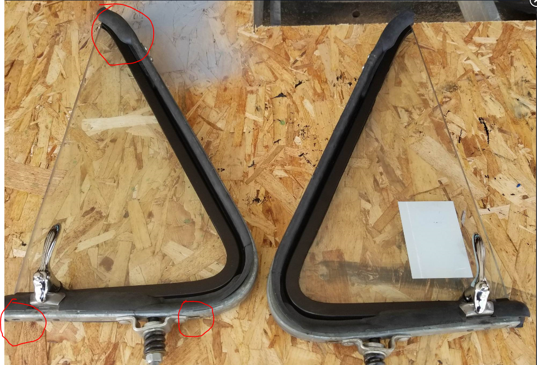

There are if I remember correctly 3 small screws buried in the rubber seal that need to be removed. they hold the vent in the door frame I have circled where they should be. open the vent window and look at the seal in those 3 spots. Once removed you just rotate the assy aft and pull it up from the door.

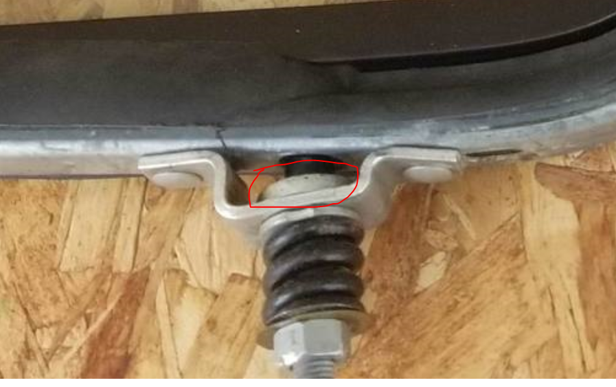

the cam is the item circled in this pic. Once window is removed you have to remove the pivot arm at the top...mine had screws, but i have heard some are riveted...so you can slide the window out of the frame. the cam is splined onto the shaft and will pull right off.
