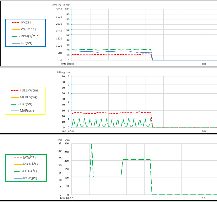

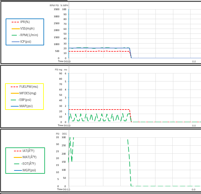

jstihl was having some issues identifying the log files on his local machine, so I offered to help him out. He sent the log files to me via email and I have attached the "jstihl ICP Plugged In" chart and the "jstihl ICP Unplugged" chart. I have also snipped a bit of each chart and pasted them below.
This image is from the "jstihl ICP Plugged In" chart.
This image is from the "jstihl ICP Unplugged" chart.
Just looking at the chart and the PID's that were logged, jstihl I need you to double check your settings and selected PID's against what I have indicated in the instructions for creating a log.
The instructions can be viewed in PDF format by clicking this link: https://www.ford-trucks.com/forums/a...0&d=1600131728
Not a big deal, but if you can pay close attention to page two in order to set the csv delimitator to "comma" as shown in the instructions, that would help for future logging charts.
Proceed down to page 9 where I have indicated some of the PID's that are critical to select when logging data. A couple of them are a bit tricky, but they have all been identified very specifically on page 9. In my opinion, I believe this is why your EOT end EBP were all over the place in the charts. Once we make sure the correct PID's have been selected, we can start to pinpoint the problem.

Thank you for taking the time to chart these logs sous, I do appreciate it! I will double check but I'm almost positive it was on the comma setting. I will also go through the instructions and figure out what I did wrong. I did notice the engine oil temp was very rapidly going all over the place when rewinding through the log slowly but did not notice this at all when the log was being recorded.
Would you like me to log all the pids that are on page 9 of the instructions?
