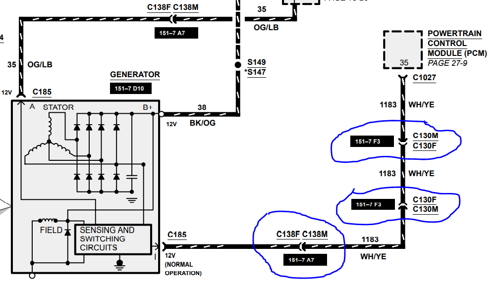

There are some connectors on the "I" circuit between each alternator and the PCM. Maybe one or more of these, or the wires between them, are why the voltage does not get over 12V.
Could someone post the connector locations on the truck for the upper and lower alternator "I" circuits circled on the schematics below?
Lower Alternator I circuit
Upper Alternator I circuit

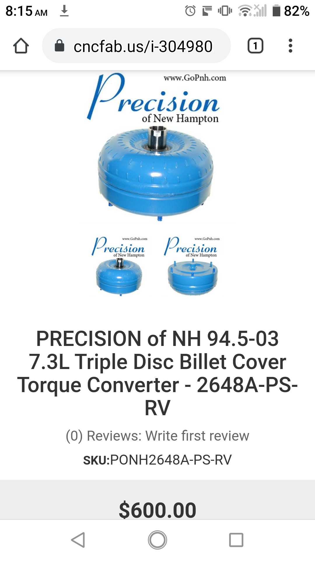

Boy, this seems familiar to me
Pic is of a message I just sent the other day....
Dont know why I typod flywheel, meant flexplate

I find it hard to believe it is my issue, going to take a closer look at it this morning.
Last winter I installed a new flexpate and low stall converter, would liketo think that I would get more then 5k miles.
I have no reliable local shop, so I get to do it all myself....
Hopefully this takes care of your issue.

I will have to check. Pins and everything seems to line up good. Original e99 flexplate was fine, just wanted to replace with new when I did the converter upgrade.
These are what I used in addation to a JW VB
