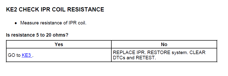

If you have a multimeter you can test the coil on the IPR for resistance.
Performing this check will not tell you if the IPR is working mechanically, but it will allow you to check one more box as not the problem.
