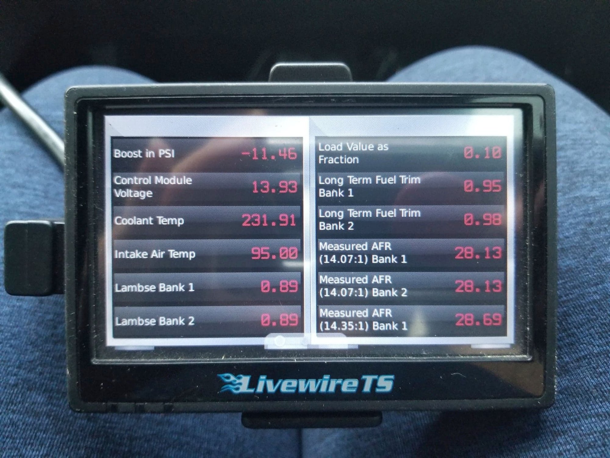

I will check and let you know ASAP
Originally Posted by ford390gashog
What is the transmission temperature? Seems like you don't really want help here. If the trans is 215 the engine should be right at 210, these engines keep a tight delta and this is why I mentioned earlier that the temp sensor is known to be wrong and causes false overheating. The trans is a good indicator because it uses a package oil to water cooler so the temps are easy to trace.

All I got for now. 85 degrees out today, driving home from the store, not particularly hard, this is right after boost come off.
