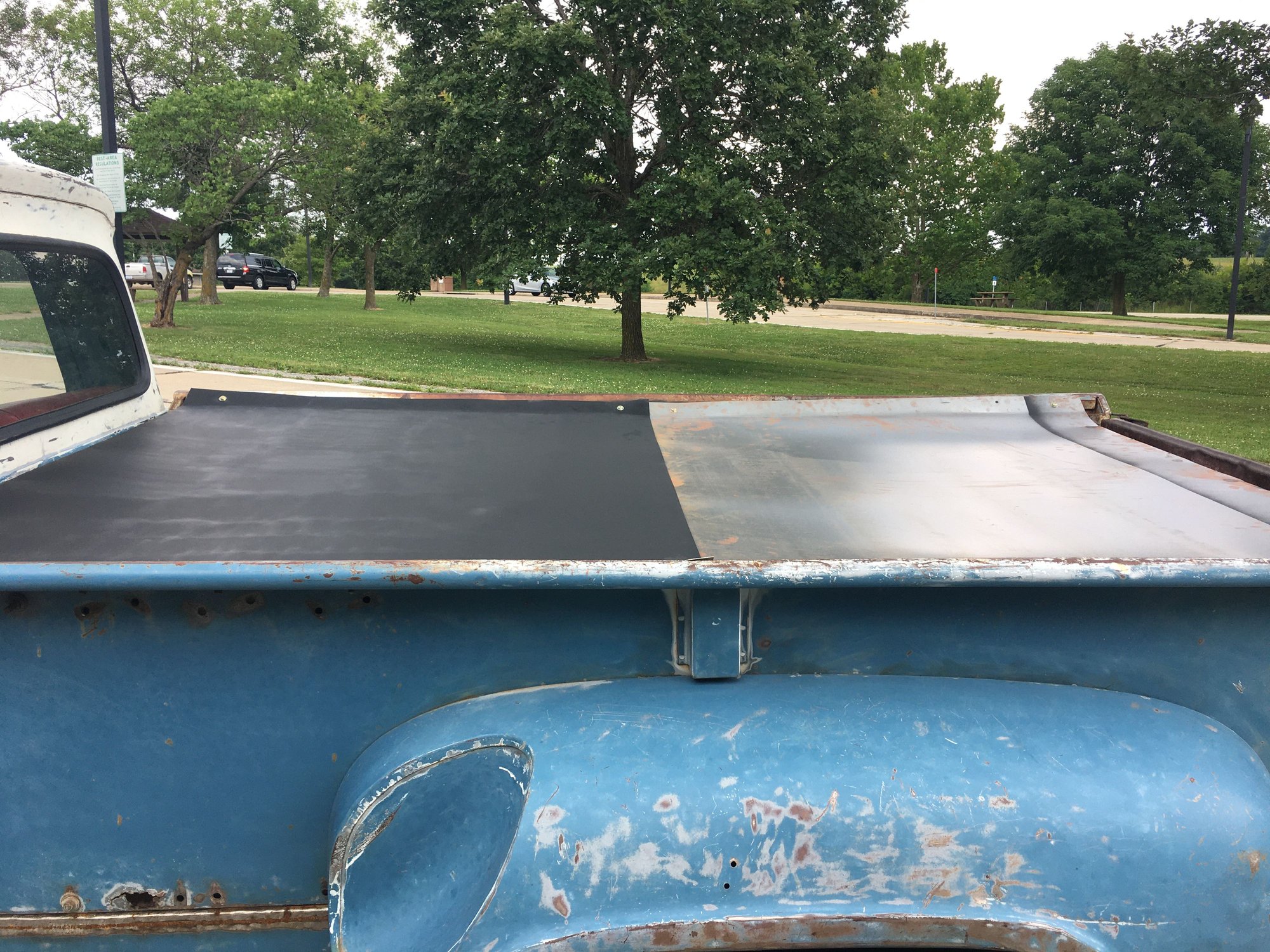

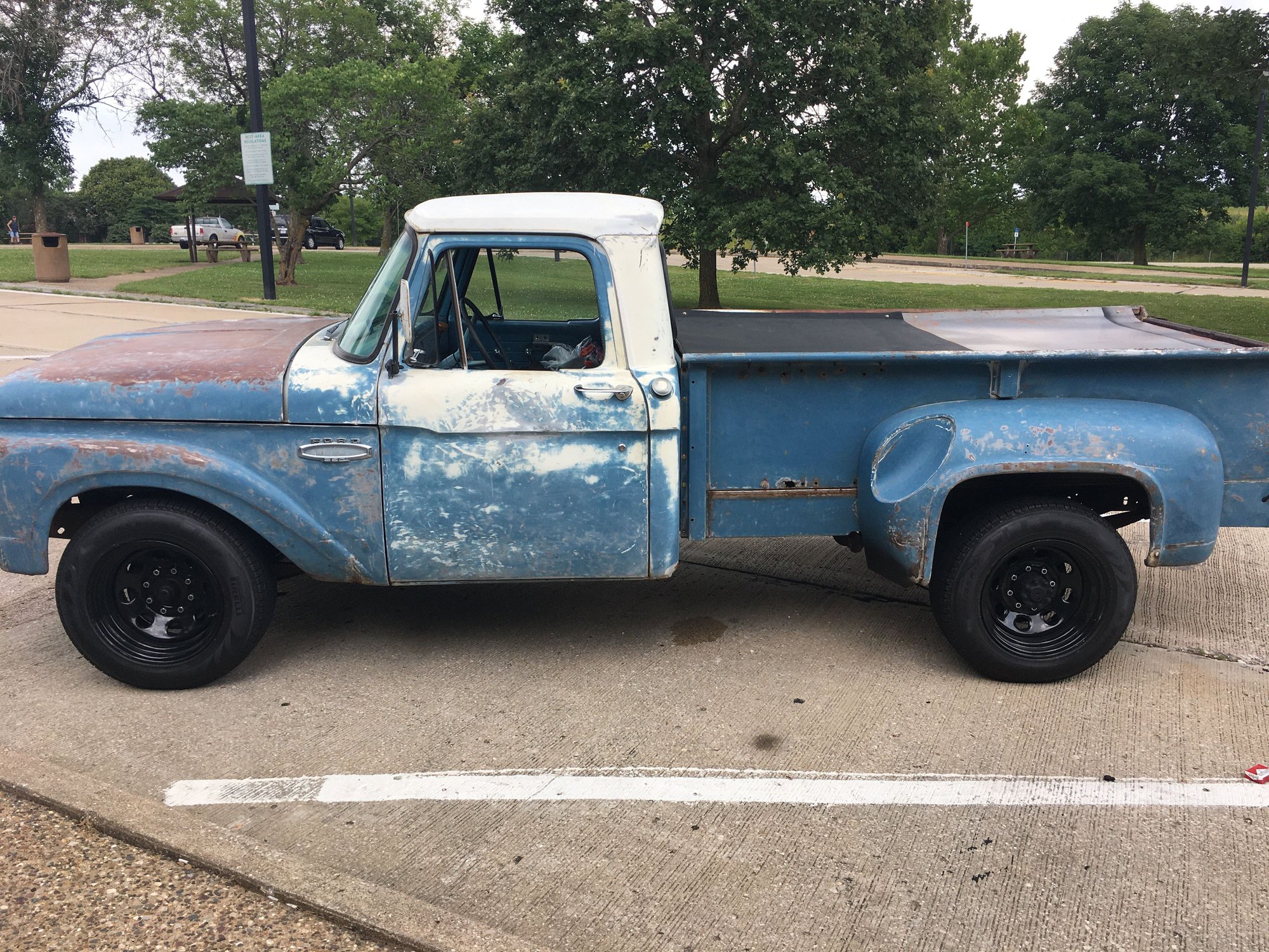

Here are a couple more pics to keep y’all happy. Side view so you can see the new wheels/tires. I went ahead and spent $60 to get a sheet of 20 ga mild steel and made myself a little bed cover for the trip. Helps with aero a little bit, but mostly good for keeping things in the bed and dry. Painted the forward half matte black just to keep the glare down. Didn’t feel like doing the other piece. It’s two 4’ sections.
