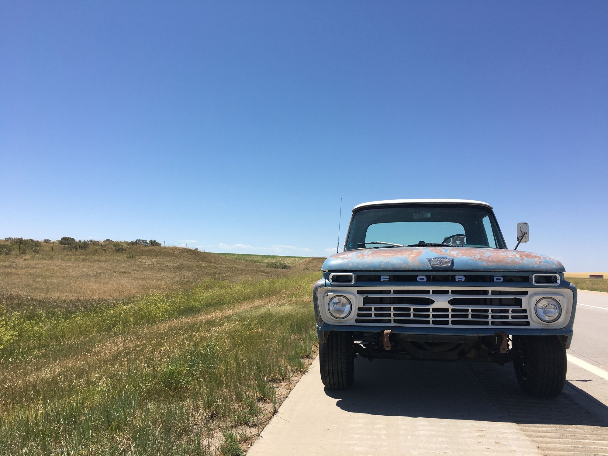

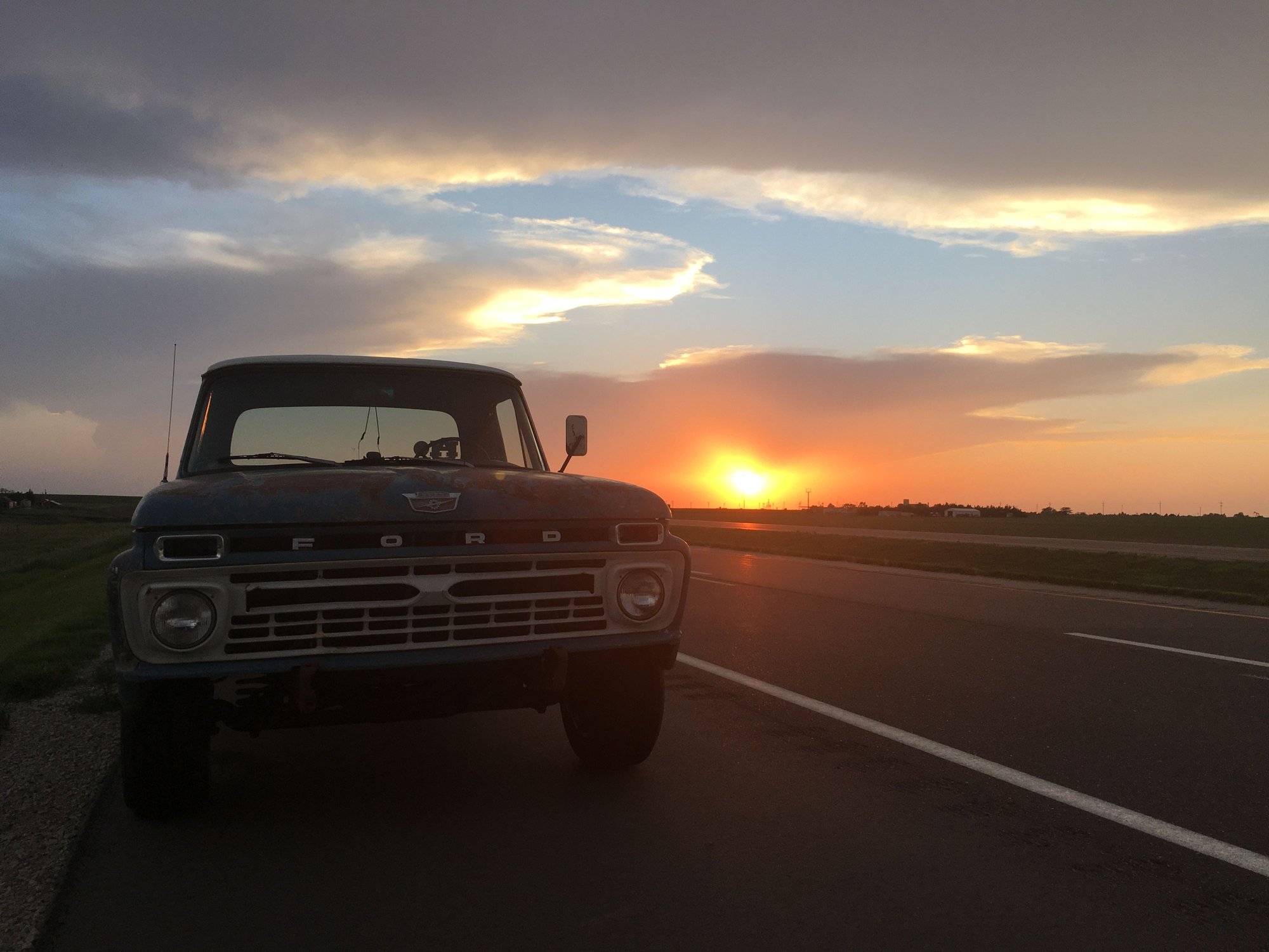

At least I got some good pictures out of it
