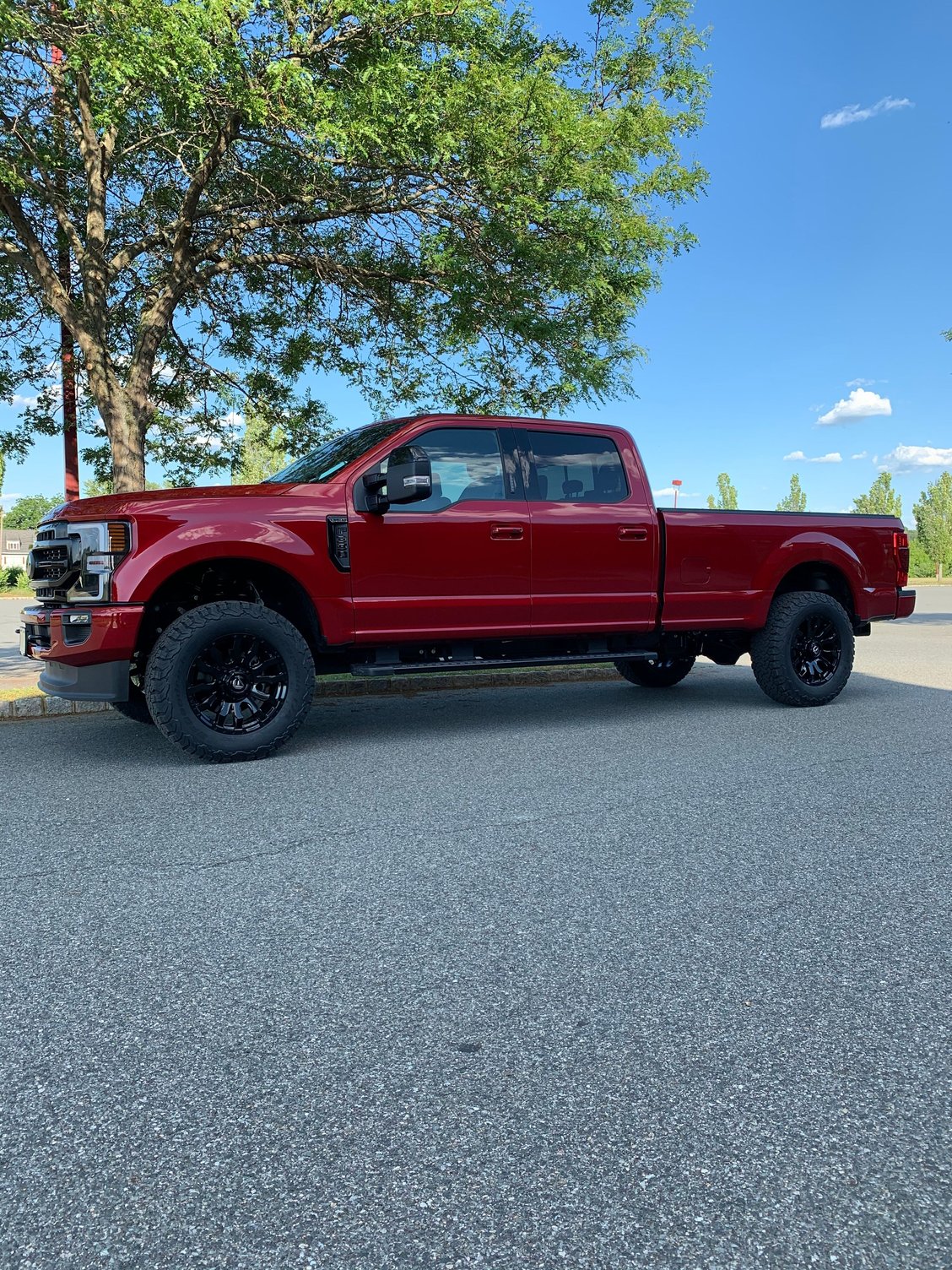

nope I don’t. Also this one is the 3.55 gear option
thanks !

Cool..... is the axle still centered ?

Yes. It didn’t change it, I told them if I needed to I would buy an adjustable track bar. But didn’t end up needing it.

That is great to hear. I have the snow plow springs so should be a lil higher up front. Going with 20x9 +20 fuel blitz with 295/65r20 KO2’s
Very cool to be able to see everyones trucks before. Makes decisions much easier.

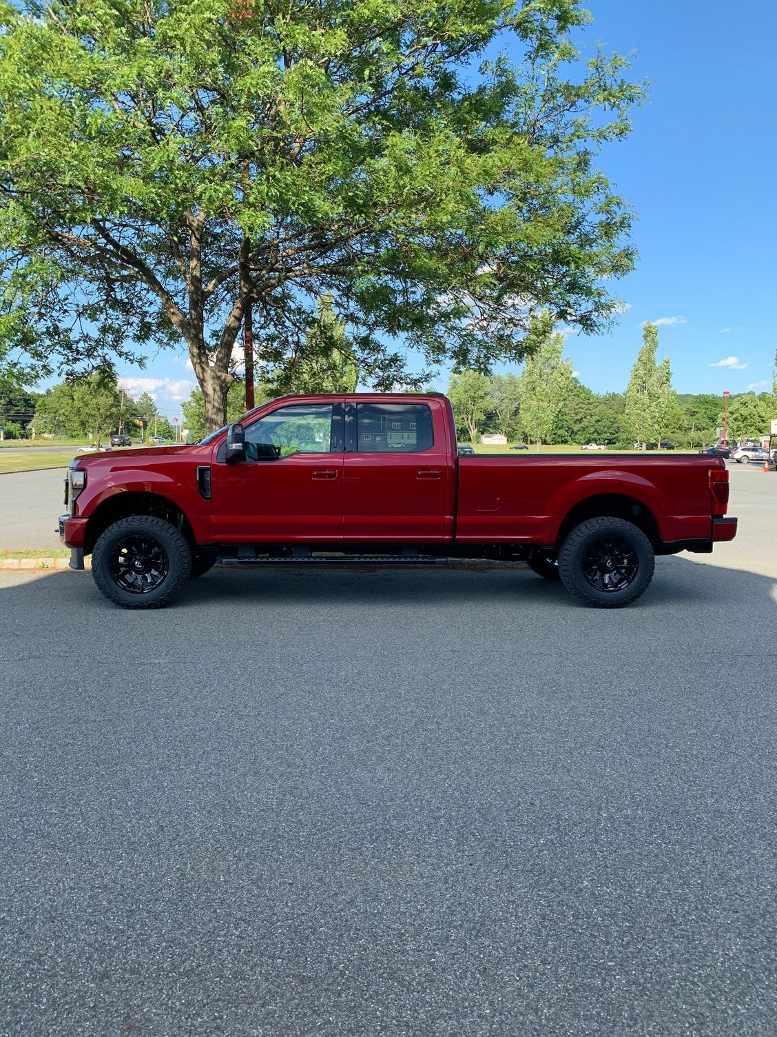

1.5” level, 20x9 Fuel Blitz +20 BFG KO2 295/65r20 Rides like stock.

the 1.5” level is definitely the way to go on the 2020 super duty in my opinion....maybe 2” at max....anything higher appears to be “nose high” from what I have seen...

I agree ...... I have the snowplow springs and it still a lil rake. I like it. Perfect for me.

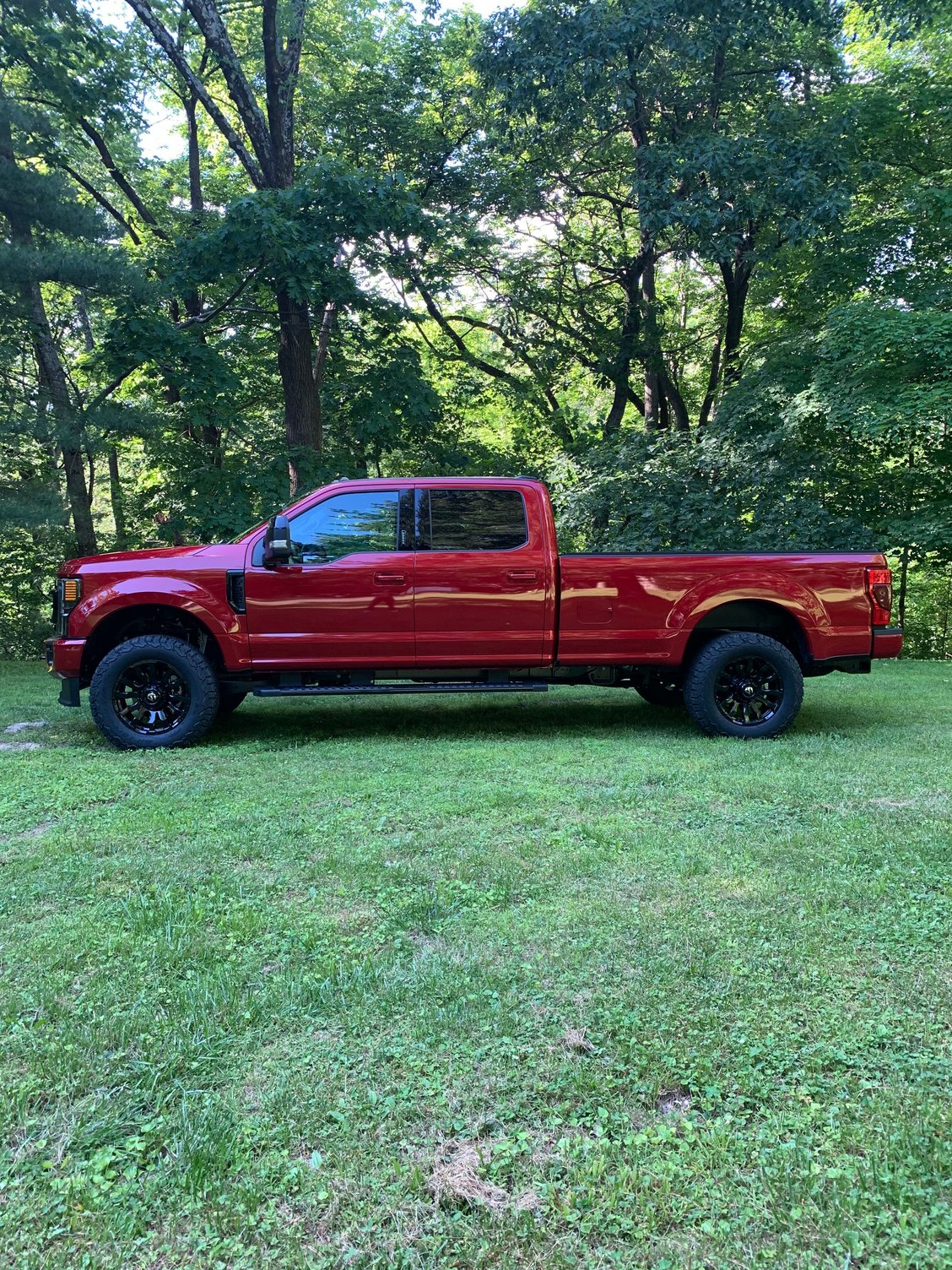

Here is my 2020 7.3 Platinum with a 1.5” level kit from ready lift. Only level kit and alignment was done, no track bar or anything else was needed. Can’t tell a difference in ride quality from stock. Tires are 35x12.5 ridge grapplers and wheels are oem ford wheels that usually come on the lariat sport.
Can you comment on rubbing with the lariat sport wheels? I want to do the exact same on my 2020 and would like to know how much rubbing will occur on the radius arms and sway bar. Thanks!

no rubbing at all.
