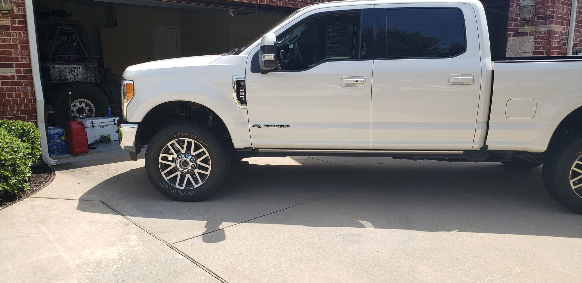

I went with Rough Country under-spring 1.5" puck, Carli 1 degree castor shims, a Readylift adjustable track bar, and Fox 2.0 shocks. I wanted the truck to drive as close to stock as possible so I did the shims and the track bar. Definately not needed though.

What size tires did you go with? How is the ride compared to stock?
i like the way your truck sets. Looks great!

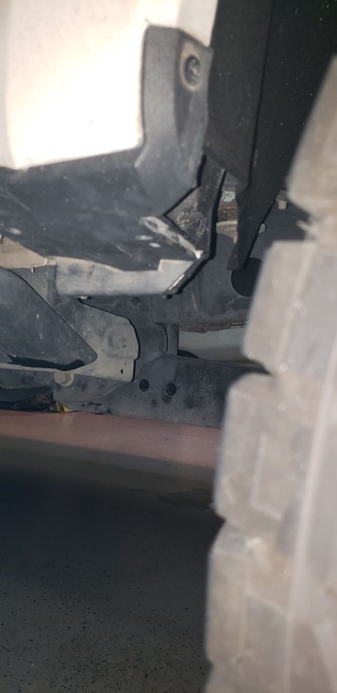

I could be WAY wrong, but I think the 20's have shorter springs but the same mount of bumpstop as previous years. Meaning the tire will stop, with regards to up travel, in the same spot on a '20 as it does on the '17-'19's. I didn't add any bumpstop to mine but did have to cut quite a bit of plastic and metal at the back/bottom of the wheel well opening as I had a lot of rubbing with the wheels turned and any articulation. My wheels have 0" offset. With a factory rim, it wouldn't rub there.... just on the radius arm and sway bar.

Looks great, how much did you need to trim? Have pics?
Here's the only pic I have on my phone. Someone told me, the 1st cut is always the hardest and the 2nd is always the largest.....
Old Jun 1, 2020 | 08:46 AM
Joe T's Avatar
Joe T
Joined: Mar 2017
Posts: 10,172
Likes: 1,376
From: Chaz
Ah ok, a new fender liner would put it back to stock.
Did you have to beat any metal in?
In the past I have just used a heat gun and massaged plastic in. I am going to be running a similar combo, same wheels and 1.5 inch coils. Trying to decide on tires.
