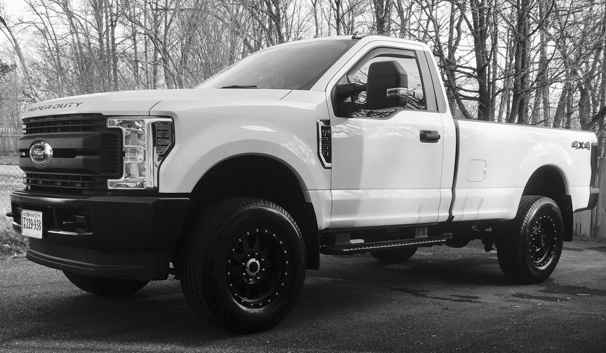

I am running a 1.5 block kit by ready lift without the trac bar adjusted. I do have one wheel that sticks out & plan on addressing it, but at the time that I did mine, there where not many options. You will have to have an alignment.

I have the readylift 2.5 on my truck. It is perfect with about a 1/2 to 1" of rake still. I will say I ordered the track bar relocation bracket to add since the level kit does slide the axle to the driver's side and the wheel sticks out 3/4". Once it warms up I'll install it. Others have said it realigns everything perfectly.

I have the 1 1/2" ready lift block and I did the track bar bracket, it did pull the axle back to center. I also needed the caster camber kits to reach alignment. My front measurements are now 44 3/4 and rear is 45 1/4" sits perfict. I also have the snowplow package.

Puckett
Those flairs look great.

Nice looking rides, and level too, lol. Thanks for the info, now I can plan this task.
