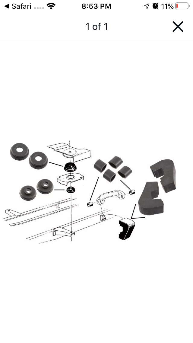

I got the call my cab is done. Haven't picked it up it and I still need to get my old cab off. Is there any rubber pads between the cab and frame? Or does it just sit on the front cab mounts and the rear mounts? What do I need to put the new cab on and the inner fender wells, fenders and lower gravel pan and grille?
Think you may need these.
Numerous suppliers stock them.
