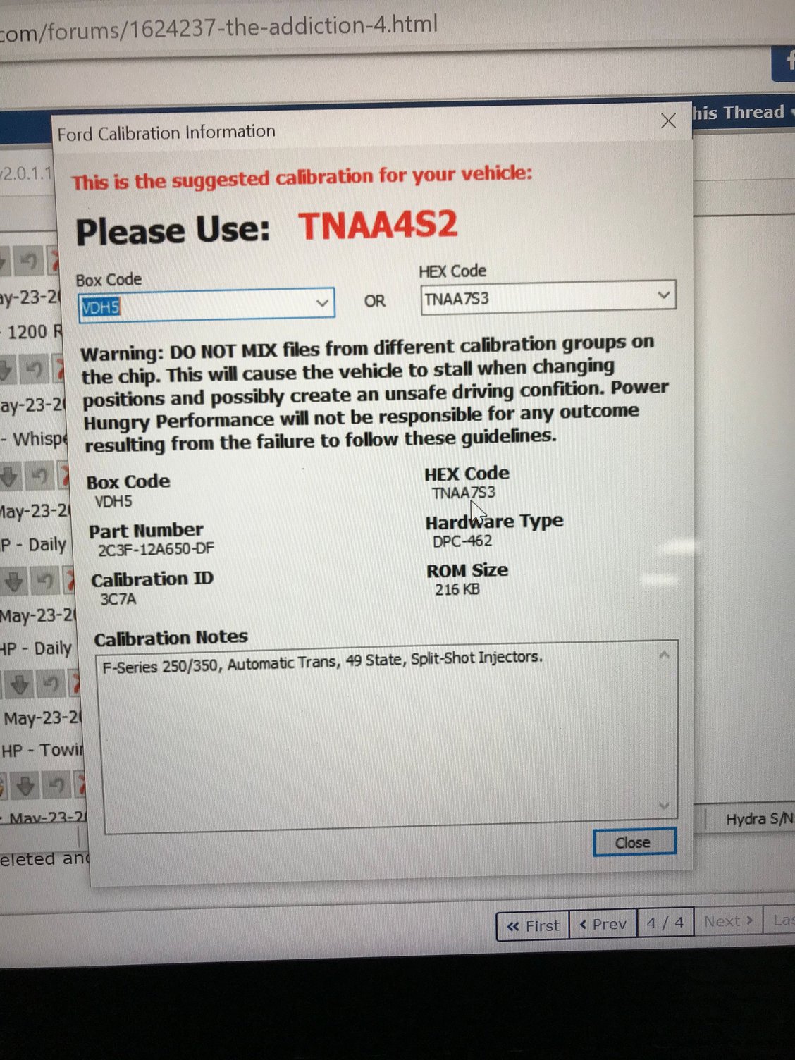

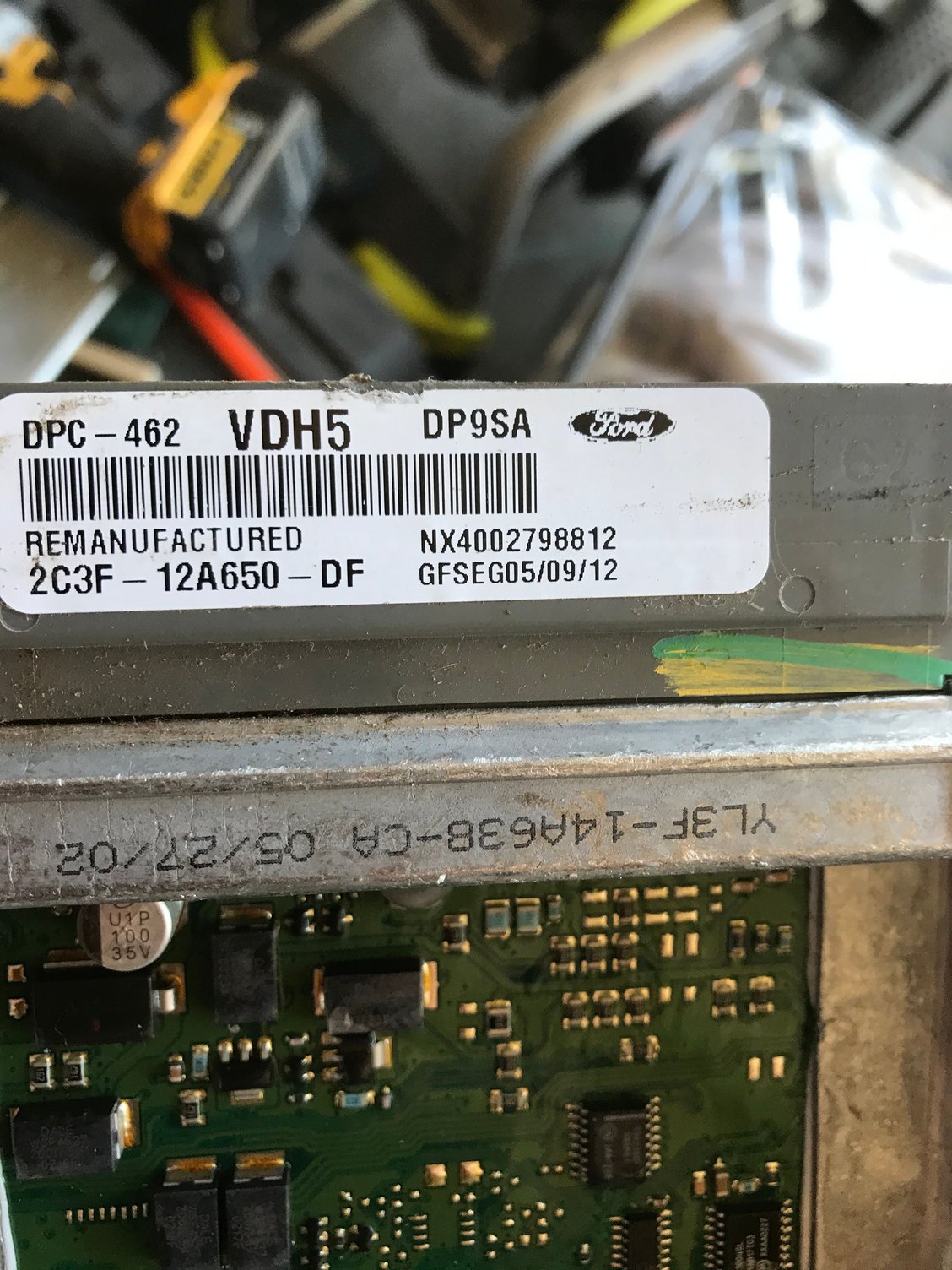

I’m no expert on the Hydra as I only programmed mine a couple times years ago. But from what I remember the flash software will give you a recommended strategy based on your hex code. Different hex codes can share a recommended strategy. You need to use all the same strategy codes or you can get hiccups while switching between them.
Id confirm the hex code and go from there. My pcm had it on the plastic cover I removed which is now in my parts box.
It’s real easy to grab a different strategy by mistake while filling up the slots in the software However I think they made an improvement that made getting to your correct code easier than the long scroll I had to do.

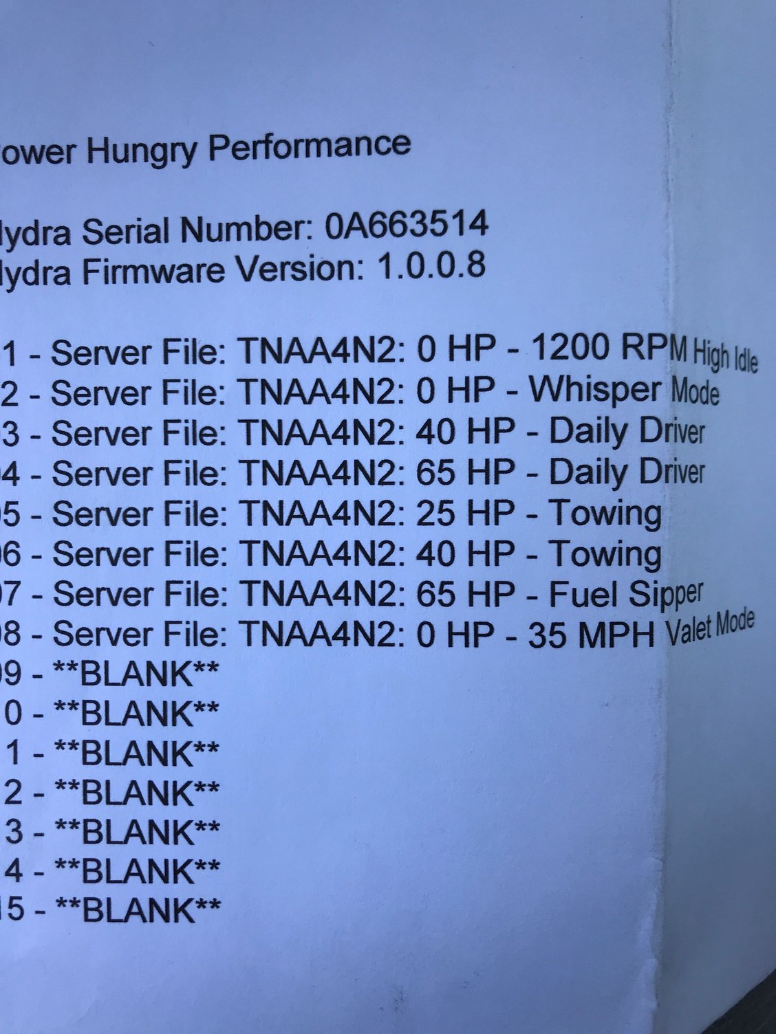

Forscan showed me tnaa753 but the hydra showed me something else, kinda at a loss here no tunes are working now
going to pull the pcm again maybe I pulled the cable loos somehow[img]blob:https://www.ford-trucks.com/ac9a4f42-cae1-4f1e-8c5d-b24e0c9b4536[/img]

If Hydra software gave you a hex code to use, load tunes for that hex code.

ok final conclusion, I am a dummy i was running the wrong tunes all together I was running tnna4n2 and was supposed the be running tnaa4s2 i believe it was !
Took everything apart (getting good at pulling the pcm) just to check all connections
did some more searching and found out i was just wrong with the tunes i selected, they worked for a day but i guess the pcm decided Ummm no way and shut me down
good thing the truck is smarter then i am!
