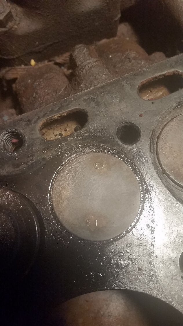

Okay, the valves passed the paper test. All pinched the paper so I could not pull it out. I have included some pictures of the valves. Only one had a number on it and others had ford usa. It looks like there is a difference between the valve types on mine (yours were all the same). I also have included a picture of the number on the piston and a close up of the top of the cylinder wall. I have some left over marvel mystery oil. Should I use that to soak the pistons? I have a close up picture of the vacuum line which shows it's okay. Thanks. Phil

Standard bore. Nice! Maybe it just had a valve and ring job at some point. It looks like there is maybe a .002" to .005" ridge on the cylinders, see if you can catch a fingernail on it. Might need a ridge ream, maybe not if it was performed with the ring job. The Marvel Oil would be fine for a soak but I would mix it 20% with a clean aromatic hydrocarbon such as lacquer thinner or MEK for deep penetration. I might add that the pistons and upper cylinders look remarkably clean, so that suggests that the engine was tuned correctly and it wasn't an oil burner.

Got the piston soak going. There is a very slight ridge on the cylinder walls but not enough to catch a fingernail. I can just kind of feel it. If I needed to slide a piston out it would easily come out. I think they are okay. Do I need to do anything else with the valves? Phil

An afterthought, although it probably doesn't matter. Those aren't the original pistons. Original and NOS standard pistons have no stampings on top.
