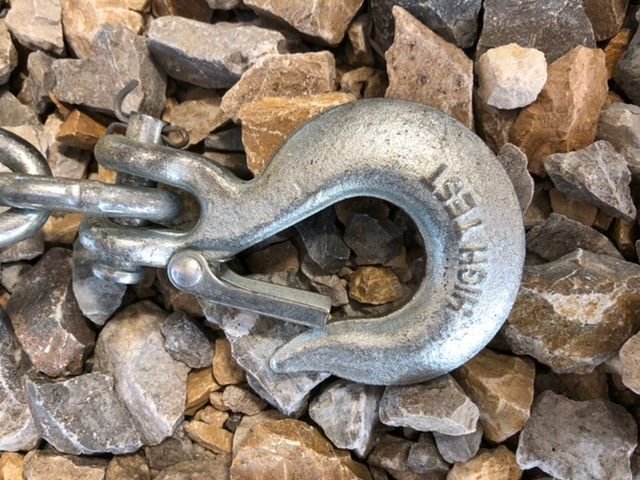

In case someone just wants hooks that fit instead of farting around with shackles, here’s a pic of one that came with my 8K-lb. TT...it and its twin work fine!

Yes, I found that the 7/16” curt hook fits and allows the spring loaded bail to close. They size them in a weird way, 7/16” refers to the width of the extension which the pin goes through, one on each side of the chain. I use 3/8” chain, that works, but I think 5/16” would have worked as well. The hooks are rated at 40k I think, so not likely to fail. They were pretty cheap on Amazon, about $15 each.
TXCOMT
Bingo
+1
I just tested my trailer's hooks on the new truck for the first time and the hook slips right through the hole in the truck and the gate closes.
Cant imagine any reason for adding a shackle in there, especially if its going to load incorrectly in a failure.
If my hook did not fit, my intention was just to change the hook to one that would.

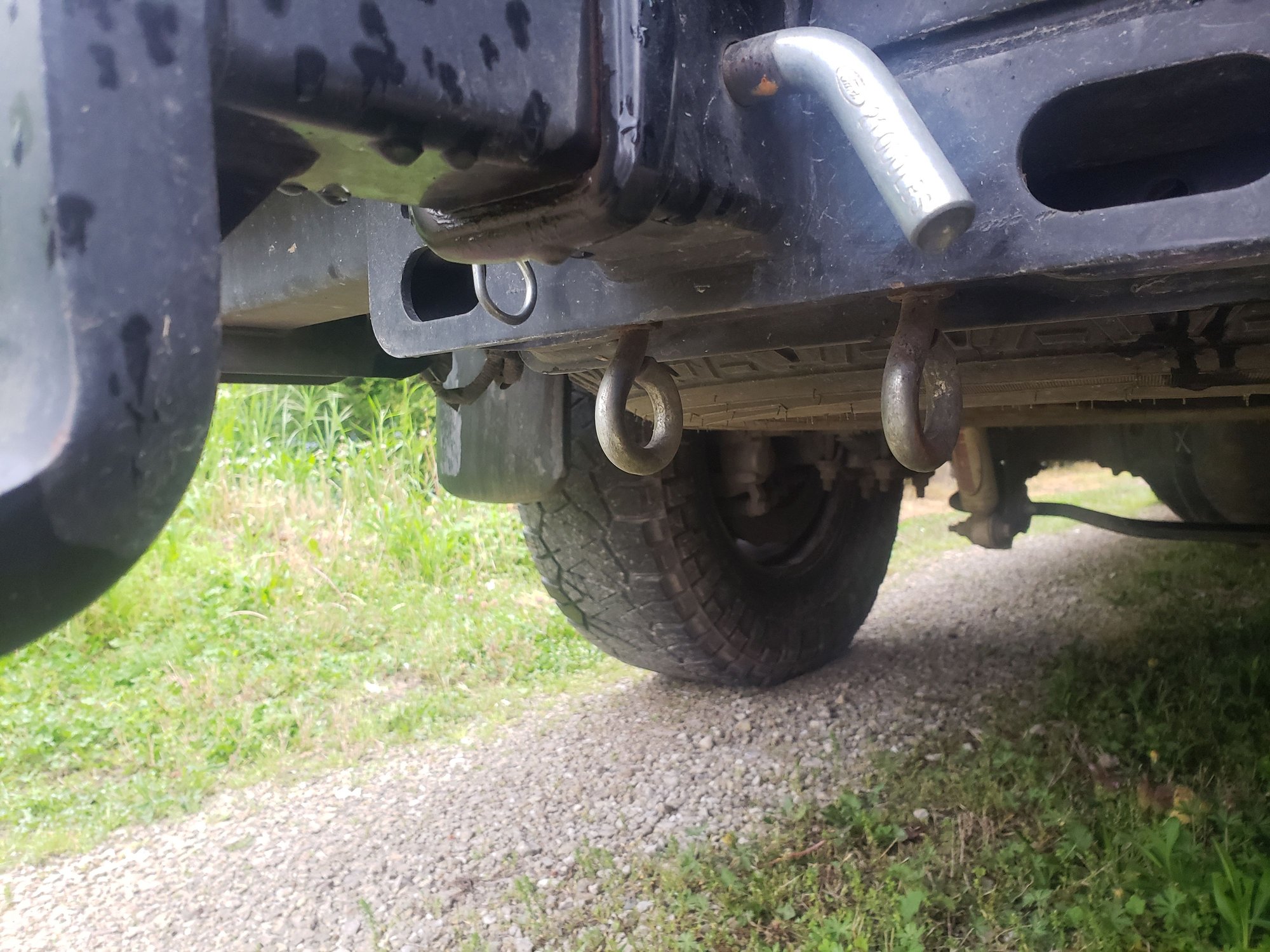

there are 2 half inch holes on the bottom behind those giant holes. i got 2 1/2" i-bolts and bolted them there. couldnt stand the idea of d rings rattling around in those holes
