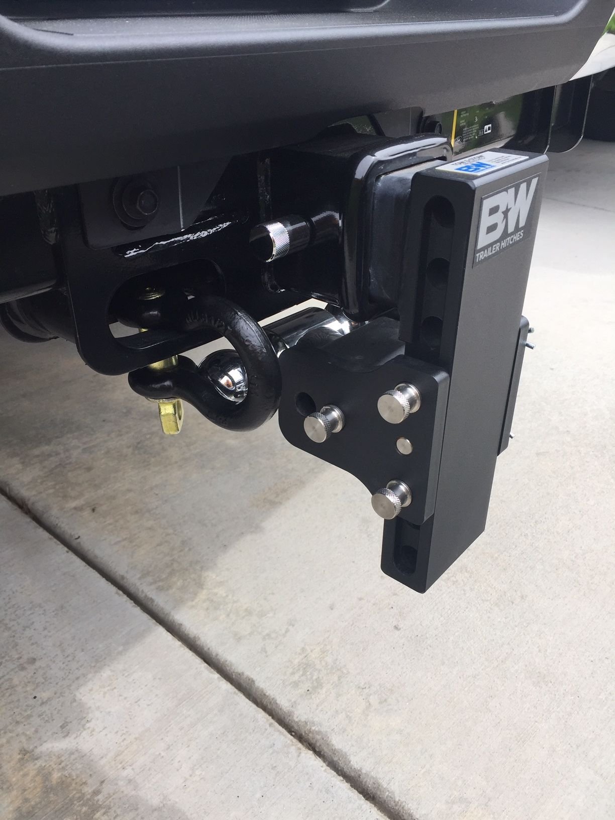

I see alot of you using shackles, but isnt anyone concerned that in a failure that the shackles would be needed to do their job the load path on the shackle is 90° to its designed load path?
It doesnt look to me that the shackle can rotate to have the load go through the bell > pin.
It looks like it would be forced to side load.
Now a 5/8 shackle probably has more headroom than might be needed, but I assume this has been discussed?
I've got a 3/4" shackle on mine. I'm thinking the loops on the truck's hitch would let go before the shackle does.

I have no data to back up that a shackle would fail, just in my work we lift lots of things (both heavy and light) with motors and shackles every day and I know the riggers are super focused on the fact that a shackle should never see side load. Load path only from the bell to the pin, so when I was looking at the photos it made me wonder how the shackle would react if actually called upon since looking at the photos it appears that it would be side loaded.
I'm certainly not saying you shackle guys are wrong (or right), but after 35+ years of seeing shackles get used every day its 2nd nature to look at a shackle and consider the load path.
I have always just hooked my safety chains directly through the open holes in the truck hitch just because I did not want to add any intermediary piece.

That bulletproof hitch looks awesome. What I like about the B&W hitch though is that you can turn the ***** forward so they're not a knee knocker. I think the B&W is actually a few bucks cheaper as well.

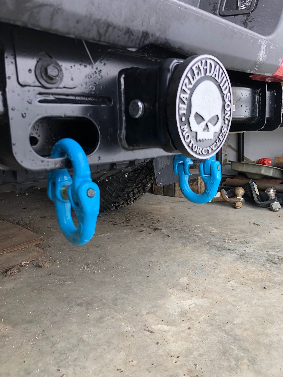

Hammerlock coupling link Made of grade 100 alloy steel Painted finish 1/2" Trade size 15000 lbs Working load limit

I like the look of thse as it appears that it would allow the link to rotate and have any loads not pull sideways on it.
For the shackle users - Will the shackle fit the other way around with the Bell through the truck and the pin to the trailer?
Would that allow the shackle to rotate so that any load would pull in line from the bell - pin?

Yes if those come apart...........you won't be around to worry about it
You could run it with the pin on the truck side and the loop toward the trailer like this. It might be difficult to hook around the pin unless you have some massive hooks coming from the trailer.
