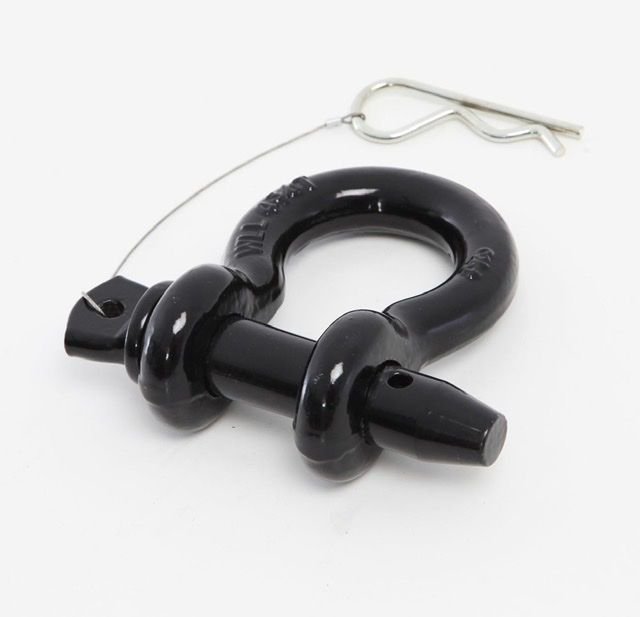

This is what I got. Smittybilt Shackles $17.99 each Cdn$. I prefer the non threaded ones.
Here’s the specs.
  • Quick Pin Shackle with D-rings that feature a 3/4" pin for heavy duty use, and have a weight rating of 4.75 tons

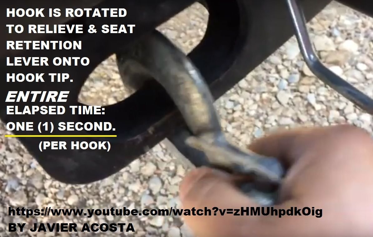

With safety chain clevis hooks as large as these, are those extra red things (Hammerlocks) really necessary?
With the risks of side loaded shackles zipper failing the threaded engagements, it would seem to me that the hooks by themselves are the simplest and safest.

My trailer chains work exactly like Y2K's images. But, they just BARELY fit like this. I have to take care to get all the angles and such just right, or it won't fit. I think most of this thread are for the folks who fall on the other side of these tolerances ... where the chains simply will not fit as the photos show. For those people and their trailers, they require some translation device to go from hook to hitch ... and hence this thread.
