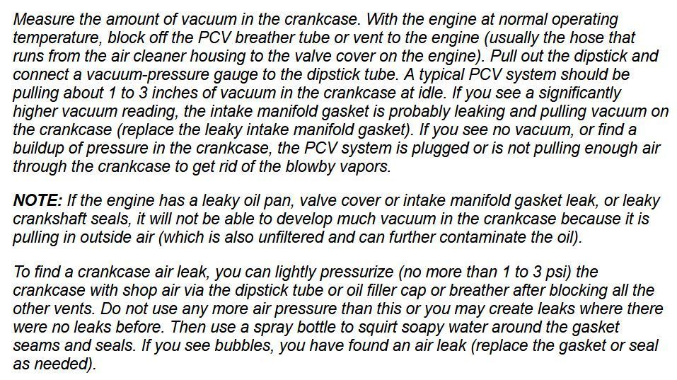

The below method can also be used to find the correct rate of flow valve -
