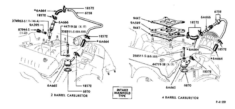

I'm going to be switching my y block from the draft tube to a pcv set up. I bought a valley pan with a pcv provision similar to the one below:
would you suggest using the original pcv "teapot" or using an aftermarket one? Also, in researching this, someone suggesting putting steel wool in the baffle box on the bottom of the pan to prevent sucking up oil. Is that neccessary? In the research I've done, I hadn't seen that recommended before. Any help would be appreciated.

The "tea pot" will require a pcv valve that can use a hose on each end, I think 1/2" and 3/8". I used to run a setup just like that. You can also install a grommet into that hole for a more common style of pcv valve. However, the valve may hit the threaded fitting for the "tea pot." That is easy enough to correct if you check before installation.
If the baffle is in good condition, then it will work fine to keep oil out. Nothing else should be required.

You want to retain the adapter on the pan. That is an oil (mist) separator. It minimizes oil vapors (with remote in-line valve and cooling tube) from being drawn into the intake tract.
If you put the valve into the opening on the pan, it will draw vapor. That and the DIST DRIVE throws oil straight at it.
Just say no to a SS mesh insert.

thanks for that info. I had just assumed it was a valve itself. After looking at the info below, I guess I'm looking for part number 6a666. Thanks everyone about not adding the mesh to the box. It didn't sound right, but I thought I'd ask

The adapter is C1AE 6A665-G I believe. You can still find them NOS or take-off.
