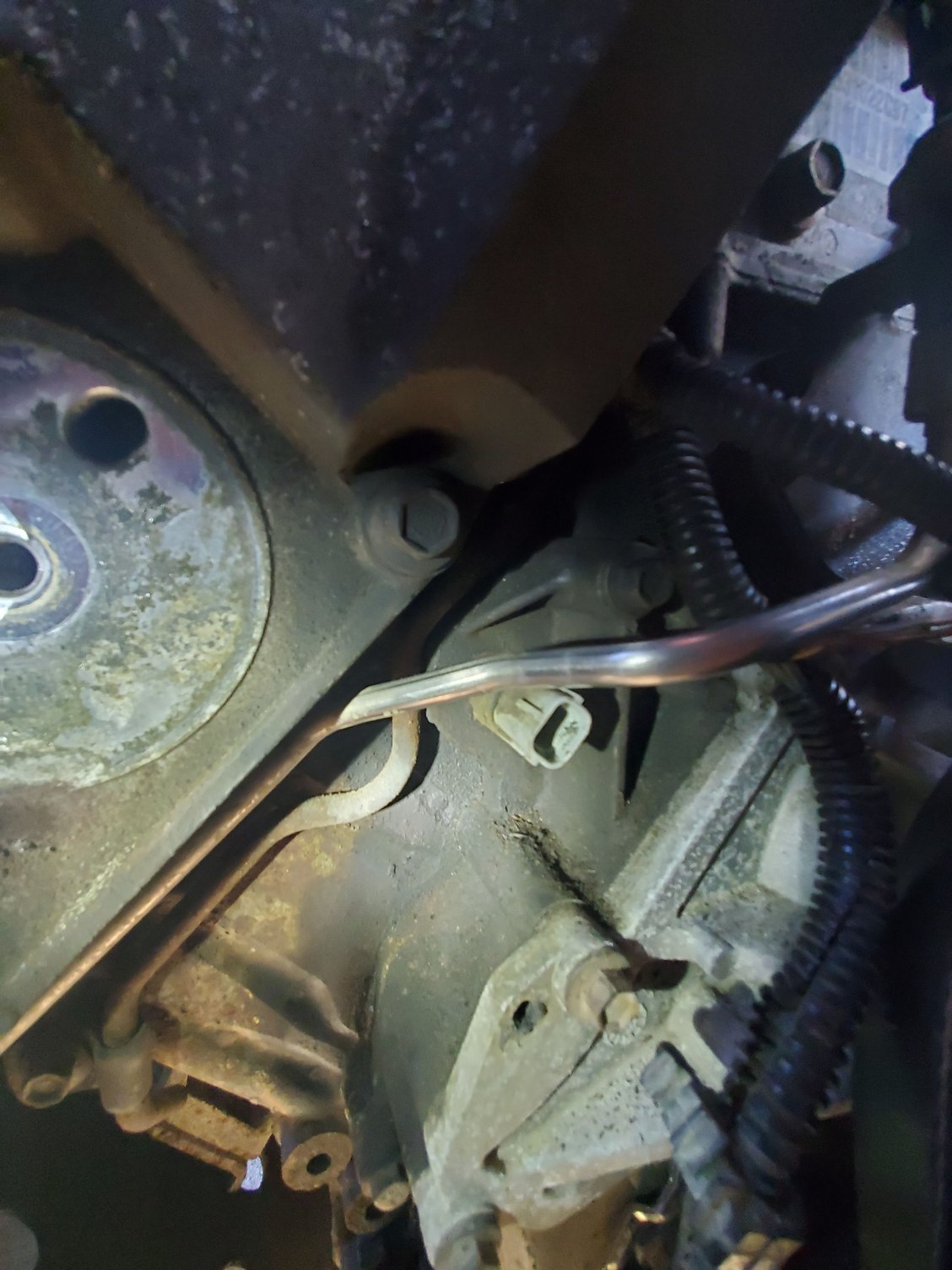

After spending some time today searching for more
information about what I am up against. I believe I found a clear picture of the sensor. This guy was doing his water pump and you can see the sensor.
I also believe it goes in the front cover. I will confirm this with my own pictures when I replace the sensor.
The image is not clear enough to reveal the coloring on the wires.

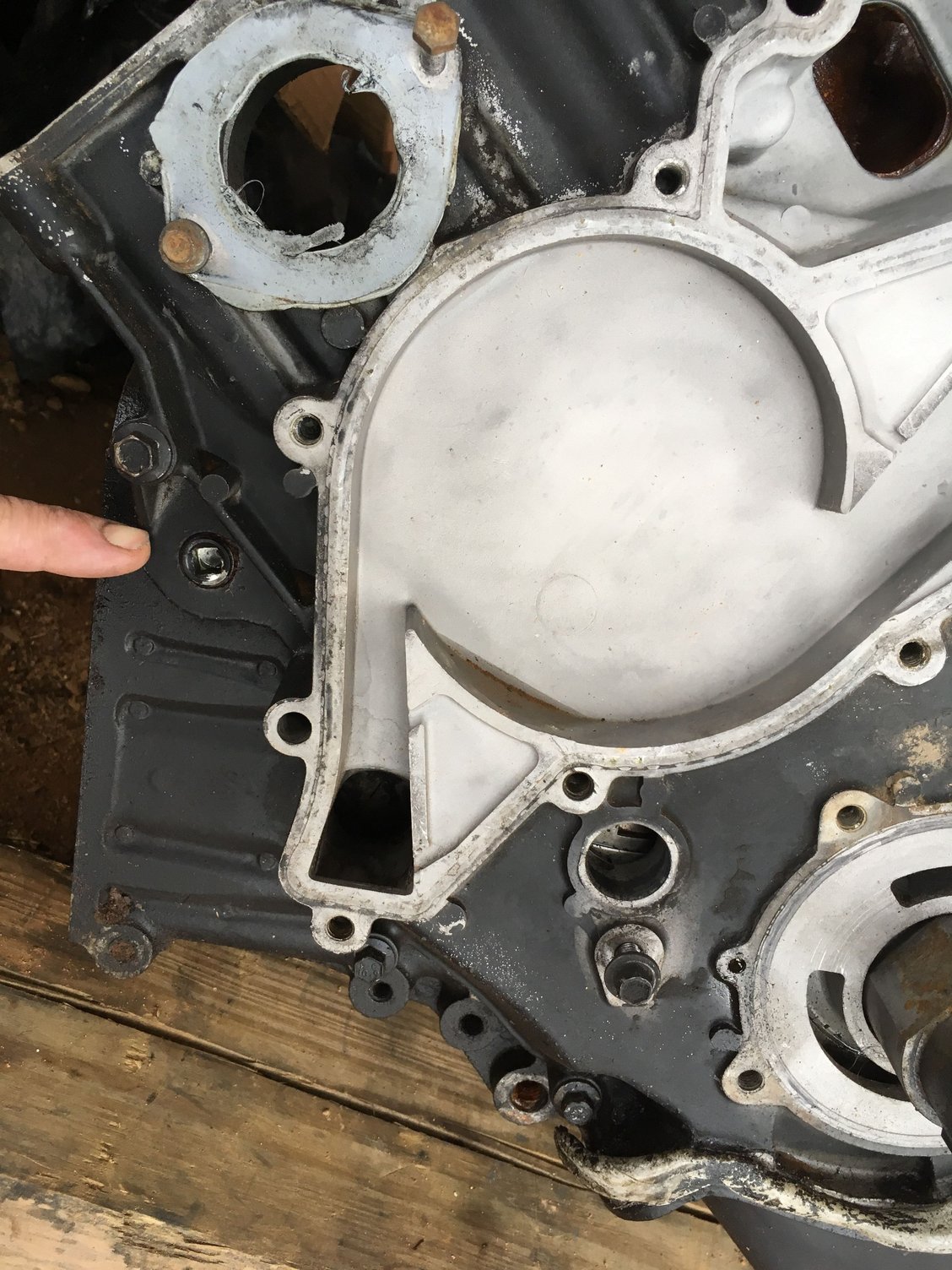

Yes. I’ll take a pic when I go out in a minute. I have (3) ZF6 trucks here right now and a couple loose engines...

None of the loose ones have it. This is the spot though.

The nearest (3) trucks are ‘01, E99 and ‘00 ZF6’s.
Y’all are welcome to come look. Lol.
Its hard to take a pic in the truck. But that sensor is behind EBPS tube and looks just like the normal ECT sensor. Which looks like the Int’l one. Int’l uses a few ECT sensors depending on application...

So those are the wire colors on a 02 6 speed.
Same as the 03 diagram. I bought the part number in these post. The plug fit. I did not remove the sensor due to the old part reading the same as the new part. Forscan is reading trans temp for this circuit. While watching trans temp, unplug this plug
and trans temp defaults to 60°. I dont know where
the EOT reading is coming from. For me it is wrong anyway. Ambient is 50° and it is reading 80°.
My baro is at 0, my trans/EOT is 11°. So the batteries are unhooked. When I power it back up
if the readings are the same, I will send the PCM out for reprogramming.
