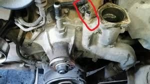

This is where the sensor goes:
It doesn't sound like the sensor is bad. The PCM will command rev-up if the engine starts to cool when the truck is sitting still, even after the truck has been running around for awhile. 40 deg F ambient seems a little high for that to occur though.

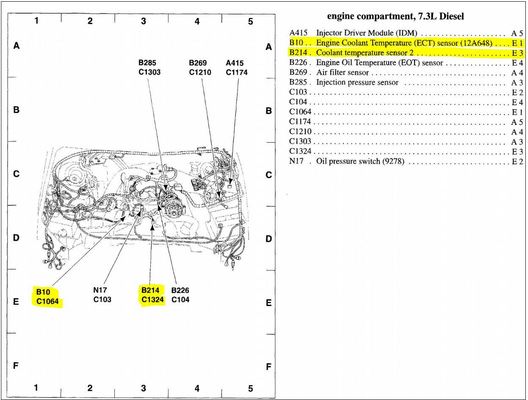

Found this: https://www.ford-trucks.com/forums/1...l#post15272803
and this:

Thanks for the pictures. I dont think I have a sensor in that location. I replaced the water pump
a year ago, right now I believe it only had one sensor going to the dash. I will check when I get home. While researching threads, I found post that show a sensor behind the belt tensioner. It is very difficult to get to, but I was able to confirm I have this sensor. I can touch it and I can see the wires running to it. On Forscan it is reading 20° but the temp outside is 40° On other post folks are saying it should be close to EOT.

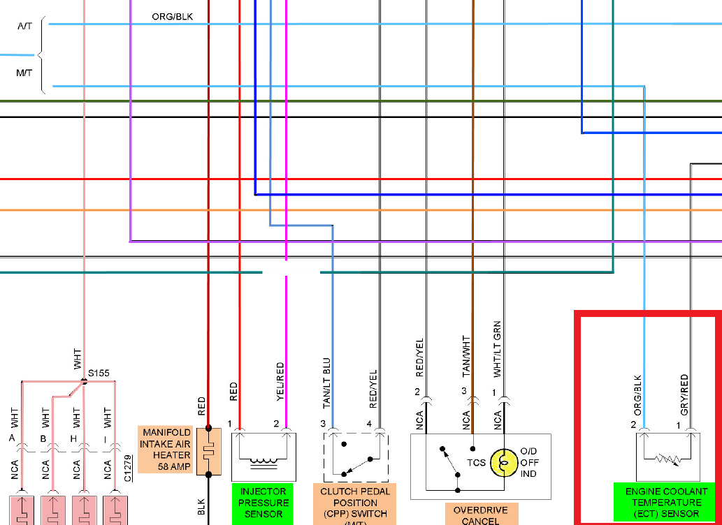

Also, went to the 2003 PCM wiring diagram and found the circuit that is for the ECT (MT) and TFT (AT) which I have indicated in a red box below. The wire colors should/might be ORG/BLK and GRY/RED.
