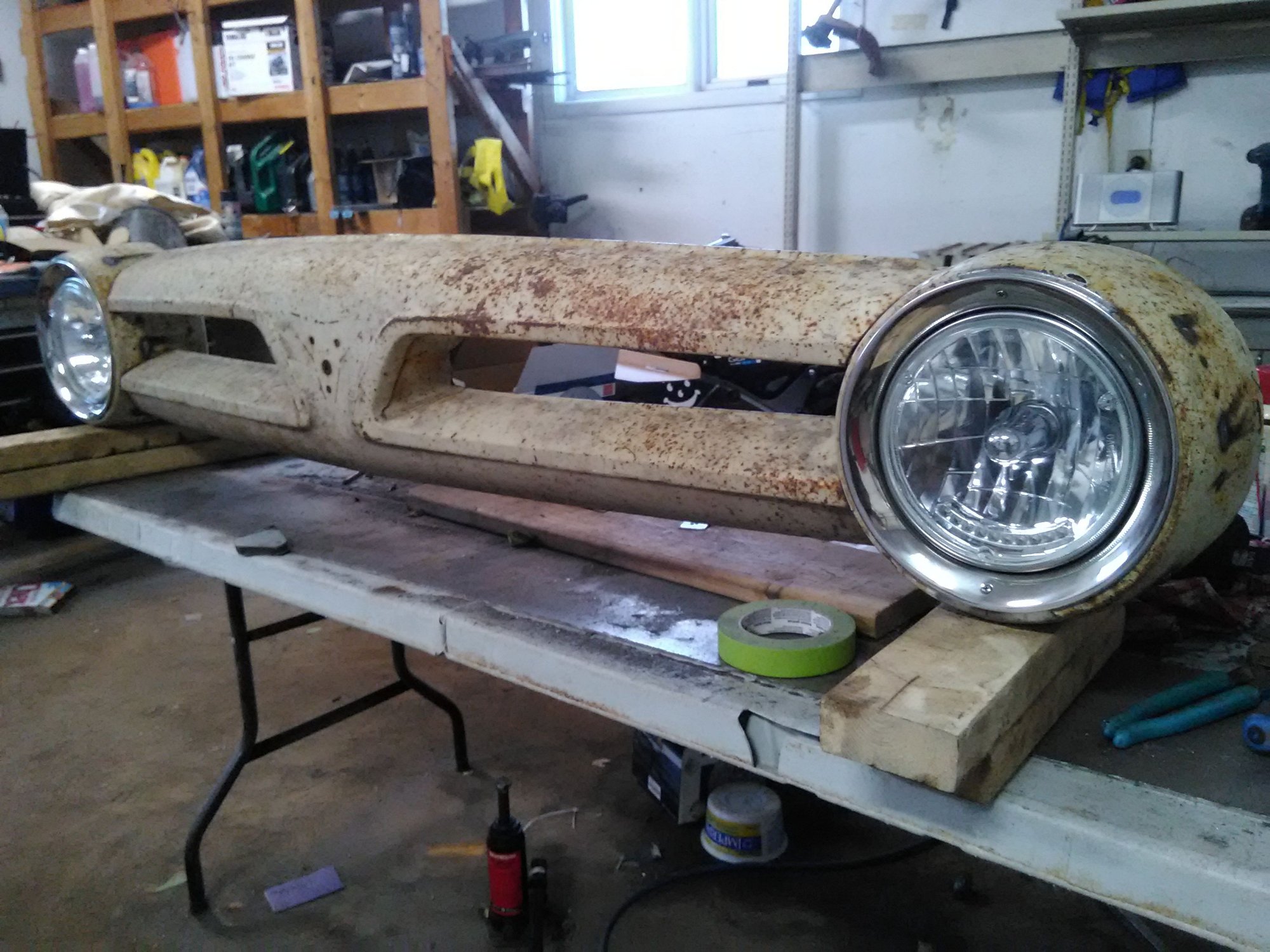

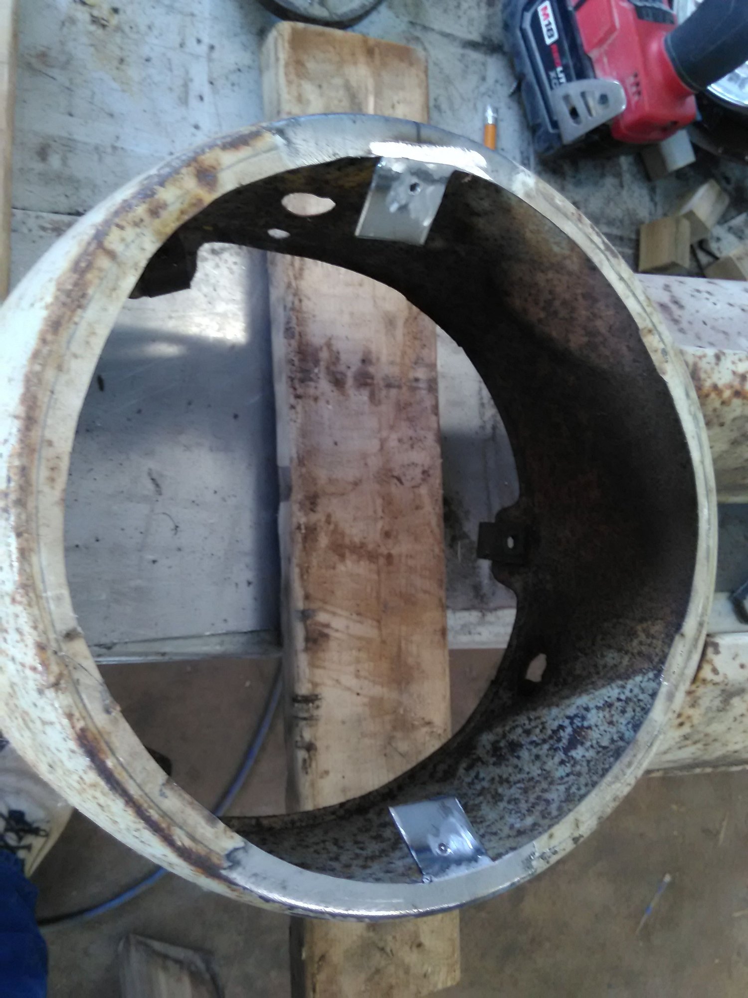

Next thing I wanted to do was the rework the headlights. Shout out to Drewski and John as this is their idea.
Started by drawing the outline of the new trim rings and a cut line inside of that.
Cut the head light ring to suit and welded in some tabs for the trim ring.
Created some mounting tabs for the buckets to get fastened to
Cut some spacers to hold the brackets after figuring out how far in I wanted the headlights to sit. Then welded in the brackets.
Put everything together and the final look for one side.
Second one was similar and now I have a '53 grill with '56 style headlights.

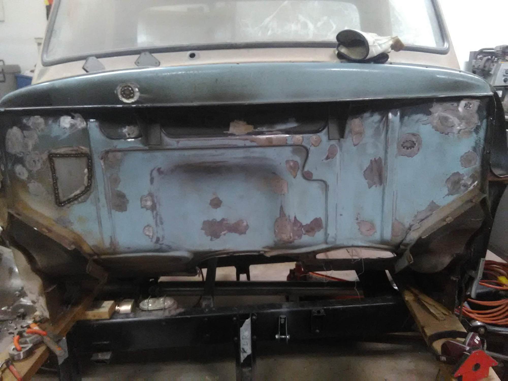

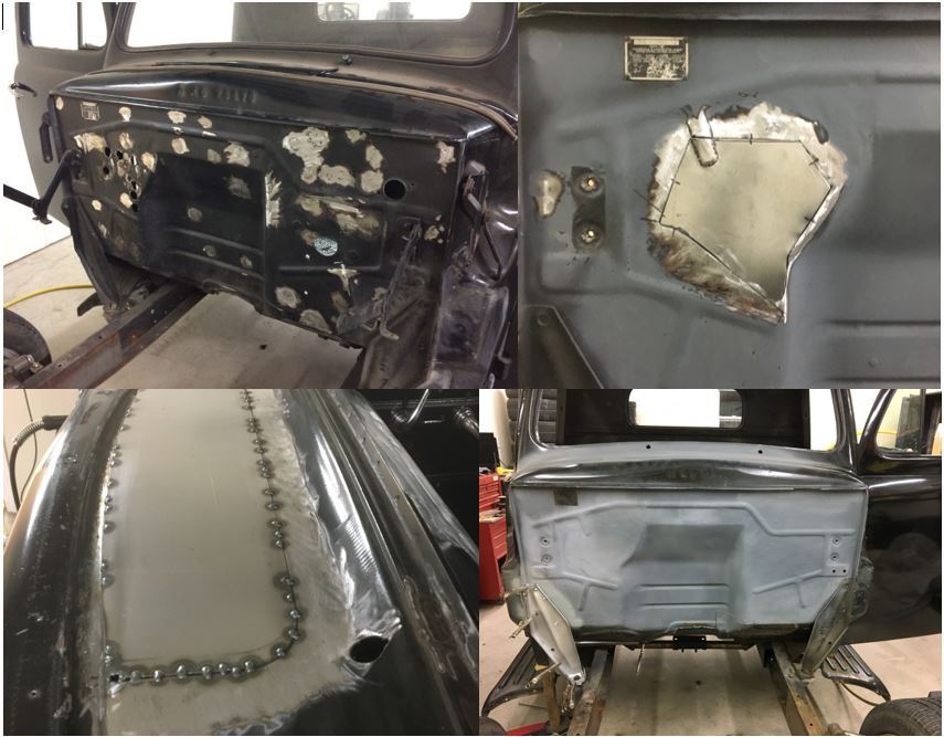

Next was to patch the firewall. Why did someone think that 53 holes in a firewall was a good idea.
And after
