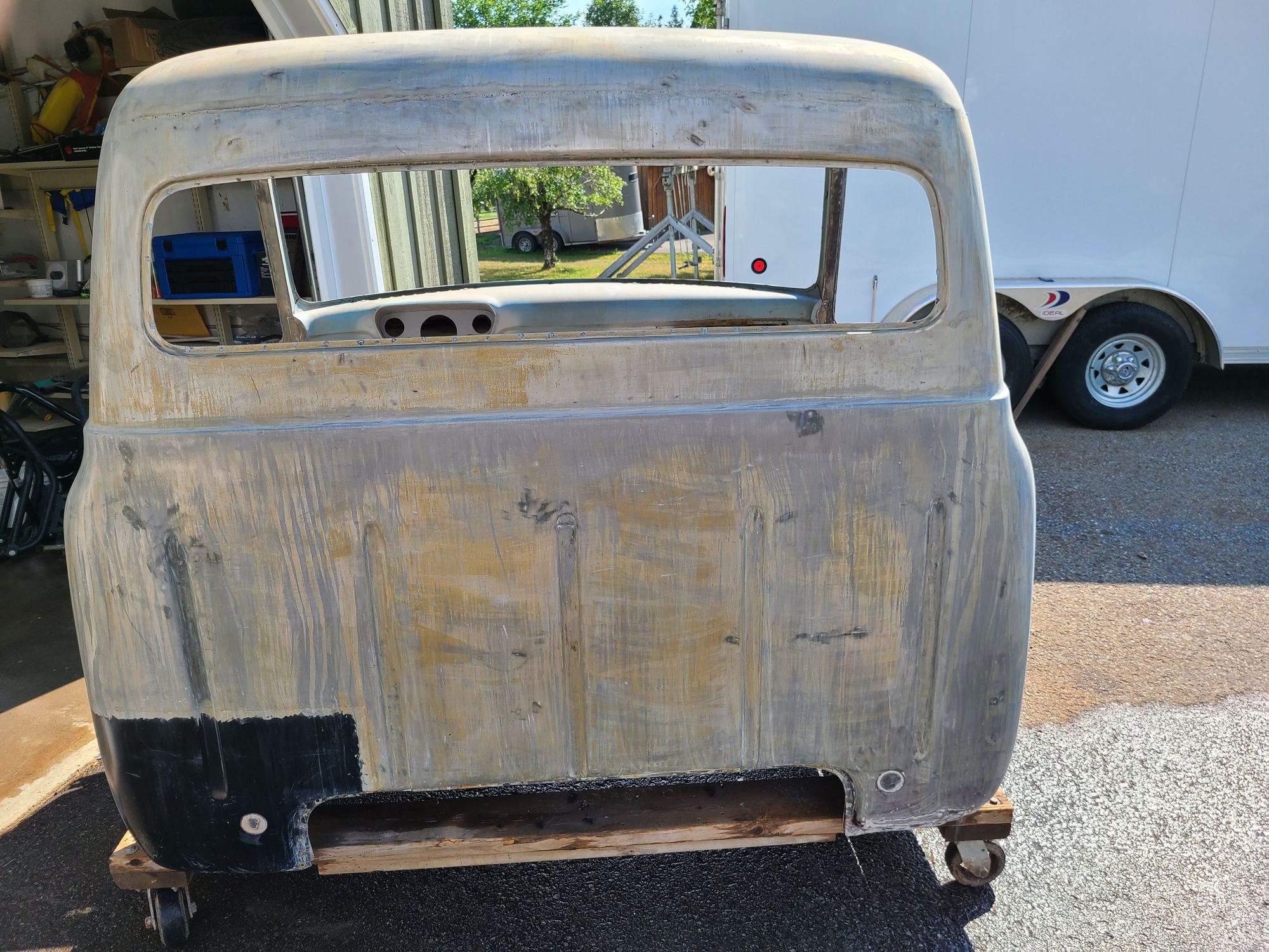

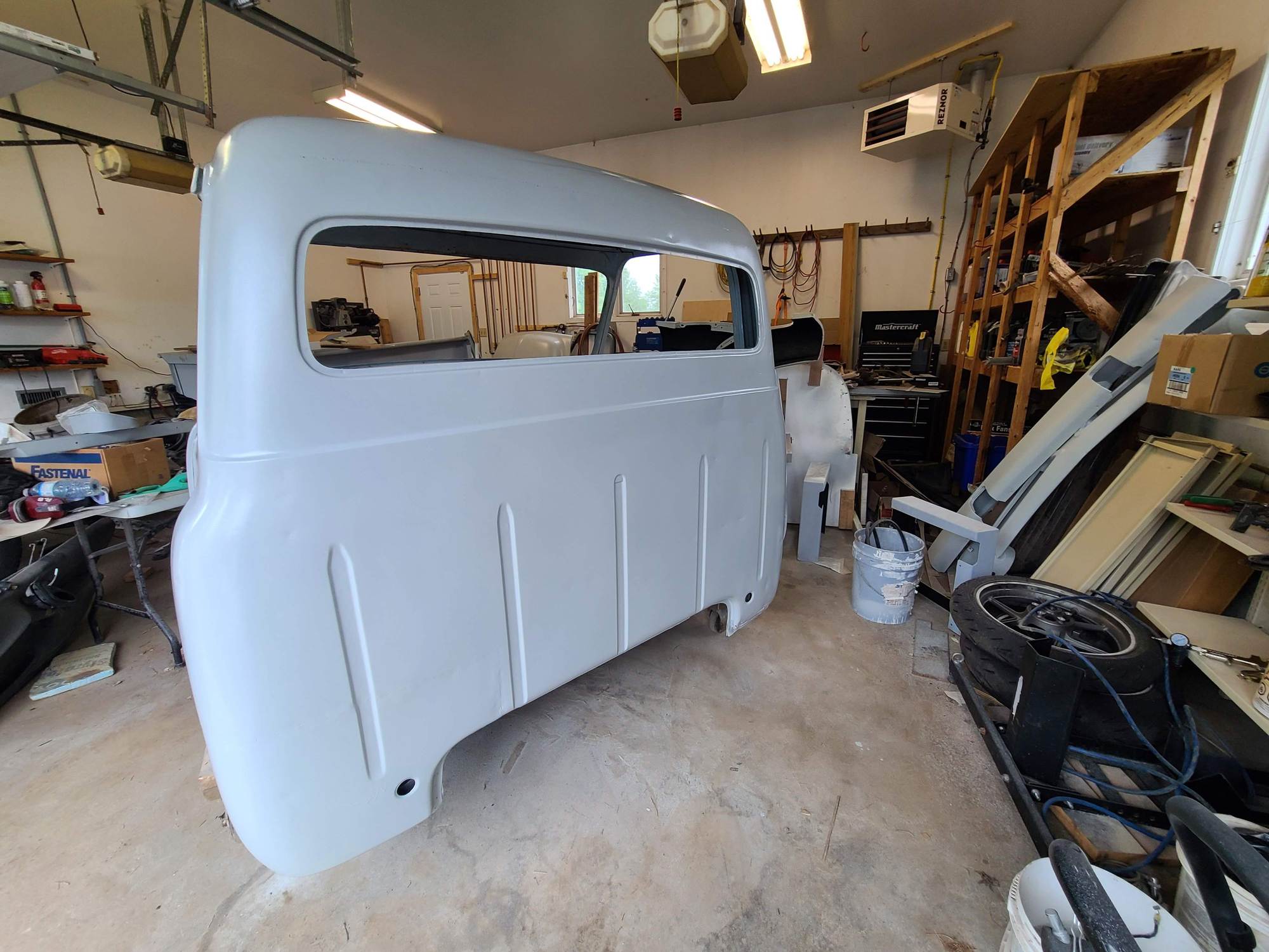

Have not been able to do much lately. But progress is progress. Got the cab stripped. That is a dirty job so needs to be done outside. With all the heat we have along with the work I do, there is nothing left in the tank to work after supper so it has been slow going.
Did get it done. Then washed with Metal Prep. Rinsed with water, per instructions. It then has a bit of flash rust.
That gets sanded with 120 grit. Everything gets double checked. then into primer she goes. Wow can you see where I have to do the body work now that primer is on. Cab went back on the frame today. Now I can move forward with some other stuff.

What I was told by the guy that has sold me all this body work stuff is to use the epoxy primer first. Bondo work until good. Epoxy again over the bondo. Sand with 120 grit. Then use putty to fill in the scratches. Then 2K over the whole thing, 3 thin coats. If not perfect then more putty work. I asked about when to start and stop. He says that as long as the epoxy is on I can do as I please. Probably not a great idea to leave in the rain though.

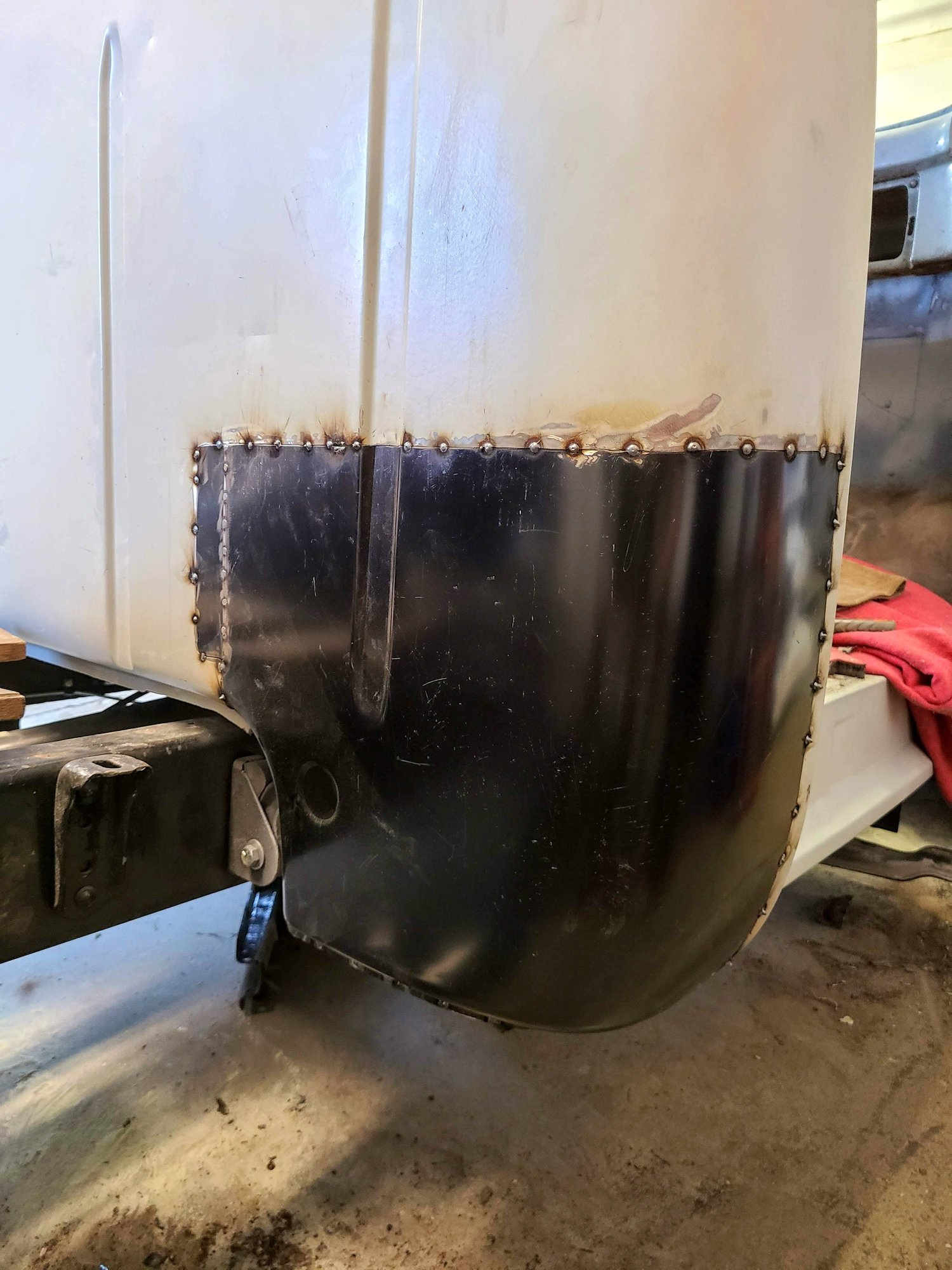

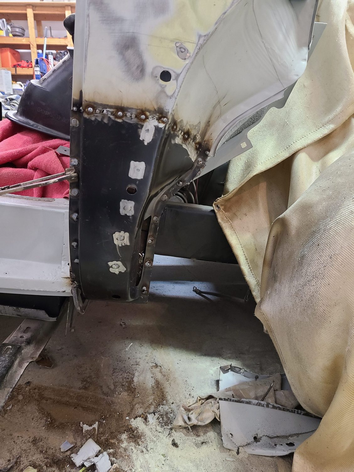

Been working on the truck but nothing that is picture worthy. I decided to go ahead and fix the passenger side cab corners while I wait for Speedway to send me their backordered stuff. Front was OK. Ordered the panels from Mid Fifty. The front was OK but not great. The top of the panel did not line up with the existing truck. Why can't someone make panels that work. So I decided to cut the new panel down and hope for the best.
That worked out much better as it now lined up.
The rear was another story all together. When I held the new panel to the existing this is what I found.
Over 1/2" difference plus the thickness of the metal. After much pondering, I decided to cut the old panel one tape width away from the last bend. That way I had something ridged to work with.
Got things fitting somewhat better. Looked great at the back but now at the front I had this. I could not bend it enough to fit at the bottom.
More cutting, more bending, more, of everything. Finally got it to fit.
Just need to finish the welding, then filler.
