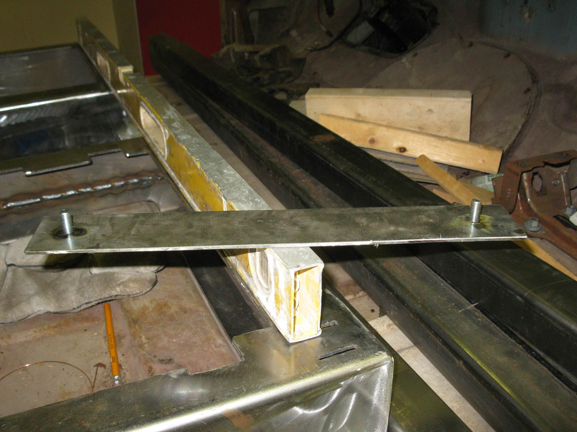

So things have gone much slower then expected but had a chance over the last couple of weekends to work on the risers again. Go them all welded up and back in to see how they fit.
Was all excited until I put a straight edge across them. Found out that the truck floor has a hump in the middle of about 1/2".
So out them come, more cutting and welding. Cut out 1/2" from the middle and 1/2" to nothing taper on the front. More welding, more grinding
Then back in for another fitting.
Much better that time. So thinking it would not be strong enough to bolt it to the sheet metal floor I make up some 1/8" plates with holes for 5/16" bolts to go through and welding it together. Located the risers, drilled some holes and mounted the seats.
Looking much better now and felt good when I sat in them. I will take them out once more to epoxy prime the steel so it will not rust but will do that when I prime up the rest of the steel I got for building a new box.
Hope I have done this right, please let me know if I should be changing something or if I am on the right path. This is all new to me so it is a lot of guess work.
