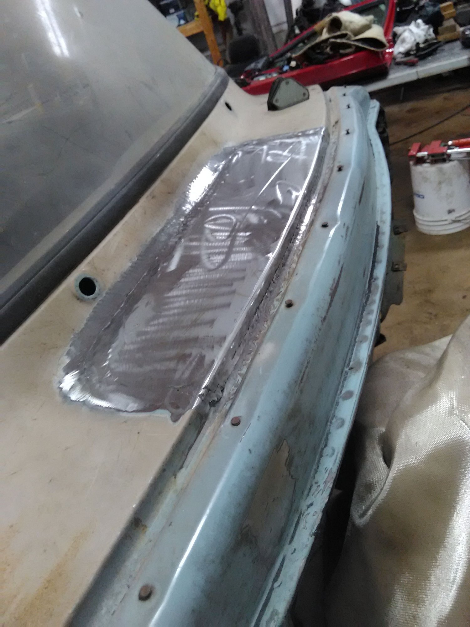

Thanks for the feed back guys. I debated on going with a smooth firewall as well. My concern was that with such a large area it would oil can on me, whether is was a new one or if I cut out the existing one and tried to weld in a piece of metal. Hoping this is a nice balance between the two options.

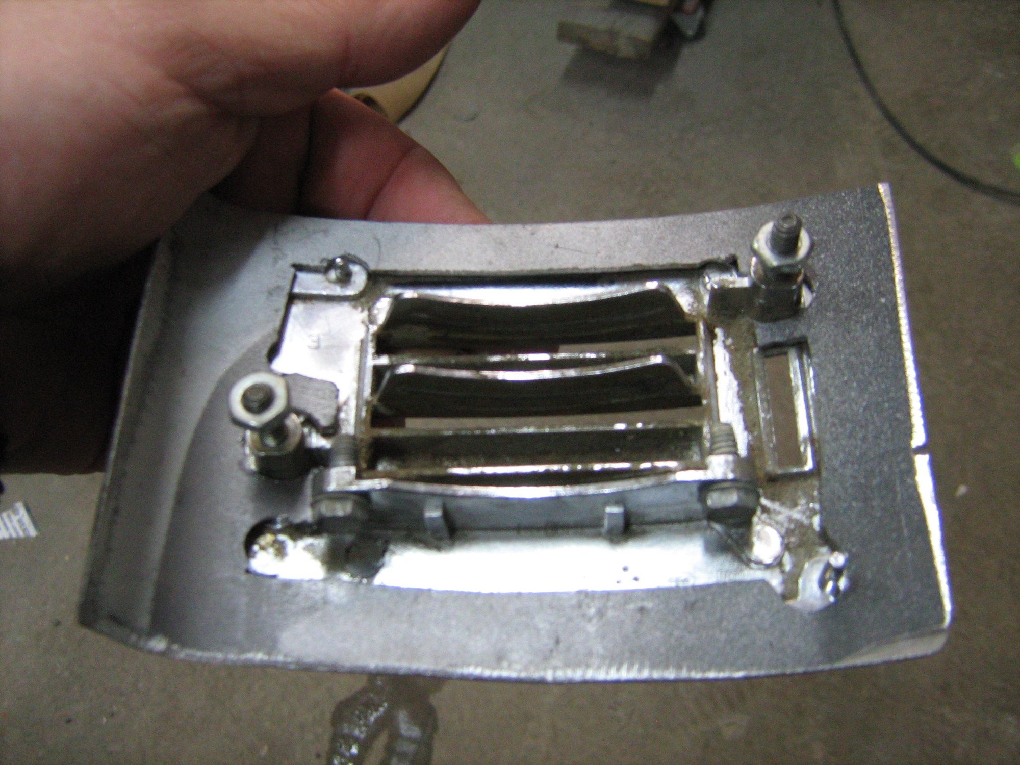

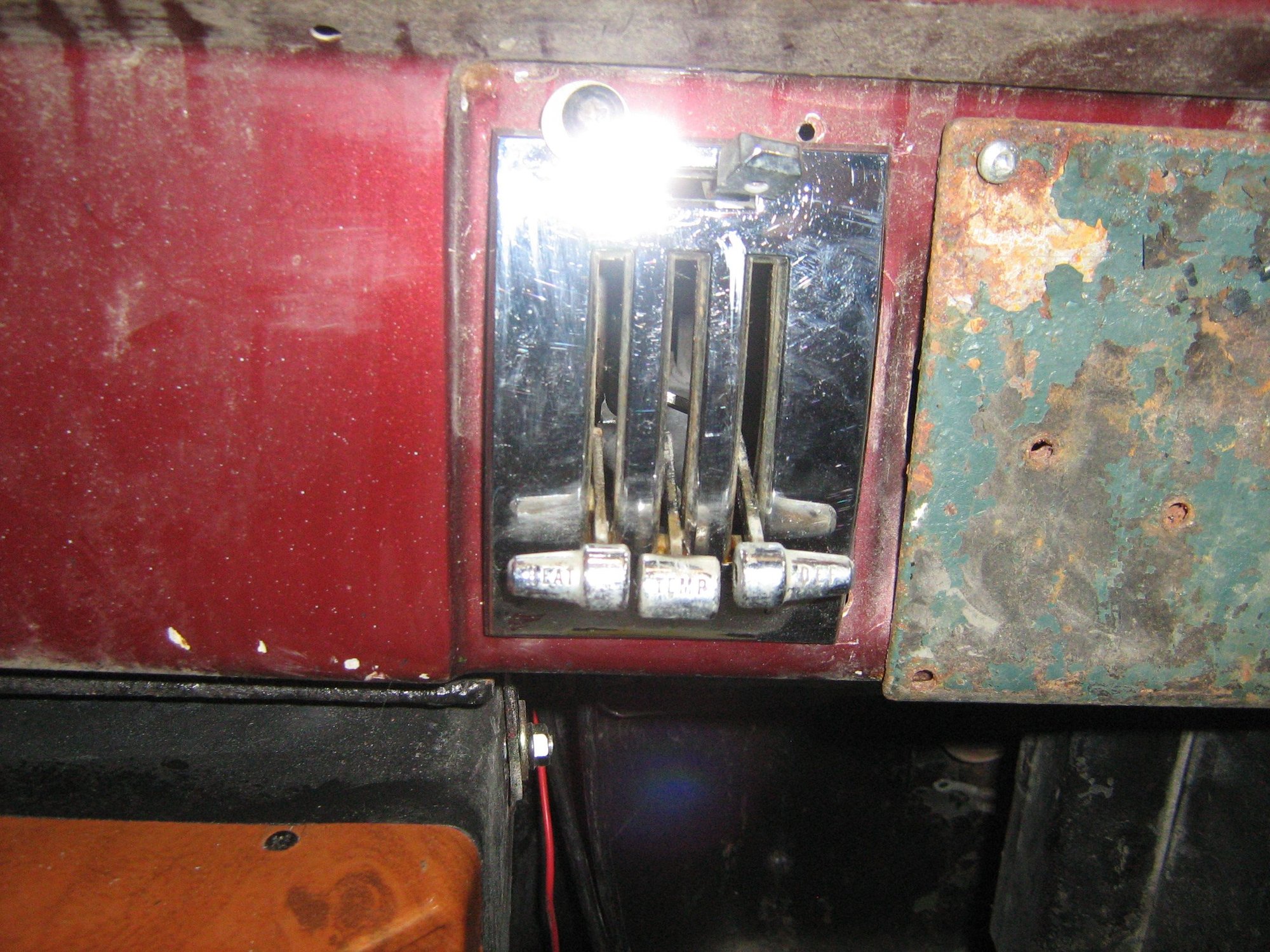

Here's where my ash tray is going .

That's interesting. I need to know more.

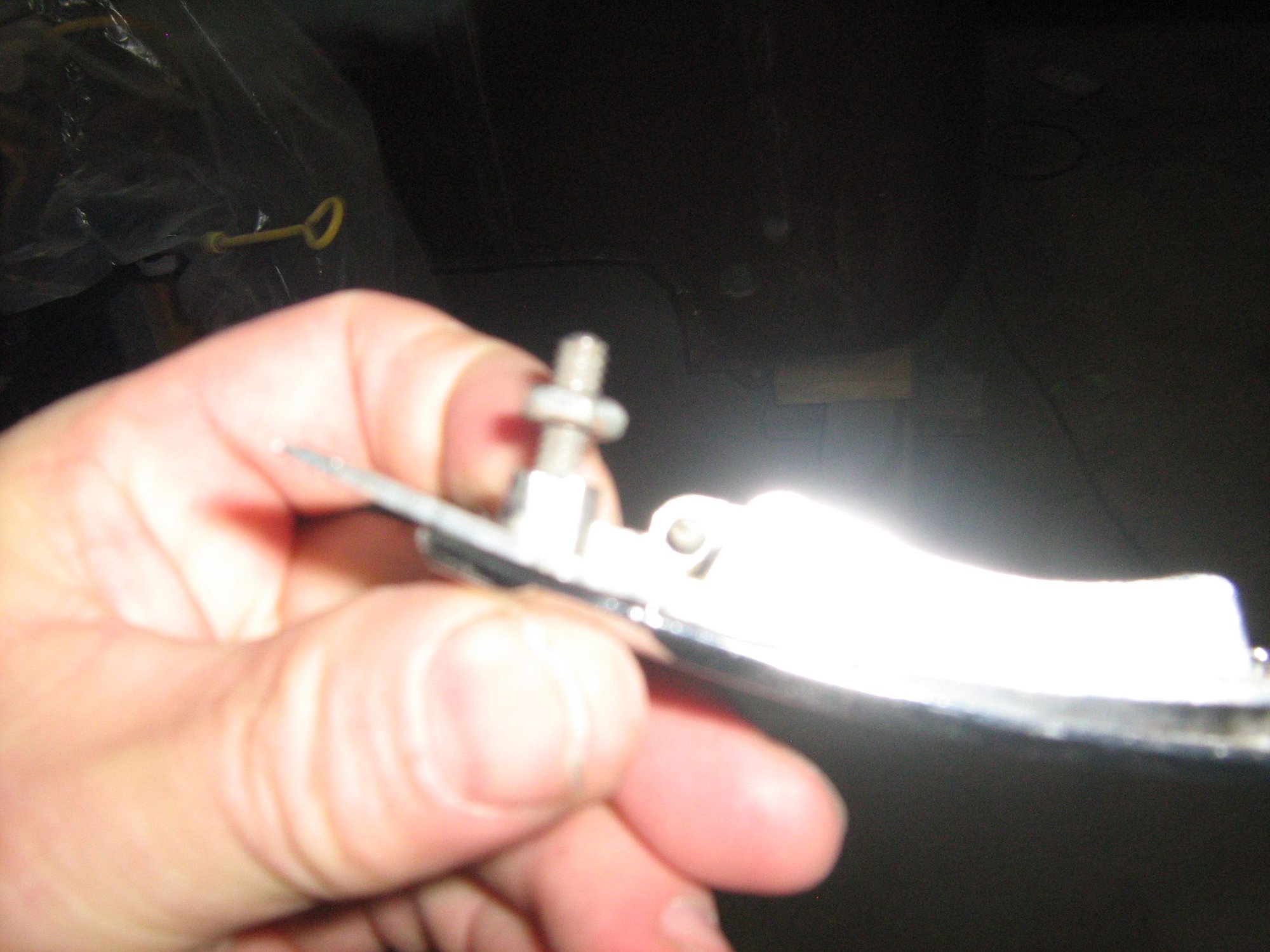

1965 MUSTANG . It has a slight curve to it so I am building a panel for it to sit on and fill in the opening .

I was just looking for something a little different instead of having a bunch ***** and had hoped to find something flat but the mustang fits the ash tray opening nicely so I found a used one off ebay and got lucky as it had the cables and heater switch all in good condition .. It is going to work even better than I had hoped , the cables will all reach where I need them to after I swapped two . I will post more pics on my build thread when I get it welded in .

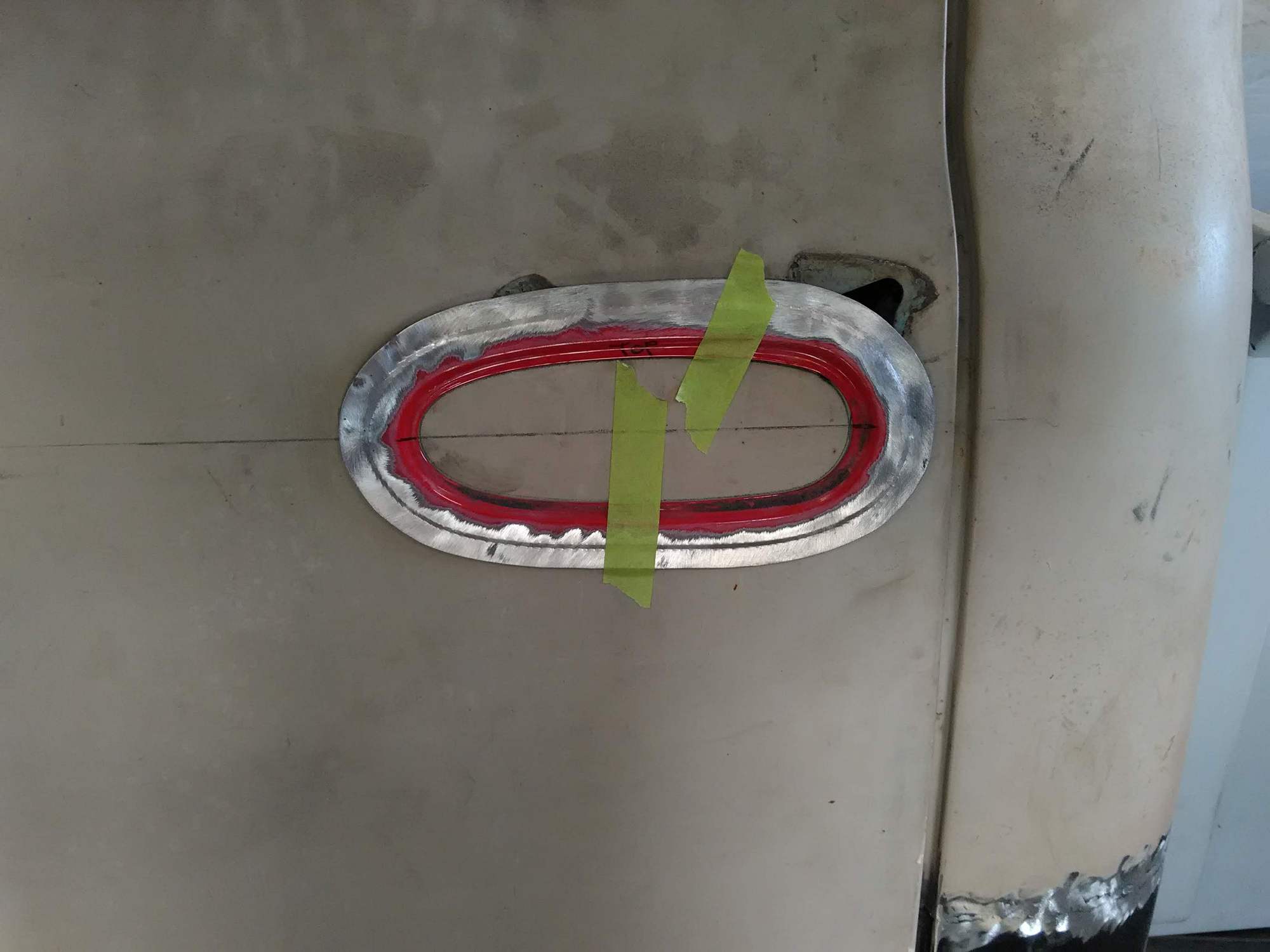

This Covid-19 thing has given me a bunch more shop time, wow. With each thing I do I learn some more. Next thing to change is the door handles. I was looking for a more streamlined look, modern handles and a safer latching system. Found some Grand Am door handles and locks I liked at a local pick and pull so I bought the whole door. Was not sure how to go about this so started by removing the door handles and all locking parts that go with it and cut out the metal around the handle. Then made a line around the handle to get a cut closer to the original handle. The idea was to get as much rigid metal as possible here for welding.
After cutting I took a flanging tool and created a flange. Then went to the truck to layout where I wanted the handle to go.

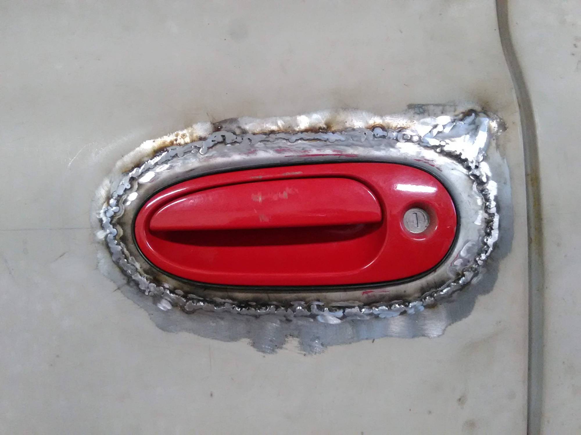

Took a deep breath and hoped for the best. Started cutting a perfect door. At this point my wife is wondering if I had fallen to far into the whiskey barrel. Once cut, I welded in the flanged metal and installed the handle to see how it looks. Did the flange thing because to Grand Am uses 22 gauge metal and different metal properties then the old truck which used 18 gauge for the door. Butt welding that did not seem like a good idea so for this work I decided to go this route. Although for any other work it has been butt welded.
Here is the other door but gives you the big picture as to how it looks.

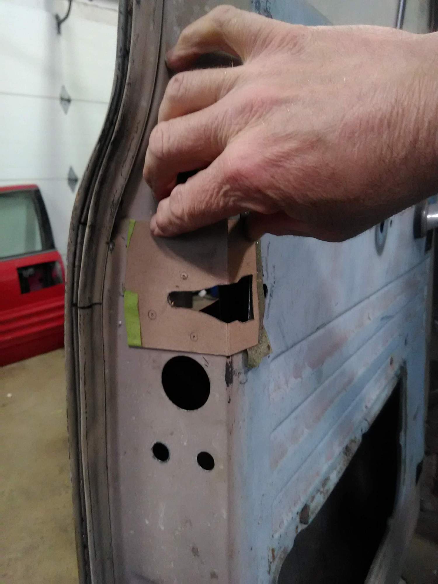

Then onto the latch part. I took a piece of cardboard and made a pattern from the Grand Am door and transferred it to the truck. Looking around to see if there was any interference anywhere including the location of the strike.
Once all was good it it was onto more cutting and welding. OK so I don't have a pic of the holes all welded up but here is the latch installed. I can reach through the hole where the handle goes to unlatch it if required. Handle will be bolted in later.

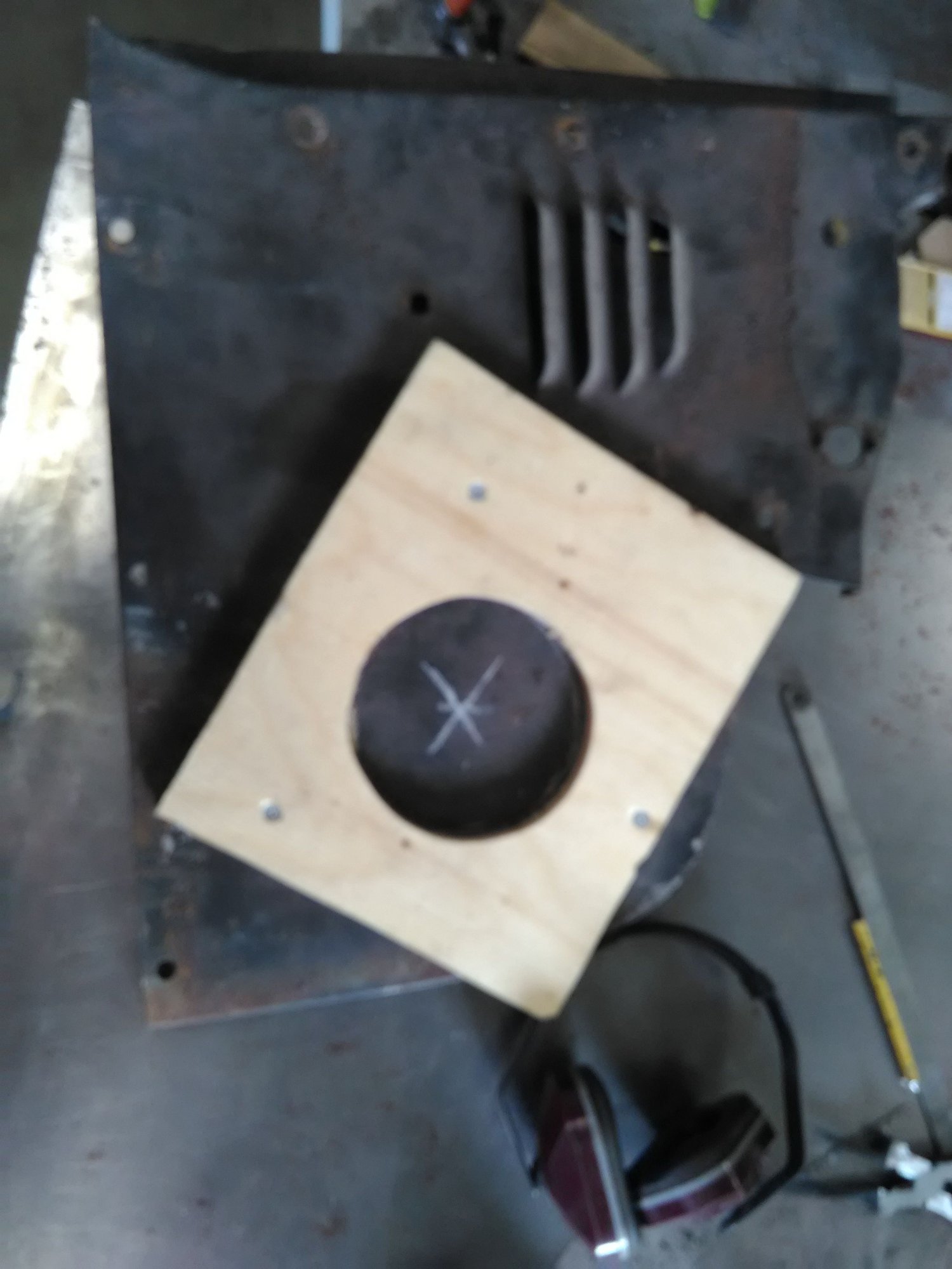

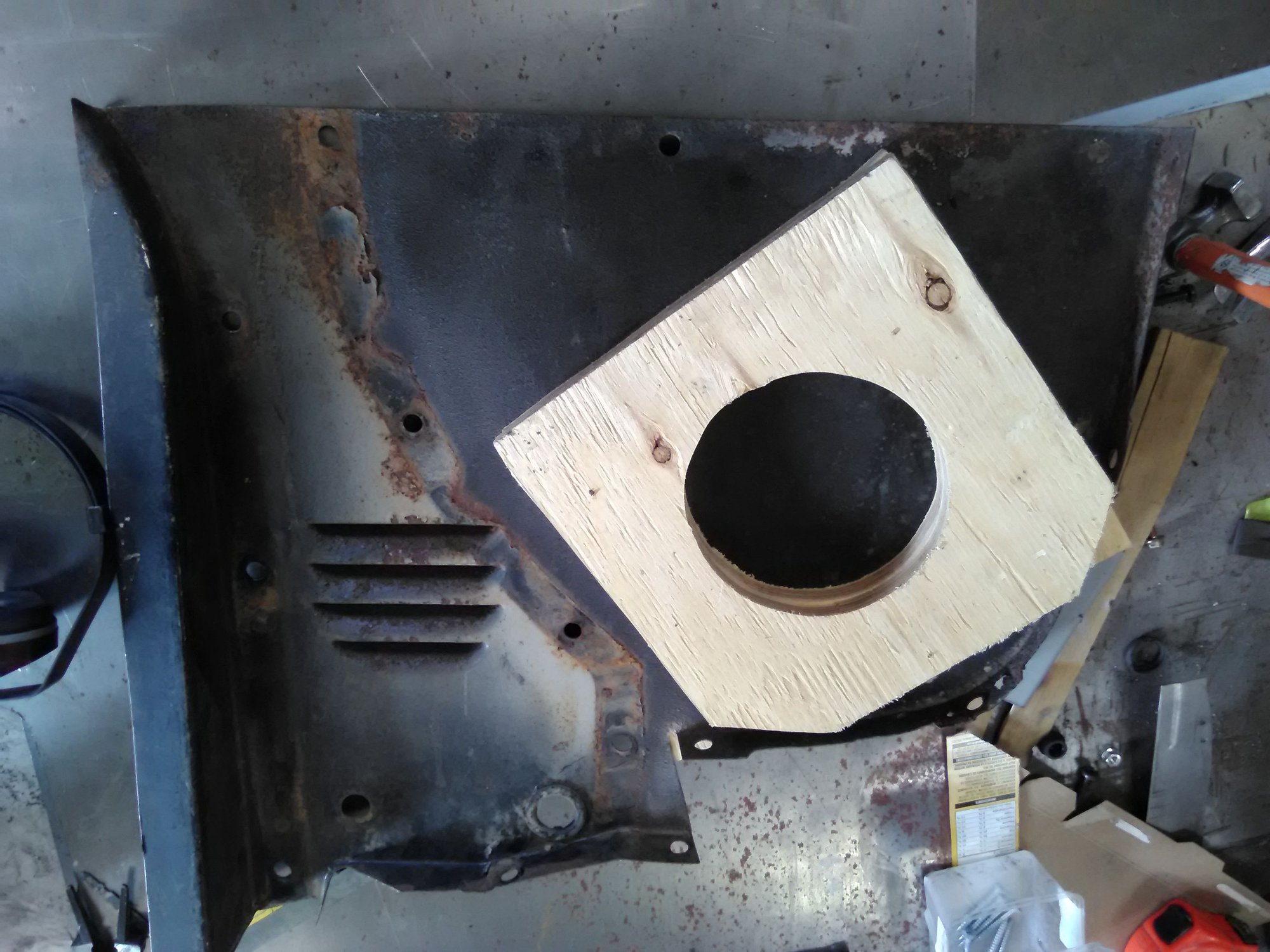

Because I changed the headlights to the '56 style I needed to change the air dams to work. One option was to buy them. But thought I would try and reshape what I had. I cut 3 pieces of plywood with 5 1/2" holes in them. Put two pieces on the back and one on the front and screwed them together through the existing holes in the air dam. X marks the center between the three holes. Front side
Back side
Choosing some hammers to try. Ended up using my carpenters 20 oz. hammer.
Slowly pounding away. Be careful here. Slow and steady wins the race. Not sure how much stretch I could get but know I needed at least 7/8". I managed to get 1 1/4" almost. Worked out perfectly. Test fitted everything. No rubbing.

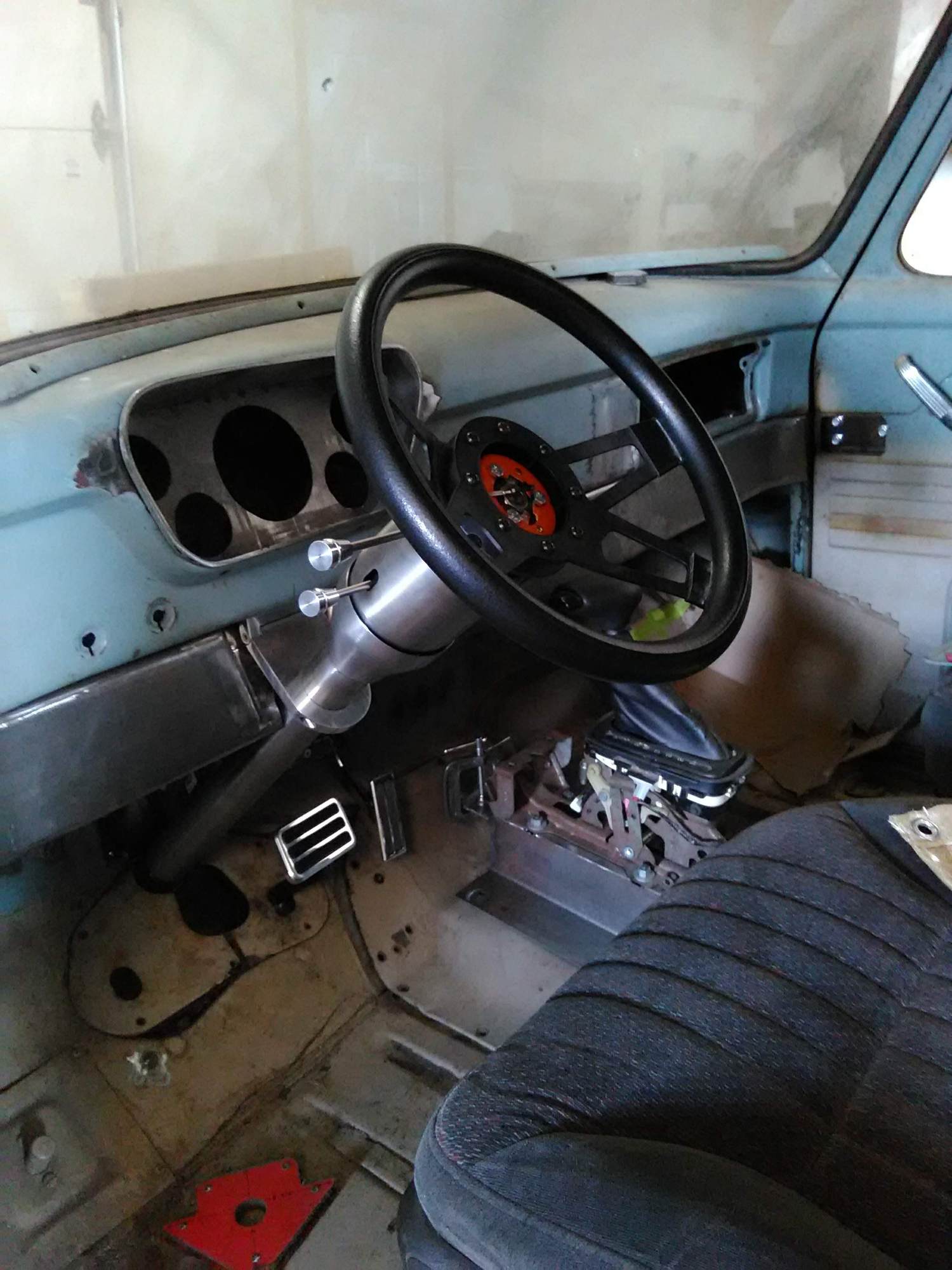

With all the down time I am getting better at finding stuff, lol. Although I have been working on the truck every day, some days don't look like much. Got the pedals and column in. The steering shaft was tight. Took a bit of work to figure out the steering wheel and shaft. When first installed it turned more one way then the other. Turns out the steering wheel and column didn't want to play nice together. Works perfect now.
