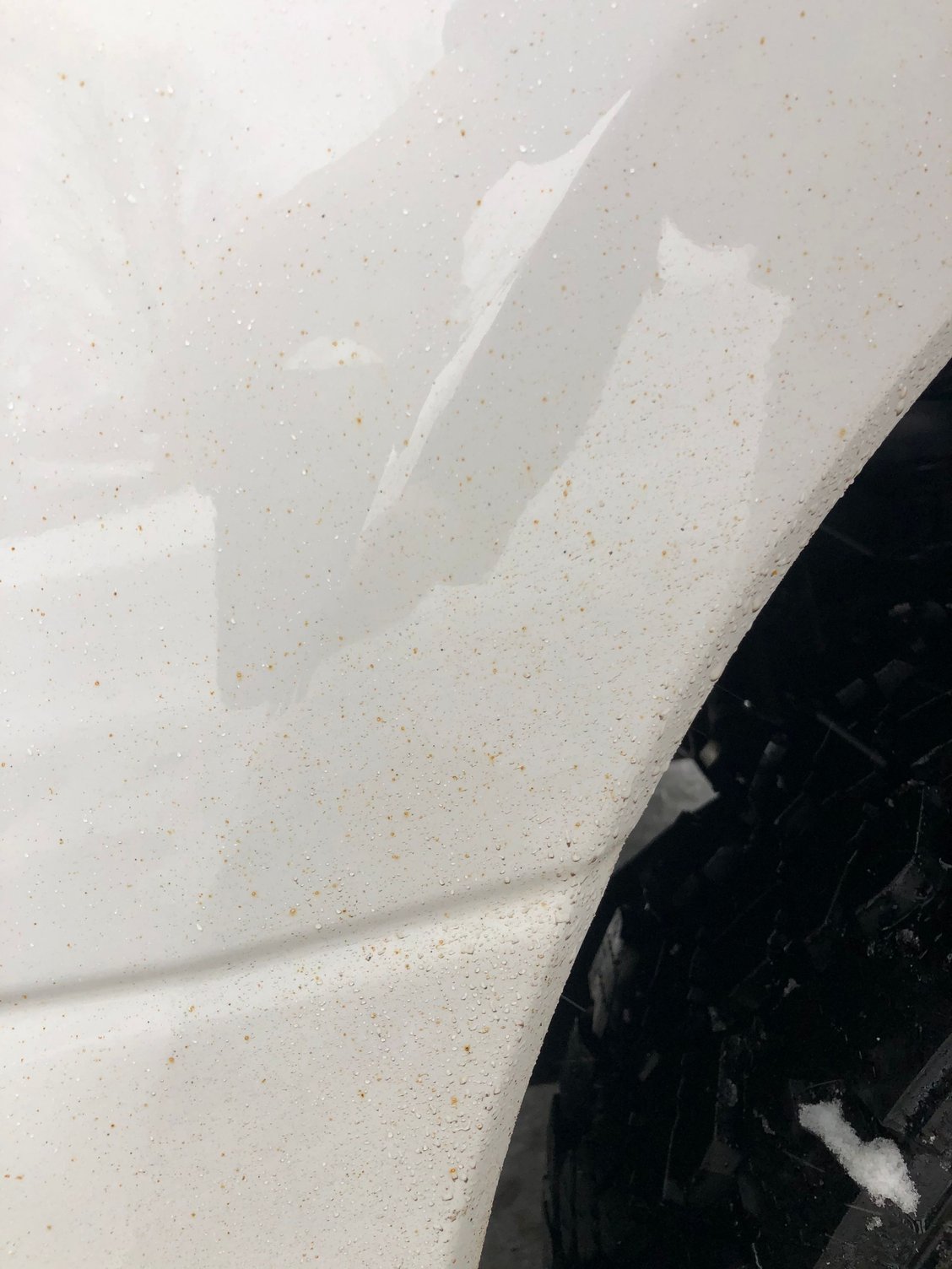

Just want to follow up on my "paint " issue. Unlike some of the posts on the thread, my dealer experience was great. I went to the Fox Ford dealership early in the morning. The service gal had me pull my truck in the bay, took a bunch of pictures and asked me to stop at their body shop (10 miles away) for a complete estimate. Went there last night on the way home, it was 30 minutes AFTER they closed. I saw the hours and just waved to the guys inside and walked away. They opened the door and said no problem. Came out to write an estimate, and told me that my truck wasn't corroding, but just had "rail dust" on it from the metal material in the rotors. Apparently, back when companies used to ship vehicles by train, this was a bigger deal with the metal from the wheels adhering to the body panels. Lighter colors are worse as it shows up as rust colored. They use wheel cleaner, spray the panel, let it sit for a few minutes and wash as normal. They said to stop by any time and they would take care of it. Thanks for listening, and I just wanted to clear my paint issues up. Vautti

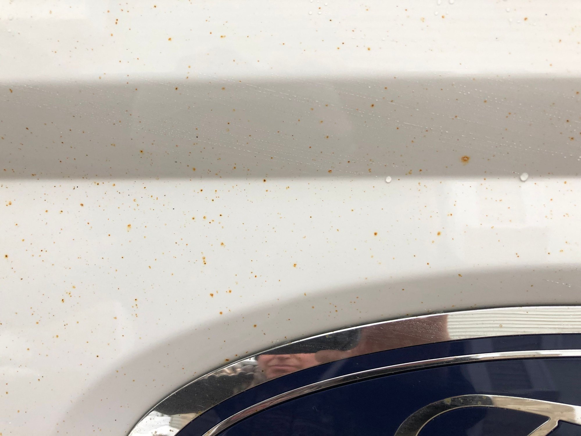

Rail Dust on 2019 F-250
Tailgate is the most noticeable.
Rear quarter panel.

Pictures I posted show the "rail dust." Salesman at our local parts store also knew about it and recommended a wheel cleaner (without any acid). I tried that as well and had no luck removing it at home. I suspect that I will need to use something with a mild acid, but I will let the pros clean it the first time. It has also been pretty sloppy driving up here, so I am not in a great hurry as long as there is no long term damage. Kind of freaky though when you see it on an aluminum panel!

Ive had good success on this issue with clay bar and elbow grease

They say wheel cleaner because they have iron removers in them, but there are products that are specifically marketed as iron removers that might be more effective. Clay bar, like mentioned above, are also used to remove that type of deposit. I would NOT use an acid wheel cleaner on the paint work, they are nasty.
The iron remover, if effective, would require the least amount of follow up on the paint. Only requiring a new coat of wax or sealant. If a clay bar is used, it will need to be polished after, then followed by a wax or sealant.
