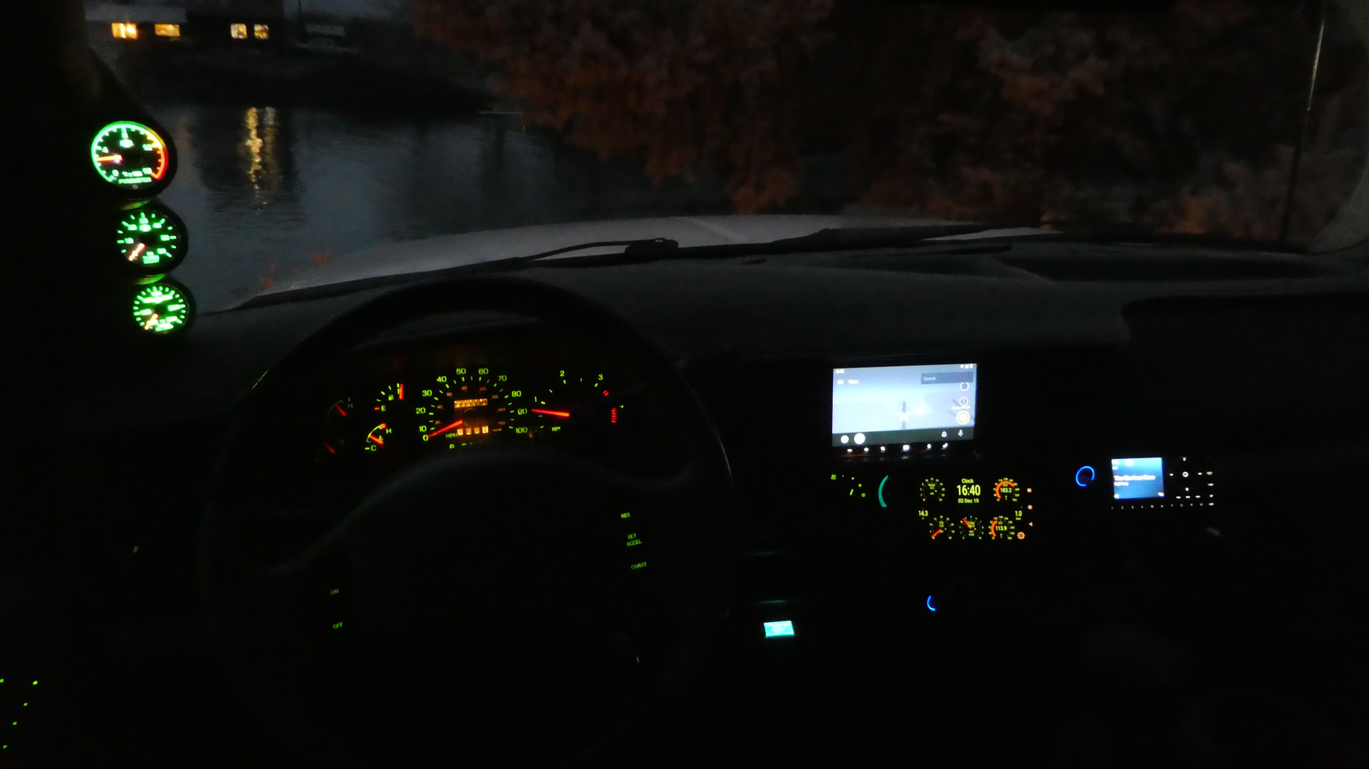

I have an older version of AutoEnginuity, which comes with a USB adapter. I also have OBDLink MX (I bought it before the plus version was available)... wanna guess which one gives me a better data rate while monitoring gauges? Our Jurassic electronics have a throughput of about 41K baud - where computer modems at the time were 56K baud. Even at that glacier-movement speed, the USB adapter put gaps in my data because it was too slow. At least the OBDLink MX (and plus version) feed the data at the truck's electronics full data rate. I've also used my adapter on a 2007 Prius, logging about a gazillion PIDs (there are dozens just for the batteries) - and the MX/MX+ is up for the speed challenge.
Maybe my AutoEnginuity adapter was just a poor design, but it wasn't the laptop - I've tried everything from a 10" netbook with an Atom processor, to my current laptop with an i7, 16G of RAM, USB3, an NVME SSD, and a 4K touch screen. That particular USB adapter just sucks.
There are times when my phone won't link with the BT adapter, but I just unplug the adapter and plug it back in and the problem is gone (reboot). You see, while most other OBDII adapters continually leech electrons from your batteries with the key off, the OBDLink MX/MX+ does not. I've left it in the port with the truck keys on the hook for as long as two months straight - no battery drain. So... I leave the adapter in there all the time, and I've learned these things need an occasional reboot because of it.
I don't watch the gauges - I log them. I have the gauges up on my phone to be sure... but I really only glance at three of them while driving/towing - Engine Oil Temp, Transmission Fluid Temp, and Torque Converter Slip. I no longer look at boost... unless I were to start rolling coal or lose power. As for the ICP, IPR, FIPW mix... there is no way in hell you can suss all of that out while driving - unless you really really understand the relationships between them all AND you're not sharing the road with other drivers. Log them, then peruse of over the log with a beverage at your home computer... or share the logs here for analysis.
Don't forget the alarm feature. You can program every PID you want with a min/max - then an audible alarm will sound, and a voice will tell you what is out of range. I had an annoying demonstration of this feature last summer. Apparently, Frankenstinky has a bad EOT sensor, and the alarm gave the ol' chest pumper a test fire. Once I determined the sensor was bad by way of the IR thermometer I keep in the truck, I reset the calculations on the PID to give some semblance of accuracy, fired everything up, and drove on. That PID is still boogered, but hey - it's winter now. I'll get around to replacing that sensor, but the workaround in TP is not something you can do in all OBDII apps.
Anyway... don't worry about the size of the screen like I used to, you really don't even need the screen up with the logging and alarm features.
