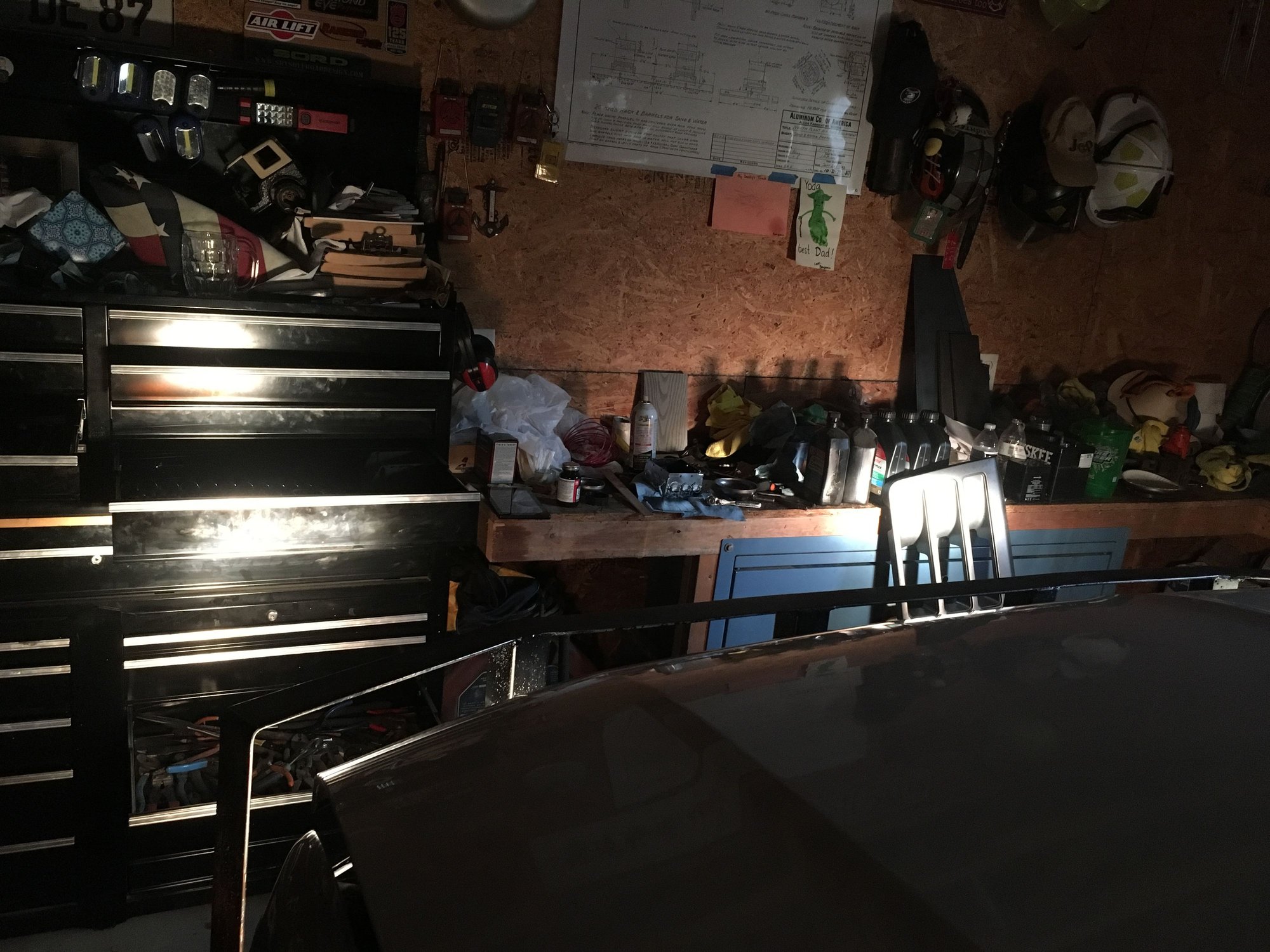

I dig that harness, same one I use. Best part takes load off the switch. Brighter lamps are a side benefit to me!
