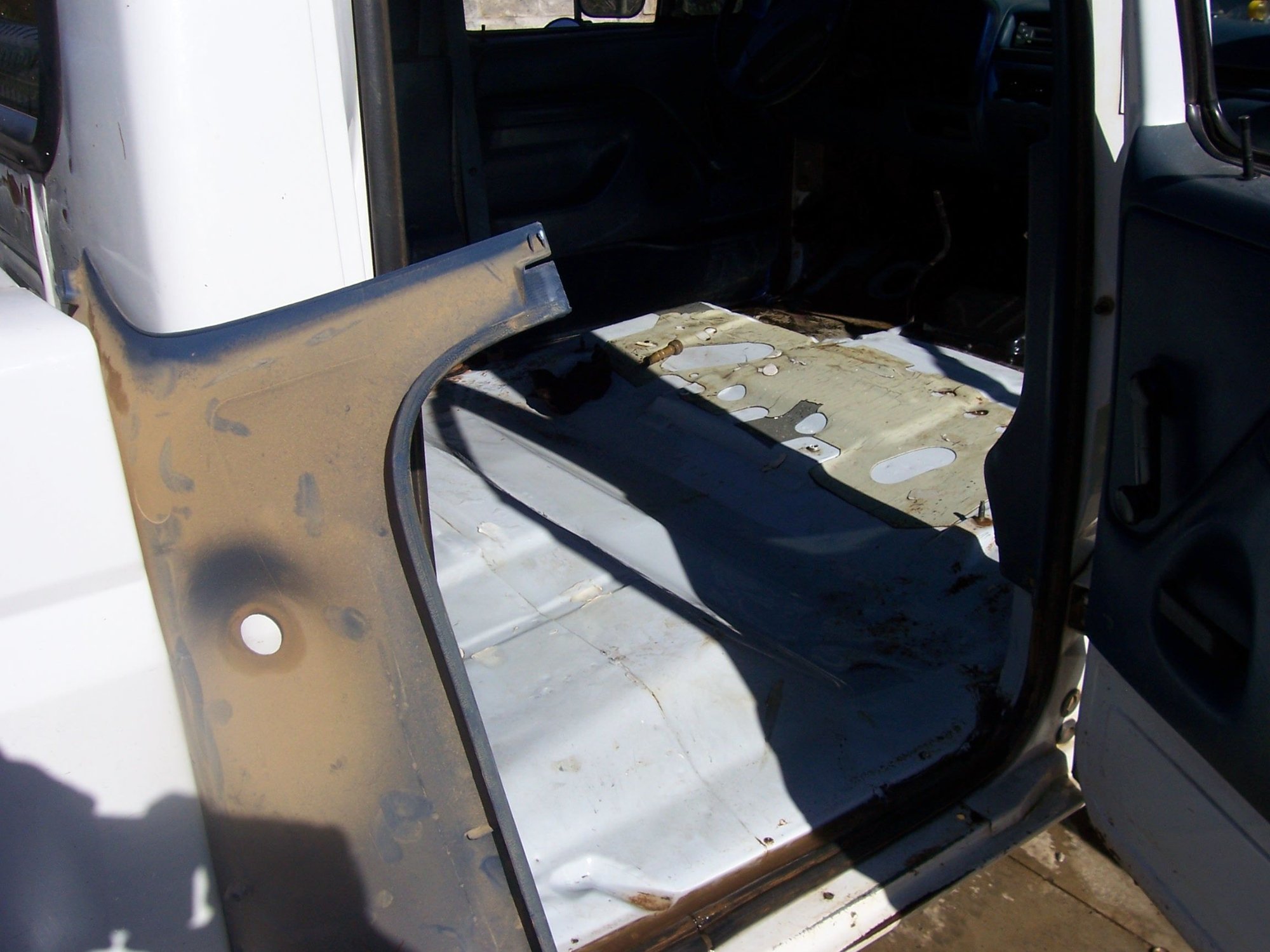

After the bumper I started trying to look at some interior sound deadening. At the time I had a straight exhaust that exited in front of the rear tire so it was pretty aggressive sounding. I had some left over "double bubble" material from a garage door project I had completed. granted it probably is not as good as some nice sound deadening/ vibration isolating materials but I decided to give it a shot.

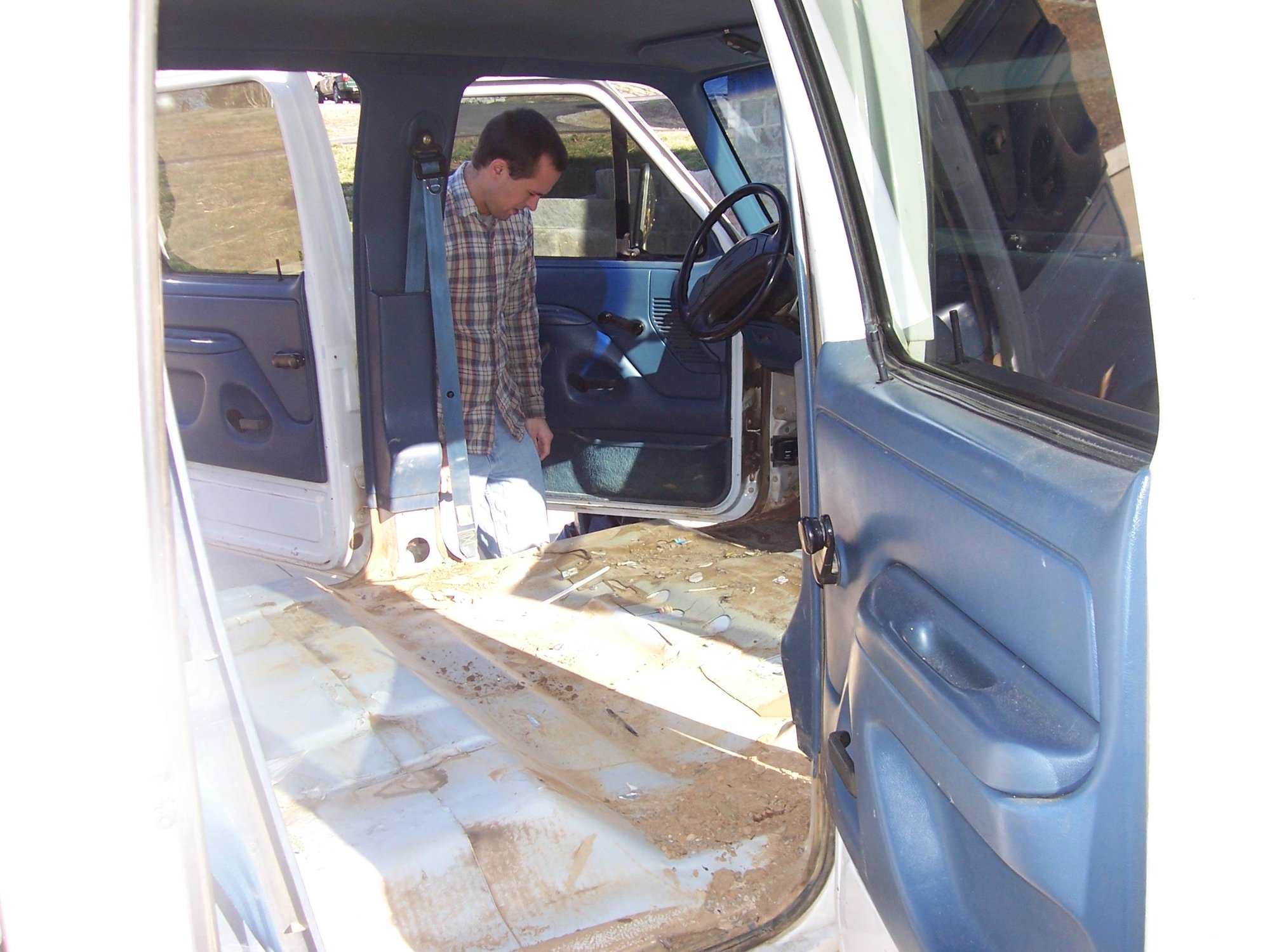

I was horrified by how much dirt was under the floor mat.
After some deep cleaning
I had to vacuum out the rails because of all of the fun cleaning!

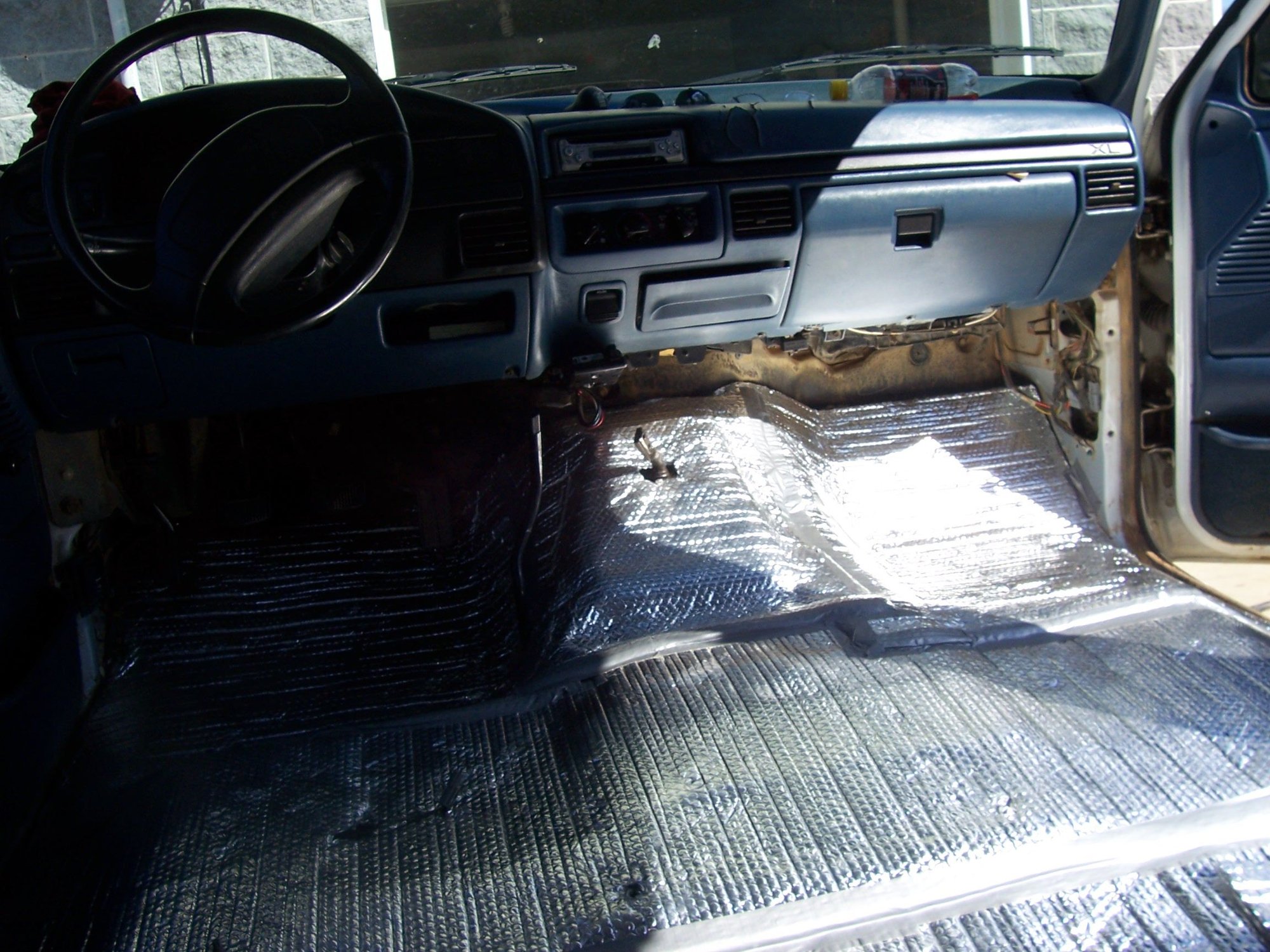

Then I applied the barrier:
For those unfamiliar with this product here is the basic breakdown:
1 layer of white thin plastic sheeting
1 layer of bubbles, similar to packing bubbles,
1 layer of thin aluminum foil
the product is commonly used on garage doors, walls, water heaters and other fun construction projects. I chose if for a few reasons.
1. I had it as leftover from a job I did
2. I didn't have to use adhesive to put it down, so if I didn't like it I could easily pull it out
3. it won't absorb water
After the install I was pretty surprised at how well it worked. It does a nice job on reflecting the heat from the floor board and quietened down the interior a noticeable amount. I don't have a direct read device to measure the db difference, but the wife-o-meter made a positive reading after the install, without being aware of the change. It has been down for several years now without a noticeable issue.

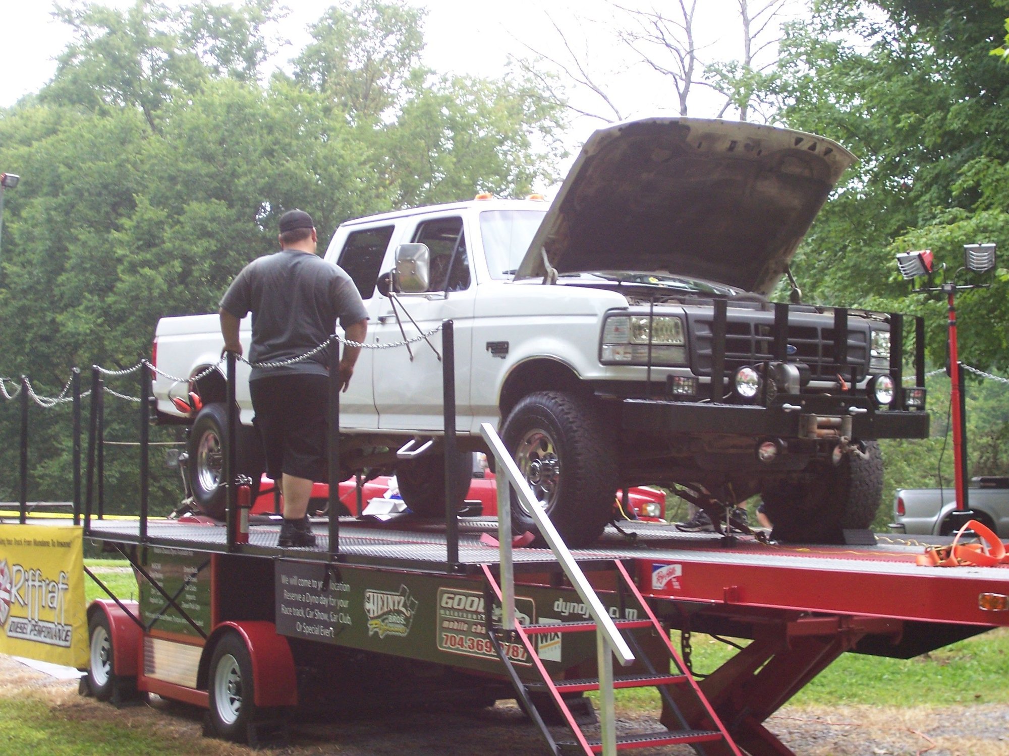

I have always enjoyed this pic. The date says 2005 but obviously that ain't right. I think it is from 2009-2010 or so. The RRE events were a ton of fun
Watch out now, I think I dropped a jaw dropping 207 HP on this one
That's awesome!!
Rre 2020 is gonna be another good one tho...

Considering that at the time of the dyno my only mods were an intake, exhaust, and the infamous 10k mod I don’t think 207 to the wheels was too bad. That was the year I won the “lowest HP”

207 seems right for a stock tune, I read these dyno 175-180 all the time bone stock. Downpipe has shown around 20rw alone and intake about 10ish on average.
