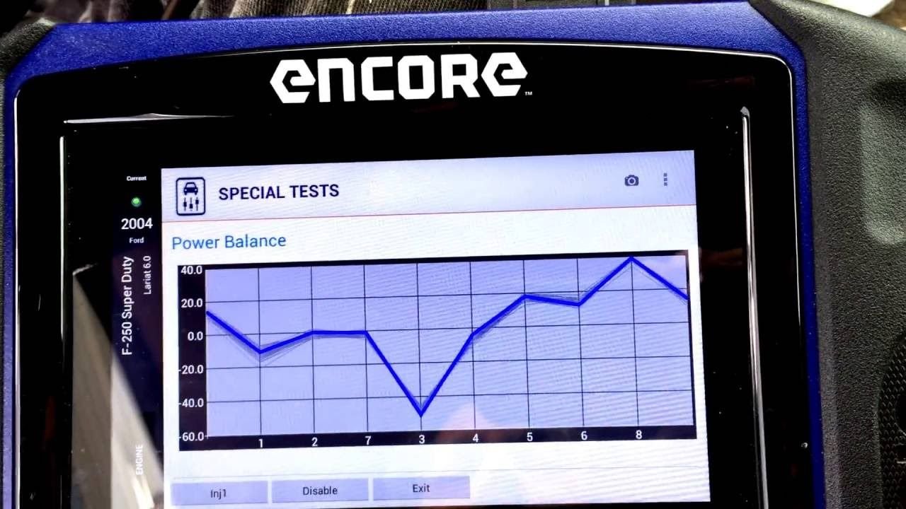

What about the Encore? If I could pick up a used one for cheap locally I would.

Encore, now owned by Bosch who do quite a bit on the Ford IDS, is "ok" --- I don't recommend used as this world is moving pretty quickly and you'll get left behind fast...........I've found that the OEM tools (I own/license Ford, GM, Toyota, Honda, etc) are vastly superior to the aftermarket "me toos".......................it's not even close.
