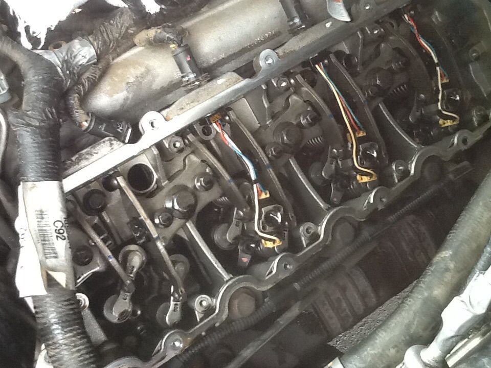

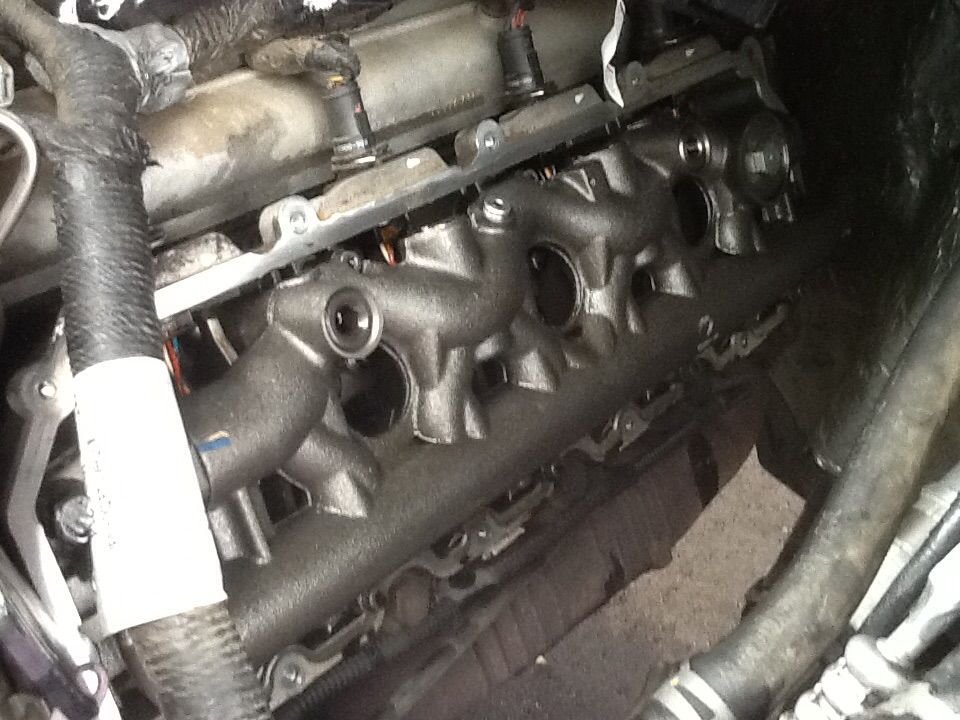

The tube connected to the oil rail that goes down into head is keeping me from getting the oil rail out. No mention of this tube in the workshop manual. Ideas?
That's the standpipe. It unscrews out of the oil rail. Loosen the standpipe, then the oil rail and wiggle them out.
Delete delete
Pull both the dummy plug and standpipe out of the oil rail first. Makes it much easier to just pull straight up. It also allows the rail oil to drain, not making quite the mess when pulling up ( large two hex bolts).

Can the standpipe go back in after the oil rail is torqued down? I'm trying, but the angle doesn't seem to allow for it because of the AC box. Might just have to pull the bolts out of the oil rail so I can install the standpipe at the same time as the oil rail.
Yes, you just need to lube up the o rings on both dummy plug and standpipes after installing the oil rail. Torque the small torx bolts, securing the oil rail to 8-10 lbs.
I used Vaseline to coat the injector o rings before inserting.
I also filled the oil rail after reinstalling to avoid dry start attempts.
Expect a no start for 10-15 seconds after first trying to start, 3-4 starter attempts.

I really don't think the standpipe will go down the hole at the angle allowed by the darn AC box. I have half the bolts back out of the oil rail already anyway,and rra
If clearance still isn't okay, I'd put the standpipe in halfway and wiggle them both down together.

From: Woodbridge, Ontario, CA
On the passenger side oil rail, you'll need to separate the upper and lower half of the standpipe prior to installation. Slide the lower half of the standpipe into the oil rail first, and let it drop into place. Then carefully thread in the upper half of the standpipe until snug. Torque all your nine TX-30 oil rail fasteners to the factory 8 ft-lbs. spec (I usually torque to 10 for good measure). Then, torque your standpipe and dummy plug to 60 ft-lbs. to complete the installation.

all finished up and running like a top! Thanks guys!
