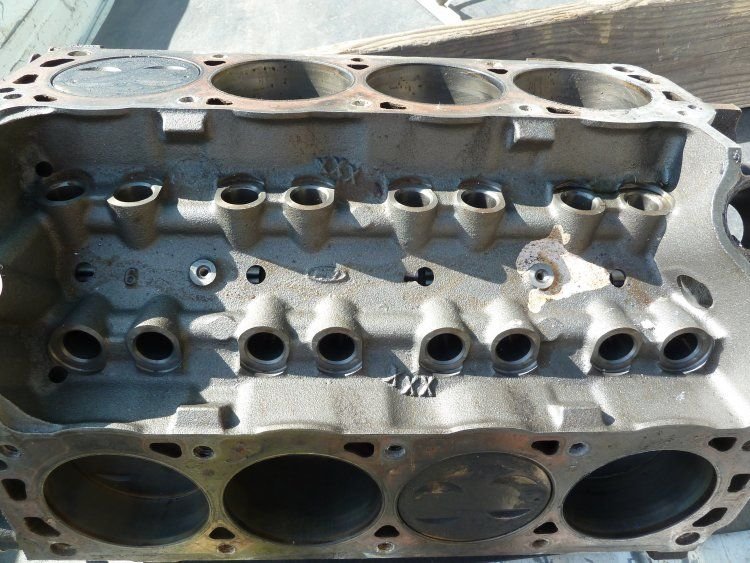

Originally Posted by CharlieLed
I did find a date "tag"...7M4
Since this is a roller block is it safe to assume that the year is 1997?
That would be my take on it. 1997, December 4. That would make it a '98 model year engine, and the Explorer was the only Ford vehicle still using the 5.0 for '98.
re; the vin stamp missing, it's possible Ford used a different method of id'ing the engine by them, but time has passed me by on that info.
7M4 = Block cast December (M) 4, 1997 (7).

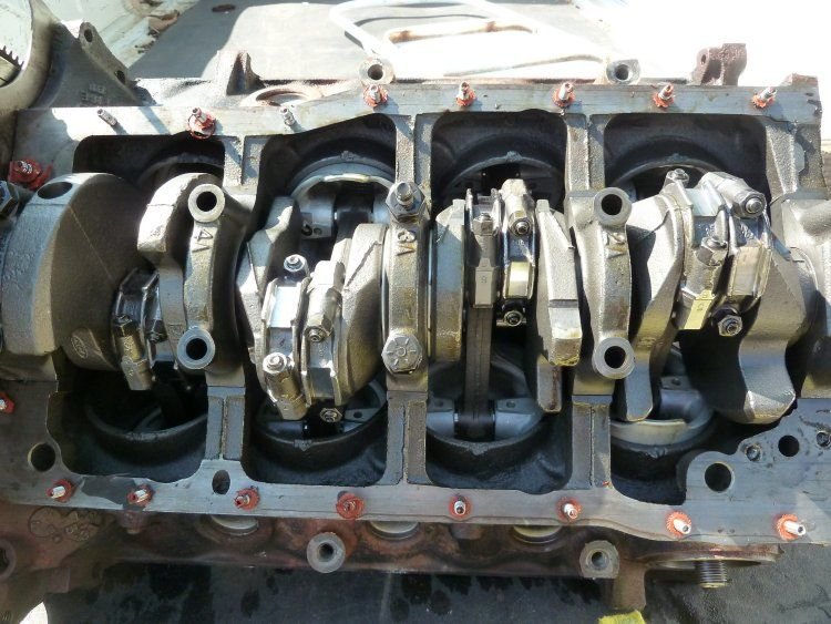

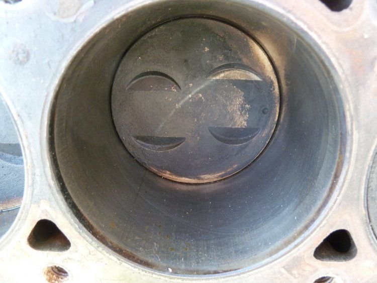

Bore is std at an even 4.00. Here is a pic of the underside of a piston...this whole short block is pristine. Tops of the pistons have almost no carbon and there is only a little discoloration at the top of the cylinder walls...no carbon build up. The guy I got it from had it in a 65 Mustang and was going to a stroker. I got the impression that he knew little about this engine and has more cash than sense. I was thinking that this may have been a crate engine since it's in such good condition and there is no VIN stamping.

By the looks of that I'd put it back together .

Nice score. You can still see cross hatch pattern on the cyl walls.
